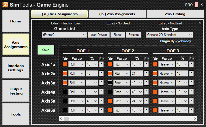

    I have 3 interfaces with 2 motors per interface. Every motor is an axis, but how can I setup the correct order of 6 motors/axes on my stewart platform? And witch one has to be the first, (front left for example)
    Is there any tutorial or manual of that? Point me please there.

    Since DIY has almost endless possibilities so does Simtools. So there is not a "correct order" so to speak. But however you do it Simtools can work with it.
    But yes this is off topic so start a new thread or ask on another thread if you want additional info. ;)

    I have mine setup so axis 6 and 1 are on COM1 (Front left and Right) , 3 and 4 are on COM2 (Middle Left and Right) , 4 and 5 are on COM6 (Rear Left and Right)
    Like @BlazinH says everyone is different and they can all be setup up however you want :) If you have yours setup the same as mine I can share you my profiles if you like :)

    But how can you tell simtools that wich axes/motors wich side located on your rig? And how can you tell simtools the dimensions and parameters of your rig? Have I missed something?

    SOrry totally messed up with what I set my axis lol I must of been on aanother planet ..............this is how they are
    [A<Axis6a>][B<Axis1a>] are on COM1 (Front left and Front Right) ,
    [A<Axis2a>][B<Axis3a>] are on COM2 (Middle Right and Rear Right) ,
    [A<Axis4a>][B<Axis5a>] are on COM3 (Rear Left and Middle Left)

    Ahhaa, there is a FlyPT interface I haven't noticed yet. Im jumping to dive in it :) Maybe it helps to understand how it works. Thank you too!!!! Im getting to fill the barrel :)
    I can see your axis6a is your front left motor/actuator, but how does simtools know that? :) What if I wanted to axes1a to be front left motor? How can I tell it to simtools... Sorry Im getting confused :)

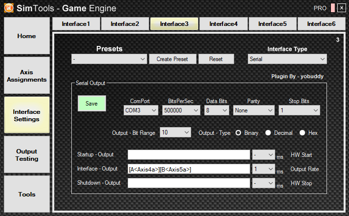

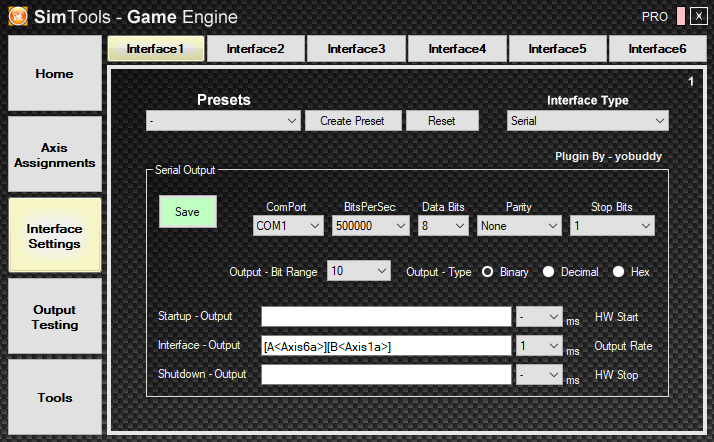

  10. SilentChill
    2,619
    20,402Coins
    +3,480 / 34 / -0
    Like this

    OK I get it, but what I don't understand, where is axis6a declared to front left? What if I want to axis6a to be the middle right? How can I do this? Sorry for confuse you :)

    You just use axis assignments to send which dofs and how much you want to axis6a, no declaration is needed.

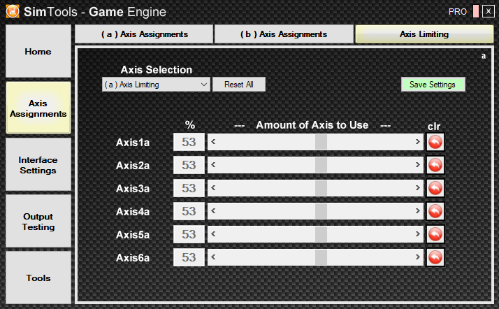

    @Gabor Pittner sorry I forgot to post my axis settngs. This is what I use for car games, hopefully maybe of some use :)
