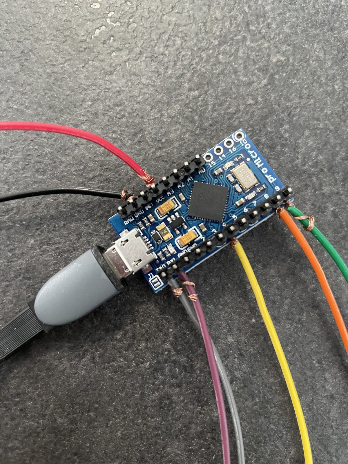

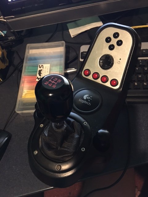

    Hi Everyone,
    As happy as I am with my Fanatec wheel (CSR) I can't afford to get the SQ shifter.
    The standard ones on the Fanatec are plain awful, but the G27 Shifter is actually still OK for the job.
    (Especially because my G27 shifter has a nice heavy gear knob for added "clunk")
    I found this code on Github and modified to just pull out the Shifter part.
    It's recognised in Windows as a USB-HID device and the buttons and Shifter work well.
    You need to mess about with the X/Y values to match the Shifter position, but that is easy enough - It's outlined on the original github README.md.
    I had to reverse Pin 1 and 0 on my build. Not sure why, you can read the Issue on Github here, however I have left the code "as is" just in case my Pro Micro board is the issue and not the code.
    https://github.com/functionreturnfunction/G27_Pedals_and_Shifter/issues/11
    I used the following parts:
    1 x DB9 Male
    http://www.ebay.com.au/itm/111159749065
    1 x Pro Micro ATmega32U4 5V 16MHz (Sparkfun clone)
    http://www.ebay.com.au/itm/201252082703
    You can read more about the original project from the link below:

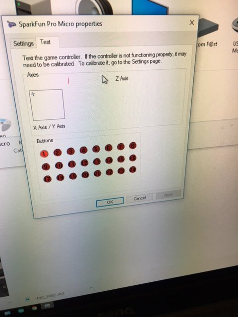

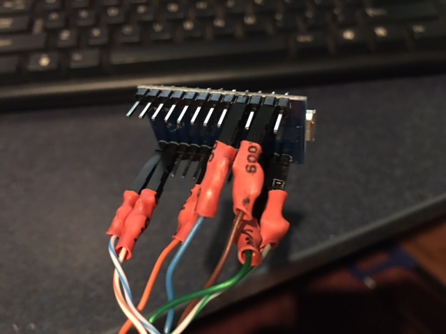

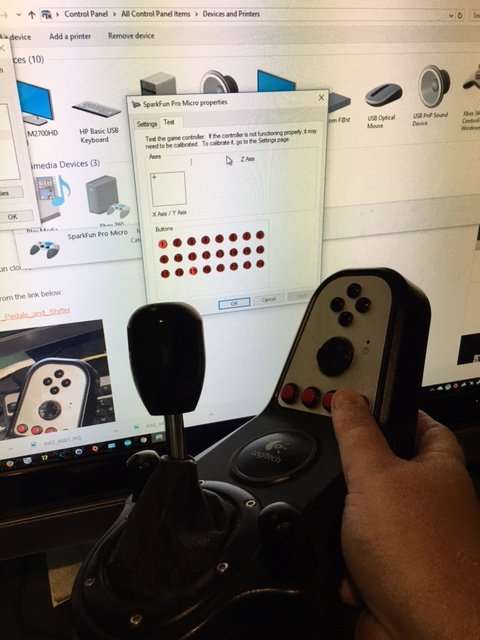

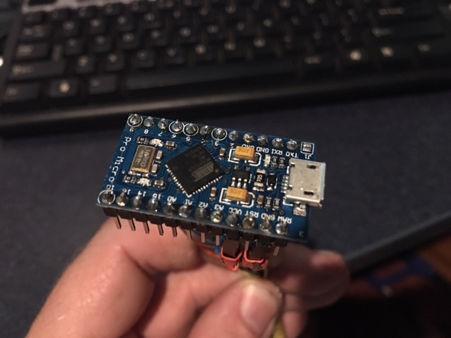

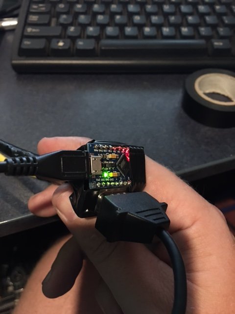

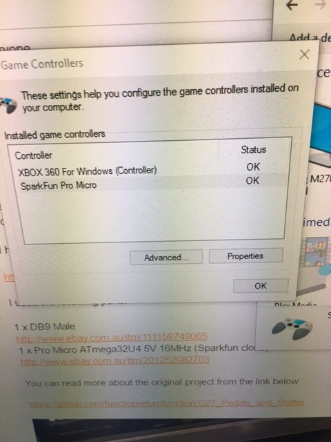

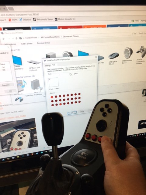

    Some more pics..
    It's tiny and weighs nothing. Could likely integrate straight into the shifter!
    Appears as a Game Controller.
    1st Gear engaged and pressing the Red button. All other buttons work as
    does the D-PAD.

  17. λευτερης ταρανας
    λευτερης ταρανας New Member
    Jan 21, 2020
    67Coins

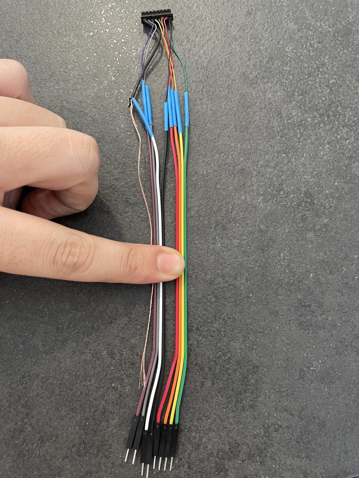

    hello everyone and a happy new year . I have the G25 shifter with broken DB9 plug ,so i need some help on how to wire the shifter to arduino without using a db9 connection .Does anyone know which extra connections i have to make ??
    *i tried to connect the wires you see straight to the arduino following the diagrams ,and what i get is no response in leds ,no response in any button ,no response in gears ,except when i move the gear knob on the three front positions (1 3 and 5 gear ) the BUTTON 2 on the controller test lights up
    thank you very much
