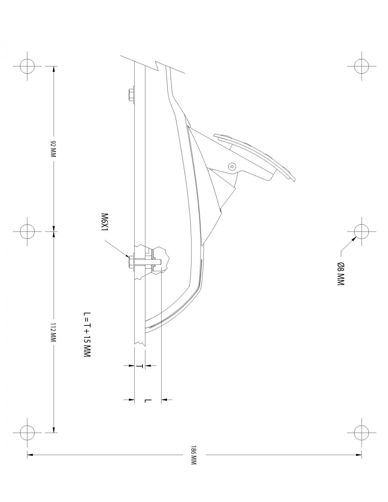

    So i did something silly this morning and forgot to take my test bolt with me to buy more of them so I can mount the pedals. Can someone tell me what size the threaded holes are on the G27 pedals for hard mounting?
    I've read online some threads about this and some people say M4 and some say M6 x 1.0. Any help would be great.

    This document from their customer care center (posted on Amazon) shows M6x1. Sorry I do not have them myself but did want to help.

    That's what size I thought they were. I'll go and buy a few M6 anyway, they won't go to waste.

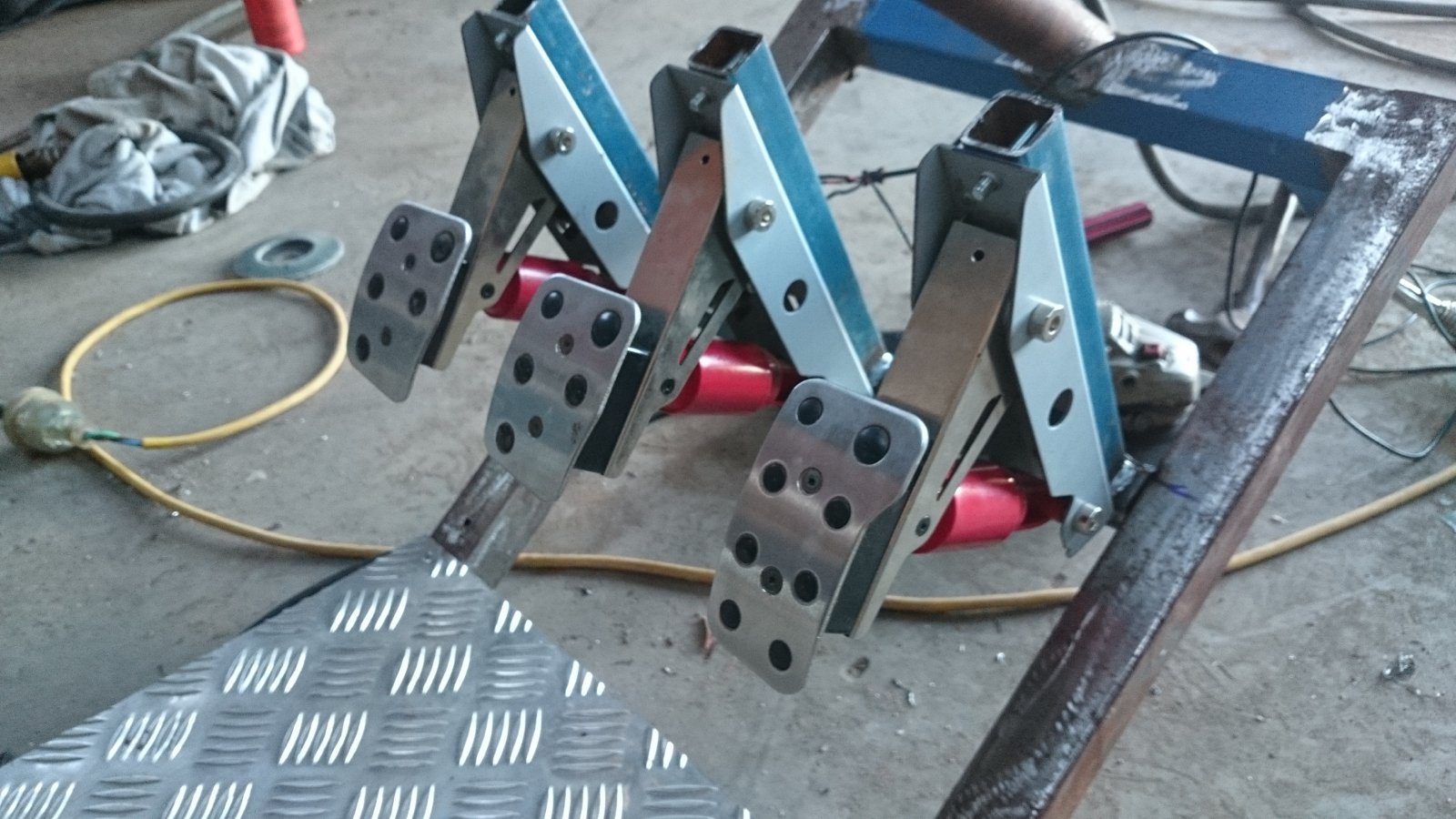

    This weekend I Will be welding up a frame to hang the pedals, I'll upload some pics asap.

    DSC_0132.JPG This is my set up at the moment.

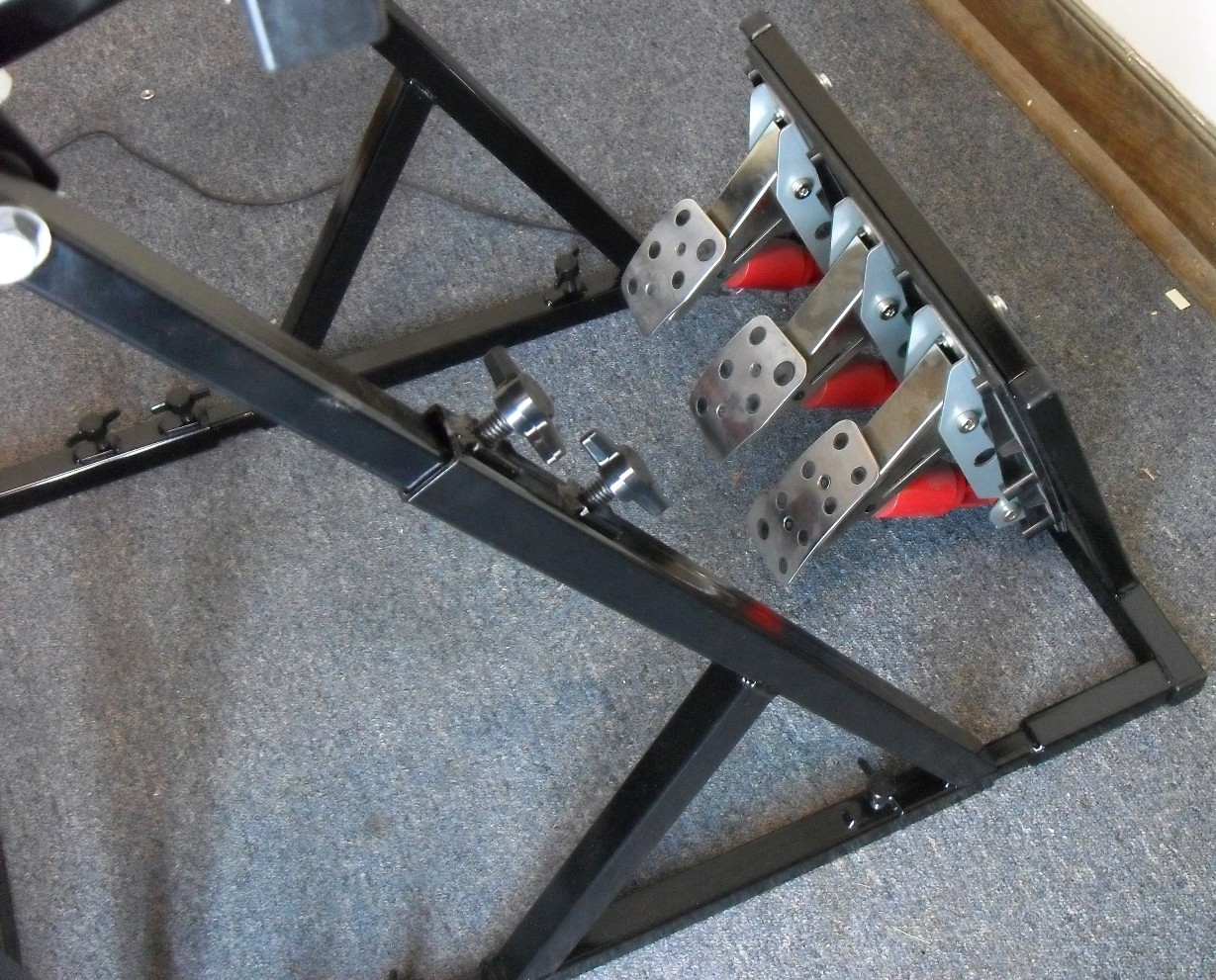

    Some tidy up left to do and painting etc but almost finished.

    Have you driven it yet Barry? Looks like the angle would be nicer on the ankle joint!

    Only just sat in it to test the leg distances. It was all measured and tested before it was put together so the angles all appear to be good.

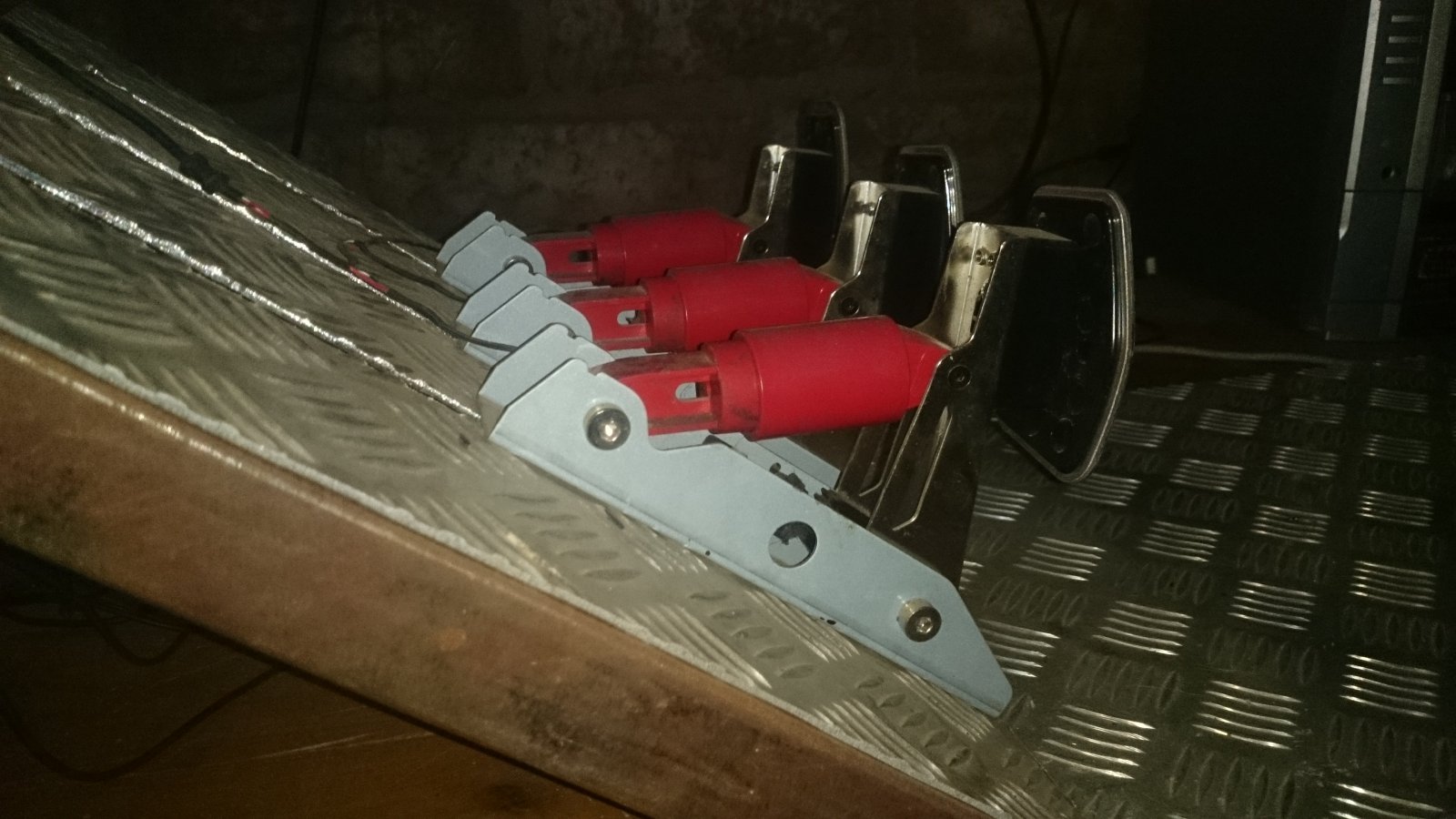

    I also had time to do the underhung pedals today but as F1 race is on I'm watching at moment but as soon as race is over I'll upload some pics, but it does feel much better though I also have not tried them yet.
    DSC_0140.JPG here's a shot of the new mod.

    Alittle update on pedals, I ran for about 2 hours last night and pedals are Alot easier to feel and control but I am going to move the angle a few degrees forward as I think I was over extending my left foot in regards to the brake but overall I am very happy and for g27 owners inverted pedals are definitely a great option to the short height IMO:)

    I rounded the box edges on mine last night and screwed a plastic carbon effect sheet to the front just to tidy it up. The inside is ready to carpet now and I need to make sure the wiring is neat and secured.

    I had another run on sim sled today and I definitely have to lower the pedals down a little bit but I love the inverted style :) I'd like to see the carbon and carpet finish Barry that would look cool.
