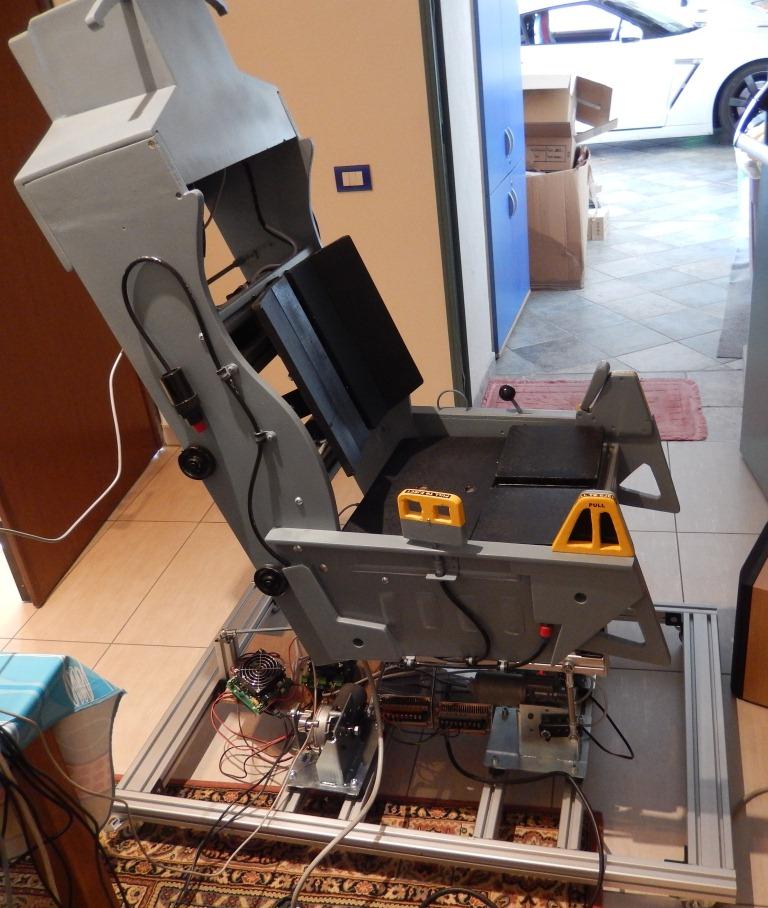

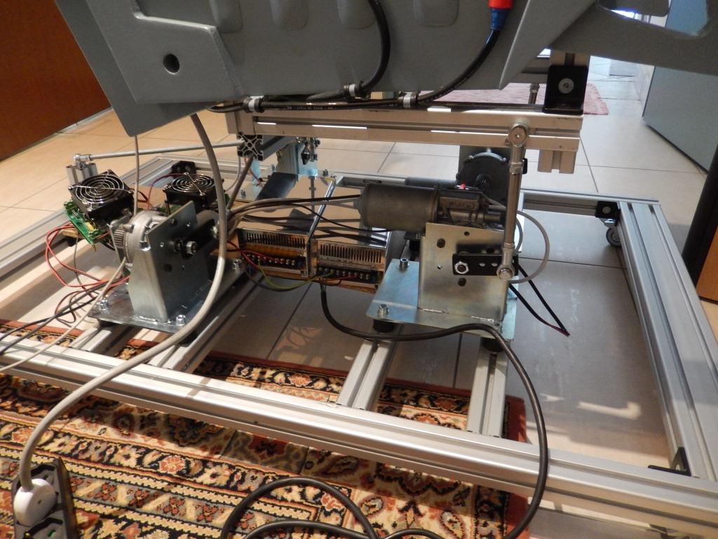

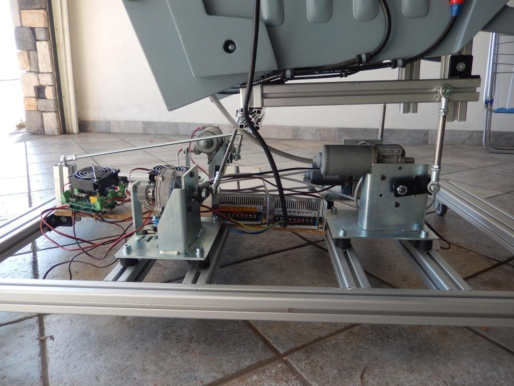

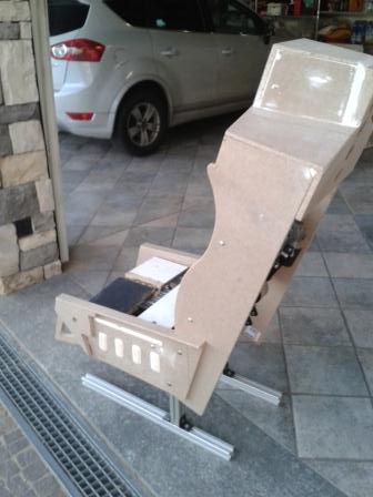

    after all this time I managed to make some progress on the g-seat, now I have a base with 4 motors 24v this will not be final must see and control still many things I used my cards that support high loads, now I have tested everything 12v then the movements are still very slow.
    in the next few days I will try to finish it all ....

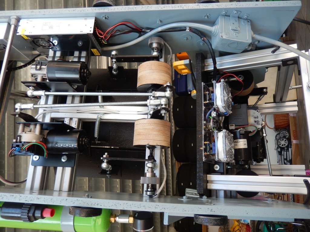

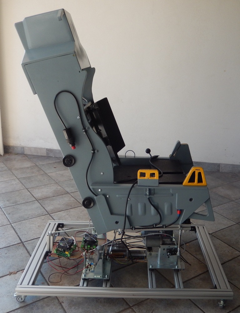

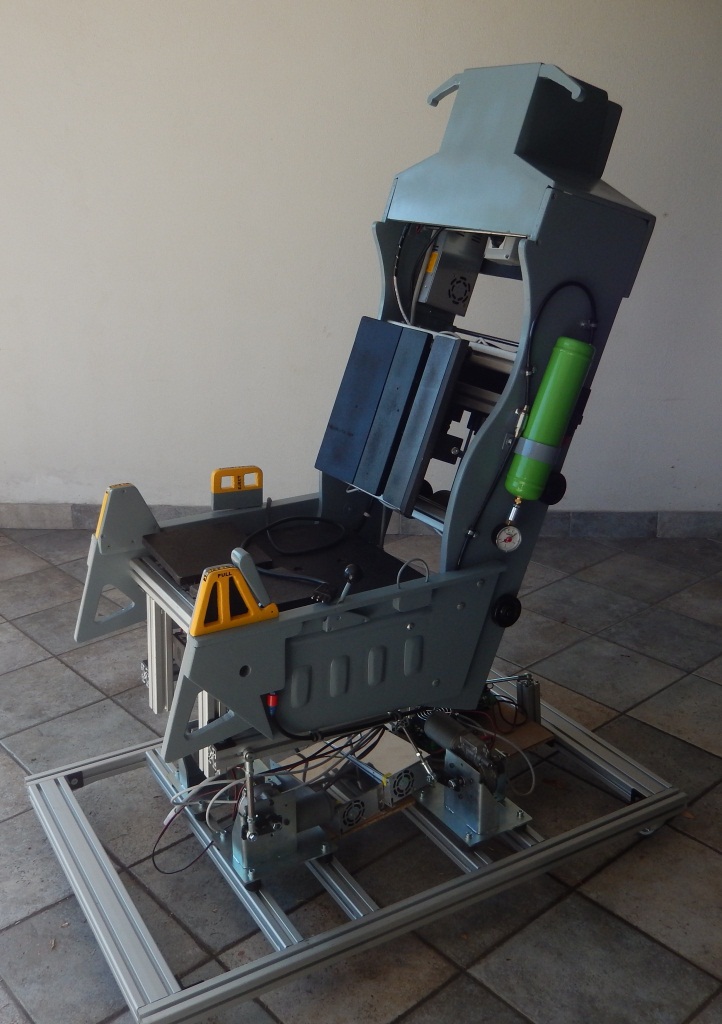

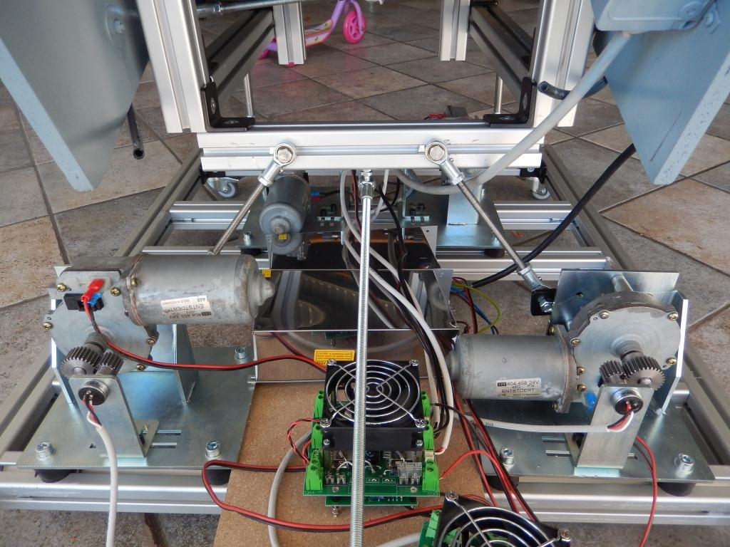

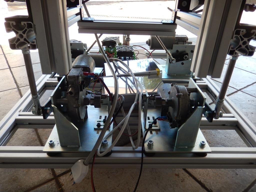

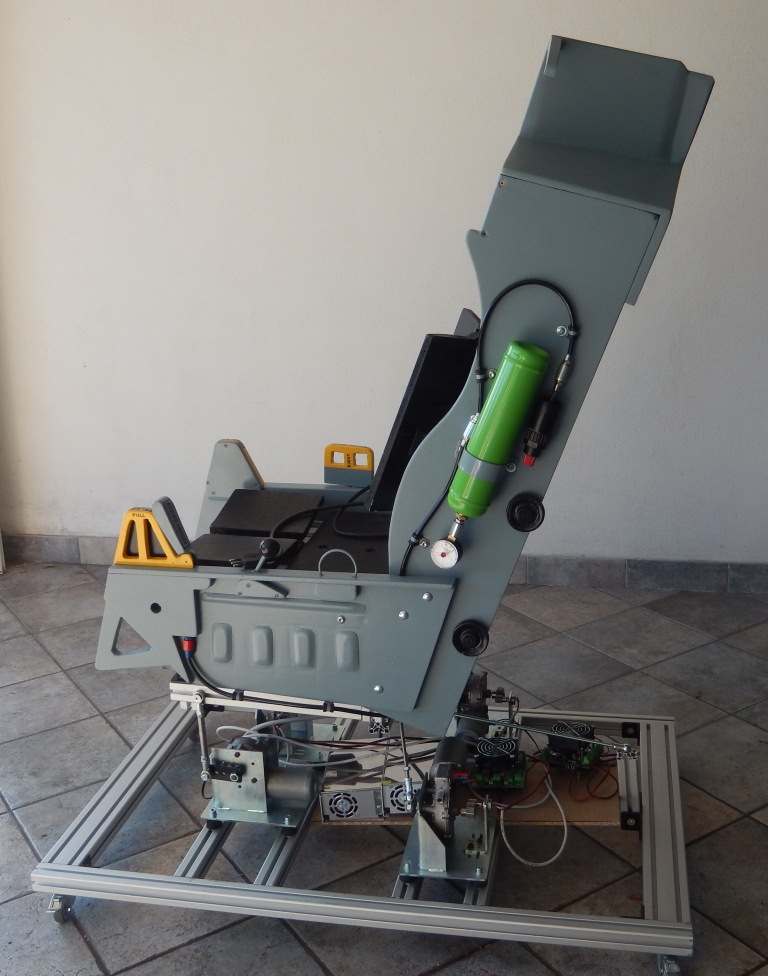

    in these days of semi vacation I took a little time to continue with my projects
    It was in February 2015
    August 2015
    DSCN4424.JPG DSCN4425.JPG DSCN4427.JPG DSCN4428.JPG DSCN4429.JPG DSCN4432.JPG DSCN4431.JPG DSCN4413.JPG
    the job is not finished yet but the bulk is done, and still lacks the complete coating of the details to be decided on the mechanics of the base
    now a small video calculated that the PWM motor was 80% and the minimum PID
    the seat weighs about 60kg tried with me that other 60Kg and motors were traveling at large
    yet the mechanism is to make more stable
    I have to make a decision:
    currently with this type of mechanism I can also recreate a minimum crush but this involves several problems:
    1 engines retrospectively must work with auctions almost 45 degrees subjecting the engines to considerable strain and decreasing the real thrust.
    2 mechanics become much more complex, I have to add various rods and deleting games due to the rod ends or uniball.
    for a slight crush worth?
    or put a joint that makes it stable
    I use translator I hope that everything is clear
    Greetings

    Nice looking seat :thumbs, but 60Kg:eek:, too bad you could not use high torque servos - as they only have to 'push' on the body? Just watched the video - cool - seat works well, just concerned on how stable that four motor setup will be and the amount of weight those wiper motors/gearbox will have to heave when there is a person on top. Look forward to further progress.
