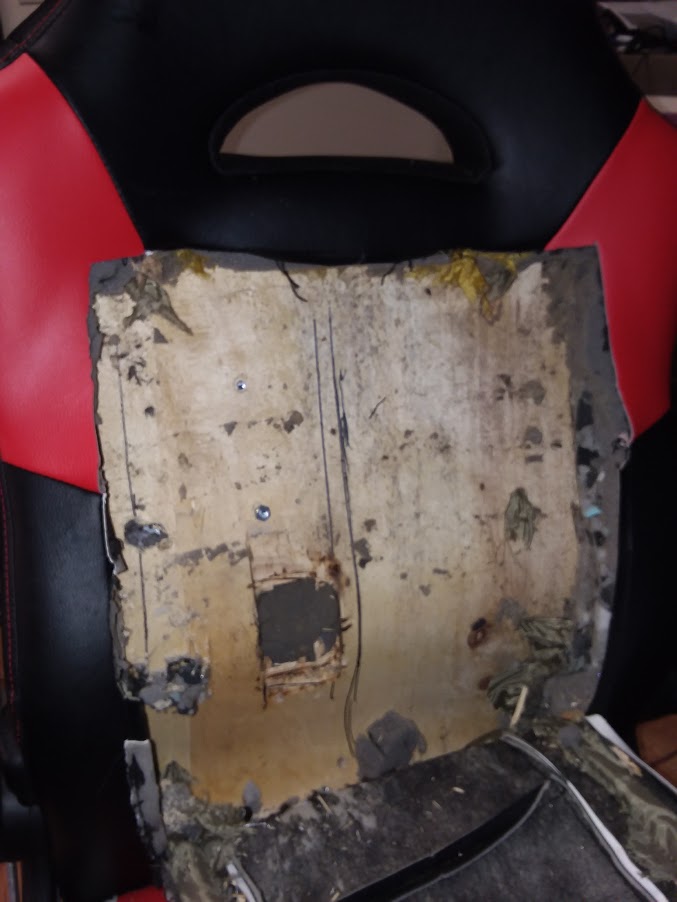

    Where to start. That was my question.
    The legendary GS-4 seat from Simexperience is no longer made and still in demand. My project is roughly based on their design. But where do you start?
    So this thread is my start.
    The chairs design you use can vary wildly.
    I would advise a wider chair.
    Be prepared to pretty much destroy your new chair.
    It is next to impossible to really know what you will find underneath that beautiful upholstery .

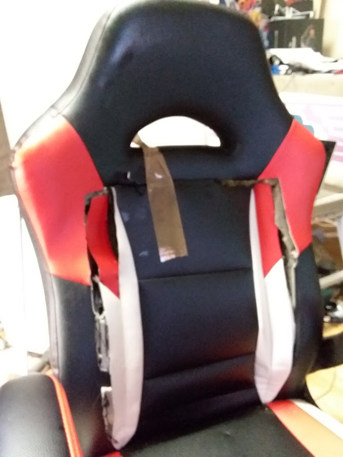

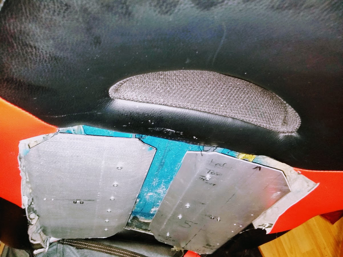

    I am starting on the chairs back. This should give surge and sway.
    The foam is removed.

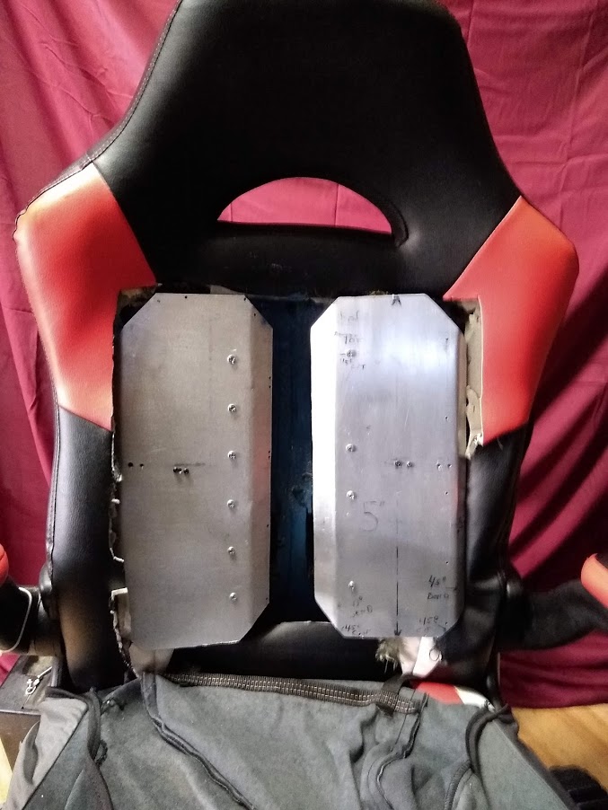

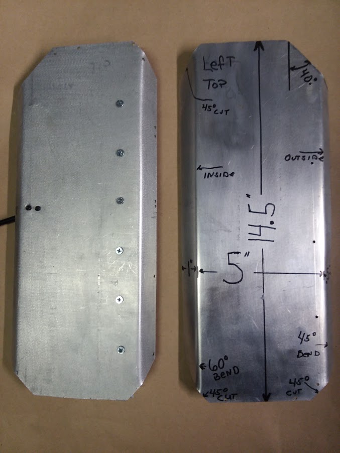

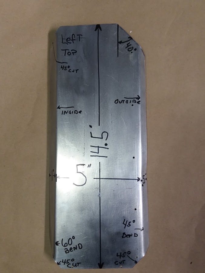

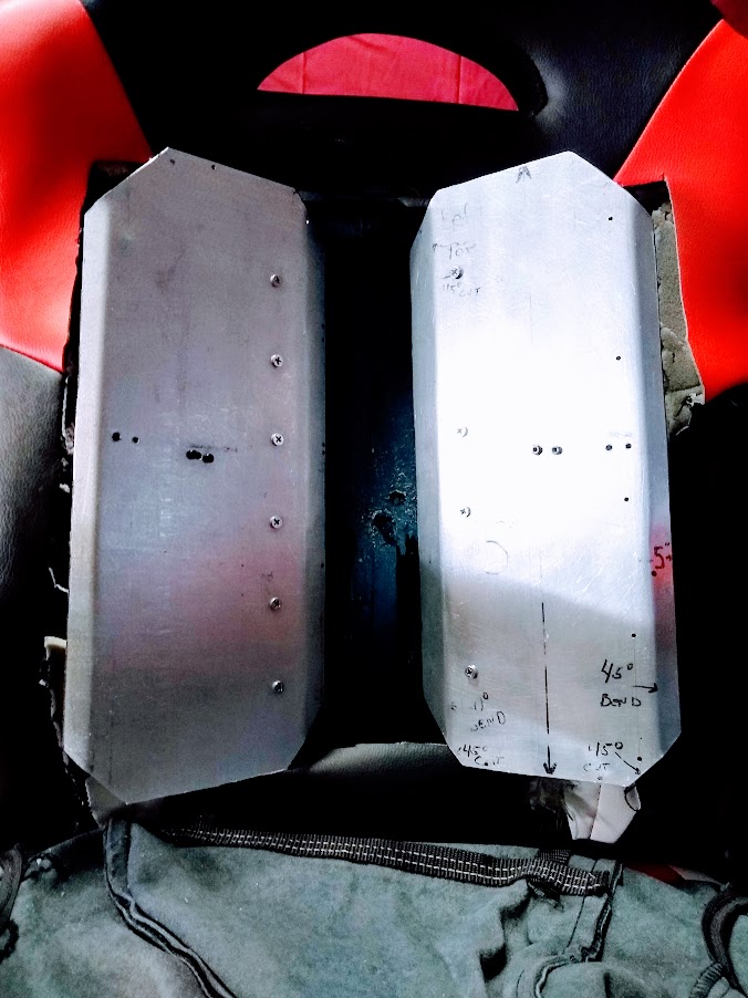

    I made the back paddles from 1/8" aluminum plate.
    The bevels edges are bent at about 30deg and 20deg
    Left is drivers left shoulder.

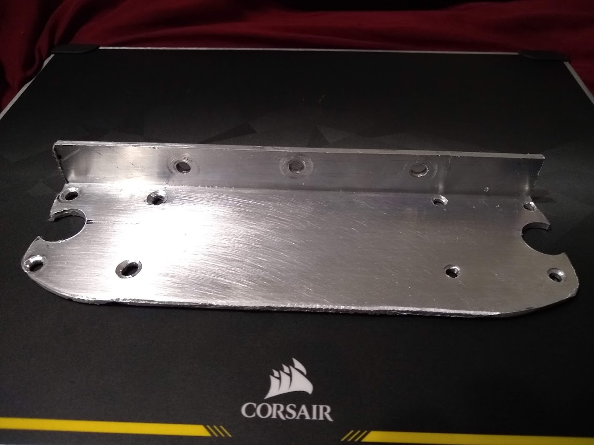

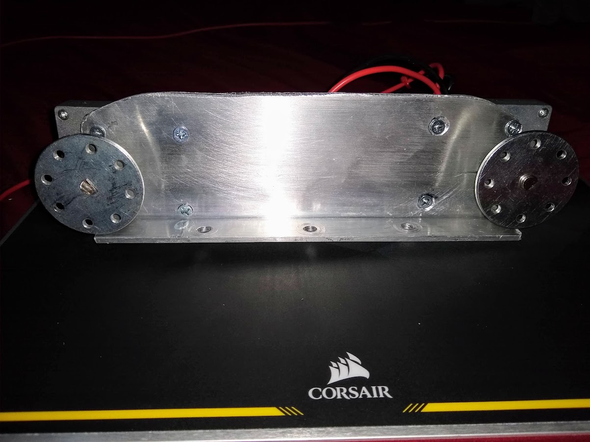

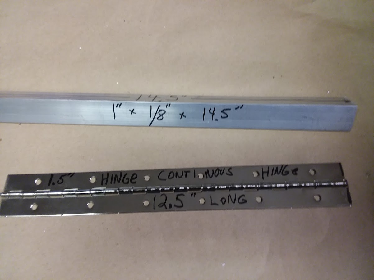

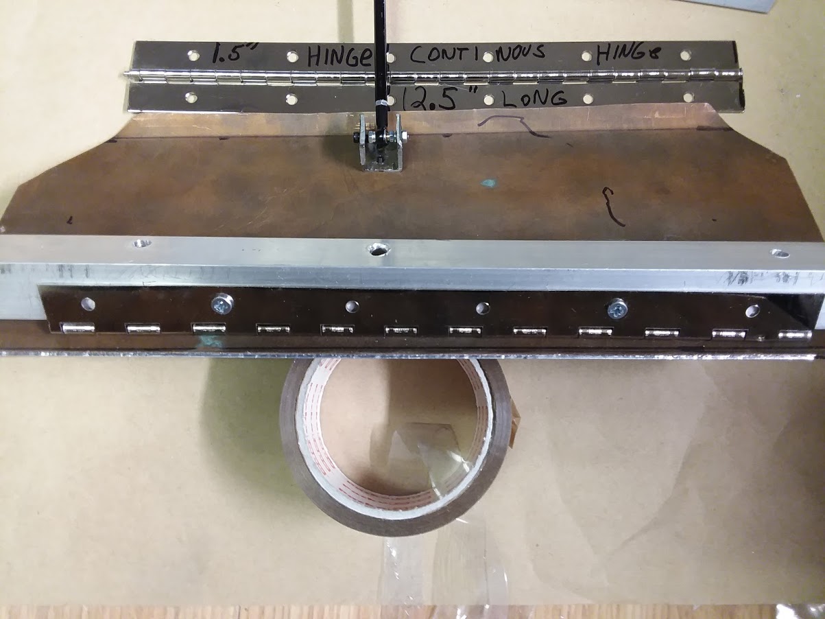

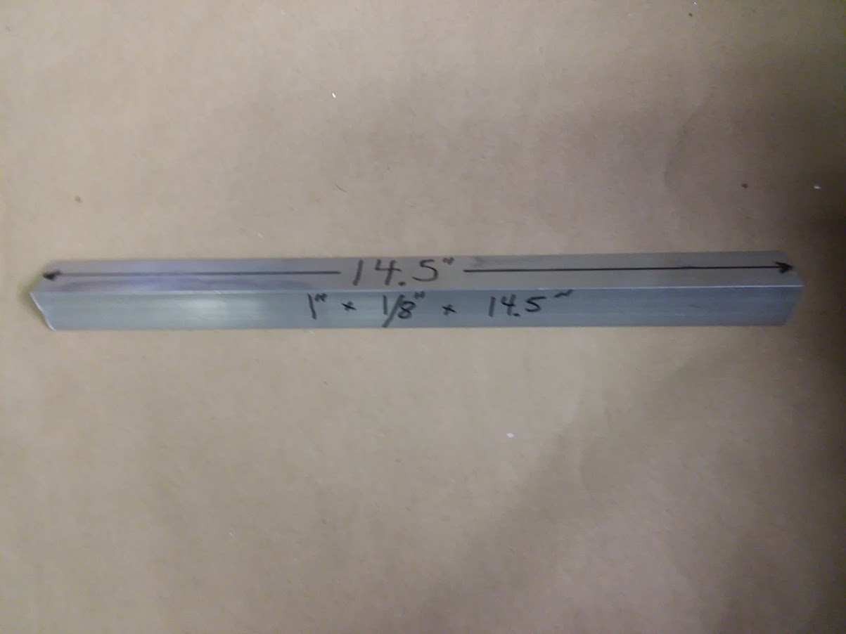

    The paddles are attached to the chairs wooden back with 1"x1" x 14.5" angle aluminum 1/8" thick. The hinge material is called continuous hinge and is sold in lengths of up to 6' long.
    I simply used the pre drilled holes in the hinge to attach to the aluminum angle and the paddles.. 20181204_154242.jpg 20181204_154834.jpg 20181204_154933.jpg 20181204_154953.jpg

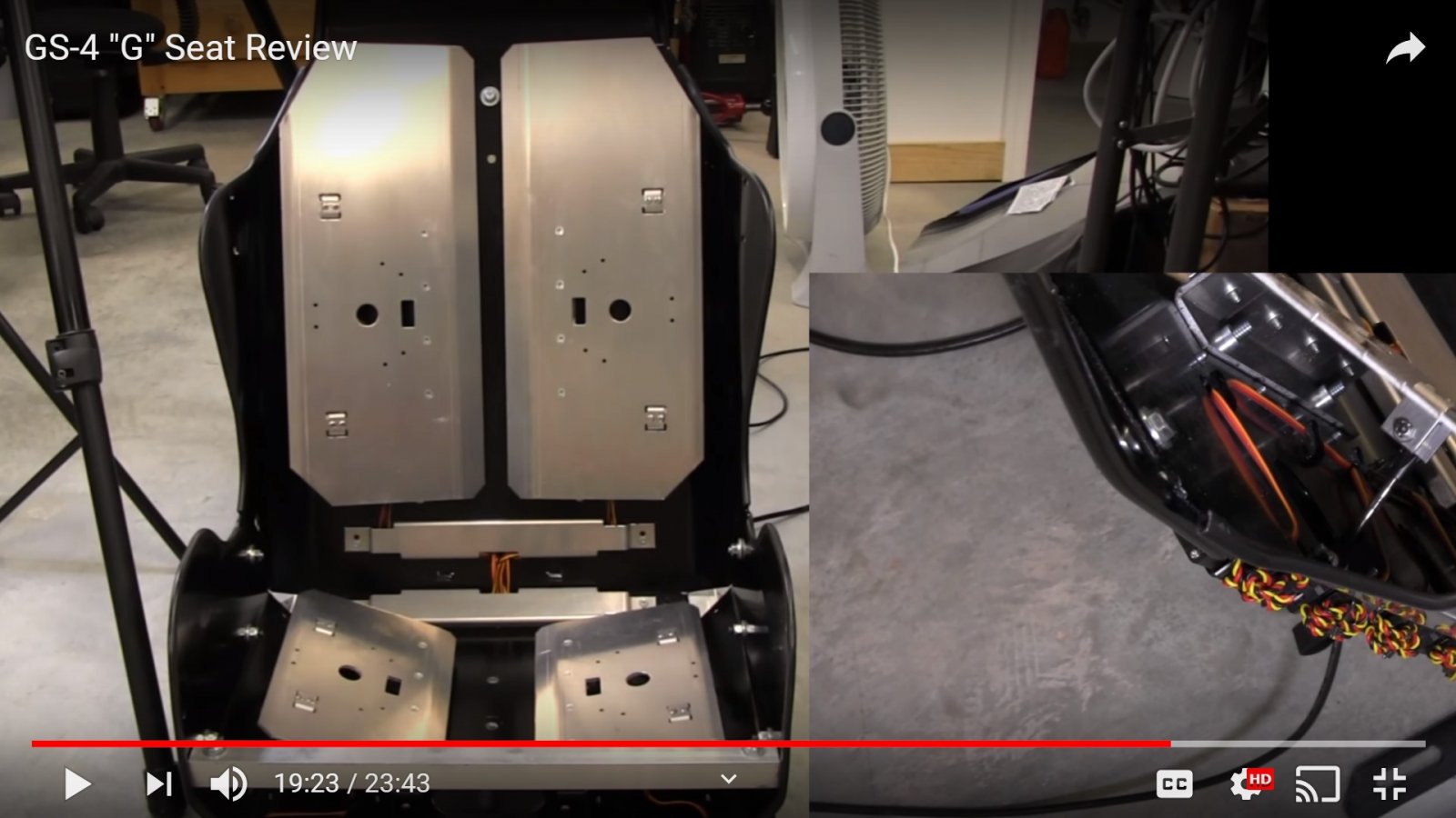

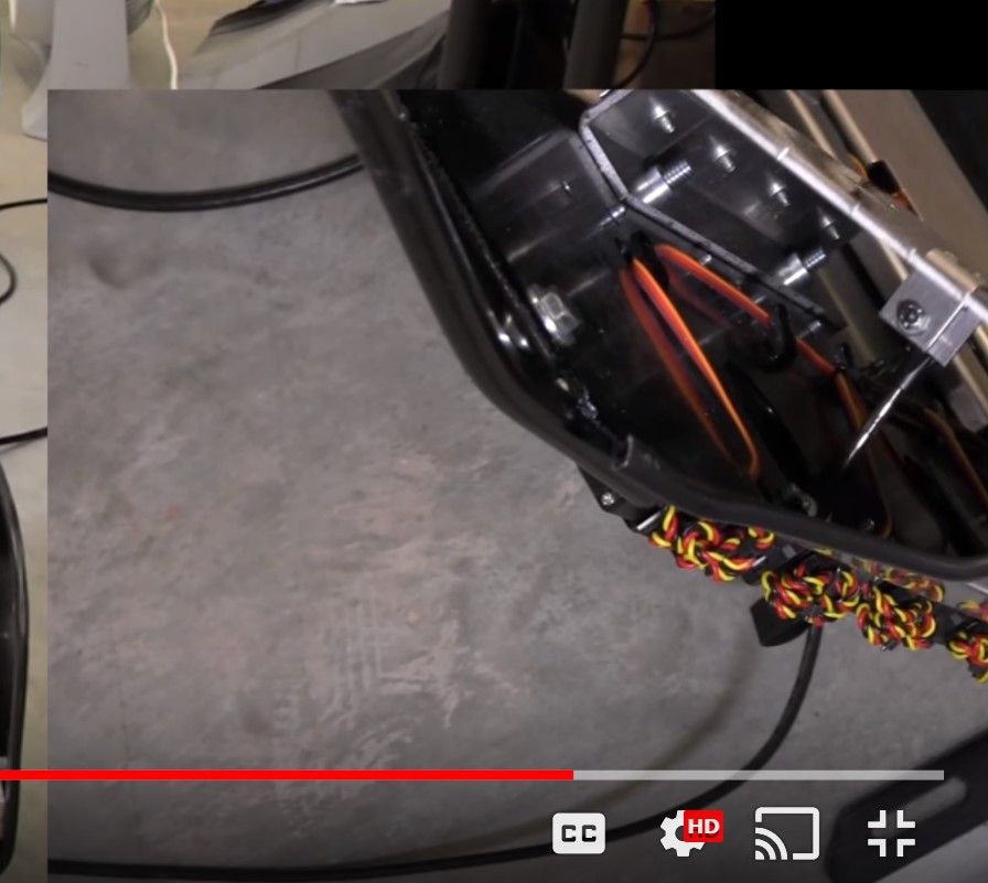

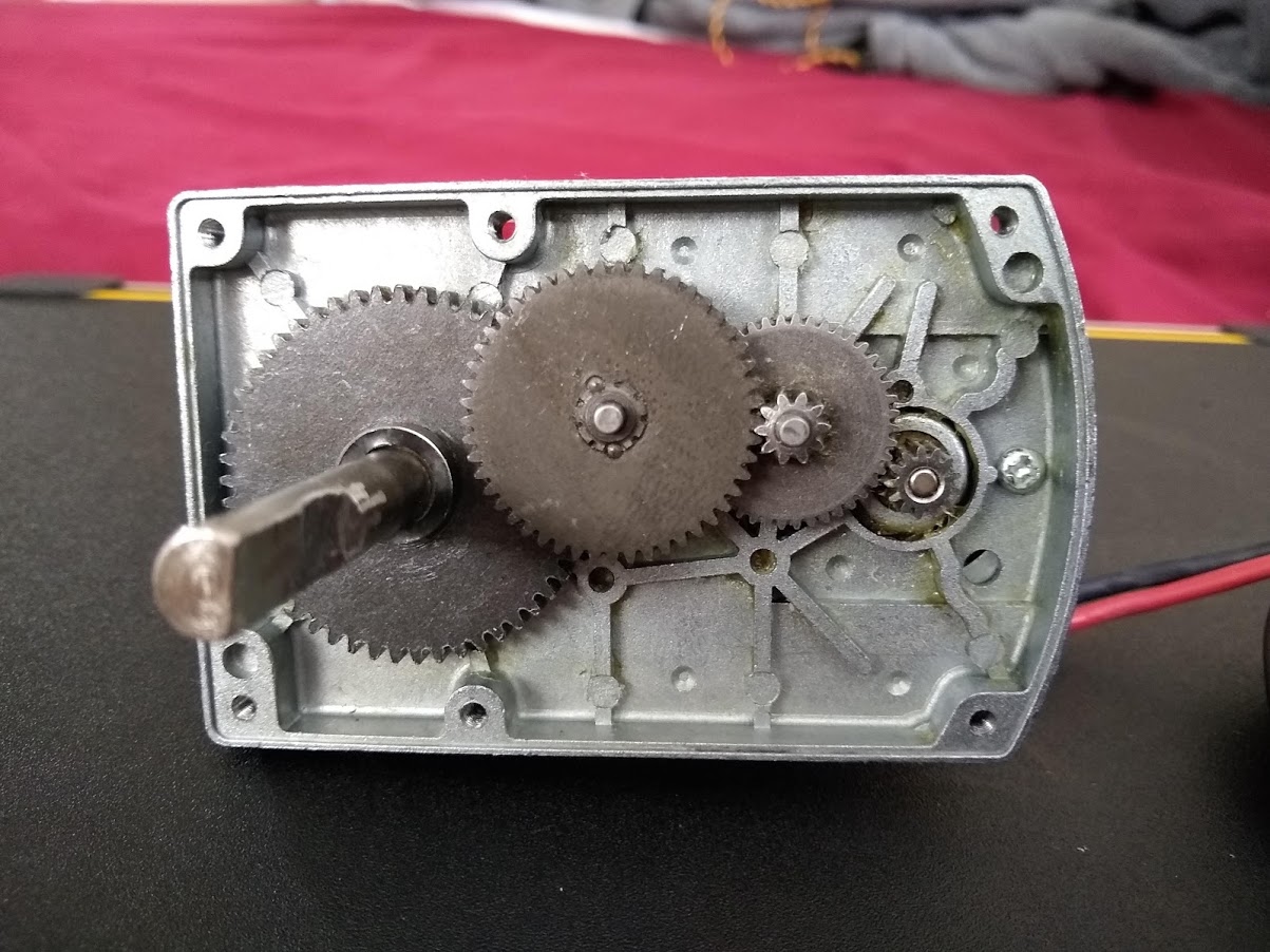

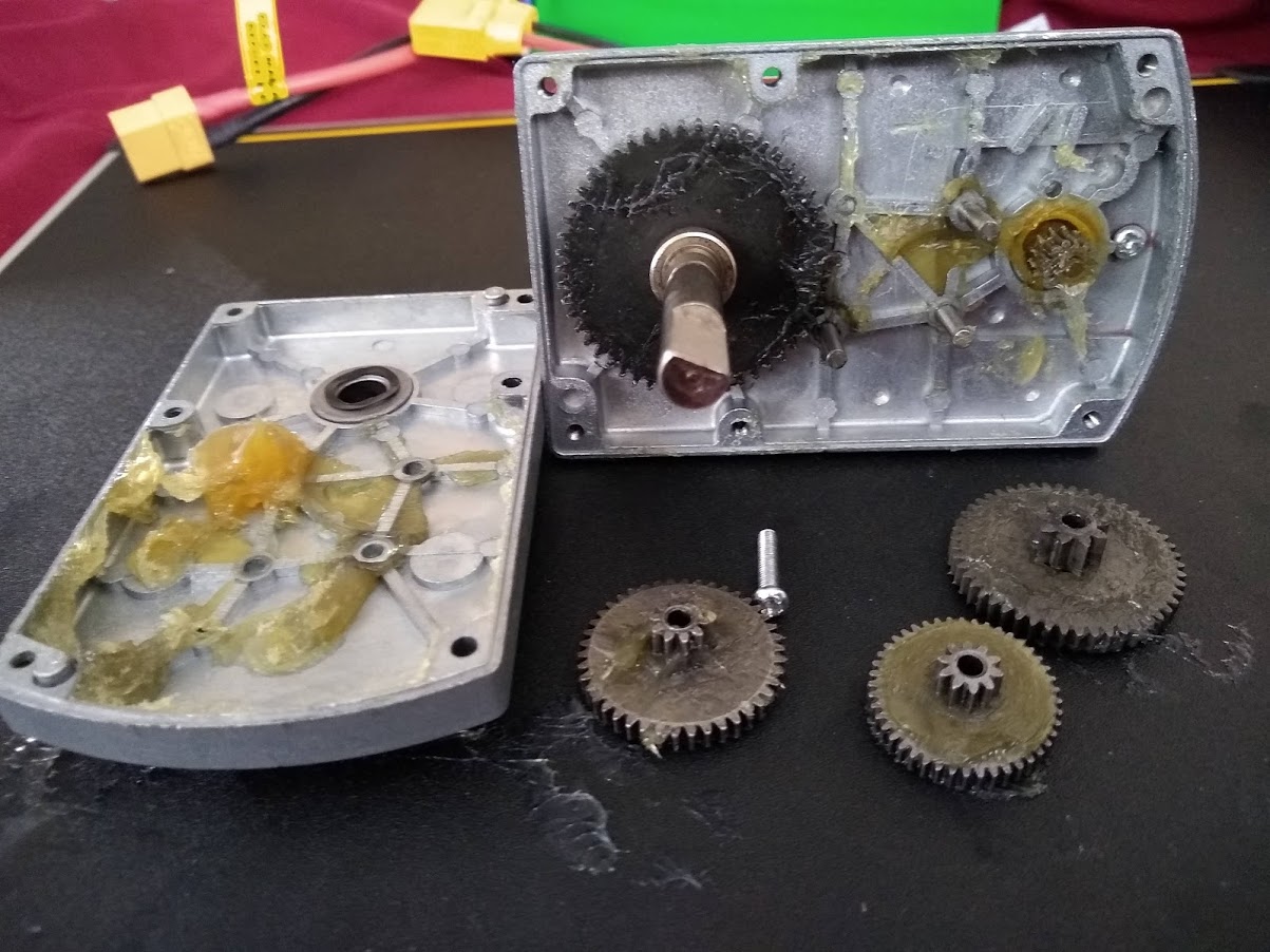

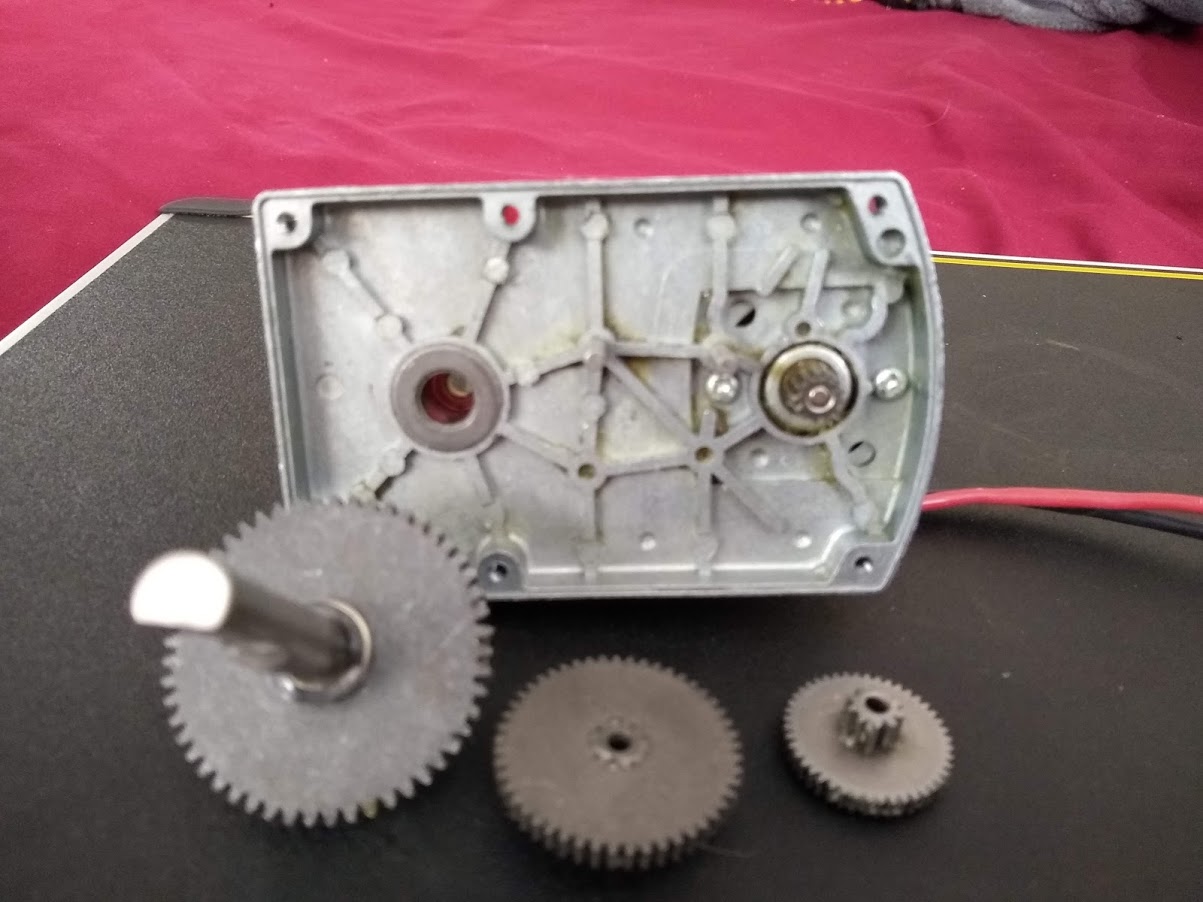

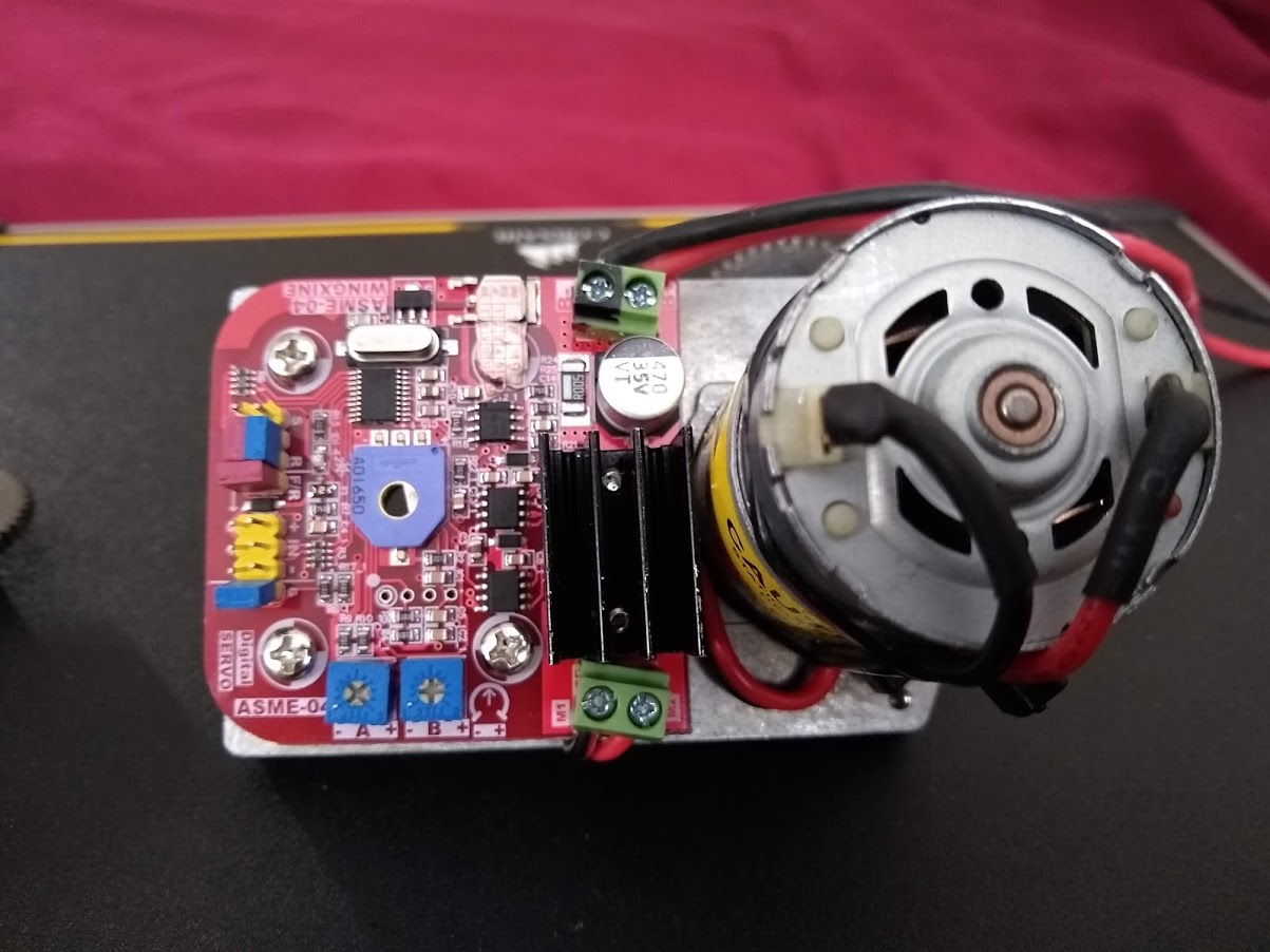

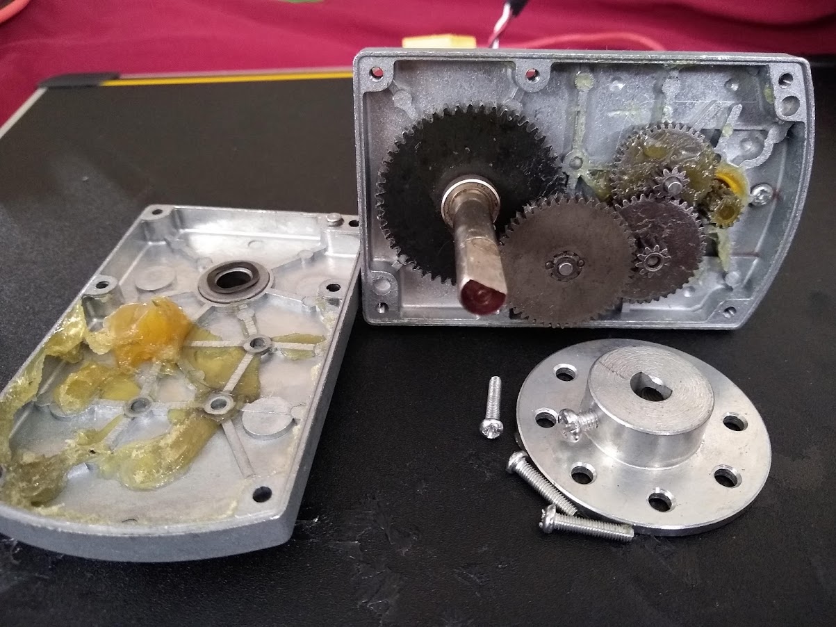

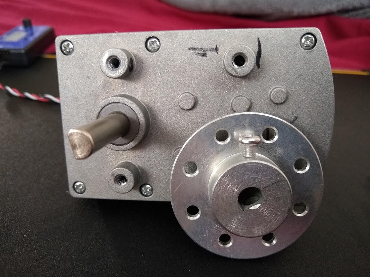

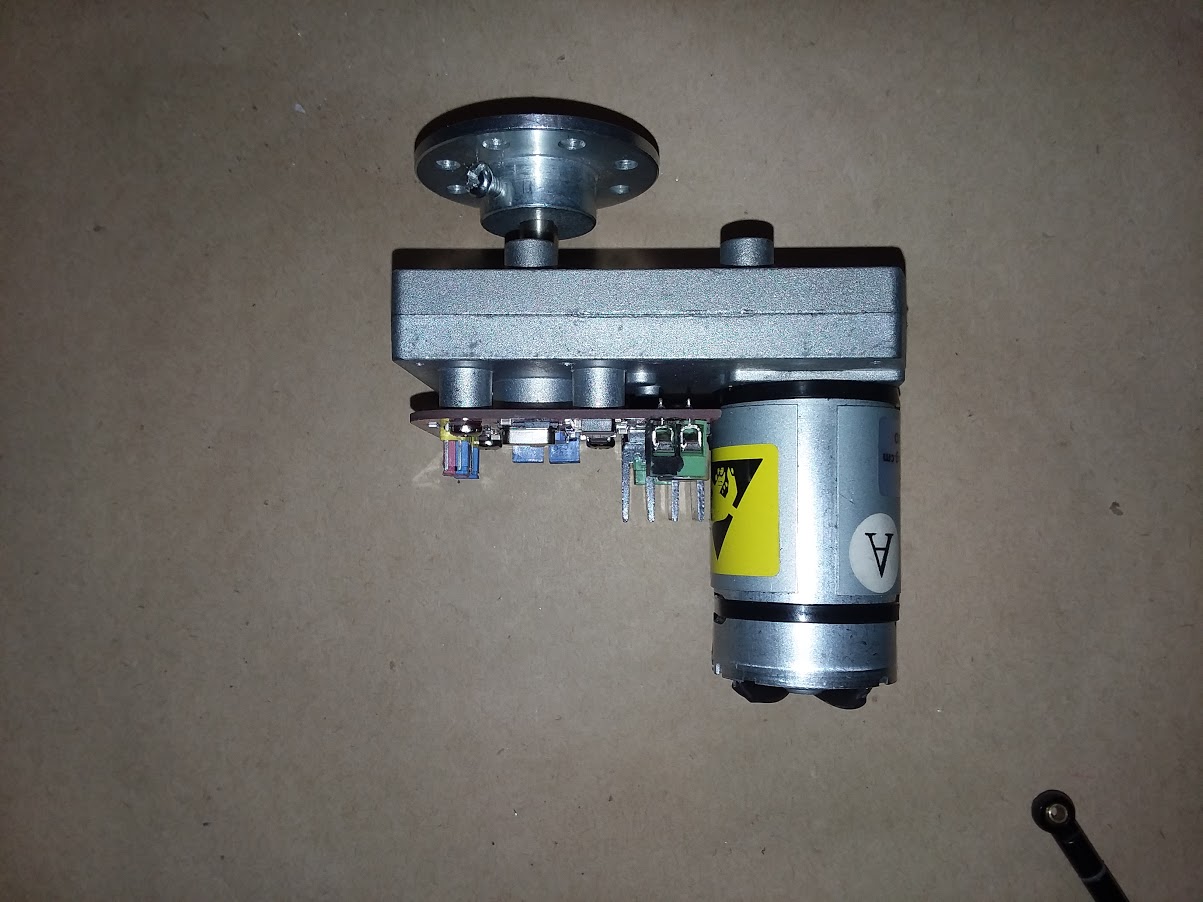

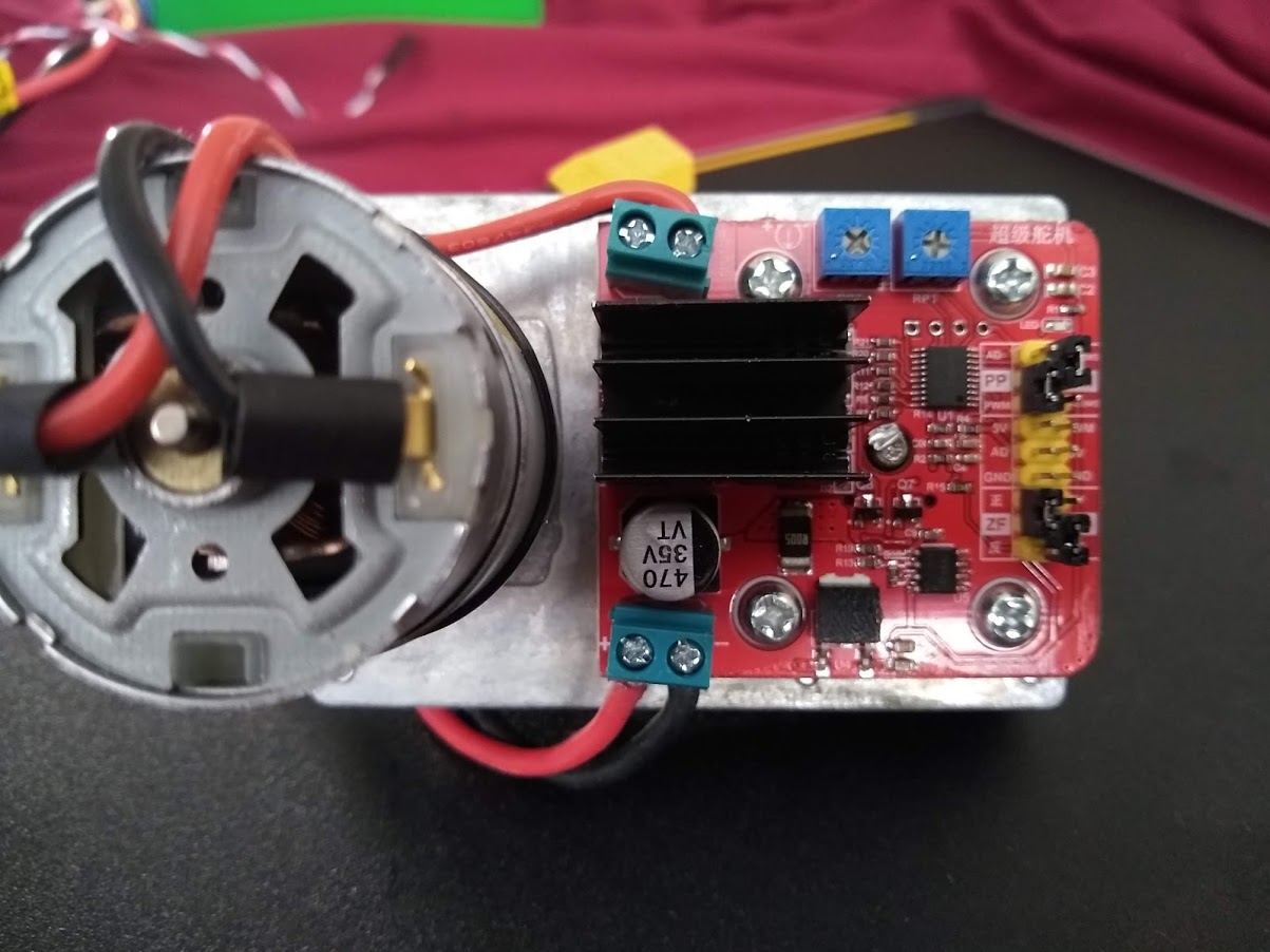

    I thought you might like to see into the 260kg .12sec /60deg @24vdc servos I am using.
    The circuit board on these provide 5vdc for your logic or pwm device. Pot "B" controls the degrees of rotation. Pot "A" is a bit confusing. It might be speed but what ever it does just turn it fully clockwise.
    I did run into a problem with these servos and thought I had received a defective one. The problem turned out to be the colored jumpers making intermittent contact with the pins.
    It shows up as a total fail or worst an intermittent problem .
    It might be best to just solder the pins.
    The F/R jumper does control direction....
    :cheers
    Just plain bearings and degreased for the pictures IMG_201.jpg IMG_06_114644076.jpg IMG_897.jpg IMG_201810.jpg

    I also picked up one of the 380kg/cm @.5sec/60deg servos.
    The control board is not as nice and has no 5vdc output on it.
    There is an extra gear in the train.
    And it was $20 cheaper than the faster WingXine servos.... IMG_3375.jpg IMG_288.jpg IMG_824.jpg

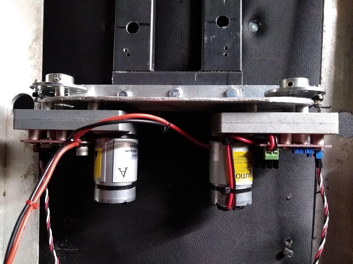

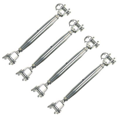

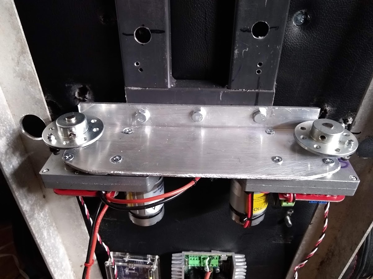

    The Surge / Sway servos are mounted and I have adjusted the paddles for a total of 2" of movement measured at the outside of each paddle. I moved the pushrod attachment point closer in toward the hinge line by about 2 inches. This kept the throw the same while allowing the servos to only rotate 90deg making for a faster response time. I cannot stall out the servos so there is plenty of torque left.
    The pushrods I used are not going to be strong enough and I have some new ones coming this week..
    IMG_20181208_171021741.jpg IMG_20181208_180152180.jpg IMG_20181208_181820080.jpg IMG_20181208_181831901.jpg

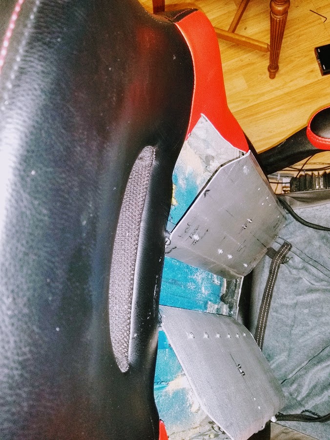

    The surge/sway paddles are installed and adjusted. Overall I like the motion they present. I have only been running it with the NoLimits 2 roller coaster sim which makes it easy since I do not have to provide any inputs like you would if you are driving or flying. The roller coaster sim comes with enough different tracks to vary between extreme motion and a much more gentle effect.
    The most impressive coaster for trying out the new system was where the coaster lays you on your back. It felt real although I was still sitting up..:o:
    The 260kg/cm servos provide plenty of torque. Even with me sitting in the chair and forcing myself back into the paddles they still move with great authority .
    Presently I have them set to about 130degrees of rotation. According to the specs this should give a full travel response time of 250ms . I plan on measuring this in the near future with an oscilloscope and a photodetector.
    I think it will be interesting to see how fast they really need to be....

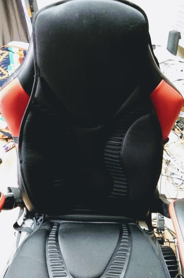

    I bought one of the vibrating car cushions off E-bay.. 10 motors no less .
    It has a zippered back so pulling out all the foam and vibrators was simple.
    You are left with what appears to be a very durable cover with a thin foam backing. The thin backing contains some carbon fiber tow used as a heating element. Its totally ineffective but the foam coating they used to seal it is near perfect for just enough padding.
    I also bought a low cost automotive car seat cover.
    No padding but still works great. Cheap and simple.

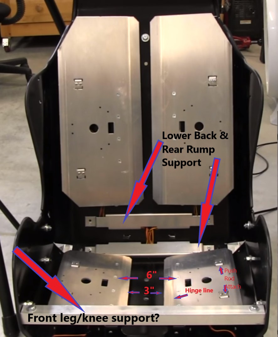

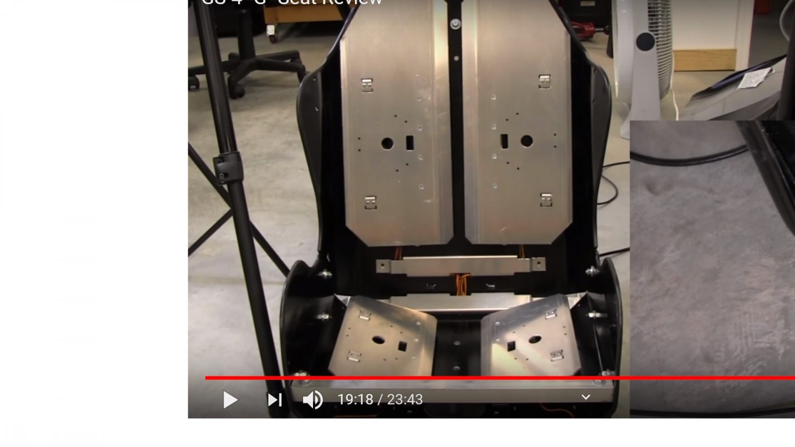

    I am preparing the heave installation. How I wish I had a real drawing of the GS-4 Seat to work off of. The best I can eek out of available videos is the seat is 17"wide. This pretty much puts the paddle width at about 6.5" total width. Inside bevel 1" and bent down 20-30 deg. Outside bevel .5" and again 20-30 deg bent down. I assume this allows the paddle to slide over the cover easier and maybe more comfort to the pilot.
    So this will be my starting point. :think seat5.jpg
