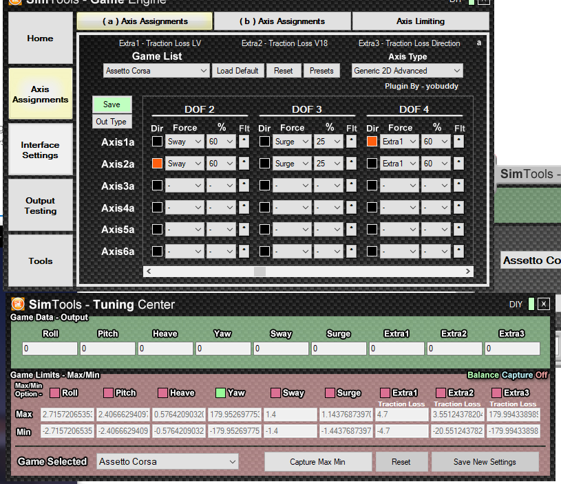

    Got my G seat tuned pretty well to AC now and i see its a very fine balancing act in tuning center with the Sway and Extra1. I can get a reasonably good feel of the lessening grip and tune that a bit up and down but im having some trouble with getting it to give me a bit of a kick when the rear end wipes out. Is there any tips you guys could give me? Im not using any filters on the axis

    Looked into it. Yaw just takes the orientation on the track so if im not mistaken i cant use that. i havent done any testing with it however but by a quick glance i dont think i can
    As for washout and gain im fairly sure i cant use that either as im feeling my grip with the pressure from the G seat. I suppose its a limitation. What i need is for the Extra to stop at a boundary so that i keep my progressive feel but snap out the last say 15% once it passes a value where the cars rear actually lets go so i can catch it.
    Im guessing it could be possible to combine the two if the yaw follow the cars orientation relative to its forward motion (or something like that) and not its orientation N W S (when looking at the virtual axis) and so on the track. It also just seemed to press one flap forward
    Its a bit late for lots of testing now so ill look at it in the morning and depening the plugin may need an update
