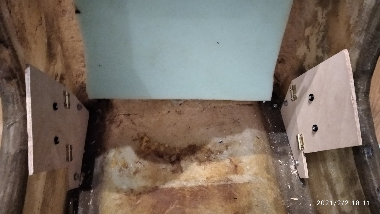

    Now I am printing some pieces in 3d to make the assembly firm, I will upload photos and stl.

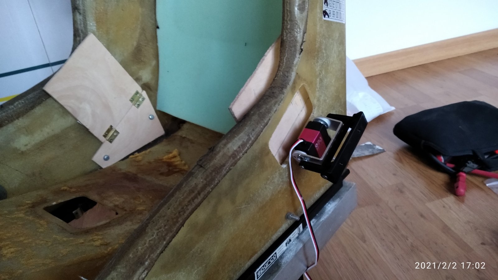

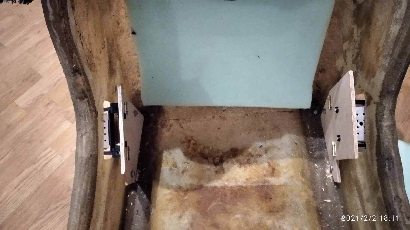

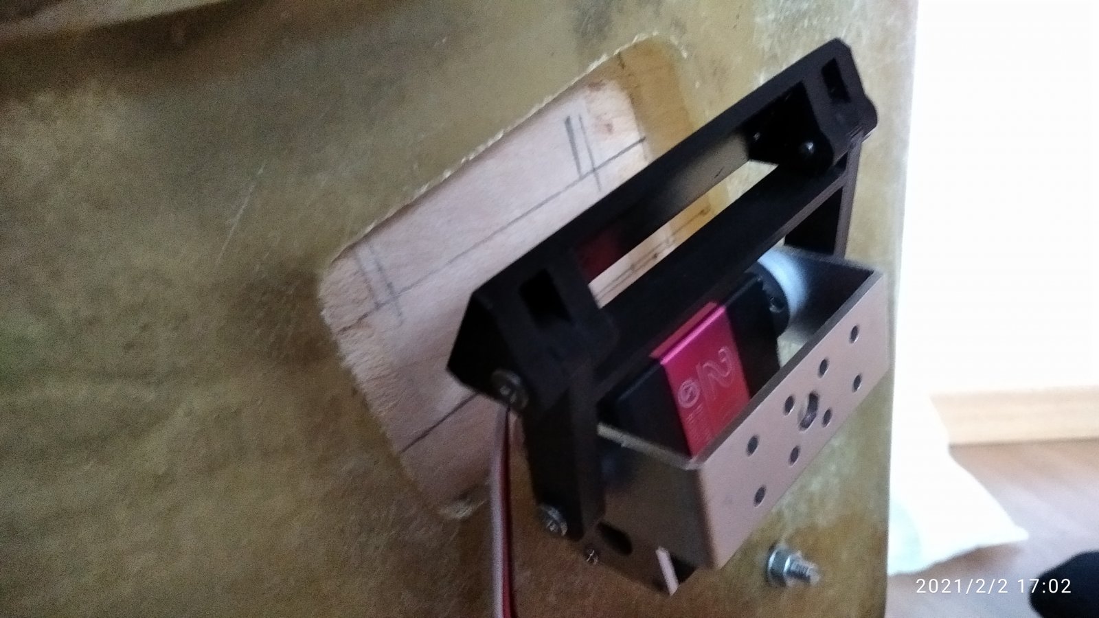

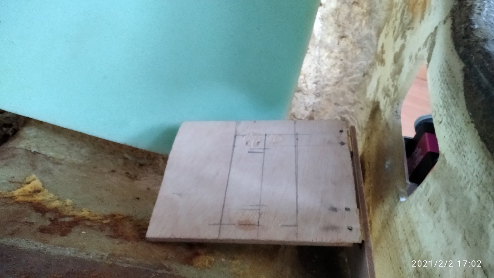

    Concept:
    Develop a sensitive G-force feedback system that is inexpensive and simple to manufacture and assemble on a backet seat.
    Sensations:
    Surge, X-axis. An actuator on the back cushion.
    Sway, Y axis. Two actuators on the hips. An actuator to the right does the + Y thrust. A left actuator does the -Y push.
    Heave, Z axis. An actuator under the knee pad.

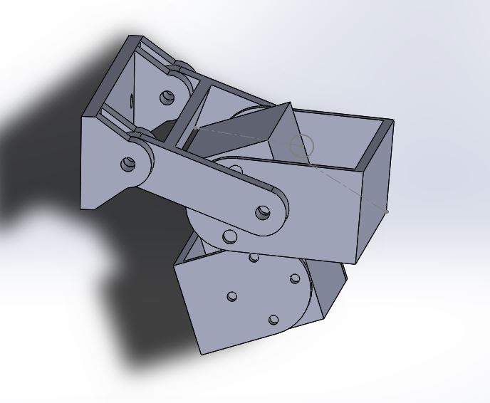

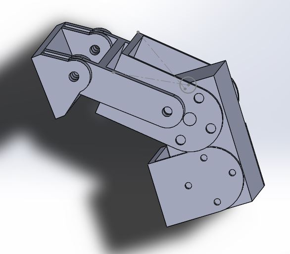

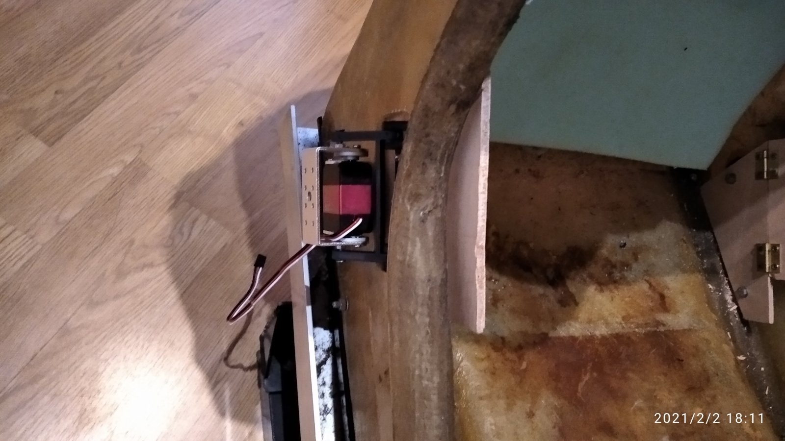

    Mechanics.
    Each actuator moves by double crank mechanism, converting the rotation of a servo into linear thrust motion on a paddle that is hinged to the seat frame.
    Photo of the montage in 3D design.
    Minimum Position
    Maximun position

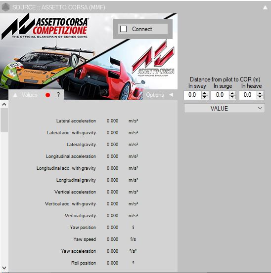

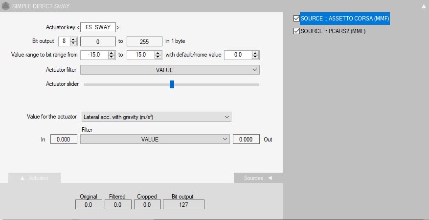

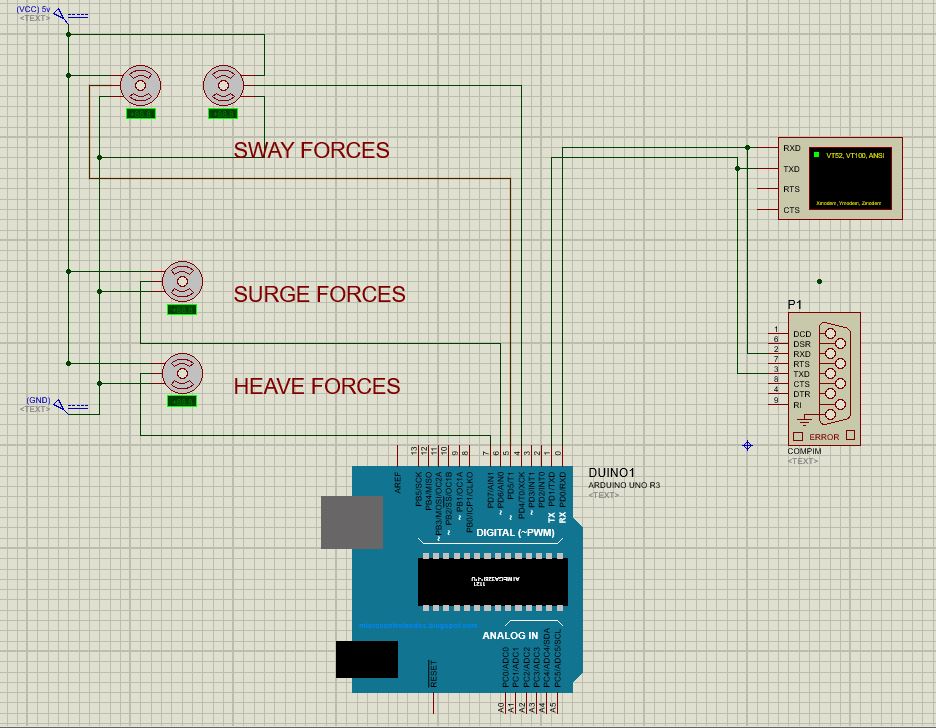

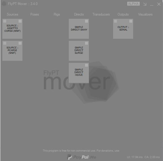

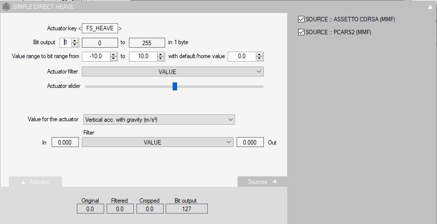

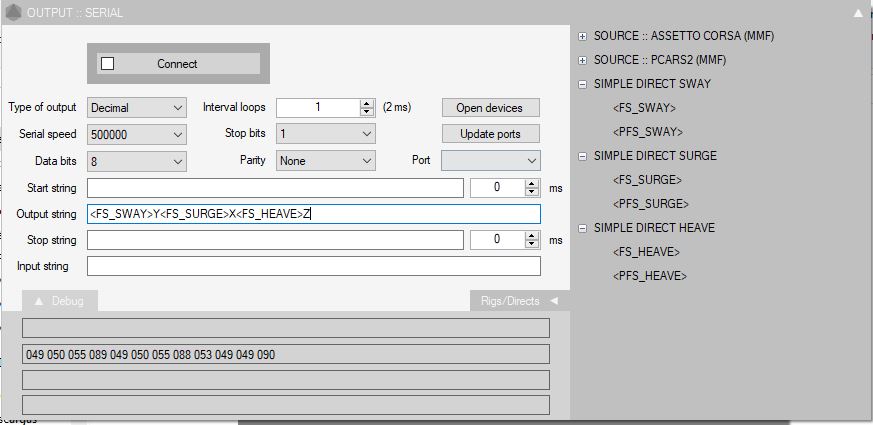

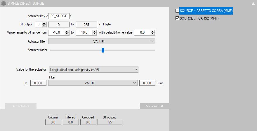

    The XYZ coordinates that simtools sends through serial communication are received through arduino.
    In principle, the sketch that @aerobbie spread was studied, and I rewrote all the code according to my needs.
    Basically simtools sends <axis1> X <axis2> Y <axis3> Z.
    Arduino receives those byte-size parameters and positions the servos at the corresponding angle within a set maximum and minimum.
    Paste arduino code.

    WIRING
    Test and travel adjustments.
    Each axis is associated with a servo and each servo moves in an interval, the minimum angle corresponds to the value 0 of the axis and the maximum angle corresponds to the value 255.
    Using the serial terminal of the arduino IDE, simtools communication is simulated and the maximum and minimum value of the corresponding variables is set in the sketch. These variables are used in the mapping function.
    Mounting the elements to the seat.
    Left hip paddle detail
    Left sway servo
    Minimum position of servos
    Maximun position of servo
    Post in progress, I will edit and post wiring and more details

    The failures are also posted of course.
    The servo profiles reach the seat frame before the end of their travel.
    This has happened to me twice, while I was distracted modifying the code, adjusting the travel limits ... the servo was forced on the seat and it gets quite hot.
    The outcome is two fried servos. At least they are very cheap, but if I keep cooking servos this will become more expensive than a platform with a wiper.
    There is a Spanish saying that says ..
    "Everything happens to him who cooks and kneads."
    My boss listens to that saying a lot.
    Am I the only one who has fun burning electronics?
    Should I ask for medical help?
    Who cares, I'll have to buy a fire extinguisher.

    More code improves
    added functions to convert rotational to lineal movements
    added start comands for max and min angles of axis
    max angle X <0 to 270>Mx; min angle <0 to 270> mx
    max angle Y <0 to 270>My; min angle <0 to 270> my
    max angle Z <0 to 270>Mz; min angle <0 to 270> mz
    i.e. 1mx 270Mx 1my 270My 1mz 270Mz
    This version uses servo.h, it moves servos one by one
    Code:

          while (Serial.available() > 1)
              serial_data = Serial.read();
              if (isDigit(serial_data))
                    val_ST += serial_data;
                    cmd_ST="";
              }else //if (val_ST !="")
                    cmd_ST = serial_data;
              if (cmd_ST=="Y"){
                    Move_YServo();
                    val_ST="";
                    cmd_ST="";
              if (cmd_ST=="Z"){   Move_ZServo(); }
              if (cmd_ST=="X"){   Move_XServo(); }
              if (cmd_ST=="Mx"){  X_max_ang = Lim_Servo(val_ST); }
              if (cmd_ST=="mx"){  X_min_ang = Lim_Servo(val_ST); }
              if (cmd_ST=="My"){  Y_max_ang = Lim_Servo(val_ST); }
              if (cmd_ST=="my"){  Y_min_ang = Lim_Servo(val_ST); }
              if (cmd_ST=="Mz"){  Z_max_ang = Lim_Servo(val_ST); }
              if (cmd_ST=="mz"){  Z_min_ang = Lim_Servo(val_ST); }
           //MOVE SERVOS TO READED POSITION
              CRCArduinoFastServos::writeMicroseconds(servo1,uint16_t (val_YLSP));
              CRCArduinoFastServos::writeMicroseconds(servo2,uint16_t (val_YRSP));
              CRCArduinoFastServos::writeMicroseconds(servo3,uint16_t (val_ZSP));
              CRCArduinoFastServos::writeMicroseconds(servo4,uint16_t (val_XSP));
             // myservo2.write(val_YLSP); // sets the servo position according to the scaled value
             Serial.println(val_YLSP);
             // myservo1.write(val_YRSP); // sets the servo position according to the scaled value
             Serial.println(val_YRSP);
             // myservo3.write(val_ZSP);                  // sets the servo position according to the scaled value
             // myservo4.write(val_XSP);                  // sets the servo position according to the scaled value

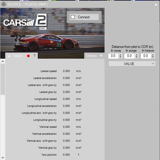

    This is the config for Flypt. uploaded fash.mover.rar
