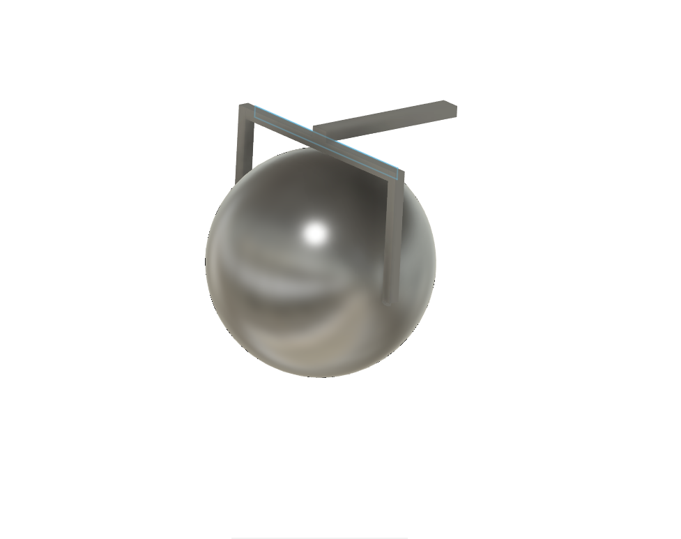

    I've decided to start my G helmet system. It will be adjustable for width to easily accommodate either a helmet or fks a pimax HMD. It will most likely use gopro attachments for the sides so its easy to click in and out of and changing gear for VR/triples.
    Here's my train of thought at the moment.
    It uses 8020 profile
    It will have rigid frame that will just fit your head and is adjustable. This way you wont have it dragging the HMD around if you are using that. With a helmet the fit isnt as important. Ive added some extra foam to the DAS on my Pimax.
    It will have either a U joint (ill most likely use this one) to allow the head to tilt a little . I'll have to experiment with that or a static bearing. Main thing is that you will be able to turn your head. I will also 3 print some pads to spread the load and get around the headphones on the DAS.
    Here's the general layout but it will have a setup for moving back and forth and from side to side. Most likely using springs for extra dampening and some safety between the motors and the frame itself. It will also have physical stops. Since i dont have actuators i need to figure out the best way for it to move on a plane without tipping up or down. Ill have to experiment with this. Another thing i'd like to add is a flip up system with a quick slide lock for getting in and out without much hassle.
    Here's the general idea

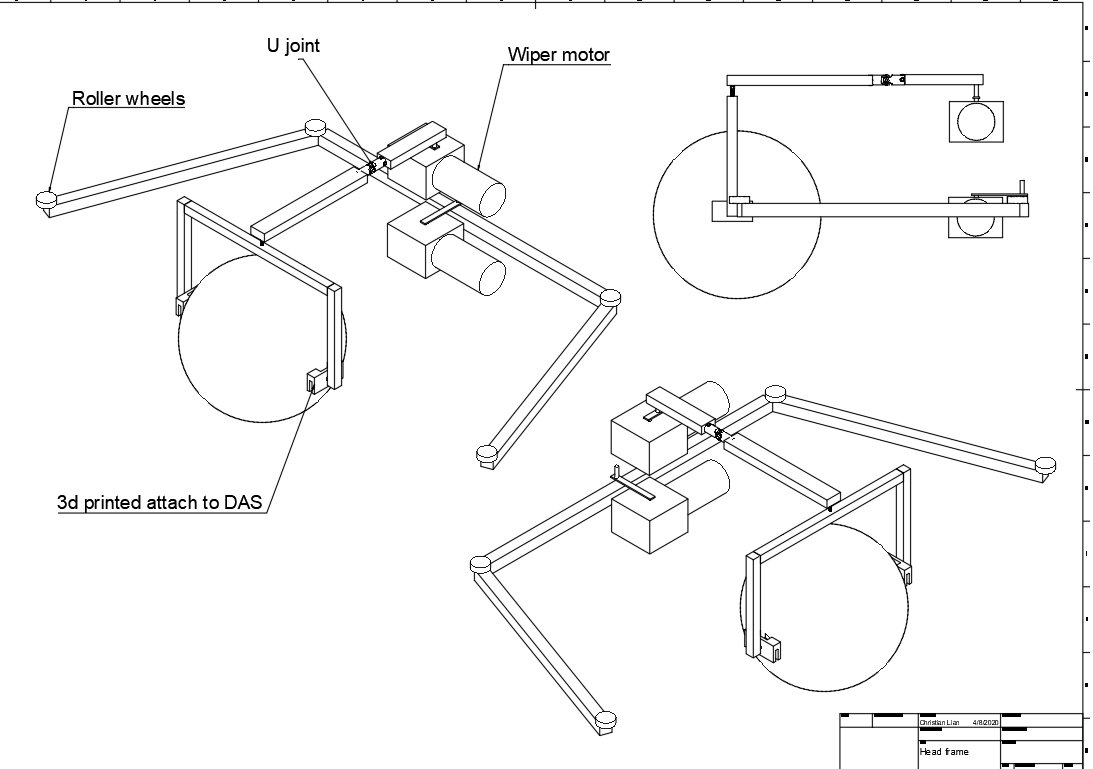

    Current design. Getting parts next week so ill design some brackets for the motors and everything else for 3d print. Motors may be changed at a later date
    Here's a sketch of the preliminary design. I decided to go with a thread and spring based design for the sides as its easier to do in relation to Surge. I may 3d print a U joint, grease it up and cover it with a Ninjaflex flexible filament cover while i wait for a metal one

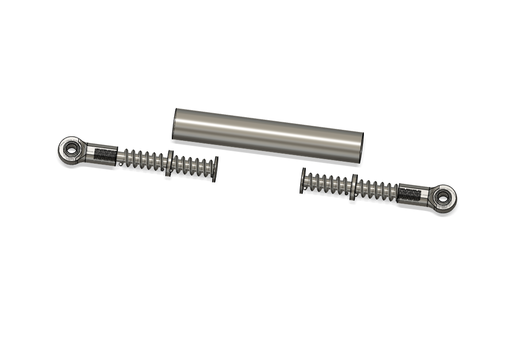

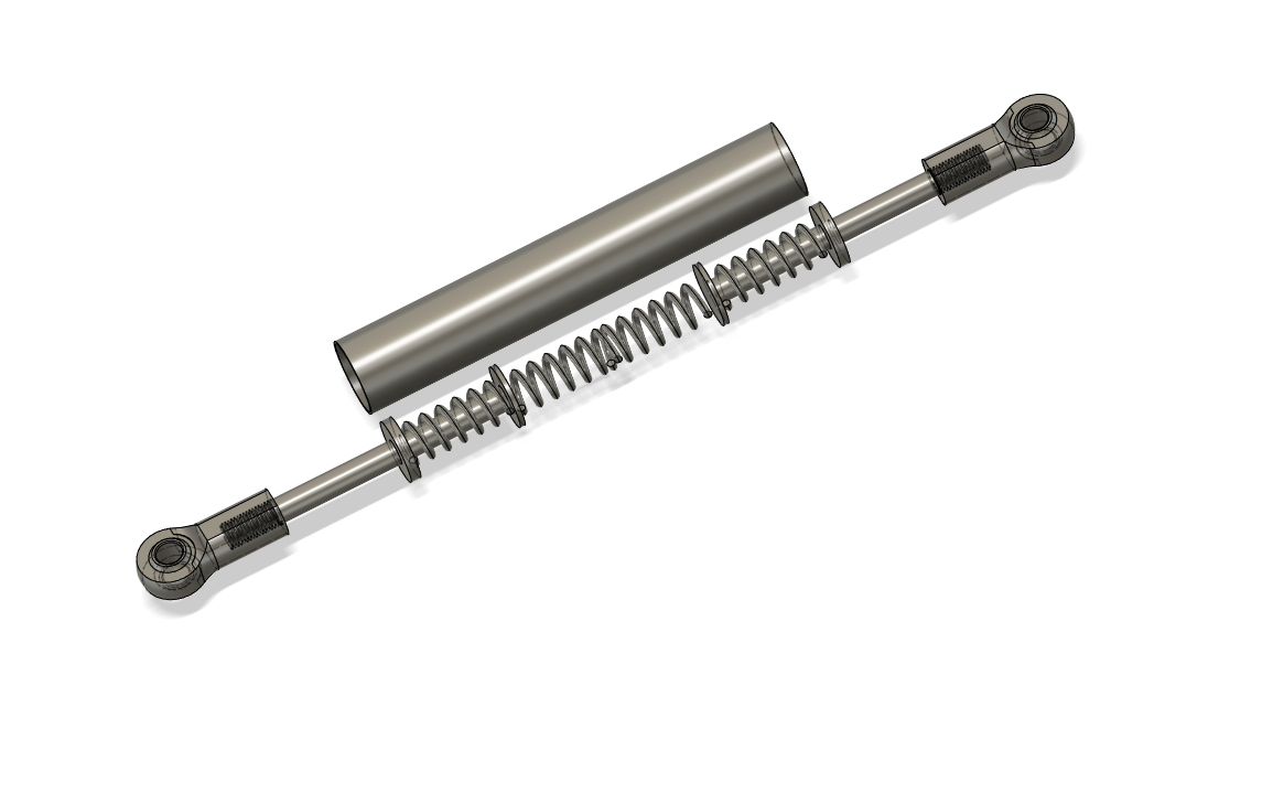

    if split the rod in the middle inside the housing and have some preload on each of the springs. I probably need 4 to make this work or 3 with one in the middle. And using a weaker spring ( the outer ones) inside for acceleration. Conical springs is also an option for a compact solution

    How do your springs limit torque or do they provide the torque?
    I use springs also but it appears for a different reason. I use torque only motor drivers therefore when a force ceases there is not a return to what would be considered neutral position because positional feedback is not present. In real life your head naturally snaps back to a position that feels natural and that's how my system works too. However there is some inherent resistance to movement in my actuators drivetrains so I use springs to provide just enough counterforce so your head doesn't feel a resistance when righting itself.
