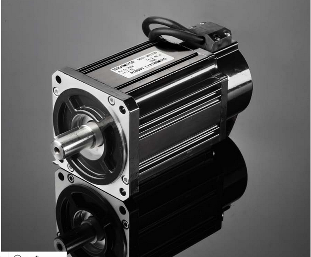

    Hi I found 750w servo motors for $ 150.00. I do not have experience in building YES, but I think this servo motor is a good option.
    Product Description
    Specifications
    1. AC Servo Motor
    2. Frequency: 50 - 60Hz
    3. Voltage: AC220V
    4. Power: 750 -1000 W
    5. Speed: 2000~3000r /min
    type: 750w servo motor and controller
    Motor model
    90ST-M03520
    Rated power (W)
    750W
    Rated rotation (r/min)
    2000
    Rated torque (N. M)
    3.5
    Maximum torque (N. M)
    10.5
    Rated line current (A)
    Rated line voltage (V)
    220
    Rotor inertia (Kg. M2× 10-4)
    3.4
    Brake
    Coder line number (PPR)
    2500
    Torque Coefficient 1.2
    Weight (Kg)
    3.8
    Insulation grade
    CLASS B
    Rating
    Continuous
    Ventilation protection
    Completely sealed, self cooling
    Installation mode
    Flange (60, 80, 90 110, 130)
    Protection Class
    IP65
    Operating environment
    Indoor, lower than 1000m, no corrosive and inflammable gas, dust and oil mist
    Ambient temperature and humidity
    Environment temperature: -20° C ~+40° C; Relative humidity: <90% (no condensing)
    Please inform if it is a good application for simulator 2 dof

    If I'm reading "right", the maximum output in ft.lbs. = 10 - Not enough torque to move very much.
    I'm using AC motors 1hp/60:1 Gearheads and my output in 113 ft. lbs., quite a difference.
    Some of the heavies here may be more informative, but I would never use a servo or motor/gearhead that would only put out 10 ft.lbs. torque.

    But couldn't put a gearhead on this motor?
    Say a 30:1 and you would get:
    ~300 ft-lbs listing power at about 66rpm?
