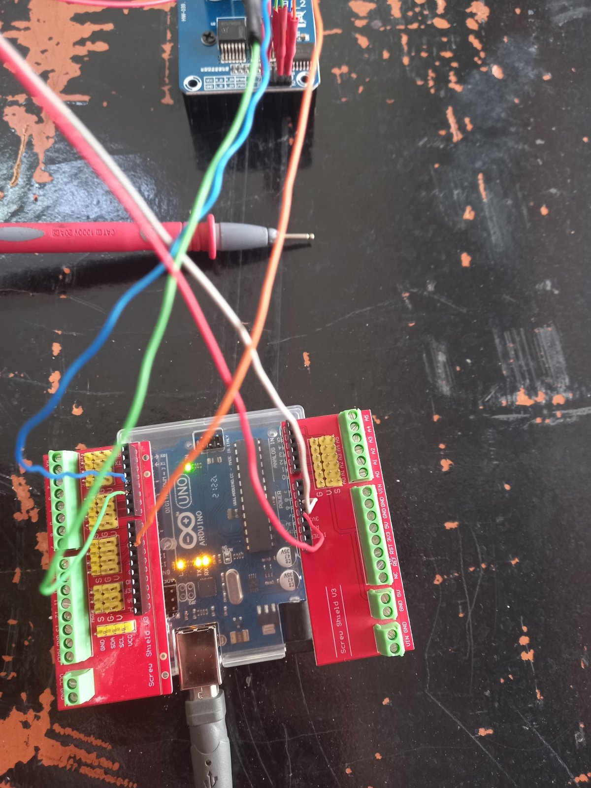

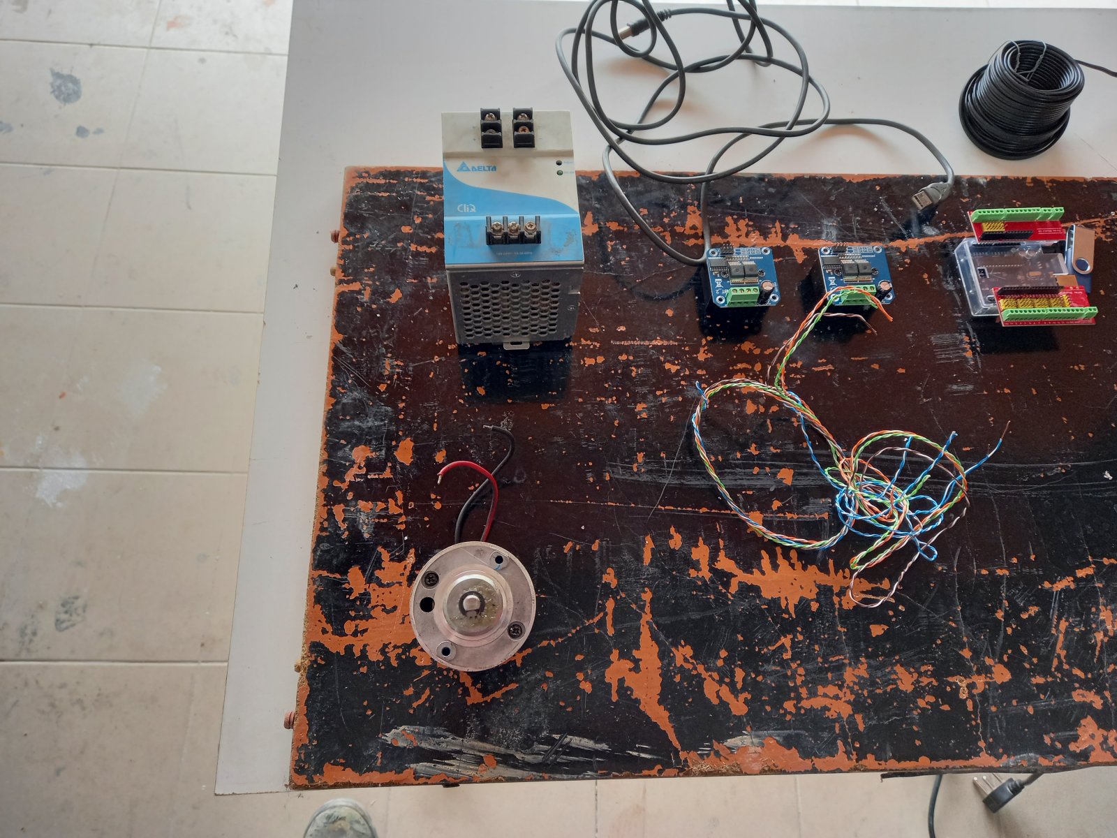

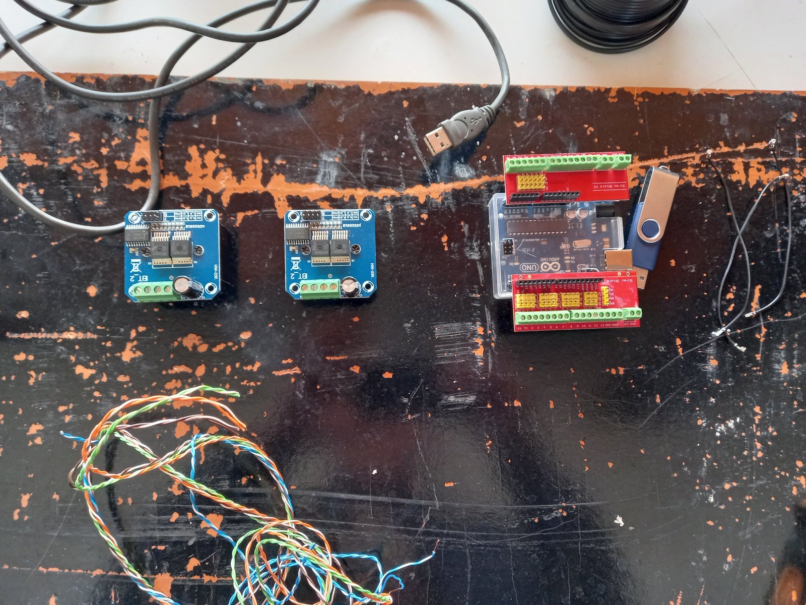

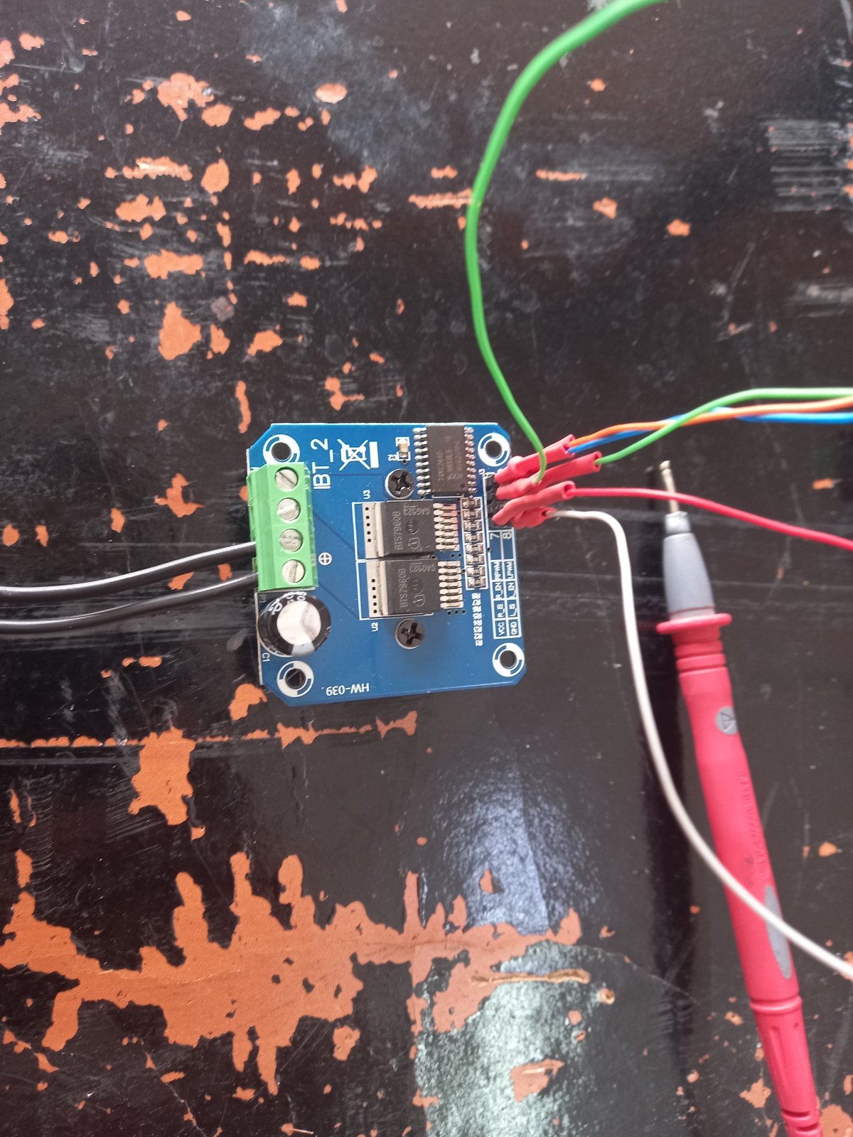

    Starting .... smc3 utility setup and test ... will update soon as I have it wired and ready to move.... very excited

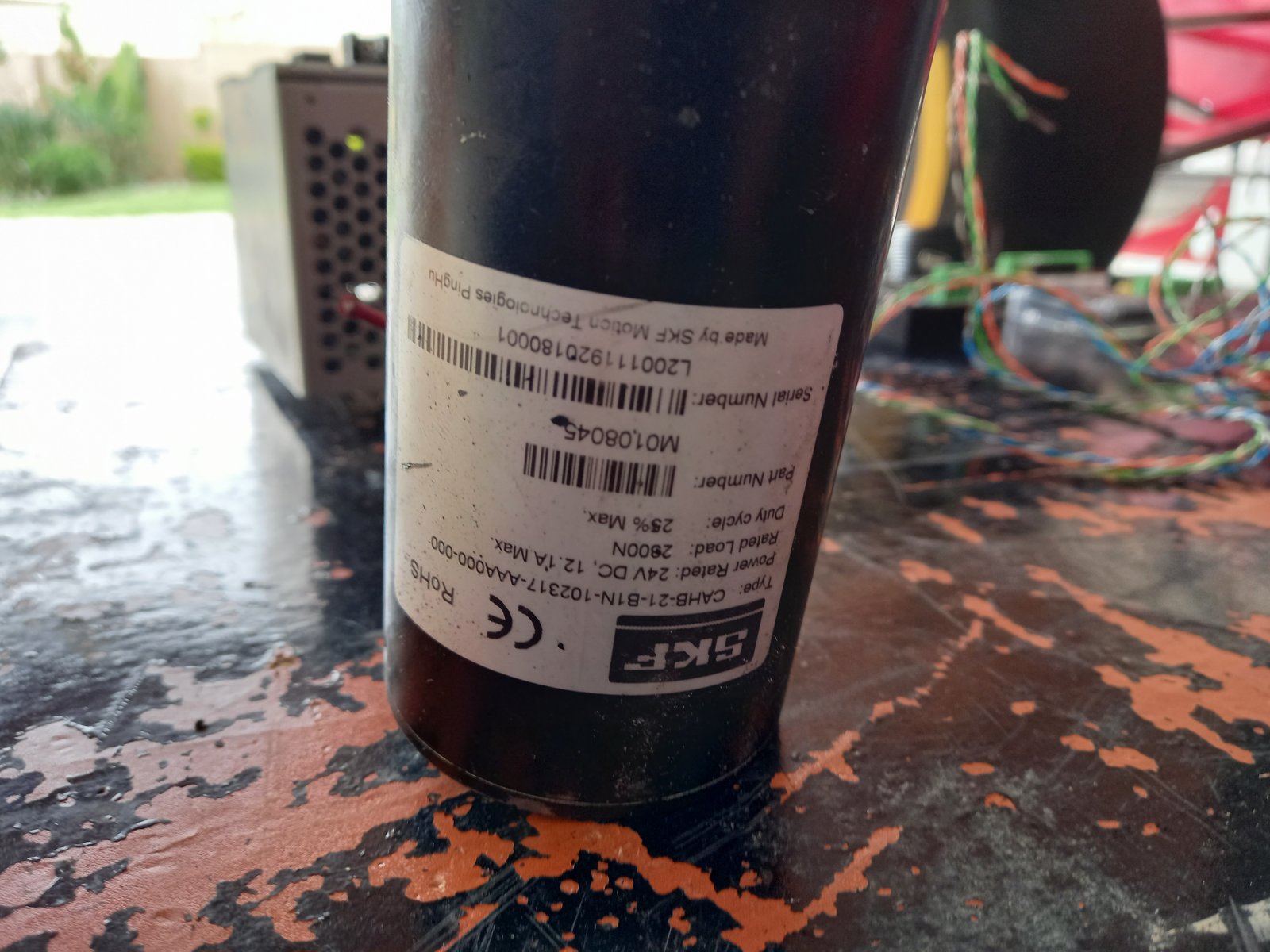

    This might be a stupid question.... but when I'm testing this setup with smc3 ... must the pot circuit be complete for me to get voltage output from my ibt2 driver I'm just running a DC motor just to get the setup right ... my encoders are wired in to my rig ... do the encoders have to be wired in
  3. Gadget999
    1,952
    11,941Coins
    +483 / 10 / -0
    smc 3 does not work with encoders - it uses potentiometers

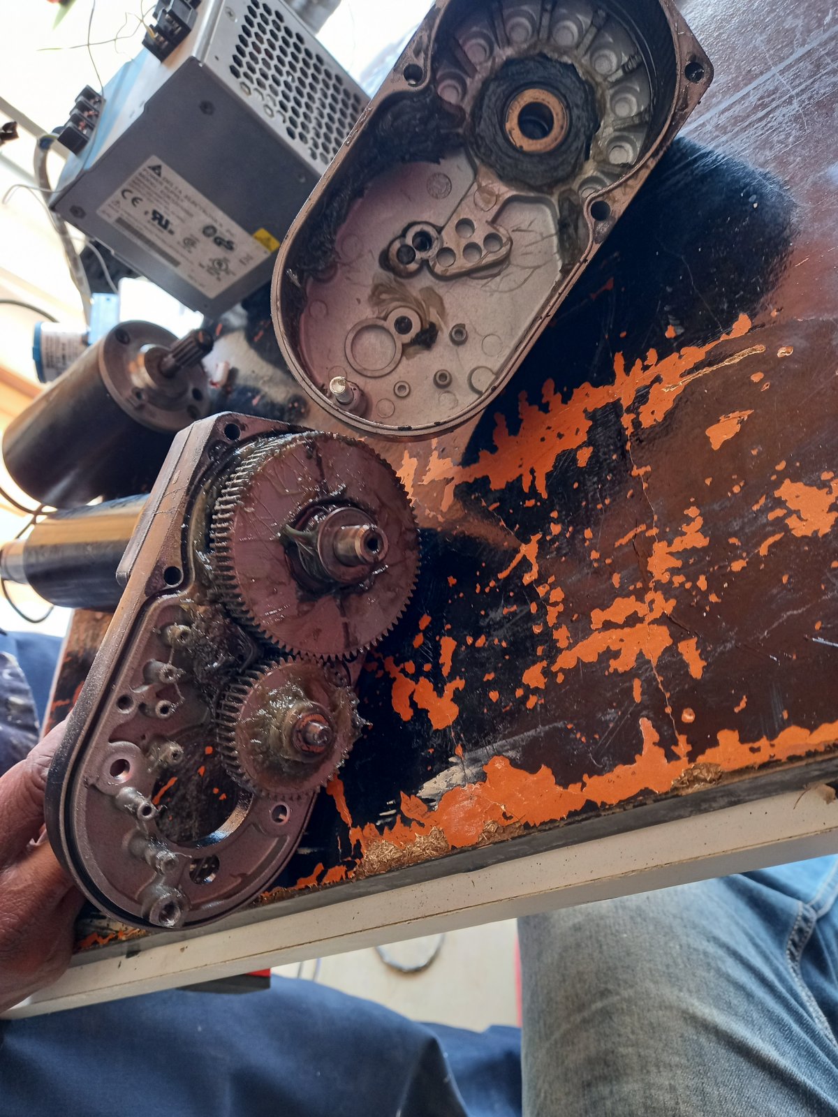

    your motors are only 1 amp - what sort of gearbox do they use ?

    Hi thanks, Gadget999 ... not sure of the gearbox ratio and spec will get them threw the day,, I'm exploring, a different easier way for me to integrate the positioning feed back ... would I need to change any type of code if i need the system to get positioning feed back from the encoders... thanx Gadget999...

    OK I got 2 pot 5v 10k I see that smc reading the feed back
  8. Boris Furtak
    Boris Furtak Member Gold Contributor
    Oct 11, 2021
    57
    160Coins
    +10 / 0 / -0
    Still no movement
    21,494
    150,584Coins
    +11,017 / 55 / -2
    Have you followed the SMC3 setup guide?
  10. Boris Furtak
    Oct 11, 2021
    57
    160Coins
    +10 / 0 / -0
    Thanks to all for advice and guidence I have got movement from the smc3 utility hardware communications good ... ready for the next step
