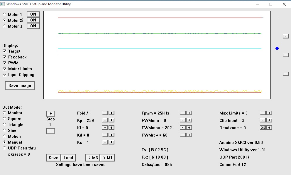

    Hi guys
    At first i wrote this off as some flukes but its becoming more and more of a nuisance. Its happening far to often. Everthing seems highly unstable.
    At first, 2 was connected to a usb hub. Next, all Ardunios have their own cable directly into the computer via usb2 into usb 3 on comp.
    x2 Ard + Sabertooth 2x32 back and bottom.
    1x Ard + China 50 amp bridge. Belt tensioner
    One flap will stop working. Need to go to SMC to get them back
    Both flaps will stop working. Need to go to SMC to get them back

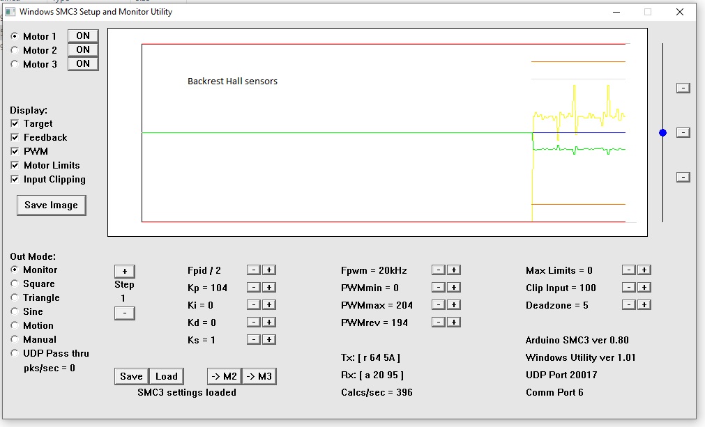

    Backrest flap will oscillate, either right or left side, it varies. This only happens in the back where i have the hall sensors. So i suppose it has something to do with that but the mounts are very solid and ive put a 5 DZ in the SMC app. This can happen even when the flaps has been power off all session and then being turned on straight into oscillate. thats the strange part. If they didnt i would just have left it to vibrations and overshooting.
    I have tried adding interface output to 15 MS for the backrest. No real change.
    I have a usb disconnect/connect log. Nothing happening there.
    I have watched the SMC graphs for quite some time and cant see any spikes that can result in it shutting down the axis.
    Im at loss as to why this is happening and what i can do about it now.
    Is there any logs?
    Is there any way to test the different things that i can do to troubleshoot?

    In the mean time I've noticed halls will fluctuate more when they don't receive a strong 5v. Check your soldering and make sure you don't have any "cold" joints. Another thing you can try is powering the pots from the Sabertooths 5v power output instead of from the arduino. It can supply 1a vs. arduino .5a and its not powering other stuff too like the arduino itself.

    For the back im still tuning and it seems to be some kind of information overload that makes it kick out and stop working. The best results are if i reduce the heave to 10% axis and keep 60% sway 30 surge. The surge can however still cause it to stop if i slam the brakes on the car or cause some sort of spike. Im guessing it just cant react fast enough and perhaps dependent on the load on the motors aswell as the bottom ones are rock solid with very fast movement over bumps. So much so that ive slightly sick in VR for the first time in a year.
    On a side note the hall sensors are very noisy so that can have an effect. Ill be trying pots tomorrow.

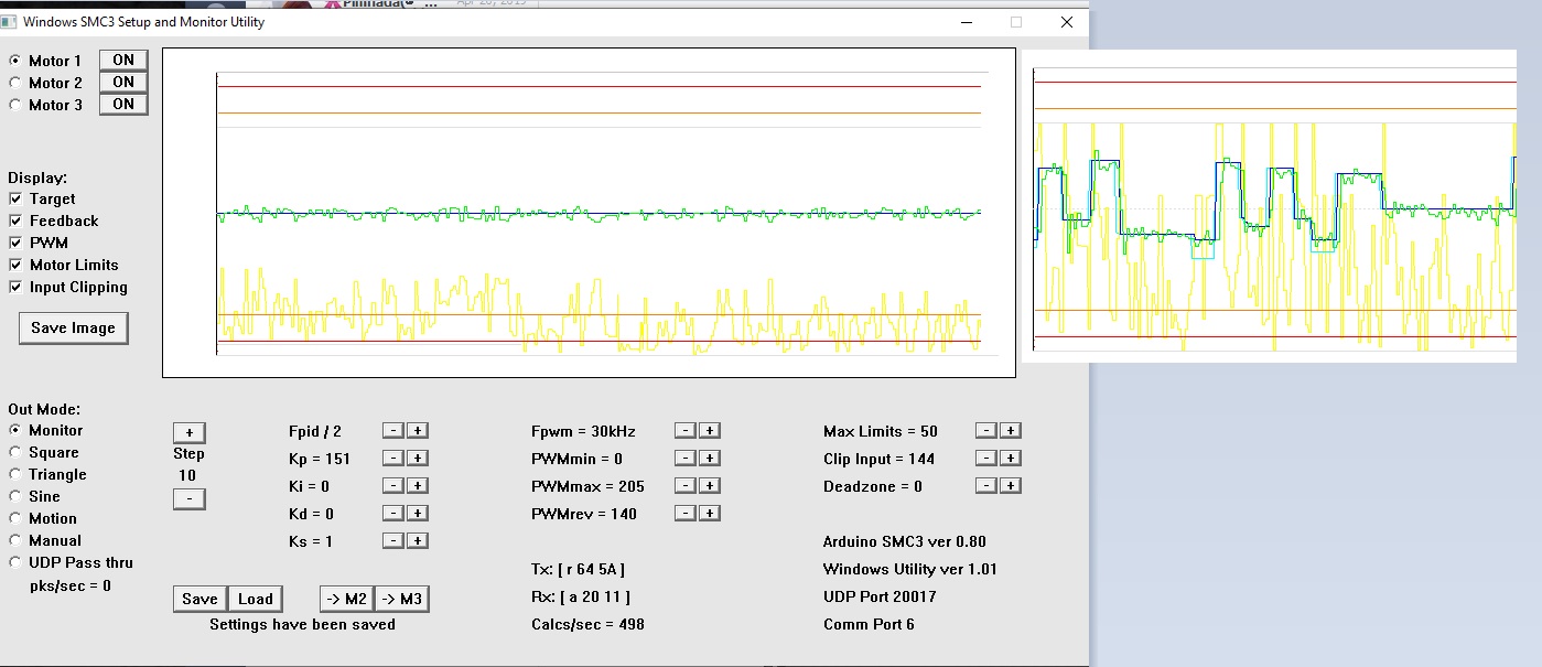

    Just fyi hall pots are contactless so technically they are noiseless. What you do have though is hysteresis which can cause up to .2% drift (on magnepots) that looks like noise. My experience shows that hysteresis is larger when the hall sensor is under powered or has a fluctuating input voltage which is what lead to my recommendations in my earlier post.
  8. Trigen
    Trigen Active Member
    Nov 25, 2018
    491
    2,892Coins
    +184 / 1 / -0
    2DOF, 3DOF, DC motor, Arduino
    Its what i understood to which is why i was very puzzled by the noise in the graph. it also makes the motor quite noisy. Not that its and issue. Its actually greater when connected to the sabertooth 5v output but i suppose its the drift that you mention.
  9. SeatTime
    2,572
    Some screened cable and cap filtering may help. Pictures below are from one of my Hall feedback sabertooth 2 x 32's with Zero dead zone and a deadzone of 2. Everything is powered up.

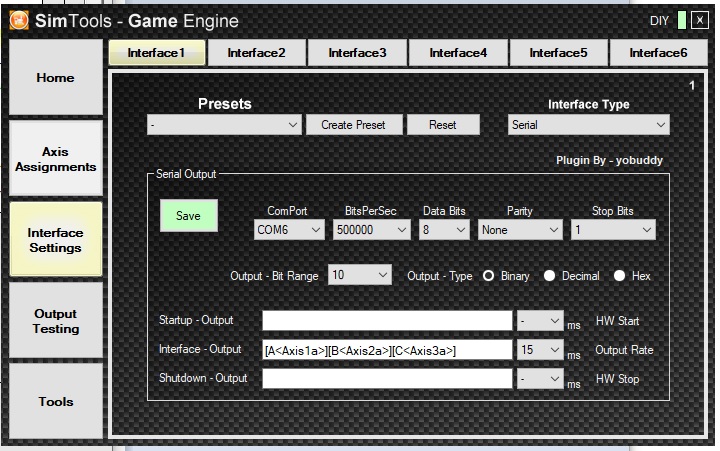

    I might have a possible solution for you, See my thread here: https://www.xsimulator.net/community/threads/help-to-diagnose-2dof-crash.13639/
    2 People with very similar problems, followed BlazinH's suggestion in the thread with directions to change baud rate fixed the problem.
  15. Trigen
    Nov 25, 2018
    491
    2,892Coins
    +184 / 1 / -0
    Thanks man, this seems to have solved it! (knock on wood) I was real close to just giving up on the whole thing.
