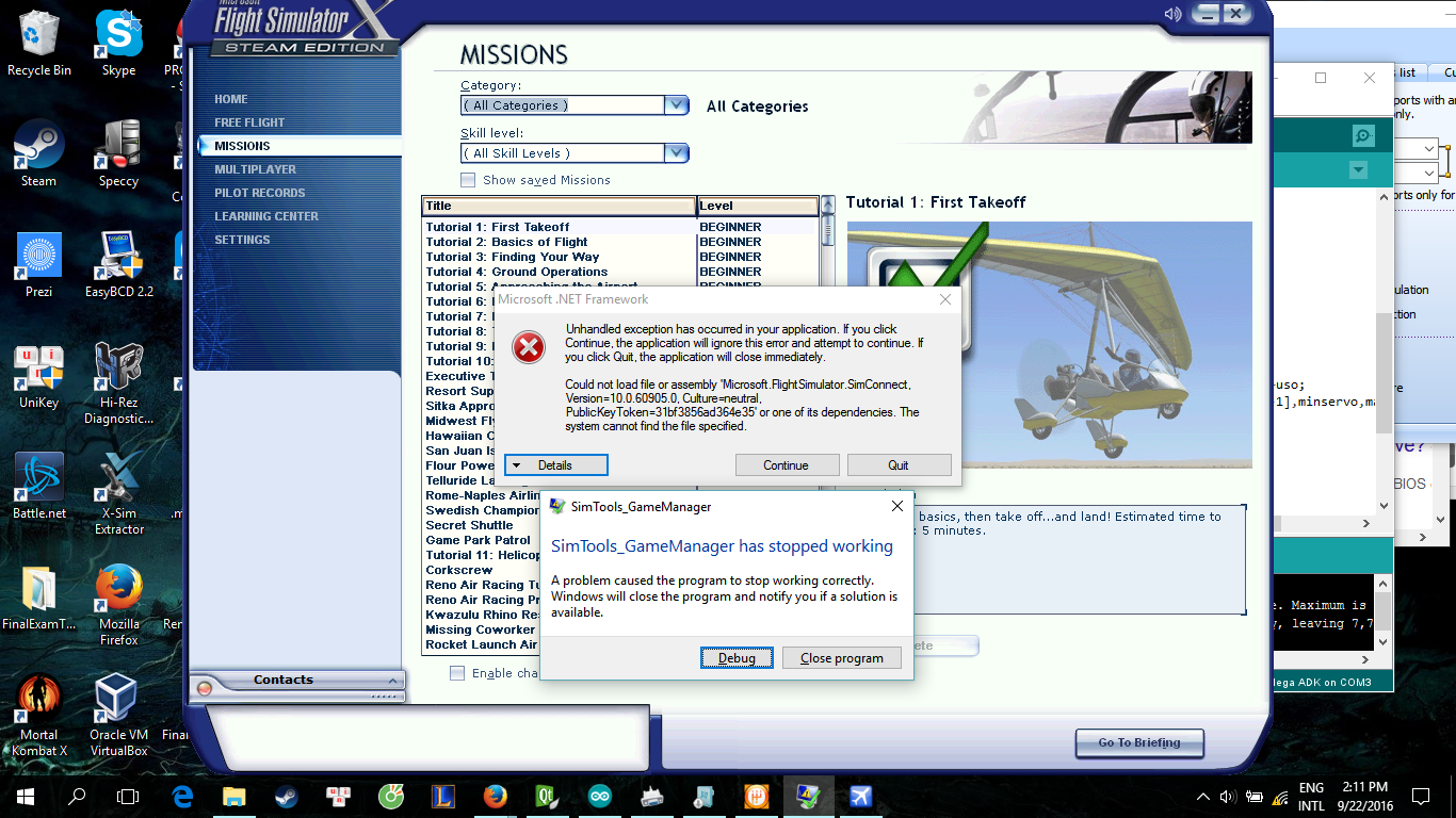

    Help, I just download Flight Simulator X Plugin , then i configure and play game , some error show up.

    I also have problems on a Windows PC 8.1
    Crash FSX frequent and random when using Simtools.
    After a full day to put all the PC updates the proposed Windows 8.1 PC stable FSX and it works without crashing with Simtools plugin and Microsoft Flight Simulator X Plugin 3.0.1.1
    Try the mmise update your PC as Windows proposals at worst it will take you some time. I have never been any incidents after the Windows updates offered

    @noorbeast
    Love u, thank you very much.
    My problem is solve. I search for the file "SimConnect.msi" and run it all then it work.
