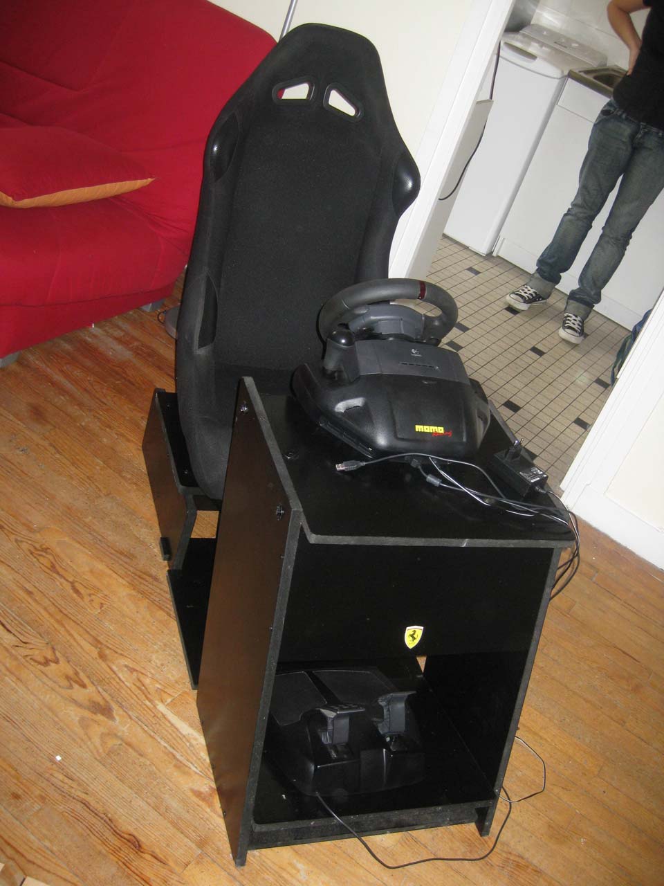

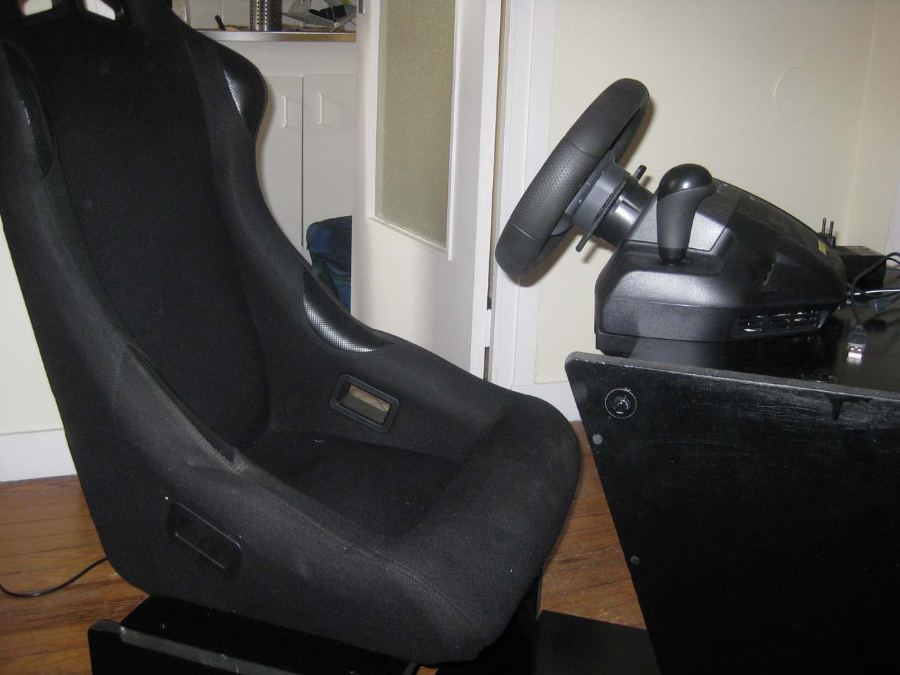

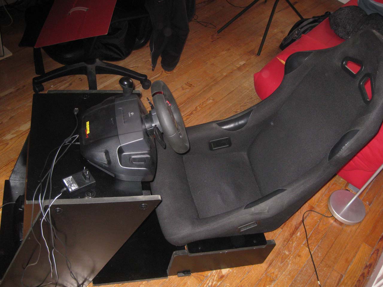

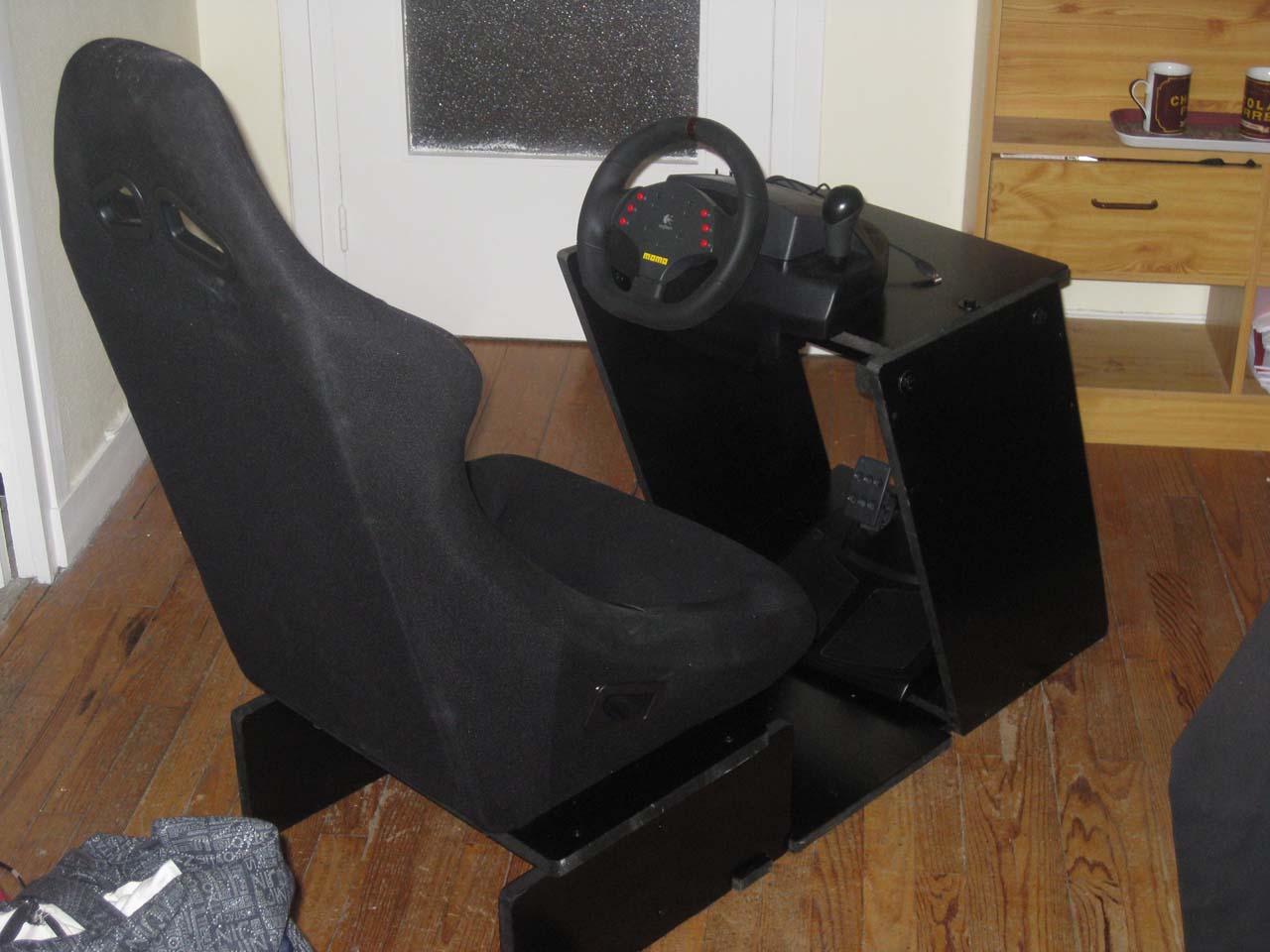

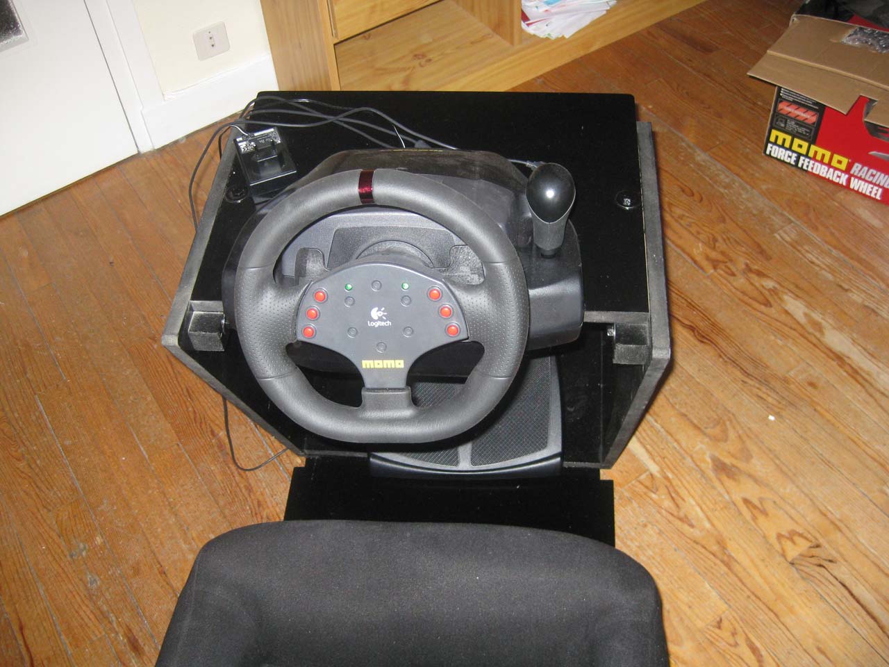

    First of all, I will present myself : I'm a french 22 years old man, who love car simulator. I live near Paris where i work as embedded software engineer . I've made a static cockpit last year and I want now to switch to a motion simulator. My favorite simulator is rFactor :D
    You can see on the picture bellow my static simulator :
    My idea is taking the seat and buy a new G25 to build a motion simulator with alu profile and wiper motor, with Tronicgr cards. I found a place where I can made make the card for ~50€. I think it's preaty cheap.

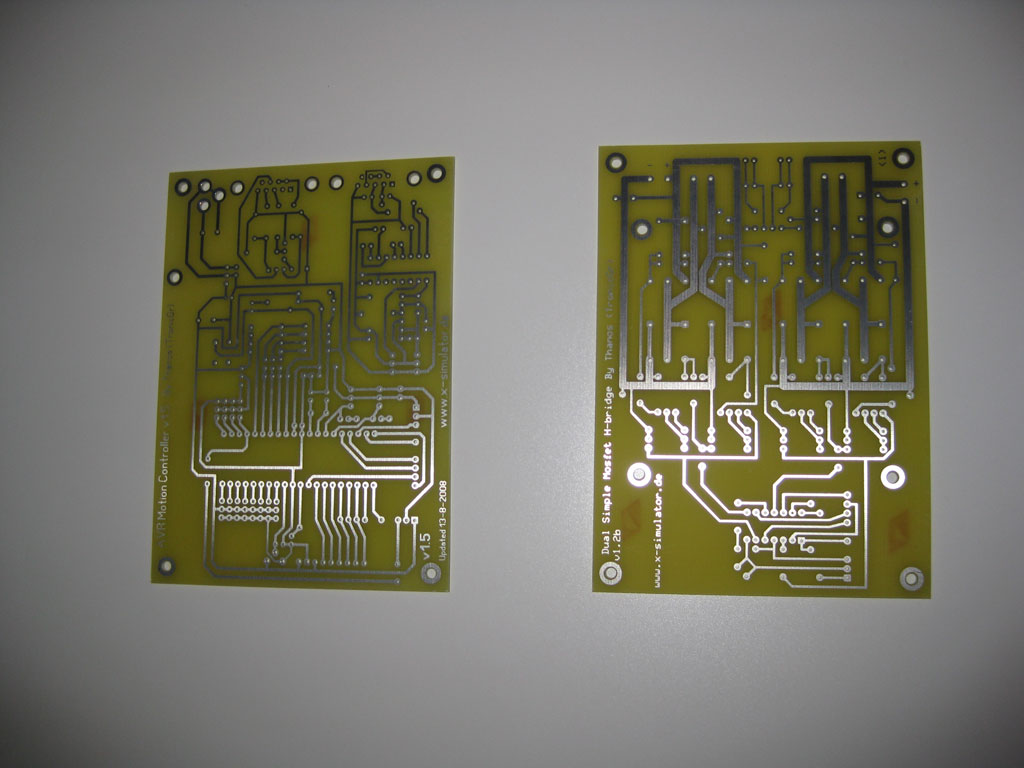

    I have receive the cards !!!!!! :D
    I had to buy the components.
    I'm happy.

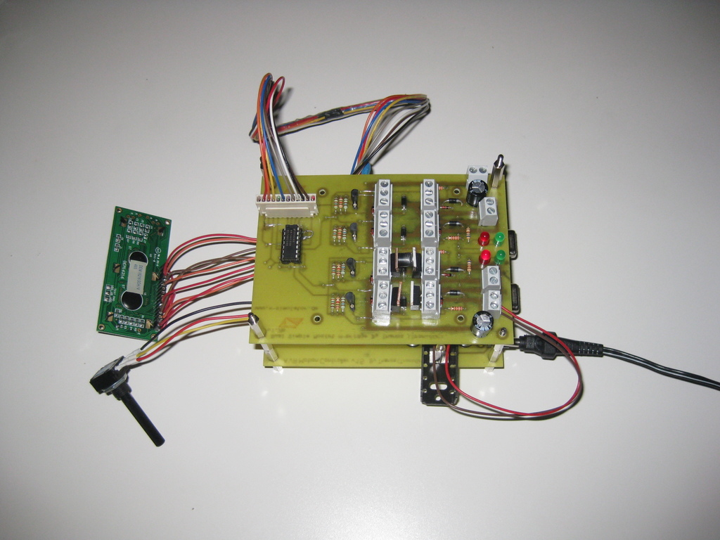

    The AMR and H bridge cards are now mounted and work perfectly.
    I have just a problem which is that I have to configure the serial port at 38400 bauds insteed of 115200 bauds.
    I can now control the led of the H bridge through X-sim.
    I'm very happy and I can now think about the cockpit architecture.
