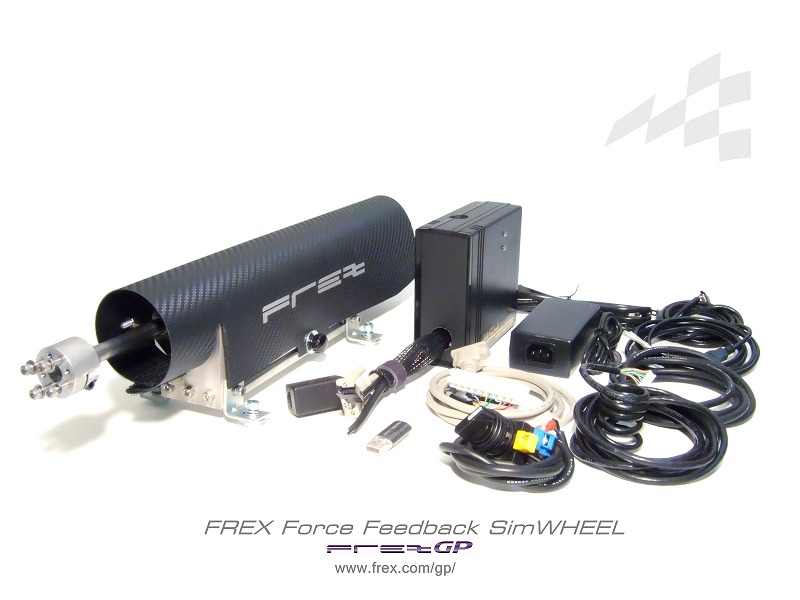

    Hi All,
    I'm intrigued by the top secret mechanism touted on the new Frex SimWheel (whole thing just looks like it's giant traction motor to me?).
    Very temped to buy one but at £800 plus shipping etc it better be pretty spectacular!
    Anyone have any insight it to what it is... I noticed ShigeT mentions it's patented worldwide but I can't find any reference on any online patent search.

    It looks like a big screwdriver motor, with planetary reduction box to me!!! LOL

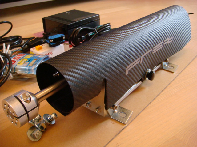

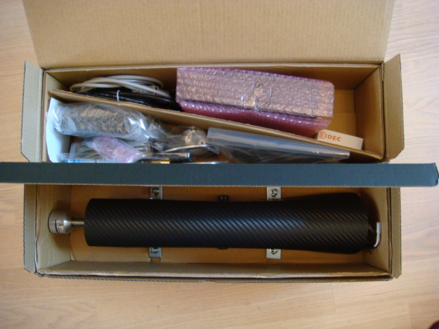

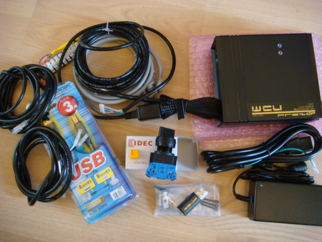

    people are getting their frex wheels over at rsc they're posting, nobody's yet to give a review but there are a couple pics up.
    you guys have any idea as to what this is made from? do you guys think it would be possible to make our own ffb wheels using x-sim? it'd be nice to try and get a frex type wheel too :thbup: maybe i'm being too greedy :tape:

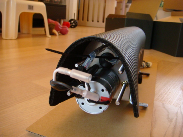

    The motor is way smaller than I thought.
    Obviously it is the smallest part in the whole construction.
    But let us discuss of what the hidden mechanism below the cover may consist of.
    There is a gearing for sure, but the major part seems to be a kind of lead screw mechanism.
    Such a lead screw drive could easily restrict the wheel rotation to a defined degree limit, and it would be way more rigid than all those toy wheels currently available. As well the the positioning feedback unit is perhaps connected to the lead screw, and does make a linear movement, instead of using mulitturn pots.
    Perhaps there is a magnet mounted on the lead screw, and a hall-sensor detects its position then.
    Btw, unlike ballscrew drives, which are very expensive, leadscrew nuts including spindles are available for very little money at ebay for example.
    And why not trying out a DC screwdriver motor including gearing ;D

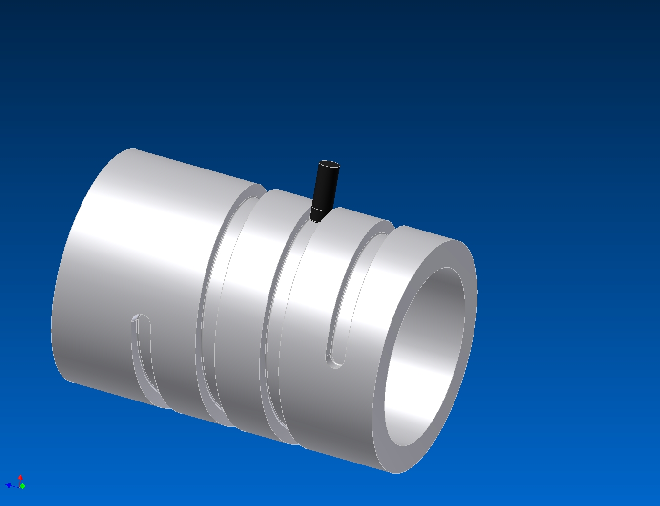

    How they have 1080° stop i am courious to, ledscrew is good idea in picture its even simplier version. They dont say that you can adjust it.

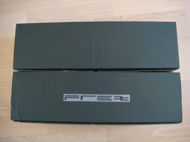

    When I first saw the shape of the packaging a long time ago I though there was some kind of linear motion inside ( an SCN5 ;-) ). But then as time went on I though it was just a massive motor 1:1 with the wheel... thats obviously not the case from those pictures.

    There would be no need to do that.
    The leadscrew would restrict the movements on hardware side when reaching endpositions/endstops, and would carry the moving part of the position tracker in a linear movement.
    The spindle would transmit the rotational power directly to the wheel.
    But seeing this tiny motor on the pic, I hardly can imagine that it could drive the wheel directly without gearing. Turning a 30cm wheel connected to a spindle that fast and powerfull, requires alot of torque...
    Regards
    Christian
  15. tronicgr
    tronicgr
    I agree with Christian... but as far I can tell from the photos, the motor is not aligned with the leadscrew... its placed a little lower that means it must be somehow geared to it...
    I'm looking for the patent for over 2 hours now with several combinations of words, but nothing... :thbd:
    Perhaps if a simwheel owner could remove the lid and show was whats inside... :adore:
    Regards, Thanos

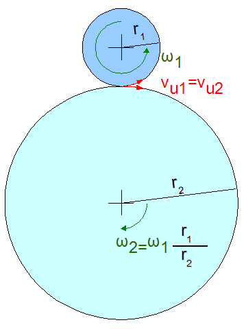

    What about friction gears? They suffer from slip, but if connected to a postion tracking system, this does not matter.
    friction gears transmit direct, smooth, less noise, and backlashfree.
    And of course the transmission ratio can be set as like with gears.
    Regards
    Christian
    EDIT: friction gears, not roller drives :)

    friction gear example:
