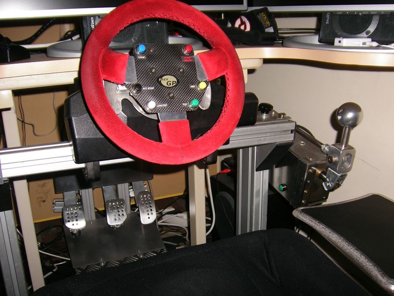

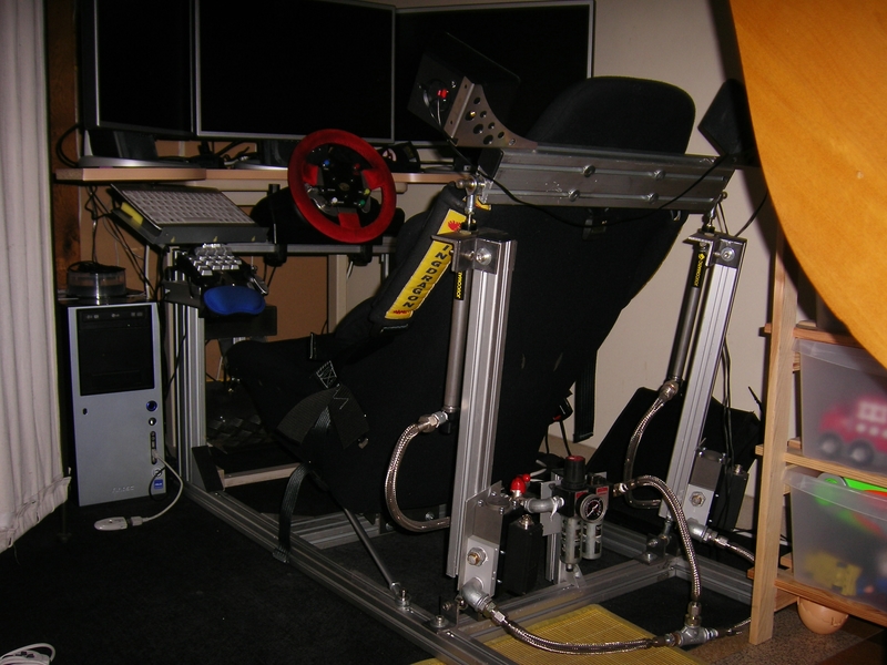

    You can find some pictures of my motion here but I really need some help to end it.
    I've built a Frex-like frame, with 2 cylinders on the rear: 1 for left, 1 for right, and both for ac/de-celerate

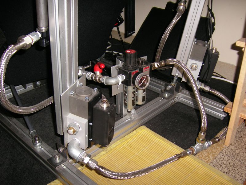

    After lookin at X-sim, I've found a solution to manage it with an USB-card and some tuning in X-sim's software but this solution works only for those who use standard pneumatic valves (in French, we say: TOUT OU RIEN or in English: ALL OR NOTHING). These valves could be activated or not, that's all. My frame is equipped with 2 proportionnal pneumatic valves from Joucomatic. To explain how it works, you have 0 to 10V on input and the valve delivers 0 to 10 bars on output ! Of course, the way how these 2 parameters react could be tuned and modified easily with small micro-pots mounted on the valves.
    So I need to get analog output from USB card but X-sim solution only drives the numeric outputs. So here is my first question:
    Is there a way to get the analog outputs of the VM USB card working with X-sim's software ? (Even from 0 to 5V so I could convert it in 0 to 10V after)

    Here you go!
    Your Cockpit is really amazing!
    I noticed that you have changed your pneumatic cylinders to thinner ones. I assume the other ones have been to strong for your setup ;)
    Anyway, I think you should start at first to get you system to rock with the software in IO Mode to get familiar with the software. There are some configs you have to make for your setup. After that you take the next hurdle with the proportional valves.

    First, I don´t have changed my pneumatic cylinders to thinner ones. Maybe the older pics you´ve seen was not enough close.

    Well, the valves are from Joucomatic. It is called Sentronic has I remind.
    If you want, I can scan documentation and wiring diagram to introduce you these valves, let me know.
    Price is a little expensive, about 350€ for one valve.

    I assume that the rear movement for accelleration has to be caused by the body weight, because it seems that there are only 2 air hoses and 2 valves.
    Do the prop valves have a prop air-outtake or just an in-take. Because the air has to leave the cylinders as well.
