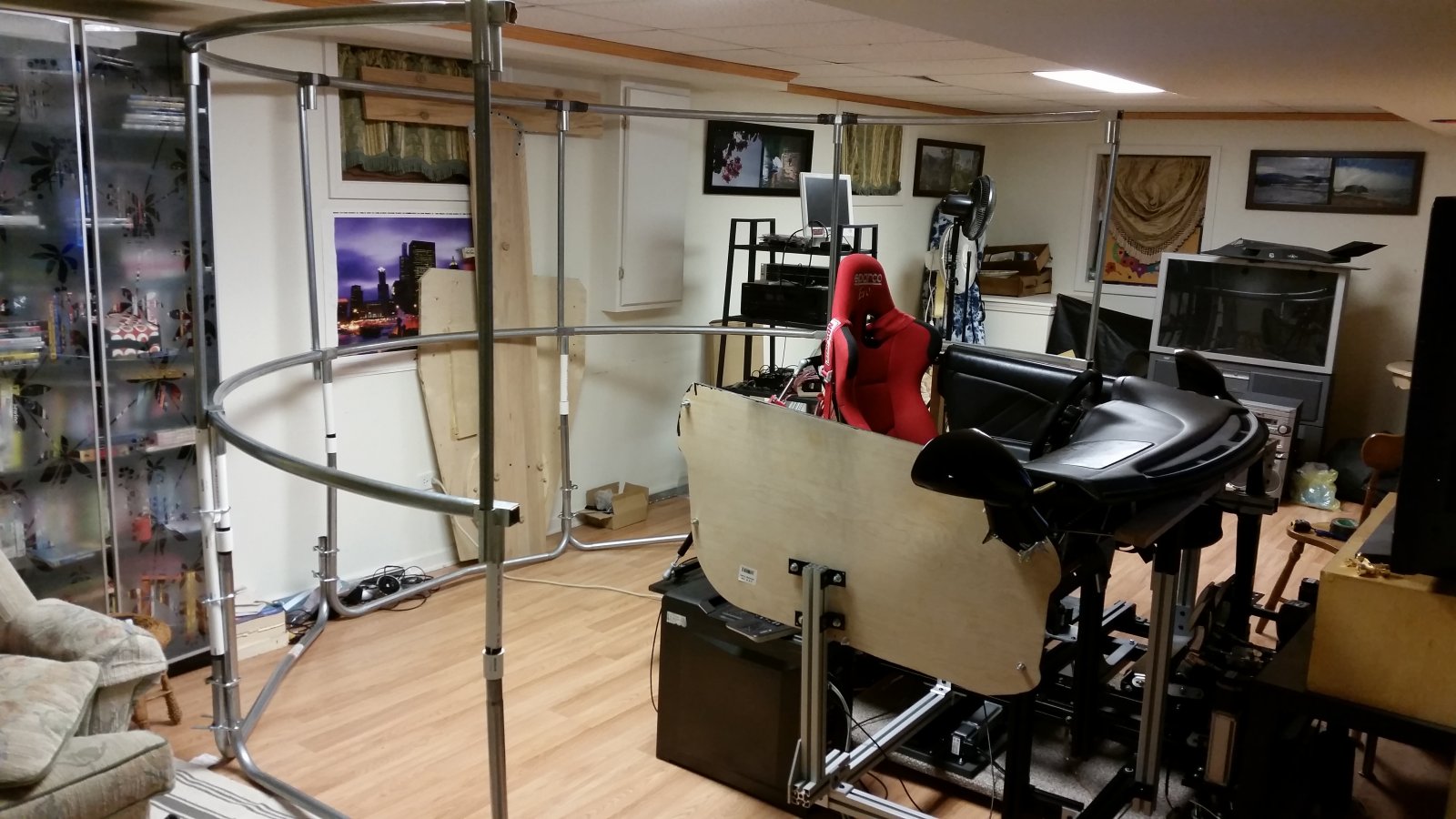

    I build a rig with such combination. Results are suprisely good, which gives far more realistic feel. Check my latest video on this. I can switch off one or other to compare...
    I can tell you that there is no way for me to go back either seat mover or frame mover alone. Both got to be ON.

    AC motor, 4DOF
    This is pretty awesome. Great job, @joe extraknow. Oh and this makes me wonder if I should strip my s2000 apart.

    Lol, I would keep the S2000. The deshborad and door panels are pretty cheap though. I got mine from local junk yard for $200. I got the side mirrors for under $100 from ebay.
    In progress making 225 degree curved sceen:

    wow joe xtraknow, thats brutal! Just one advice: get rid of the back rod that simxperience have for the seat actuators, Its just 3 scews I think and attach somehow the Scn5 directly to the back of the seat: less weight and no bouncing. But man what a rig!

    3 projectors?
    The frame looks like those trampoline frames, nice idea :thumbs

    Yes, 3 projectors, bought two 10ft trampolines...for this screen frame.

    Joe Extraknow Well simxperience frames are really heavy and well built and even though I see your seat bounce very very litle it always does. All of them do and you want direct push from the Scn5 (does that expresion even exist?) Again, what a sim man!
