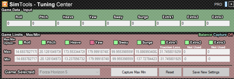

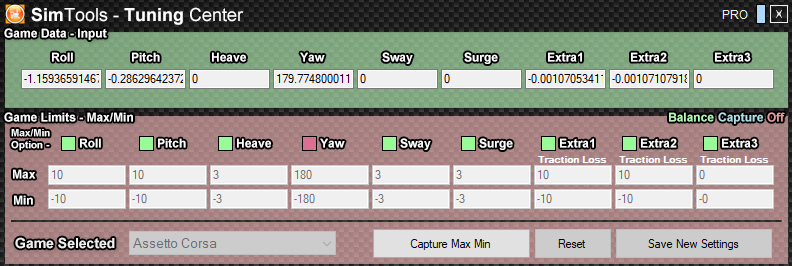

    Hi, I installed ForzaHorizon5_GamePlugin.V2.0.0.0bykai.zip and I configured:
    Udp output Ip:127.0.0.1
    port:4123
    But I have not motion. I also have Asseto Corsa and motion works well with it with but Forza Horizon 5 doesnt works.
    This is a screnshot of Tuning Center running Forza Hotizon 5 (it doesnt work):
    And this is a screenshot of Tunning Center running Asseto Corsa (it works well):
    Could you help me?
    Thanks a lot.

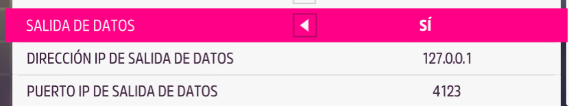

    I can confirm that this plugin is working very well with the new Forza Motorsport.
    You just need to activate the telemetry in the game settings with this settings
    Ip 127.0.0.1
    Port 4123
  17. paulopsx2
