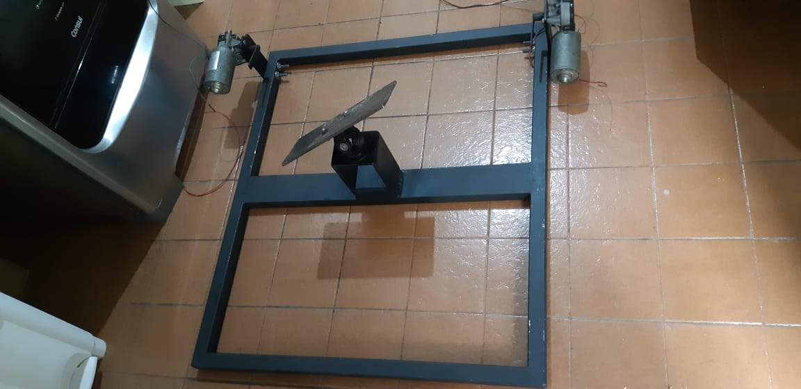

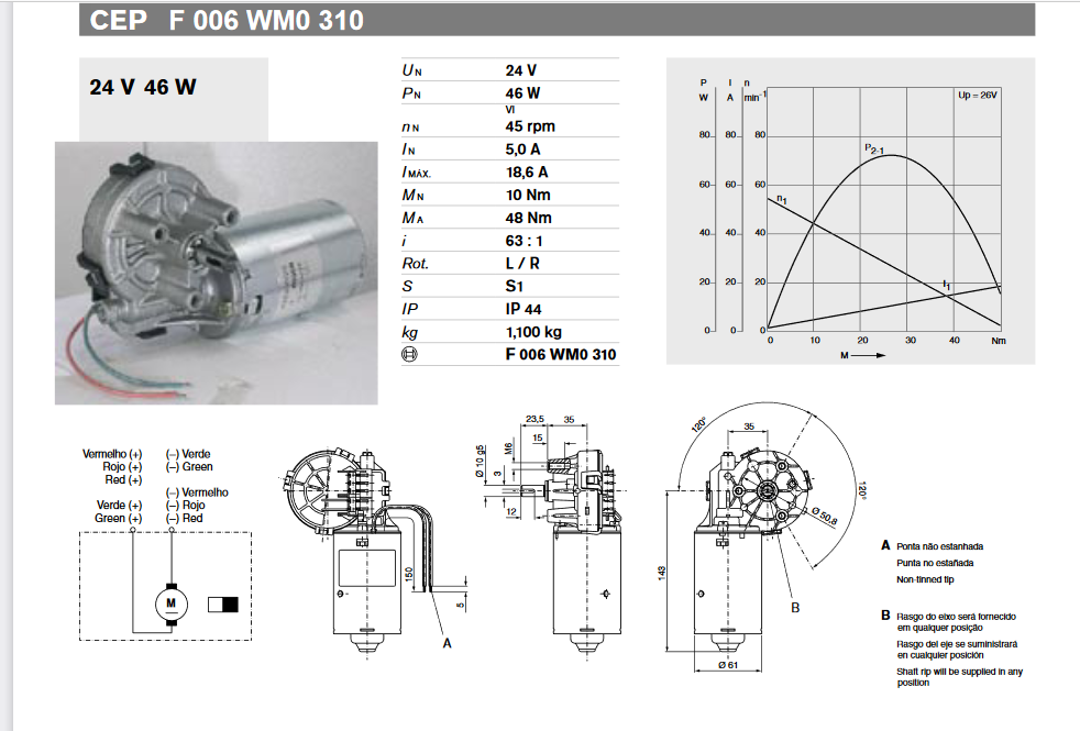

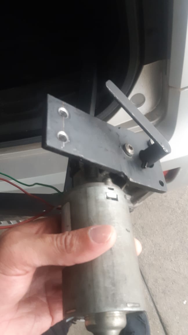

    I'm building my 2dof motion with a seat position for drive formula and GTs cars. I dont know if the phisics balance will be ok in the final, because my motors have only 10nm nominal force and 35nm for maximum.

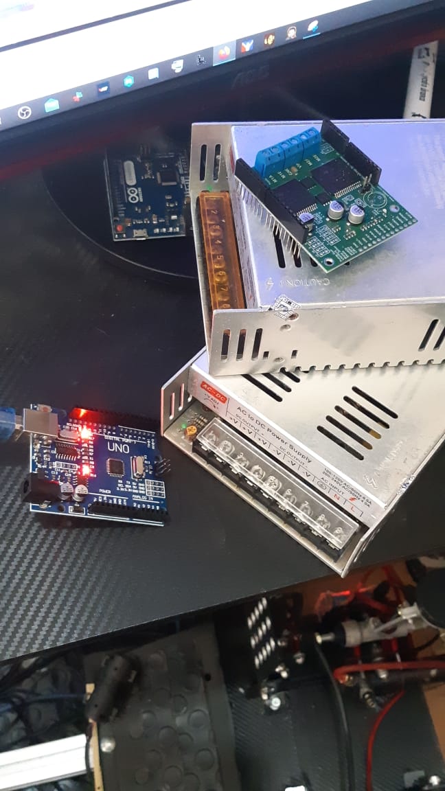

    but i will use a polulu motorshield, maybe its help me to improve the power administration because its a good h bridge.

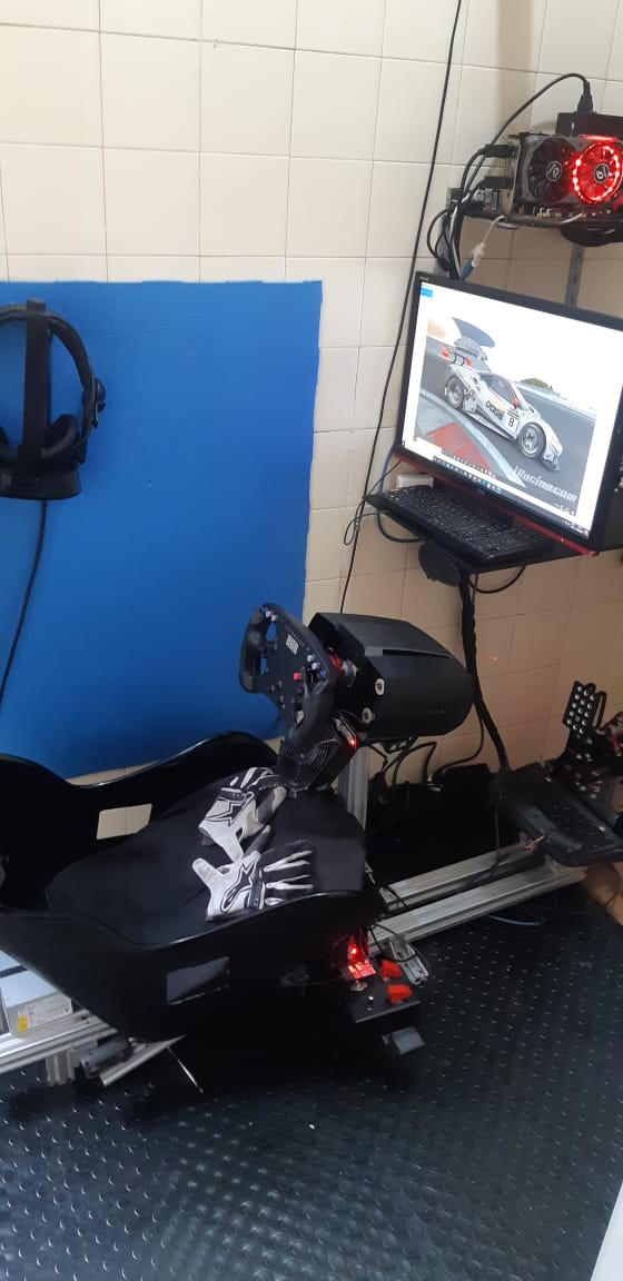

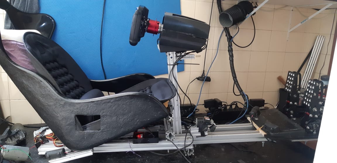

    here is my aluminium profile homemade cockpit made for the motion: cockpit 1.jpeg
    my CEP motors: motor bosch.jpeg bosch motors 1.PNG
    the Polulu shield and power supplyes: polulu and fonts 24v.jpeg
    the motion base: base 1.jpeg
    I'll test soon and will post here the results.
