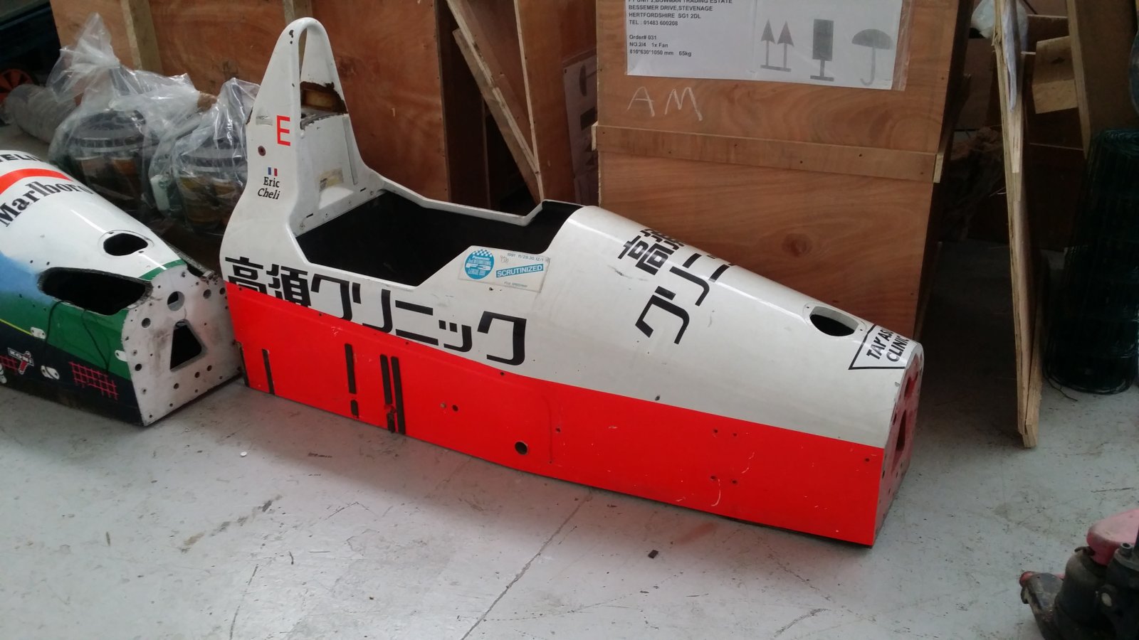

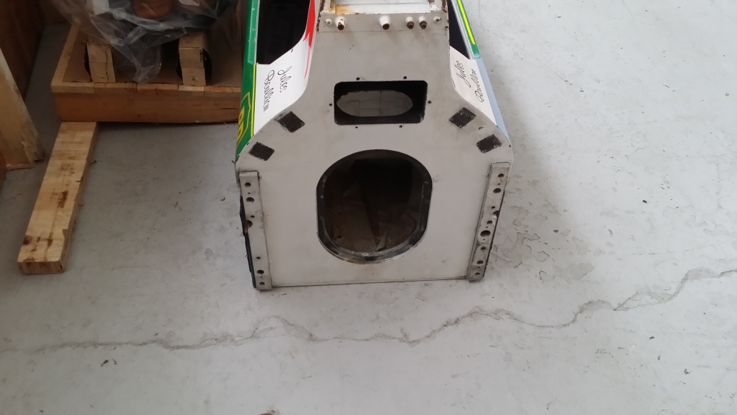

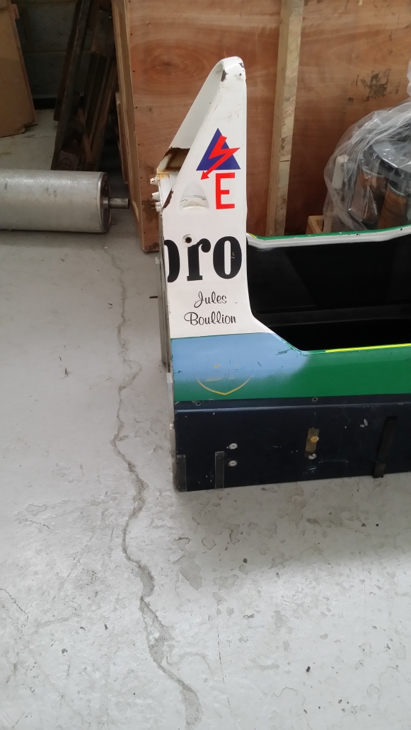

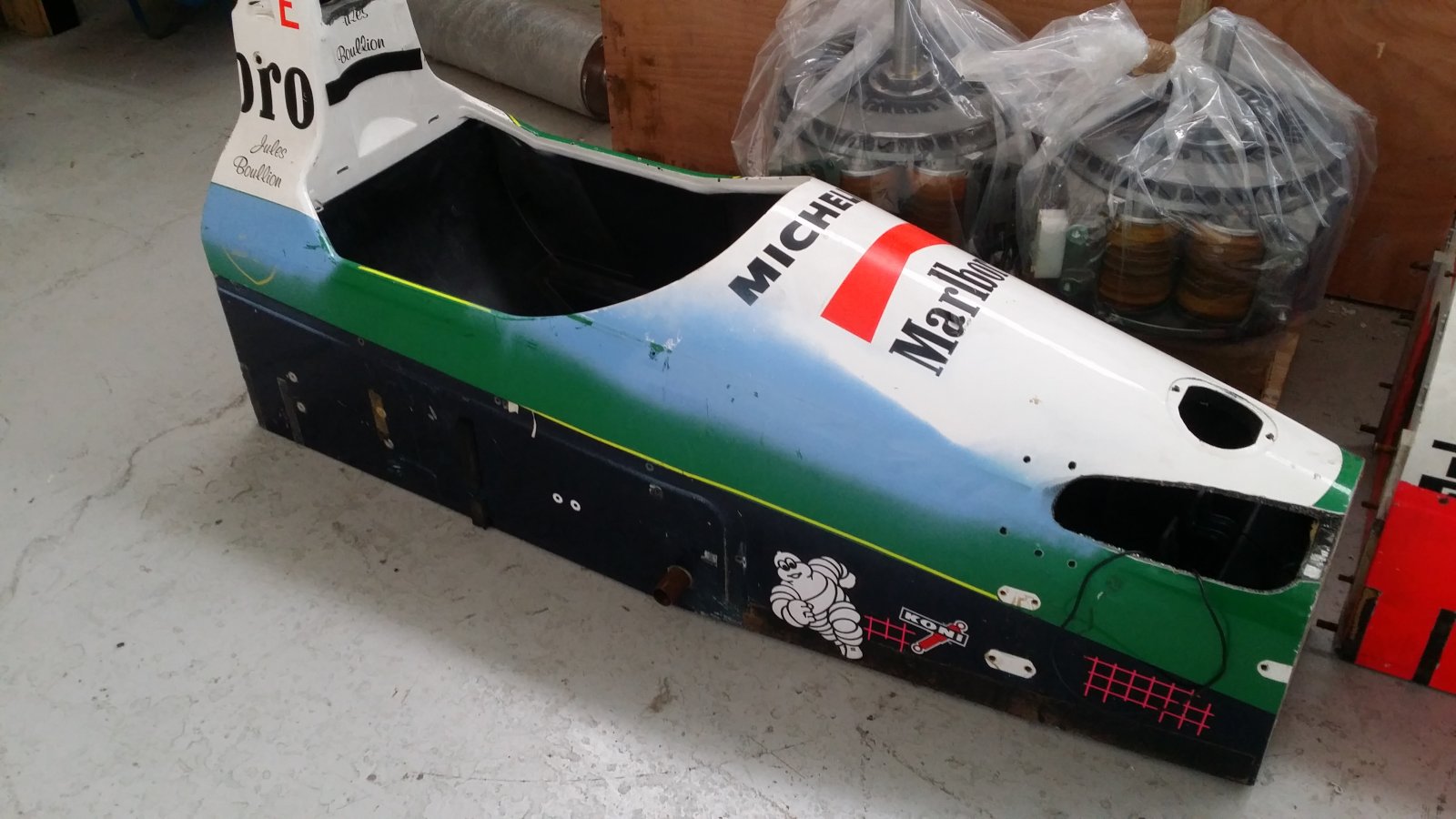

    I have a pair of Formula 3 tubs that were raced back in the 90s
    One of them was raced by an ex F1 driver and is very authentic.
    The plan is to use r factor with an arduino and some h bridge motor drivers
    The plan is to mount a universal joint under the driver and have 2 linear actuators attached to the rear of the tub.
    The questions i have are :
    Should i use 12v or 24v ?
    What linear speed do i need in mm/sec
    What type of stroke is suitable ?

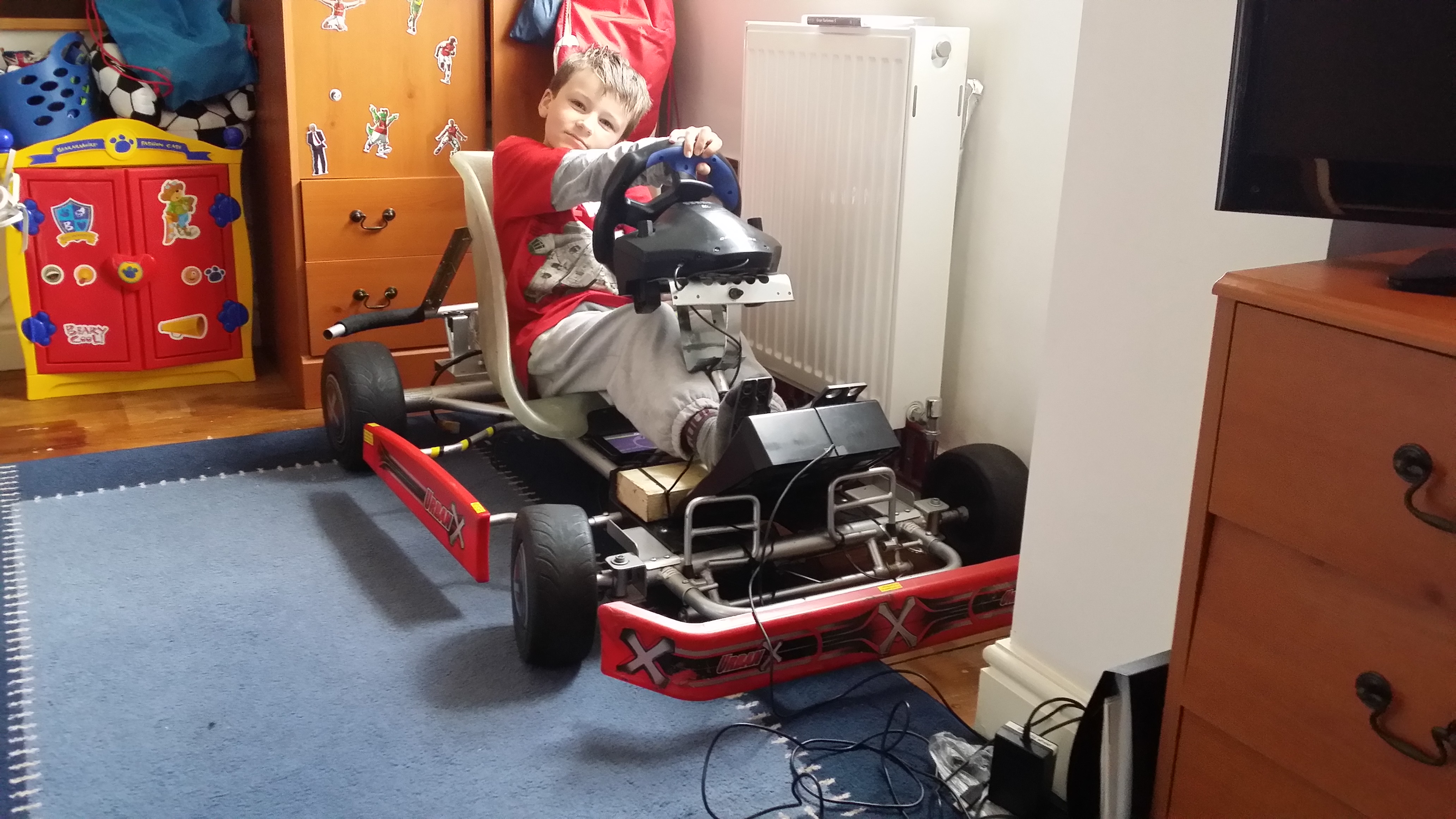

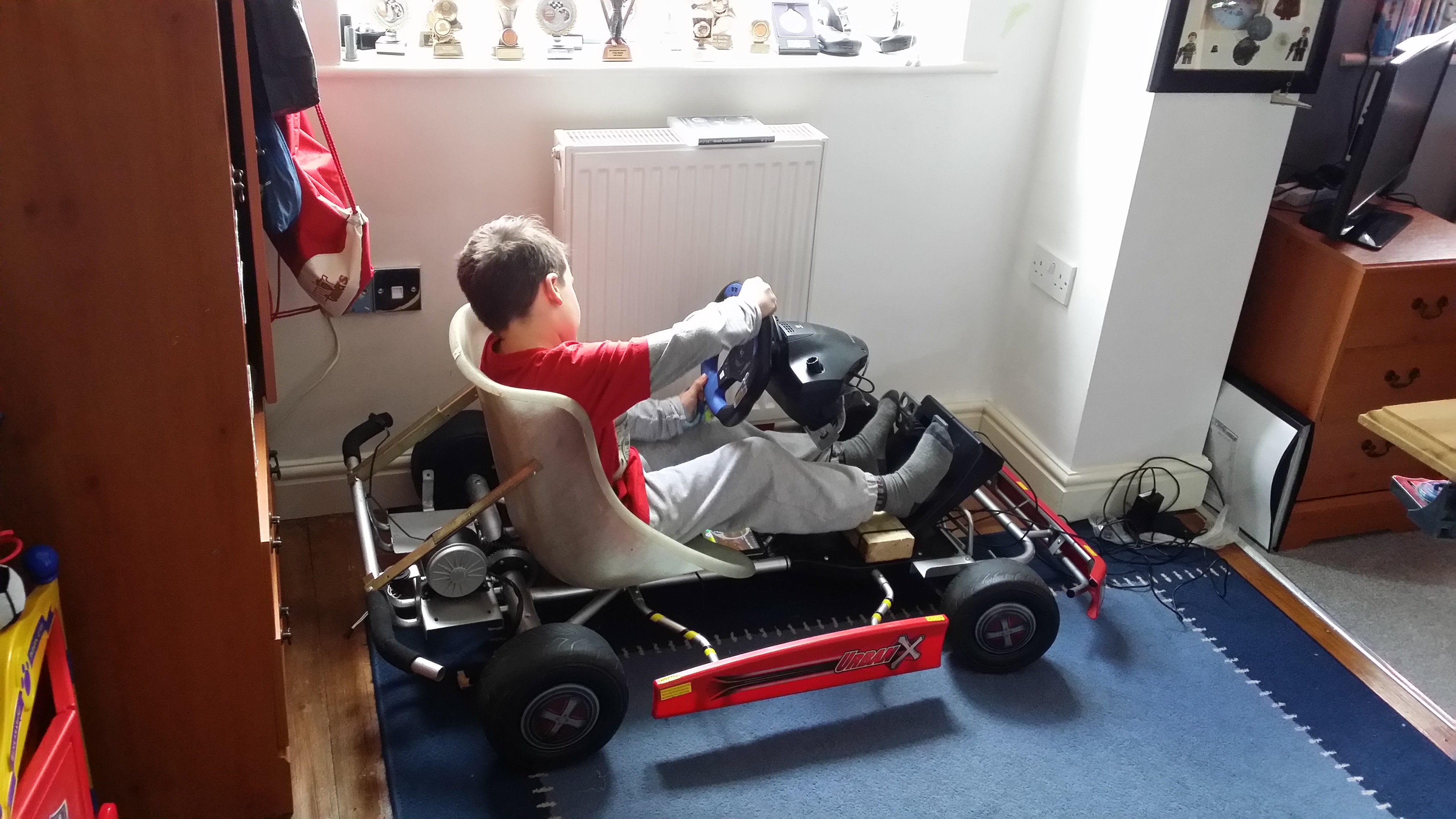

    The short term plan is to get one working and let my son have some fun with it.
    The long term plan is to use them as training simulators with a professional driver who logs in to advise the students
    Attached is a pic of a kart sim i built for my lad over a year ago. The plan was to motorise it but he was not keen
