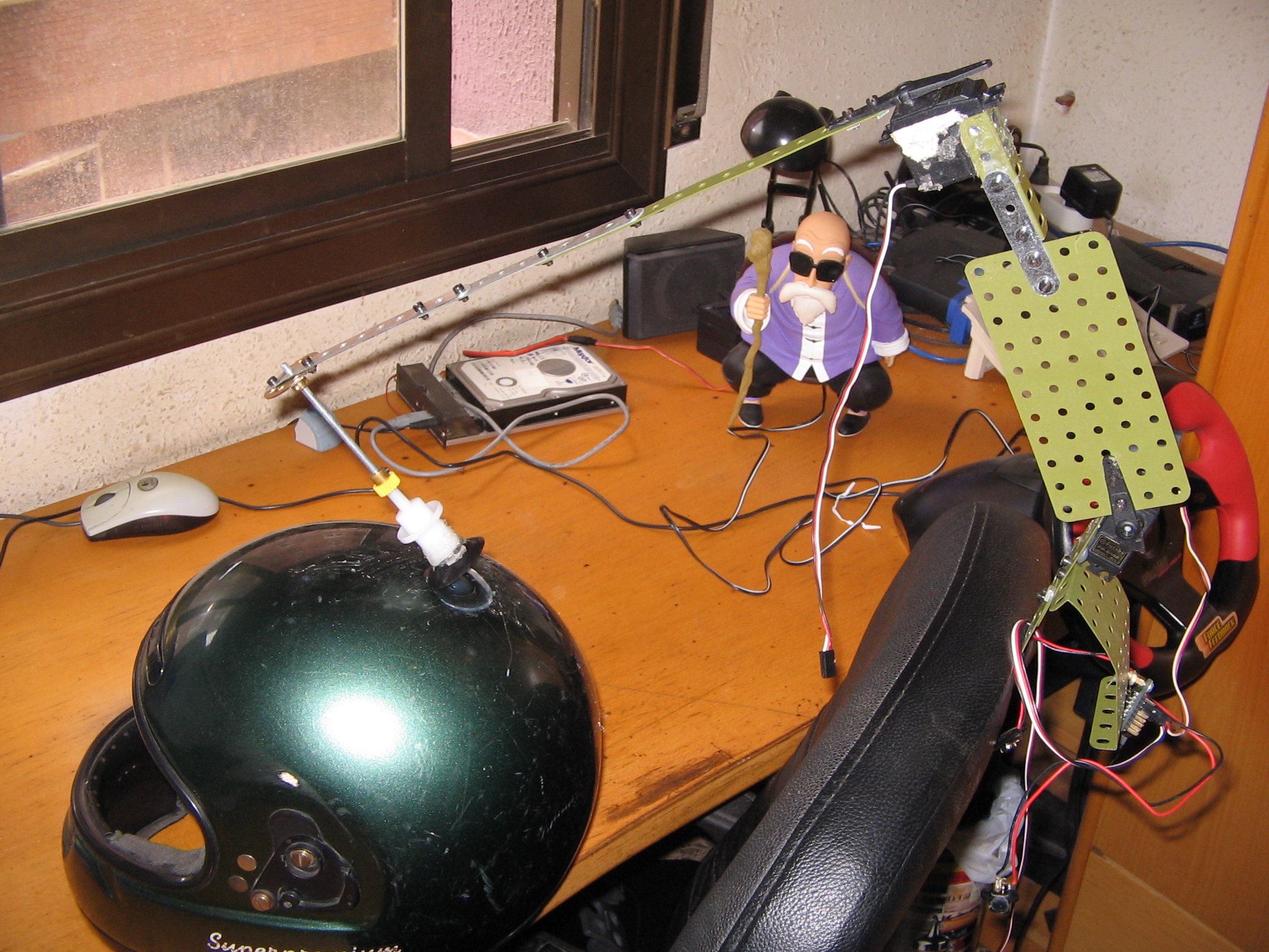

    The concept is to feel g-forces through cochlea ear instrument, hacked by helmet movements that come from two RC servos arms controlled by software telemmetry. Which means that your head will become a joystick being contolled by virtual enviorment simulations, like cars, copters, or anyother form of vehicle.
    Hope X-Sim Community Enjoy it.

    Though I understand the principle behind it, I hardly can believe that those thin sheet metal plates connected to the tiny servo arms are able to transfer lateral forces to the head/helmet without bending/braking.
    Are you sure that your construction will be able to stand 13kgf servos pr more?
    Anyway, good job :clap:

    Looks like interesting project, but let me ask some questions about it.
    Doesn't the rumbling of the servo steps pass thru the helmet making you feel like your head is ringing? (like cellphone pager vibration)
    And as Christian asked, your servos are having proportional acceleration? I'm asking you this cause I know that the servos are designed to move in constant speed, regardless of the distance between two positions, whether is just 5 degrees or full 90 degrees...
    I believe that you could achieve better results if you ripped off the little servo electronics from a standard servo, and connect their little motors in a small h-bridge and then connect both h-bridge and the existing potentiometer of the little servo to my AMC1.5 for position feedback 8)
    You will have then selectable acceleration to either direction and control over the angle of rotation... With the same cost!
    Keep up the DIY spirit!!

    Meccano pieces are rigid enough. They blend forces from servos through helmet quite nice and smooth so your head doesn't fall of.
    As a fact, i'm quite scared with 13Kg Force. I will try first this mech configuration, although as you point maybe they are too heavy for this effort. Hope to fixit via cnc milling on next prototype. This one was finished on 20th august. Once it's done i will look forward improved electronics, althought any upgrades are wellcome. If you want to collaborate on this concept email me, and I will add you as web site developers.
    Actually servo speed, even unproportional, have nice response, and are fast enough to get a new LOW COST approach to Motion Simulations.
    All_U_need can be done.
    Cheers
    PD: Will try to do a new video with split screen when i get a cam. Right now i'm using a webcam and i have not much room to adapt view angle.
