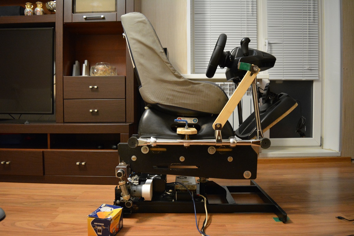

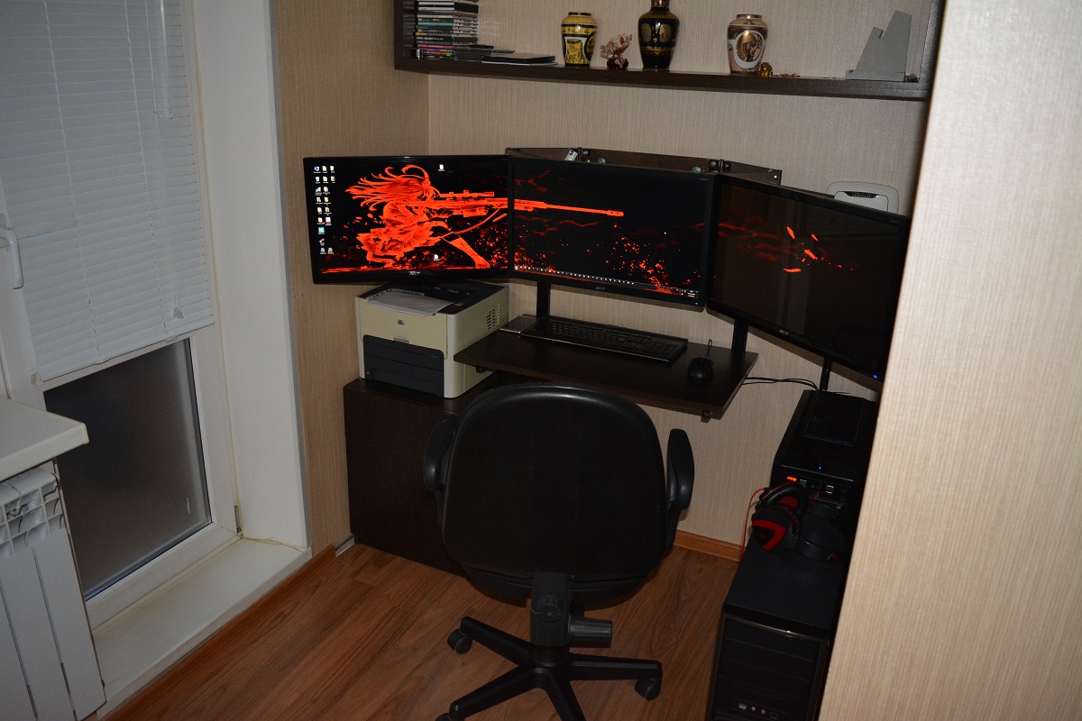

    Hello forum users!
    First of all, I want to say thanks to everyone for all the ideas on this site. Only with your help I was able to build my simulator.
    I decided to share my project. I rarely play races and therefore I had to look for a simulator solution,
    which can be removed so that it does not interfere.

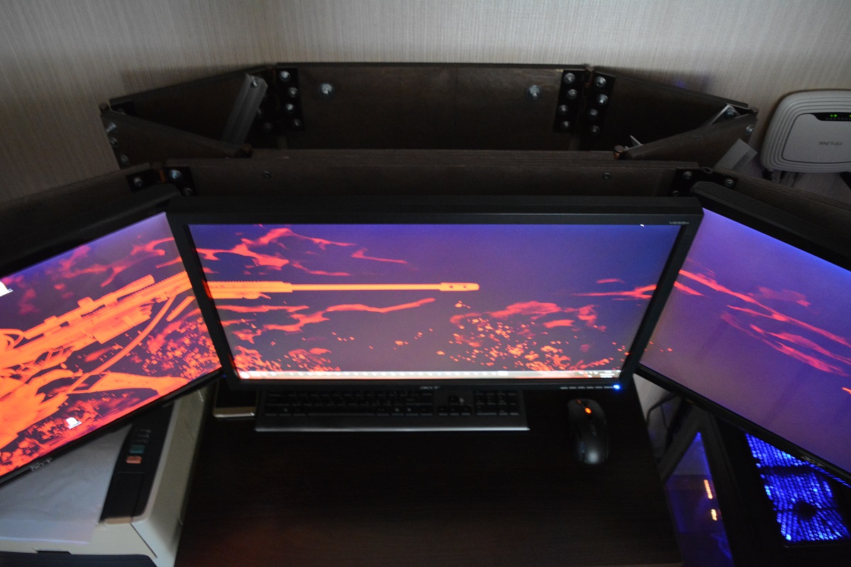

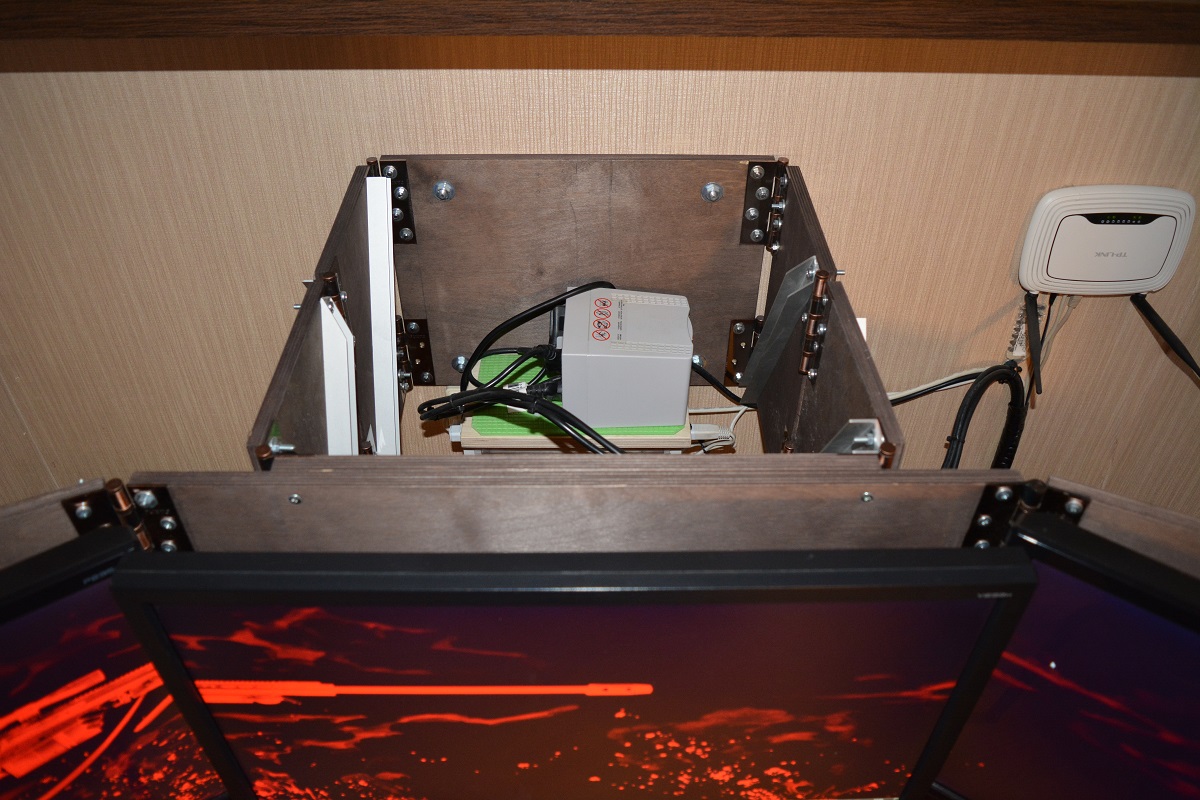

    Here is my working place:
    My monitors are shifted to 26cm:

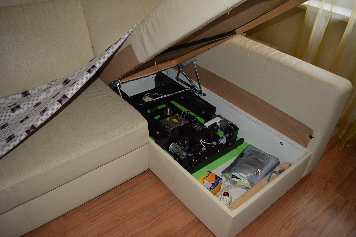

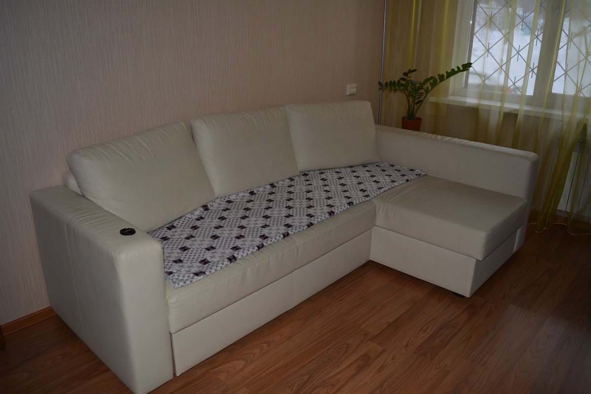

    then we go to the sofa from IKEA:

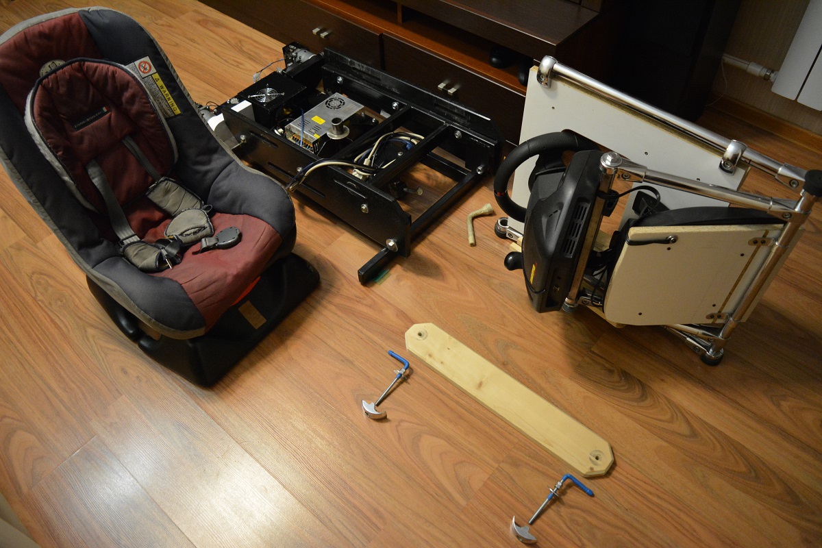

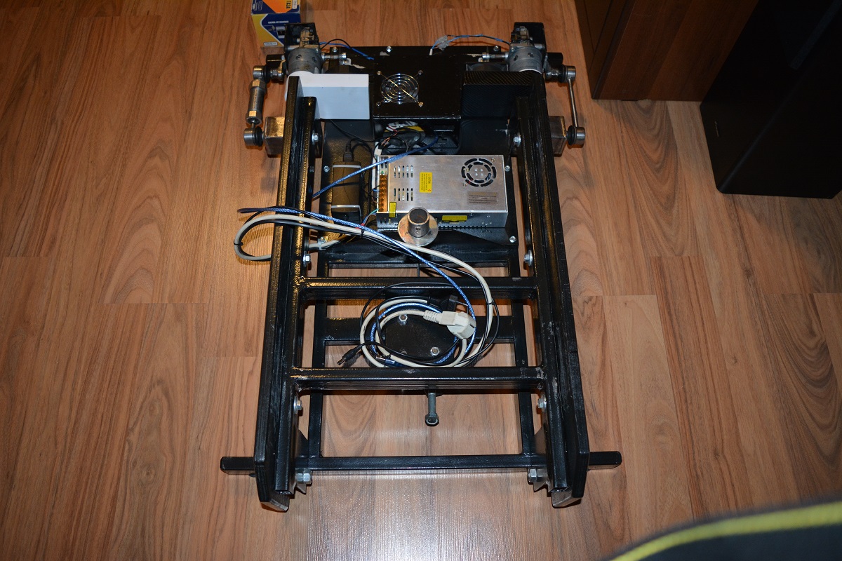

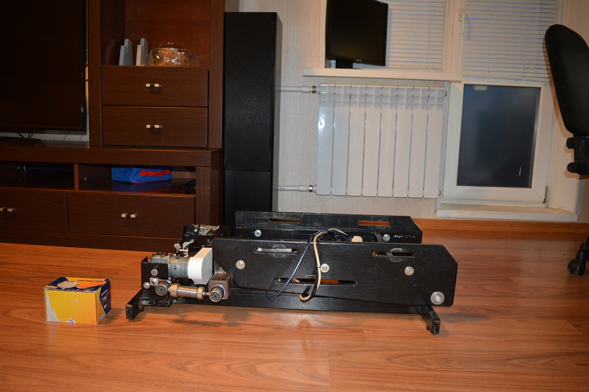

    which is my 2dof simulator:

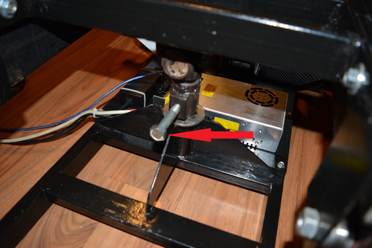

    We take it out and put it:
    tighten the locking bolt:

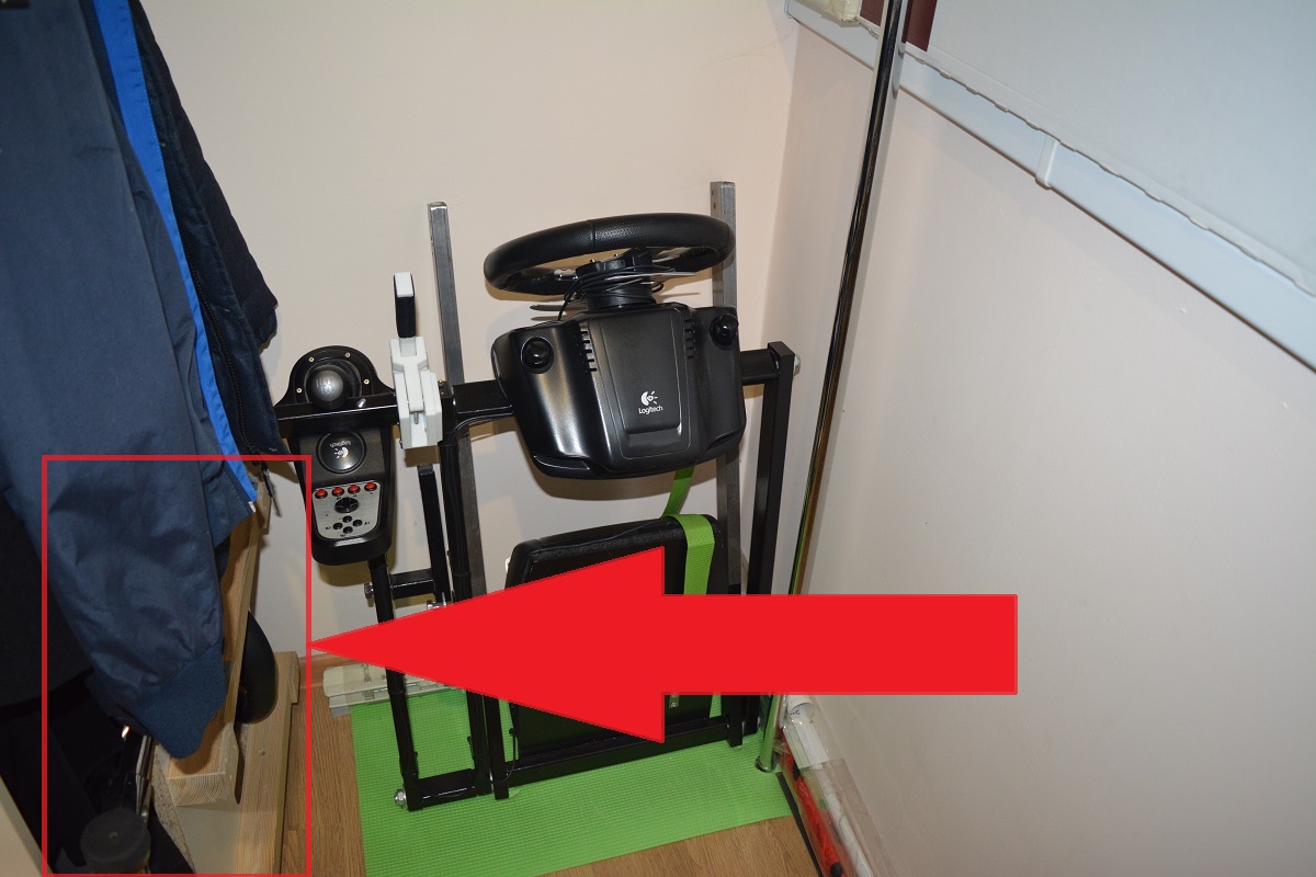

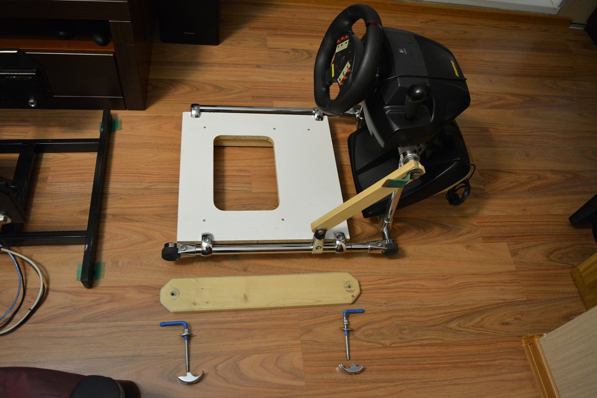

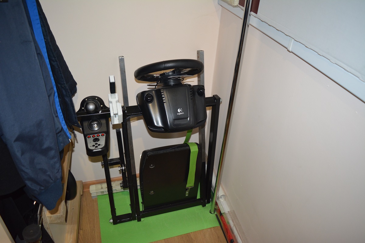

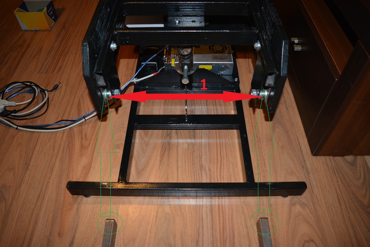

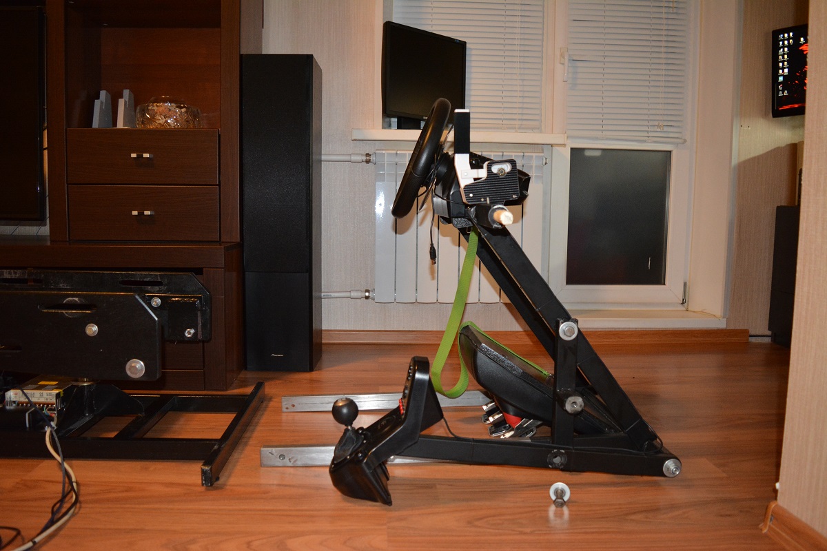

    The steering wheel is stored on the balcony and does not interfere with anyone there. We bring and lay it:

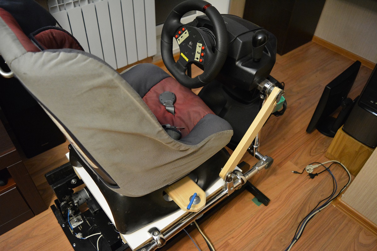

    And install (shown by green arrows). The photo shows where the bearings are installed (number 1). :

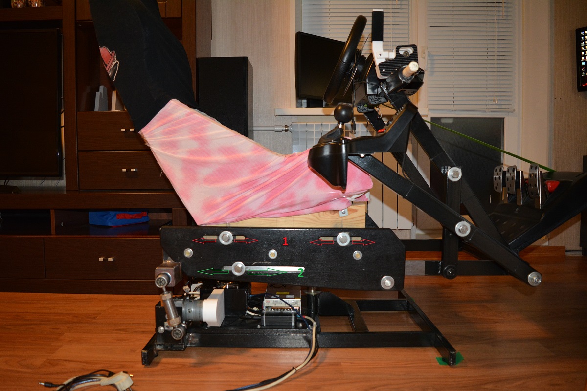

    There is no sports seat in my city, not a new one that was not in use, but maybe once I can buy it.
    I had to temporarily make sheets of plywood and my old T-shirt:grin

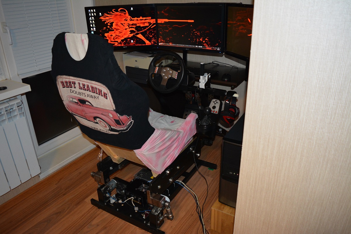

    1 pilot weight balance adjustment
    2 pedal adjustment
    Ready you can go) Everything takes me 10-15 minutes. And a bit heavy for me, plan some parts
    change to aluminum:
    If you have questions, ask, I will try to help you.

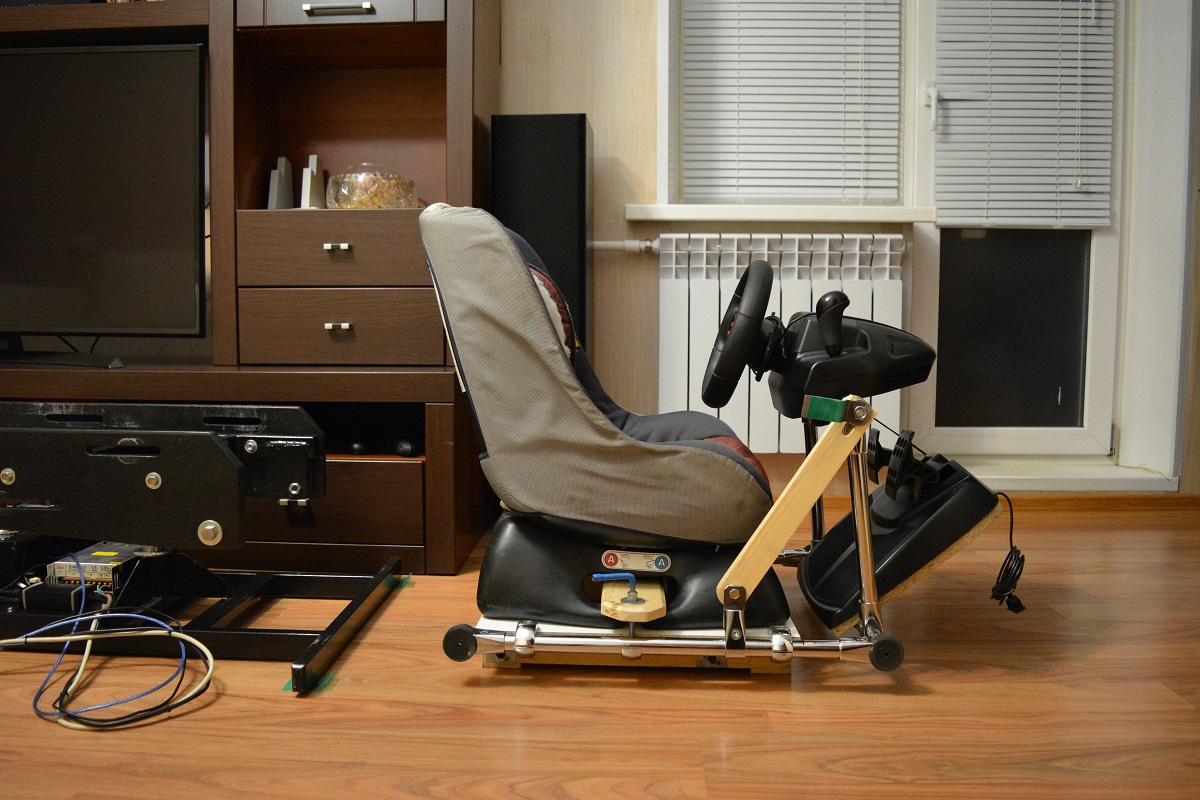

    There is a second option for my son:
