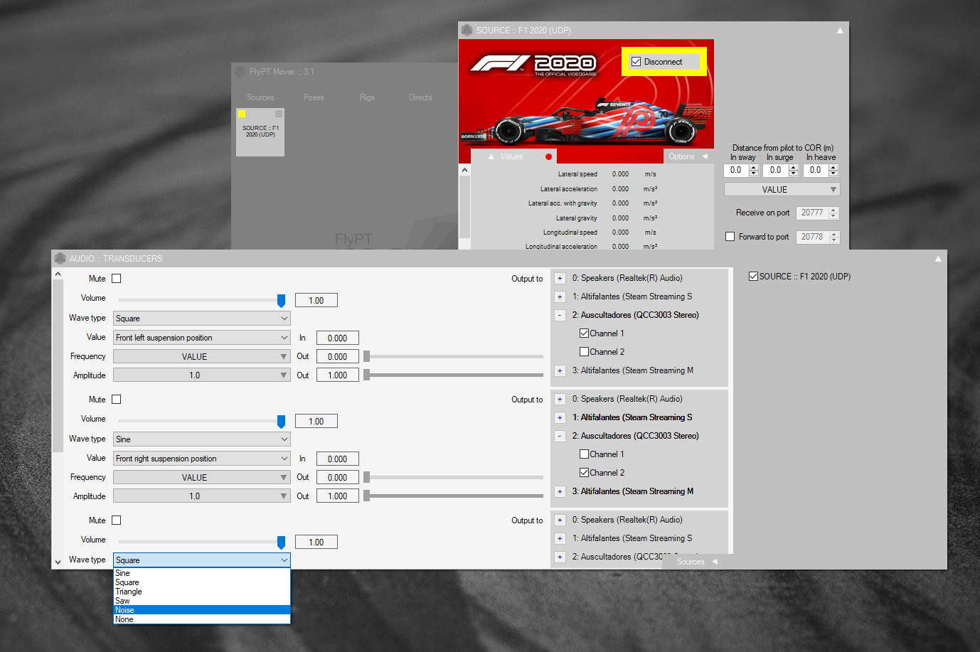

    And some more features for the new Mover - Audio shakers:
    Not the final design, still missing some controls.
    But finally we are going to have transducers.
    We can map any value using filters , by controlling amplitude(volume) and frequency separately.
    Each value can be assigned to a channel on any audio board.
    We can also assign more than one effect to each channel, they will be mixed.
    This is going to be the first pass on this feature, idea is to have full control, I know it might be a bit confusing at start, specially in the mapping of the values. But let's see how it goes.
    Still some work to do!

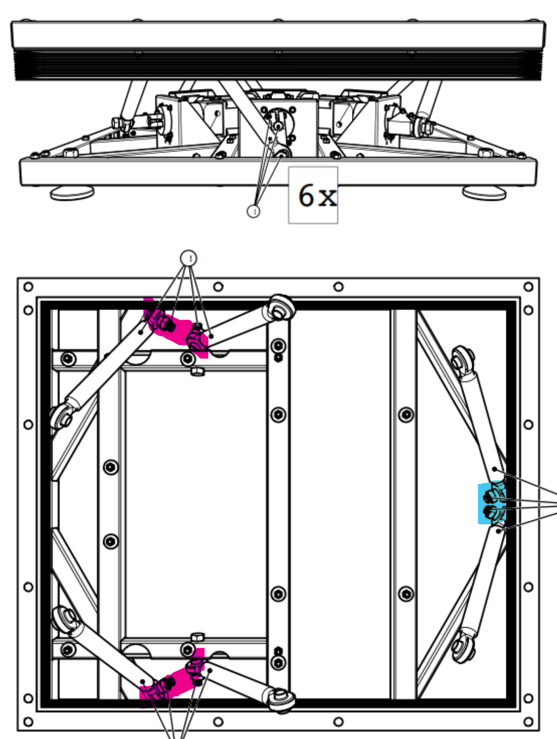

    Coming back to the design of the EDGE 6D (rotational) platform and its actuator layout. As you can see from the layout below, which is actually quite accurate, L2 is not the same at all 3 points. At the back the attachment points are only about 30mm apart, front left and right the distance is some 90mm. Additionally, the attaching points of actuators 2 & 5 are are more inward than those of actuators 1 & 6.
    Does that matter a lot? Or shall I just go on with some 60mm "average" L2 distance?

    Try an average to see if it works, and if you get matching travels and angles.
    Might work in the future on customisable rotating rigs, but I'm struggling on that with linear ones... No preview to have it.

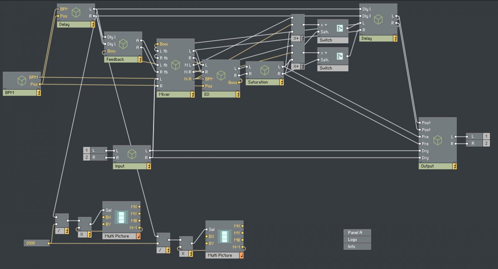

    Mover 2.9.9
    Wondering if anyone has an issue with roll over for roll on DCS (from motion pose) , I havent tested it on other sims. Pitch works fine but when using roll over on the roll axis it just does an instant switch when you hit the assigned value instead of changing direction for the motion.
    Then another question for the future. I saw for 4.0 it will be more modular and you can draw lines to connect it?. Would it be possible to then set up, Wind speed - Gear . Air brake noise values for gear and air brakes so it depends on what the air speed is?

    About 4.0, yes, you can do logic with multiple values.
    Right now it's a programming nightmare on old. Trying to make the 3.xxx
    For the rollover, I have to test. One more on the list for 3.xxx
    Edit:
    The problem in 4.0 for now is the spaghetti...
    This is going to be made in layers of abstraction.
    You can go deep to a if else with any variable or use a group of controls that hide all the details and behave like the modules on the current Mover.
    Not sure I explained well.
    The funny is it's easy to use a joystick to input a value or anything else.
    Funny to use it, but can become a nightmare pretty fast, with may connections.

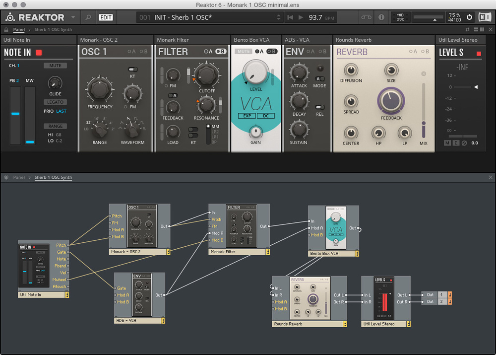

    Something like this :p
    Id imagine it will be much like Native instruments Reaktor. For me its sounding like you are creating the holy grail of control with 4.0

    @Trigen ,
    Also sources are still a doubt right now on the final visuals.
    Do i make a sigle line connection and choose a value from the available ones on destination,
    or allow the user to pick the value on the origin... :eek: what I have now, and it can be really crazy.
    Needs much thinking before going deeper, adding more sources and features.
    The base is 50% done, and it will be multiplatform. I'm
    Looks pretty close to it... ;)

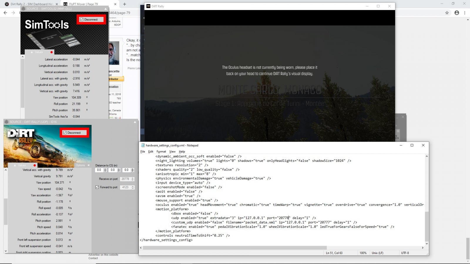

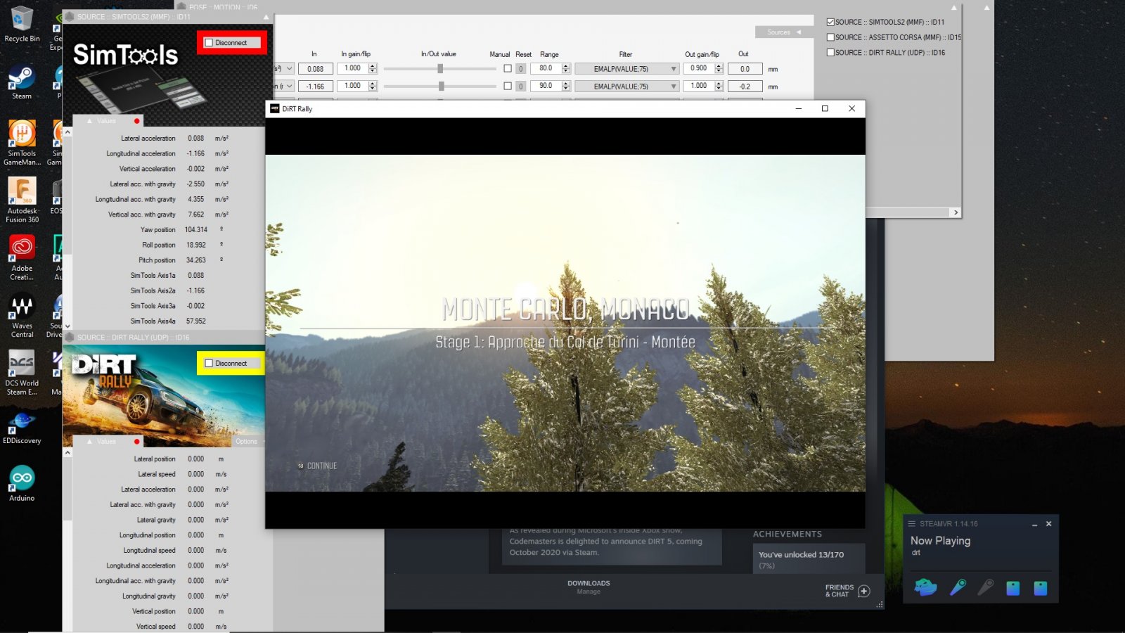

    Little question.
    I have Dirt Rally and I get value from Simtools, but not into the plugin of Dirt Rally. Am I missing something? Are the value equivalents?
    Right now the calibration is off and I want to make sure I use the right inputs before spending time tweaking.
    Thanks.
  17. pmvcda
    pmvcda aka FlyPT
    Nov 3, 2010
    2,288
    Portugal
    15,998Coins
    +2,740 / 18 / -0
    You can't use the same port more than one time.
    So if you get it with SimTools, there's no more data in Mover.
    You can get it in Mover by changing the port in the script, an Dirt source in Mover to match and forward to the normal port for simtools to receive it.

  19. Pierre Lalancette
    Dec 11, 2016
    1,012
    Tech Artist
    Quebec, Canada
    8,052Coins
    +947 / 6 / -0
    3DOF, DC motor, Arduino, 6DOF
    Okay, it didn't take long before I needed more help.
    "...by changing the port in the script..." which script? The one in the game plugin? If so, there is no example and I am not aware of the syntax.
    "...match and forward to the normal port for simtools..."
    Is the normal port of simtools is the same for everybody? If not, how do I get its right value?
  20. Pierre Lalancette
    Dec 11, 2016
    1,012
    Tech Artist
    Quebec, Canada
    8,052Coins
    +947 / 6 / -0
    It turned out I am not so hopeless after all. I have found the hardware_setting_config.xml and I edited it. I must have done it before because I had already a back up file of it. I was able to synchronize the port and even forward the information to Simtools.
    Now, all I have to do is endless hours of calibration.
