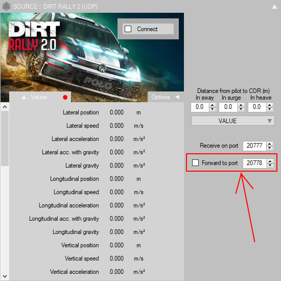

  11. pmvcda
    pmvcda aka FlyPT
    Nov 3, 2010
    2,248
    Portugal
    15,757Coins
    +2,688 / 17 / -0
    I can take a look at it.
    You can't.
    UDP output, broadcasts from all network boards on the PC to all ip's.
    If you want to separate the streams, you have to use different ports.

  13. pmvcda
    pmvcda aka FlyPT
    Nov 3, 2010
    2,248
    Portugal
    15,757Coins
    +2,688 / 17 / -0
    In Mover you can do it in all UDP sources also:

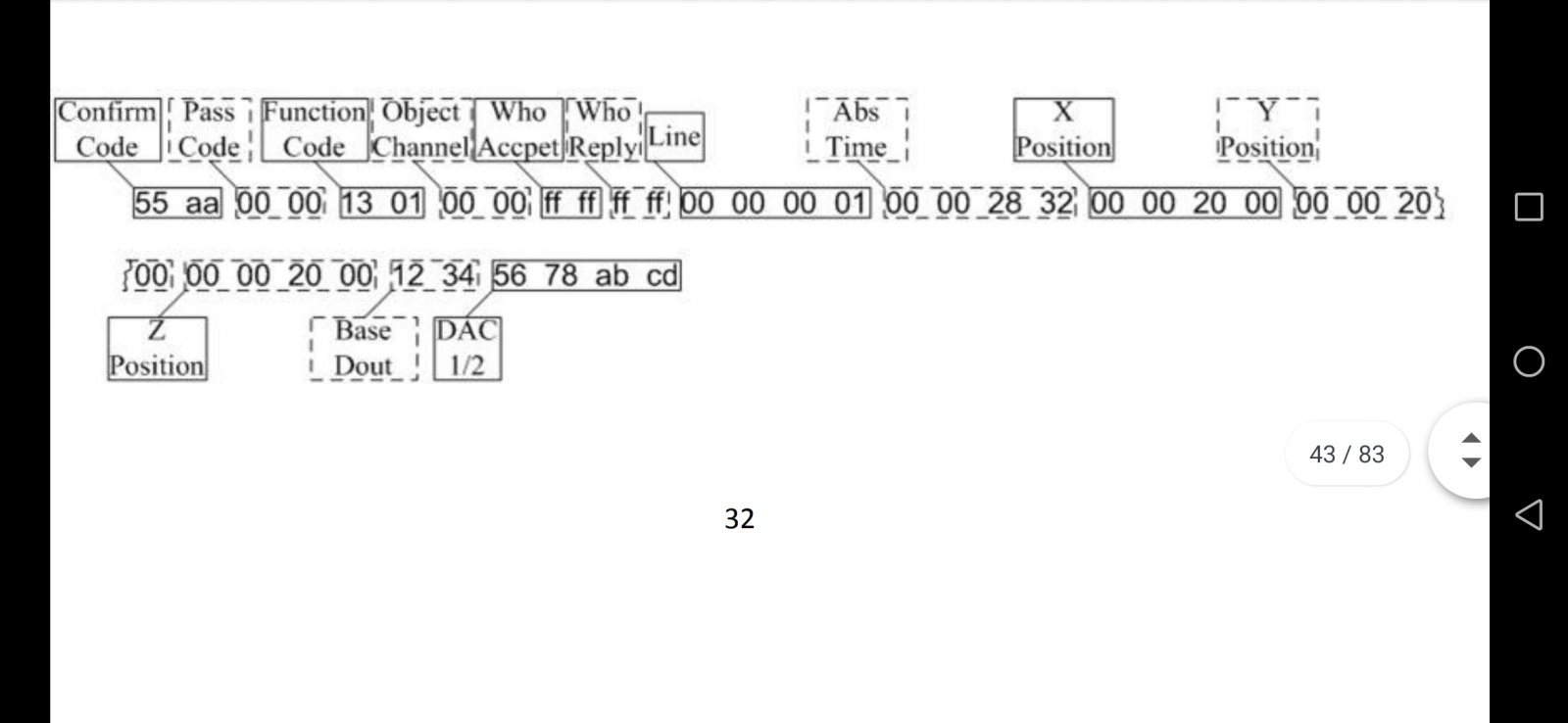

  14. Victor Urnes
    Victor Urnes New Member
    Jan 13, 2019
    20
    113Coins
    Motion platform, 6DOF
    Ok, then we would Just use multiple output with different ports. Is it possible for us to type on HEX in the string field?
    We are using the MDBOX, and is trying to get it connected directly to the Flypt. See attached picture
