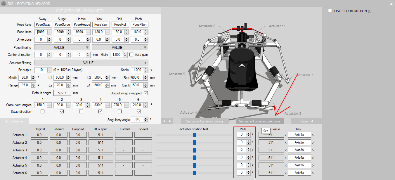

    I have rotating hexapod too. And I have Closed Loop Stepper motors with built in encoder. I adjust park position in Setting my rig. I unchek all checboxes, manualy change position with slider on every motor. Power turn off. Chekboxes check again. Turn power of my rig ON.

    @Levino Perrucci and @deadlymanager , You can set the park position of the rig in Mover.
    To do it, use the sliders to move the rig to the desired park position and in the rig module press the button "Set current pose as park pose".
    You can also set the angles or position (for linear) off the actuators in the red rectangle of the figure:
    By the way, this is a rig module for the new 3.0, there's some small differences, but in this area it's the same.
    The rig goes to park position when you disconnect the outputs.
    But if you have the Thanos board, you are going to have problems, because the board also handles park. The board waits some time, if there's no data received, she starts the parking procedure, the problem is that park procedure starts from center position, so it makes the rig go back again to center and move again to park.
    Resuming: If you have the Thanos board, better to use the incorporated park in the board and not touch it in Mover. For others, use the park in Mover.

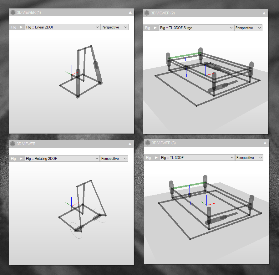

    By the way, in the new 3.0, we are going to have some more rig variants:
    Simple 3DOF
    3DOF with TL
    3DOF with TL and Surge
    Linear 2DOF
    Rotating 2DOF
