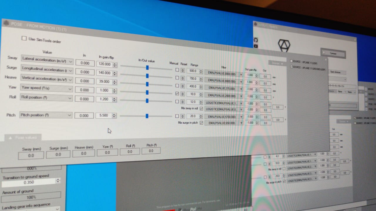

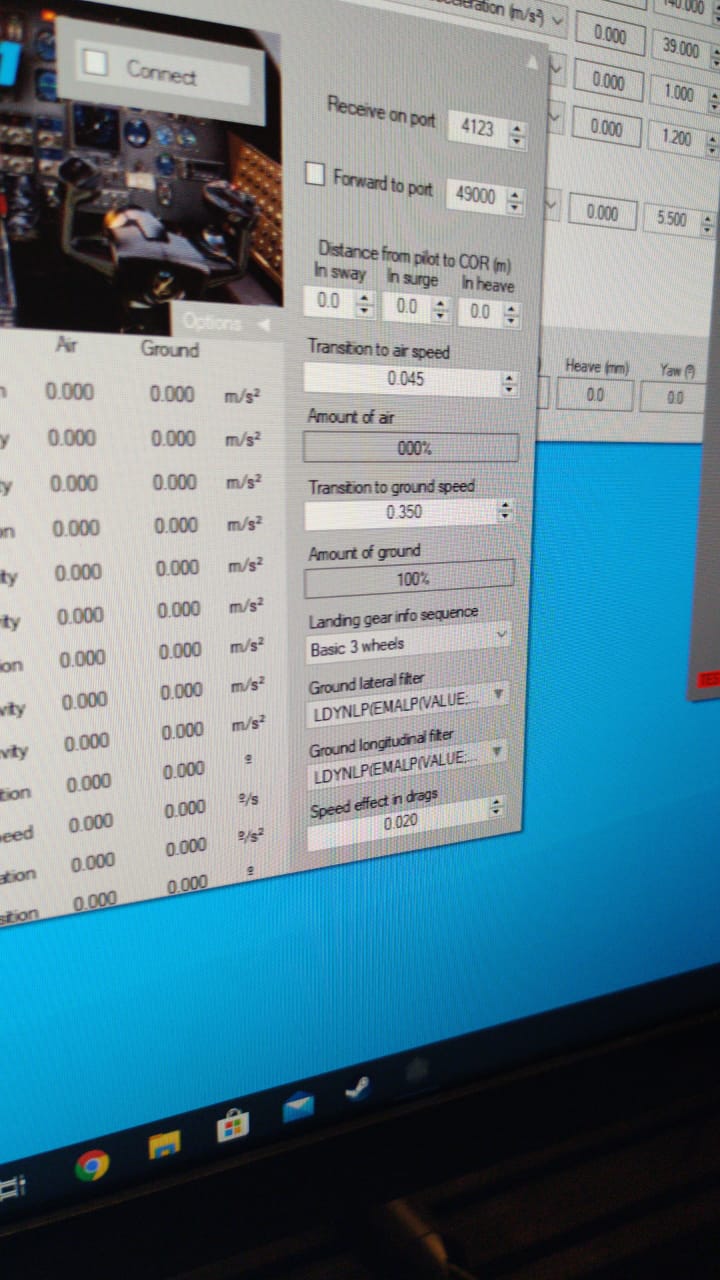

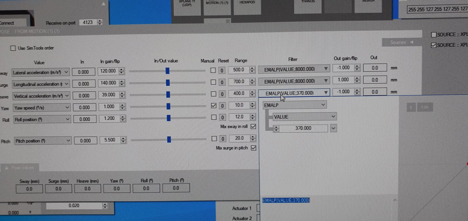

    Hello @hexpod! Thanks for the feedback. Follow my current settings. See what you think.

    Please attach the config file so we can open it

    Thats my preset

    Aside from the question of landing, I would also like I the surge and pitch mix to be more effective. The slope of acceleration and deceleration is still not good. If I increase the pitch "position" a lot, it gets "weird" with the variations of the runway. Also, I saw that if I decrease the Heave, it improves the efficiency of the serge mix, but it worsens the sensation of the runway shake, landing, etc. If I increase the heave, the sensation of acceleration and deceleration worsens. If you want to suggest changes to the profile I sent, feel free. I'm still a little lost, in these combinations, and even in the filters.

    I’ll look in your config file this evening

    This is what I could get with mover.
    Are you using a specific aircraft add-on ?

    No, Im using the default Xplane Airplanes, and on my profile, if I land at 100 feet per minute or 400, it doesn't make much difference and in real life, if I land at 400 feet per minute I can break the plane. Here the biggest difference I see is in the longitudinal (if a change the transition to ground), that is, if I land faster or slower. If I land at 400 feet per minute but it is fast, the landing will not be so bad when I land slow and 100 feet per minute. Did you understand?
    If you want to change my profile and send it to me to test, feel free.
