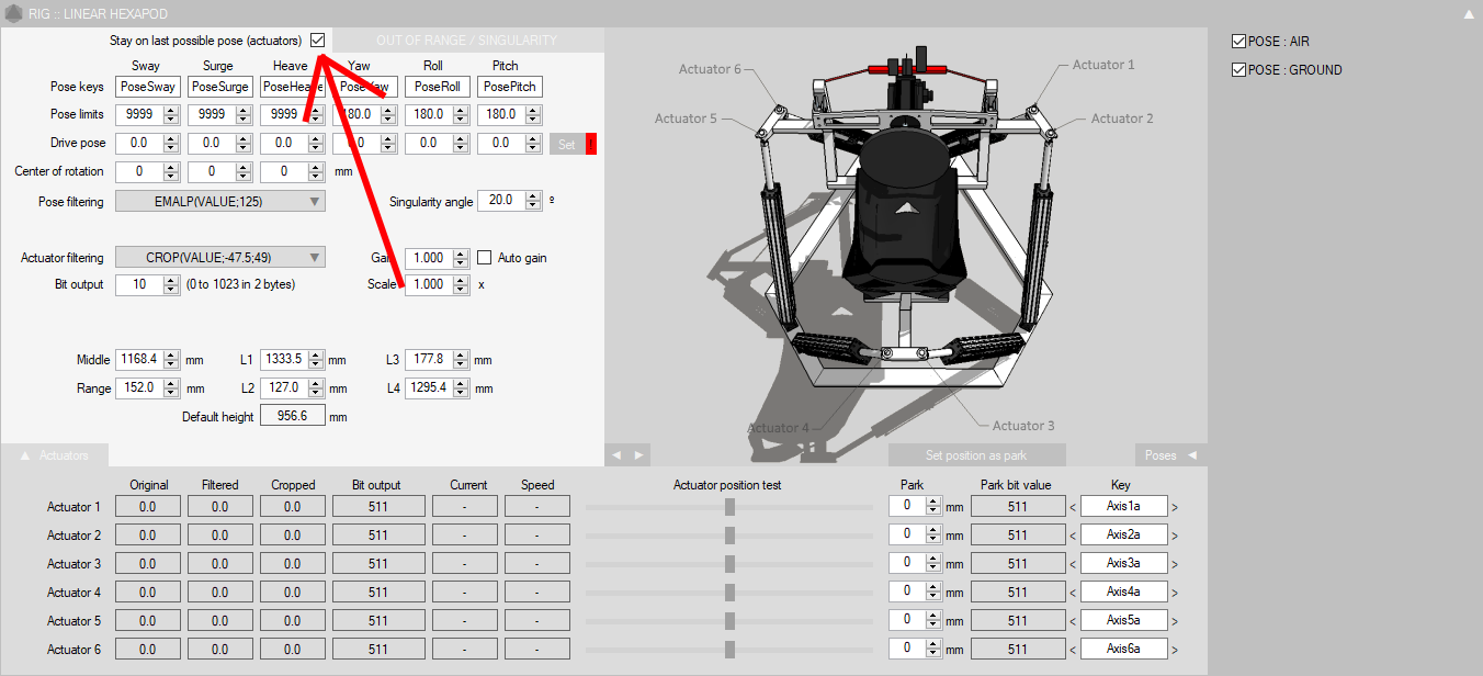

    I adjusted the logistics filter for poses in 2.9.9 as you mentioned.
    I still have problems...
    I played DCS World this time i monitored the behavior by watching the 3d view, and i can see that there is a short delay when the actuator movement catches up with when going in and out of the pose filter limits (and rig actual filter)
    Especially for its like for half second, I can see that the it pops into the position that it should be, there is a hint that it tries to level it self and then picks up..it happens so fast, but can be seen on the 3d view...(but strange, the sliders on the "actuator position test" of the rigs module move smoothly..)
    im uploading my Mover file...

    Ok, I see you have checked the stay in last possible pose:
    Try to un-check and see if that is still happening.

    yes that was it!!
    GOOD RESULT
    although i didnt do a test ride, i can see on the 3d graphic viewer that it is working well....
    IT WORKS not to have last possible pose un-checked!
    i will do a test ride shortly..
    but just for your info @pmvcda , in previous mover builds, i had to check it off and it was ok...maybe something is reversed for that option in 2.9.9?

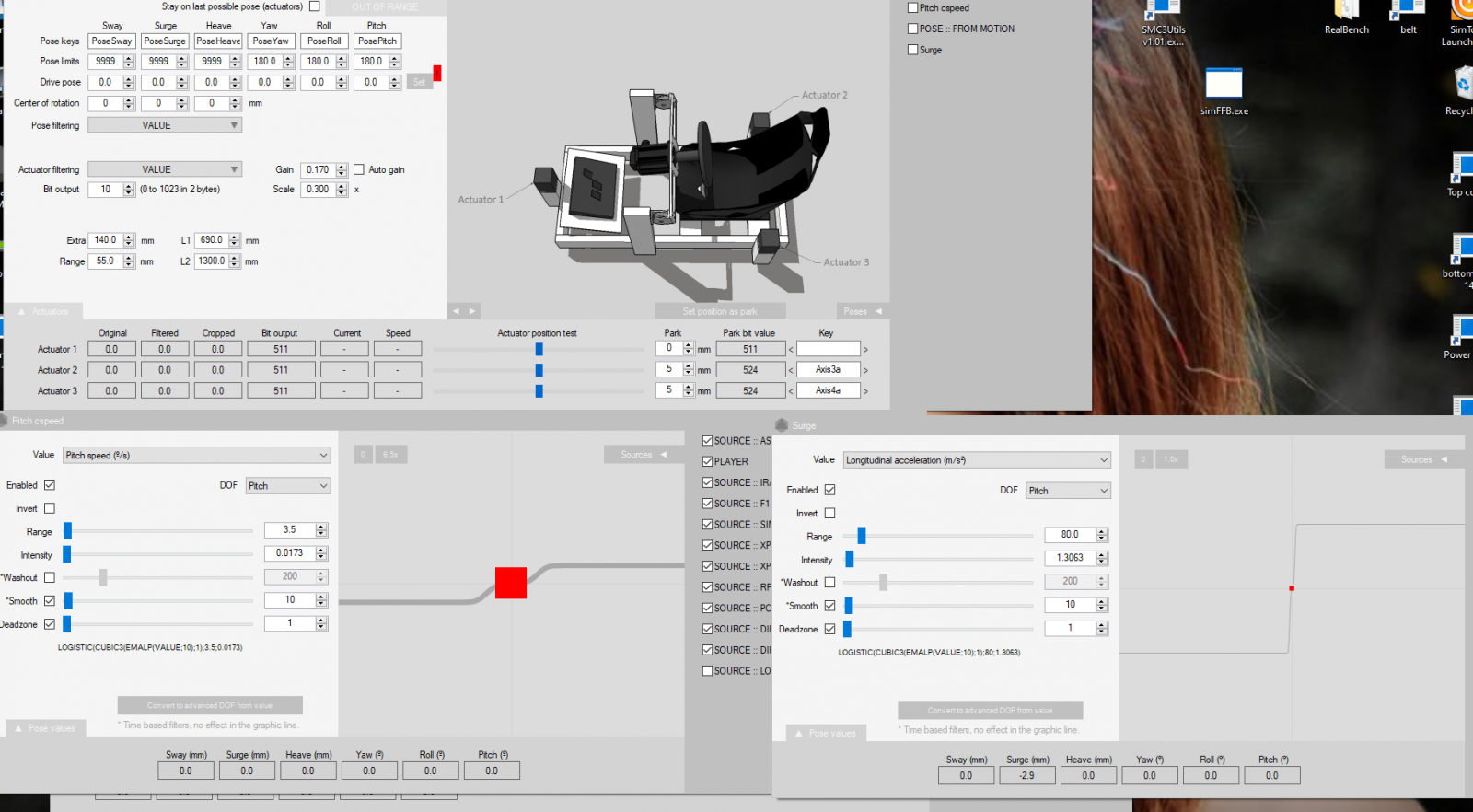

    I believe there's an issue related to surge and mix surge in pitch in pose from motion. If its mixed in any values you enter into surge wont do anything. Seems odd to me so i think its a bug. I havent tested any other versions. Took me a while to notice since as im sitting in VR and the monitor is far away when inputting values. Can barely see.
    Suppose i can get around it with using a basic dof from value.

    Another thing im seeing is that in the pose fro DOF if you have no DZ the slider and curves are acting very strangely.

    Another thing on the filters. I see the sliders have some massive ranges that seems way off to me. Fks the range which is the logistic goes to a 1000 and intensity to 100 000. Shouldnt these be to 100. Also the tooltip on Range is range is half the travel -15 15. Range is 30 which does not add up to the 1000 range. Sliders are not usable at the moment. It also effects the scale of everything
    Side note Turning the DZ option off instead of slider at 0 is a workaround but when i increase the deadzone the curve gets from straight up to more and more sloped. im sure you will see it.
