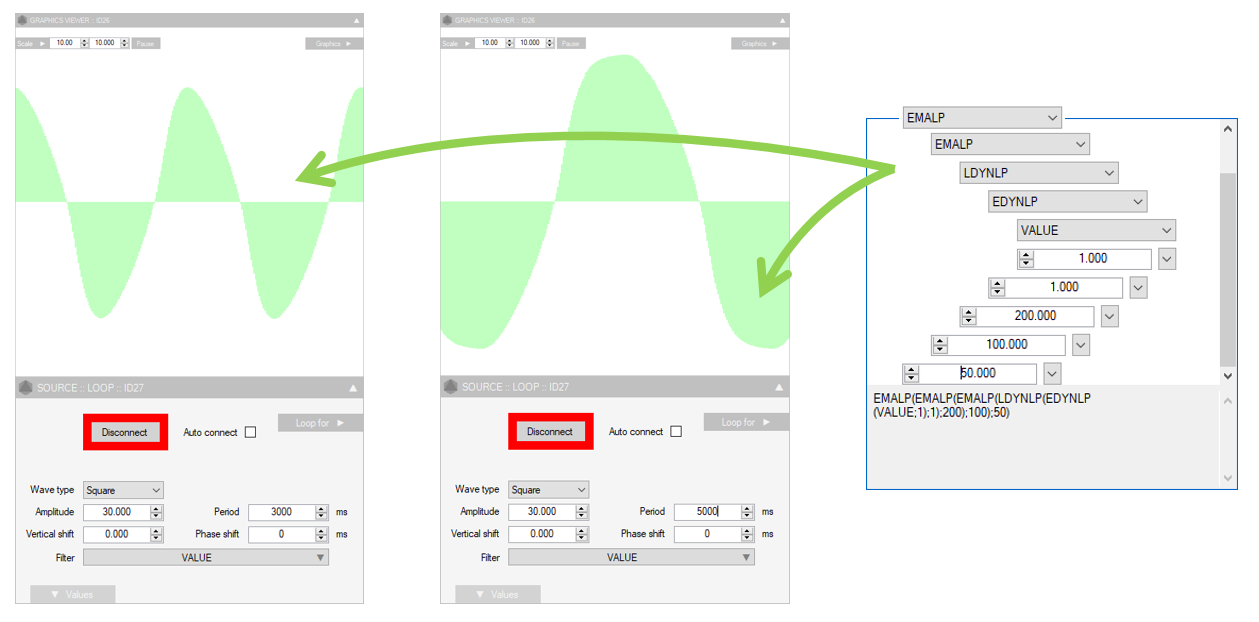

    Was thinking of this and the best solution I have, is already implemented for 2.9.
    And that's a EMALP(MALP;xxx);xxx)
    An exponential average of a median average.
    But it's not symmetrical.

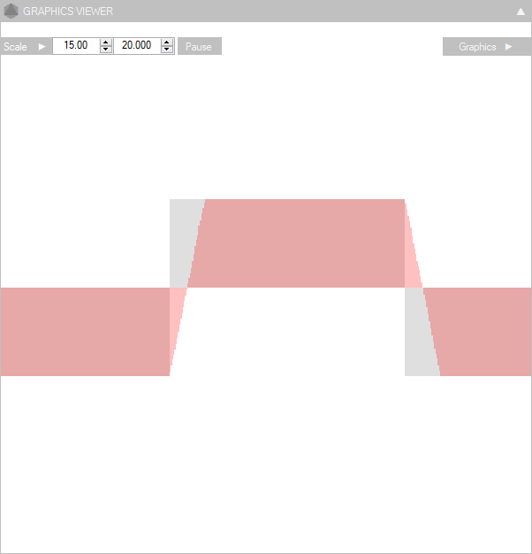

    MALP(VALUE;300)

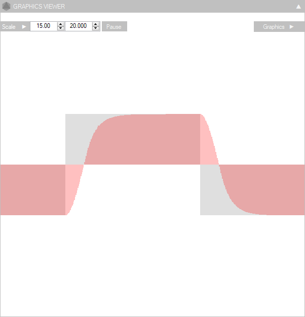

    EMALP(MALP(VALUE;300);300)

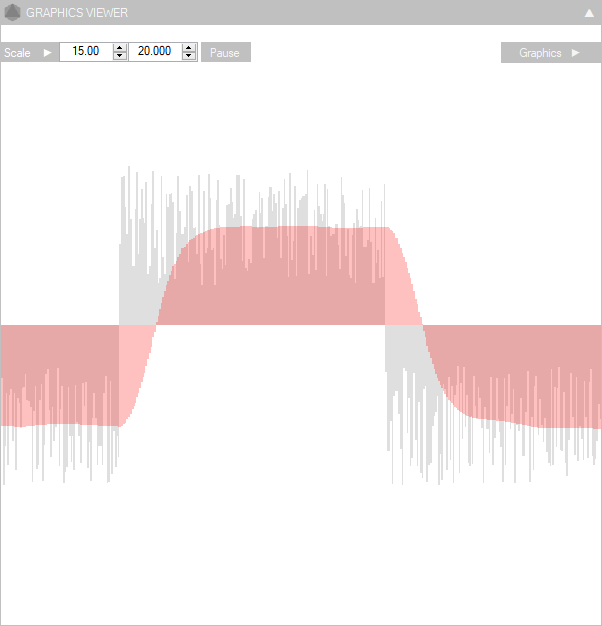

    EMALP(MALP(VALUE;300);300) with noise:

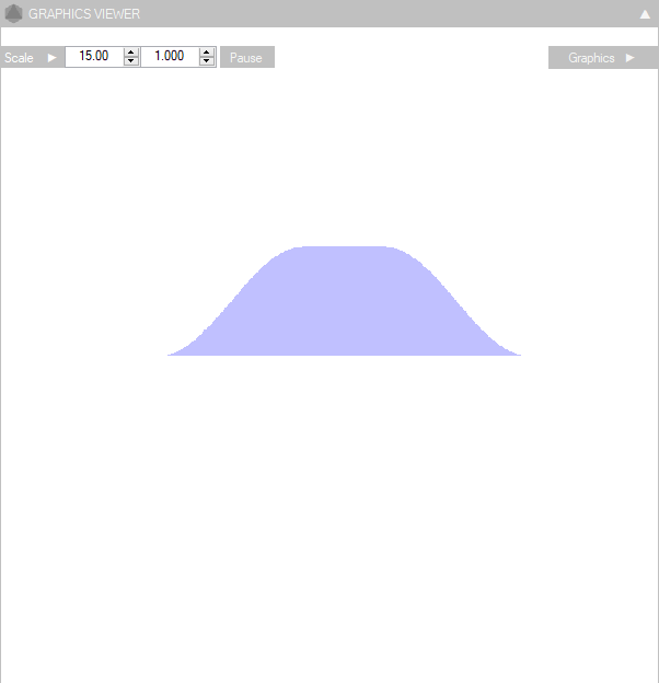

    Ideal was to have this:
    That's the soft start stop in the output.

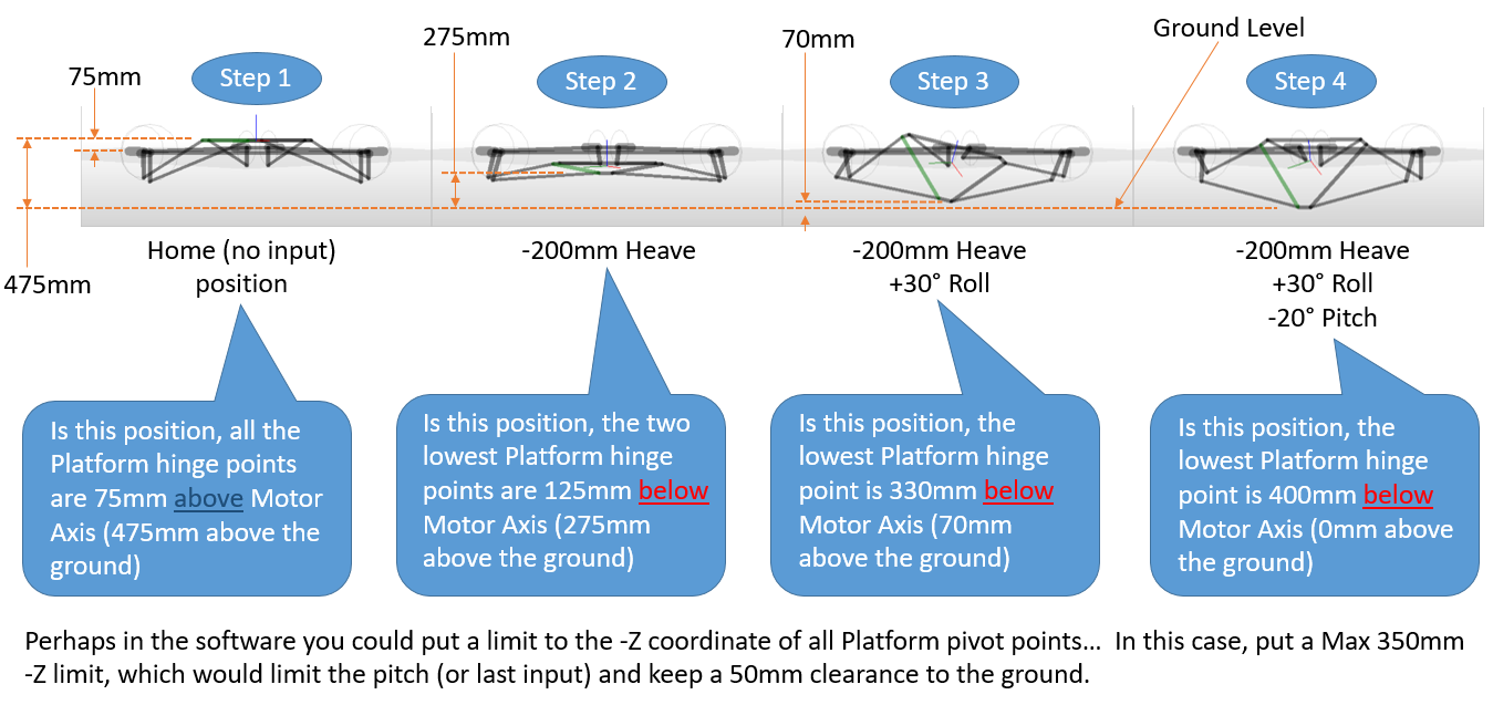

    Hello FlyPt,
    I have a suggestion for an additional check/limit feature for your amazing software, perhaps specifically for rotating hexapod (but not limited to).
    The idea is to put maximum offsets (horizontal and vertical) that all the Platform pivots can be from the default home axis position (no inputs).
    For example...
    You can design your rig to have a ±200mm Heave and a ±30° Roll and a ±20° Pitch. Mechanically, your rig can be put into all these extreme deflections at once with no kinematic issues.
    The issue is that these extreme multiple/compounded deflections could run your rig into the surroundings (ie. ground, frame, etc).
    Here is an example and more explanation...
    Ideally, you could put a max Platform pivot coordinate point value for all 6 directions (Max +X, Max -X, Max +Y, Max -Y, Max +Z, Max -Z). This would help protect surroundings from max. multiple/compounded deflections while still allowing for good deflection throws when max. multiple deflections aren’t the case.
    What are your thoughts?
