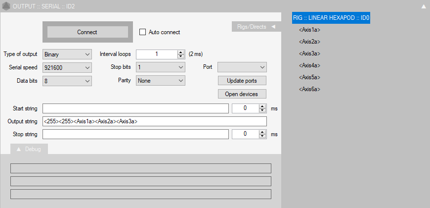

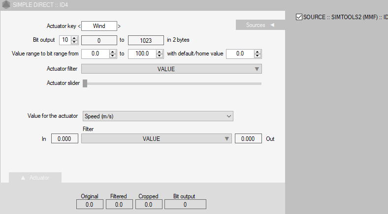

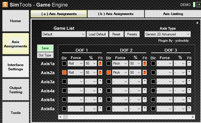

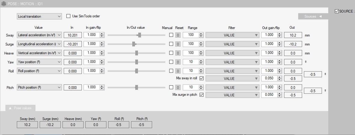

    Ok I have definitely hit the limits of my knowledge now, wow FlyPT mover, how does it work, I get the source and how to connect everything including simtools, but I cannot see any controlled movement in my actuators?
    They just bounce between max and min.
    What do I not understand?
    The actuator I built are flypt ones, any help appreciated picture attached
    Les

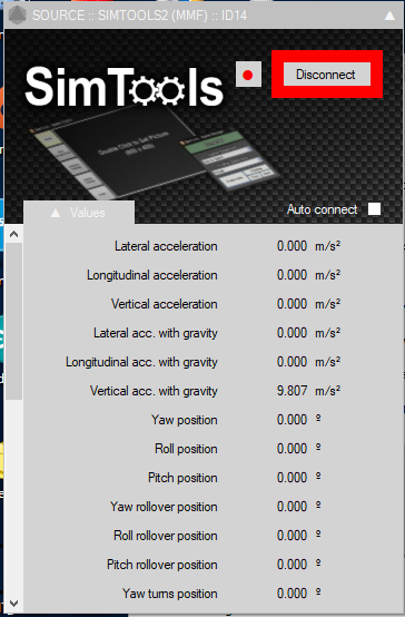

    For testing you don't need SimTools. Right now, you use SimTools for games that are not directly supported by Mover.
    In the output window, you have to use this:
    Since each board has 3 actuators, you need another output for the second board.
    By default, Mover comes with a loop test. Try to use it for testing. If needed, download it again. The default file has that loop or add it as a source.

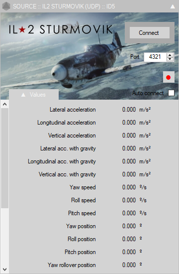

    Any chance we can get the IL2 telemetry as a source at some point? I believe it is just Yaw Roll and Pitch translations and accelerations so getting it up to par with simtools would be pretty easy I think.
    I have seen some people talk about pulling in traction loss from Yaw speed data and then using the loose DOF function to add it anyone have an example formula for something that would be useful?

    I would like to try and put it in. But IL2 is one of those that don't give telemetry, so we have to scratch everywhere to get it and then they make an update and we have to do everything again.
    Before going on this type of data capture, I want to stabilise what is currently done.

    Oh the main reason that I mentioned IL2 is that the devs exposed telemetry a few months ago which is why we have a simtools plugin now. If it is an easy job it would be great to have but worst case scenario I can just fire up simtools for that one, no stress :)

    Oh, did not know. Then it should be easy to add.
    Don't have IL2 right now,, but I will take a look at the telemetry.
    Add it to the list!
    Edit: A link to the telemetry info would be great

    Done. :thumbs
    New build in the next days. Give me feedback if it works.
