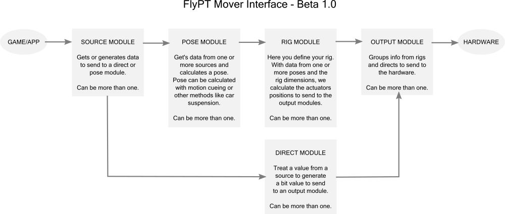

    Current state:
    Almost ready for first tests...
    Some strange names there.... made some replaces to rename some variables and changed labels also. So, I have some names to correct :mad:

    Just think like this:
    All modules receive information
    All modules treat that info
    All modules send out the treated info to another module
    Not all modules receive or send info to all other modules. Usually a kind of module sends data to another kind of module.
    The classification used right now is this:
    So for example, in the image I posted in the last post, that's something just for testing, unless you want to control two rigs with different settings at the same time.
    You can do it, but 99.9% of us are not going to use that feature. That's a consequence of the new foundation. Imagination is the limit (well, almost).
    I will be around to help.
    EDIT: The diagram is basic. Some info lacking. I will make a better one and post in the start of the thread.
