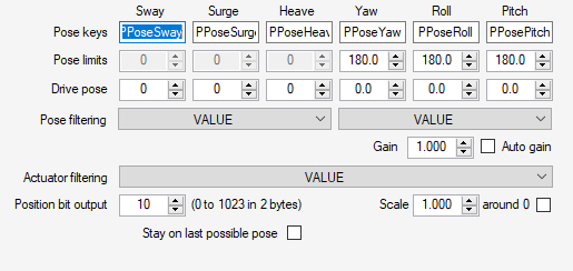

    Where can I find the parameter for maximum rotate angle of the motor? Pose limits are red and shown out of range.

    Hello Guys, I hope you can help me to solve my problems. I add a rig H3 because it is similar to mine DIY, 2dof and traction loss.
    Where can I set the axes limits? like in simtools? What ist the different between pose limits and drive pose? and how to setup when i want to add 50° up and 50° down?
    How can I invert, when motor one on dirve positive run right, and motor 2 positive drive left? Where can I setup which axes is which motor?
    I want to use "car blackbox" ore "form motion" or only for virtual tracker and stay with simtools for motion. But honestly I would like the motion to get from flypt, because i like the RPM and suspension motion so much.
    What to setup here:
    I will add an extra motor back to have at the back 2 motors combined to have traction loss and combined with the 2 on the front ability for heave. How to setup this then as rig? Do I have to choose '"just pose output" or 4 x "1 DOF with single rotating actuator"?!
    Maybe there is an dedicated flyptmover discord except of the thanos discord?

    afaik, pose limit is the max travel or rotation like a software limiter. Start position is normally from zero to a middle position (127 000) while drive position is variation from that middle point like a offset or shift.
    The software calculates the position change, the motor direction left or right is managed from the motor controller.
