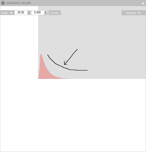

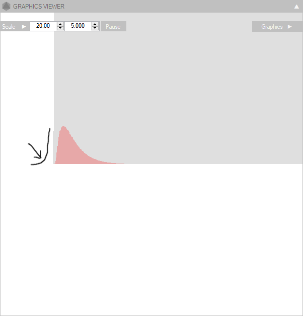

    I think everyone is strugling with this.
    Just as a reminder, we get full roll/pitch in aircrafts and rollercoasters. This is something we can ignore for cars (not yaw).
    Because of this I made some more filters.
    The idea is to wash the value, we want to feel the acceleration, but when she becomes zero or the speed is constant, the rig should go back to 0º.
    So, one of those filters is RWASH (R for rotating, you also have WASH).
    It washes the value to zero on rotations, ignoring the transition from -180 to 180º.
    It has the following parameters:
    RWASH(VALUE;a,b,c)
    where:
    VALUE is the value we are filtering (should be roll or pitch position in this filter!)
    a is the entry smoothenes:
    b is the exit smoothenes
    c is the history used, or the amount of the last values received we use.

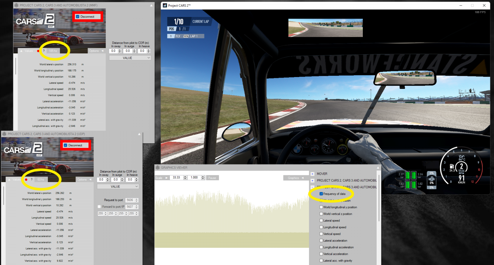

    I wanted to release this week, but it's complicated...
    To many changes under the hood...
    One of them made me go through all the sources again!
    So took the chance to get some extra data in most of them...
    And we are now getting the frequency of the data:
    Compairing MMF to UDP in PCARS2.
    UDP at 60 hz
    MMF associated to frame rate
    Let's see if I can release. Still many loose points.

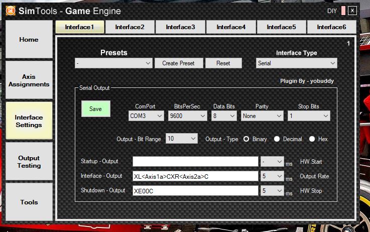

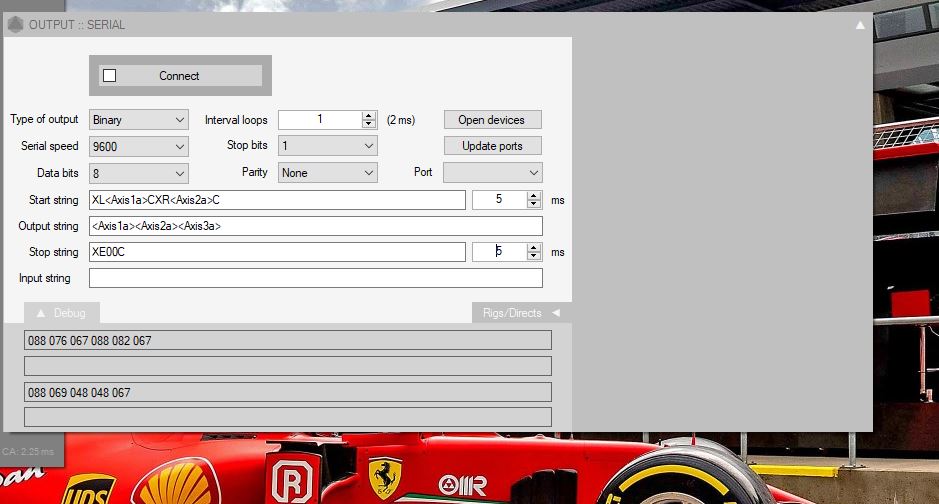

    Hello, I have three questions on FlyPT Mover is it compatible with the arduino code I use on simtools, it works with an arduino uno + saberthoot and finally I am looking for presets for f1 2021 thank you very much

    It works, just use the same settings in the serial output module
  20. bruno1210
    bruno1210 schumi06
    Jan 4, 2015
    134
    103Coins
    +12 / 0 / -0
    Hello, so the same setting as simtools I test thank you.
