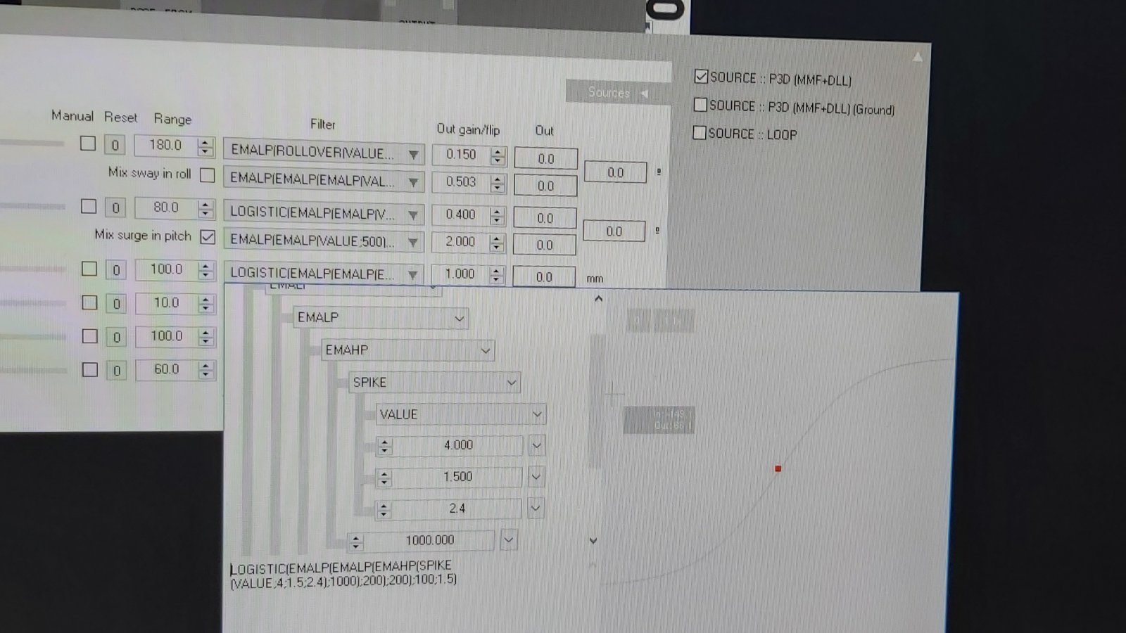

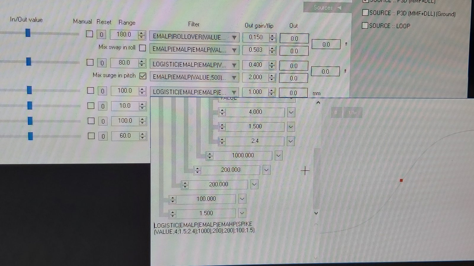

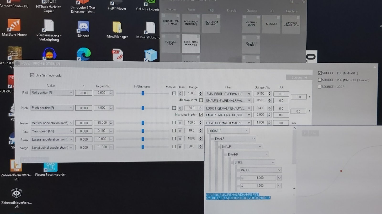

  10. PeterW
    PeterW alias Wickie
    Oct 21, 2018
    230
    Dipl. Ing. Mb (FH)
    1,766Coins
    +428 / 3 / -0
    Hi Mauricio,
    I dont know, if this will solve your problem or suitable for your type of sim, but I want to throw in my current settings for heave.
    I had sleepless nights to find them, but now finally give me the real feeling of flying.
    Wickie
