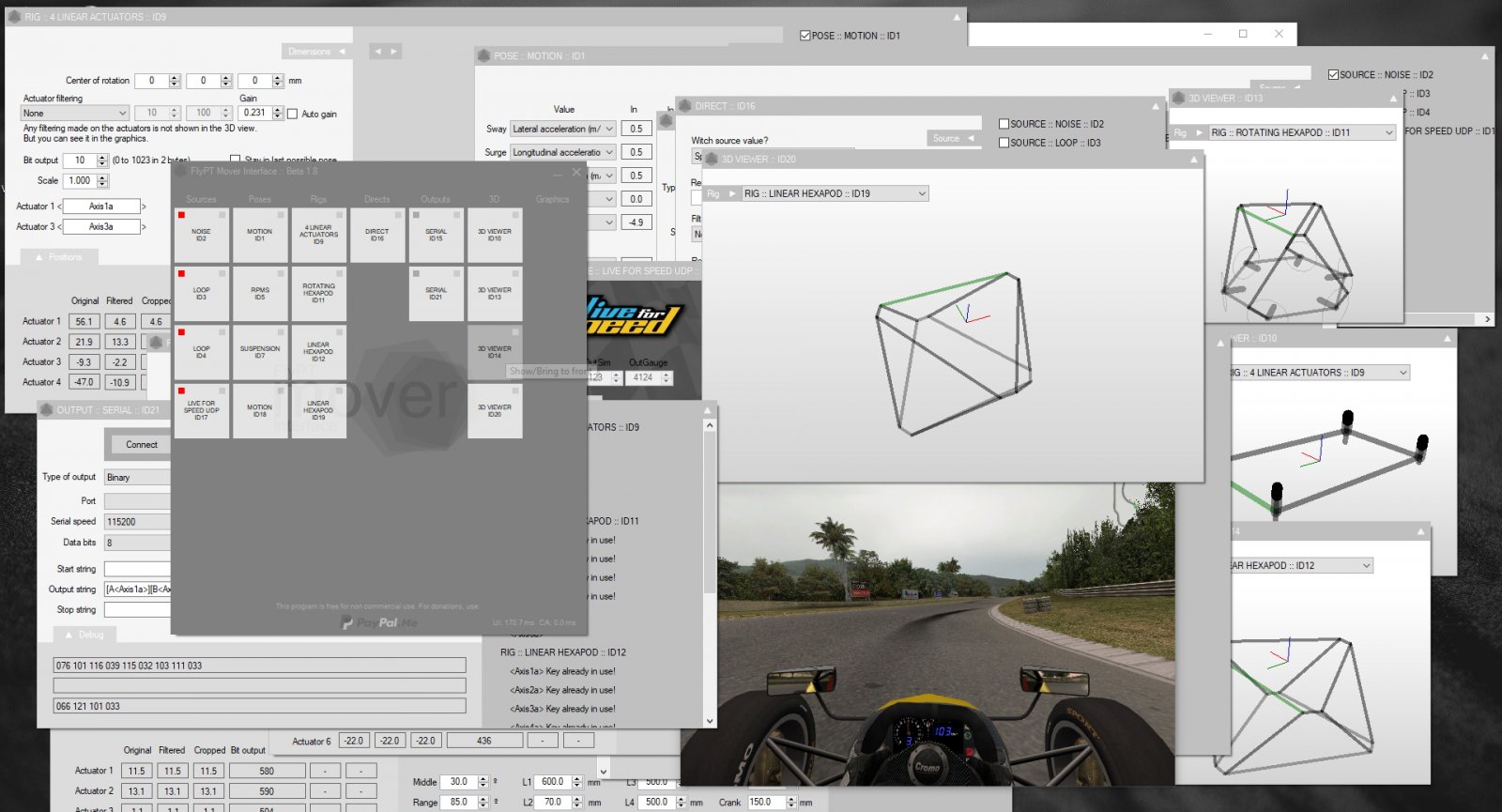

    OK, here's a new build (works only in 64 bits processors).
    Please read all the post!
    It's working for me. But threads are a nightmare, specially with all the modules.
    I still need to make some more reviews of the code.
    So don't expect it to work right away.
    Made some changes in Outputs that I could not test.
    Idea is to get some feedback from the last changes before continuing the update.
    Desired feedback on:
    -Does it opens?
    -Interface smoothness.
    -Output speed and communication.
    -Rig smoothness.
    In my tests, calculation speed is under 0.1 ms even with a good amount of modules.
    Unless I have made something wrong on the timer...
    See image bellow:
    So many modules, make interface updates slower, but that should not affect te calculation performance. At least significantly.
    Hiding modules certainly helps.
    There's some new features, that I already add in the background.

    Fought it was better to explain all the current problems:
    Program was working OK, but it was to slow on the calculation.
    That was causing problems on rigs that use fast actuators and interfaces, generating a pulsing movement.
    To solve it, I had to put larger chunks of code inside another thread. In the end all calculations are made in that thread, but making it work for multiple modules and in conjunction with threads to get data from games and threads to output data to hardware.
    Adding this to trying to put it working before vacations and errors that were already present, made it all went nuts.
