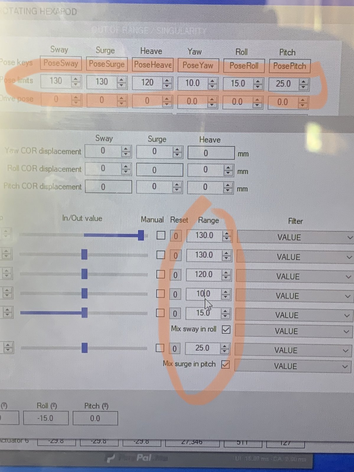

    Hi, I just uploaded a new video where you can see that the physical platform gets stuck even though the actuators in the mover continue to move. this behaves happens only when the rig is in the singularity event. I removed the filters in the rig as you advised and I attach the file in order that you could take a look.
    Thank you a lot
    Marco

    I think „out of pose“ means stopped movement for the whole platform even if only one actuator has reached its limit.
    Maybe I don’t look where I should but for now it’s looking fine to me.
    You just have to avoid those singularities by reducing the motion range of each dof or turn this feature off, which can expose you to eventual problems of not mathematically predictable poses.

    That’s not the way how I understand it. Mover can’t give you the pose with one actuator stopped.
    What you see actually is a hypothetical position which can’t be released by your physical platform

    Did you made your video with „Stay in the last possible position“ checked or unchecked?
    If it’s checked, I can insure you, that there is no magic to calculate a mathematically accurate pose with one or more actuator „out of range“, so the platform stops completely.
    On the other hand, when this feature is unchecked, what you see in the 3d Model when one actuator has reached his limit, can NOT correspond to the physical platform position by definition of IK.
    It needs all 6 actuators being „in range“ in order to send the platform to the right pose.
    It‘s how I see things unless I didn’t get the basic concept.

    I understand. Did you tried to match the „pose limits“ from rig module with range of pose module ?

    Actually I didn't, that's could be a good advice, I will try be next days than I'll let you know.
