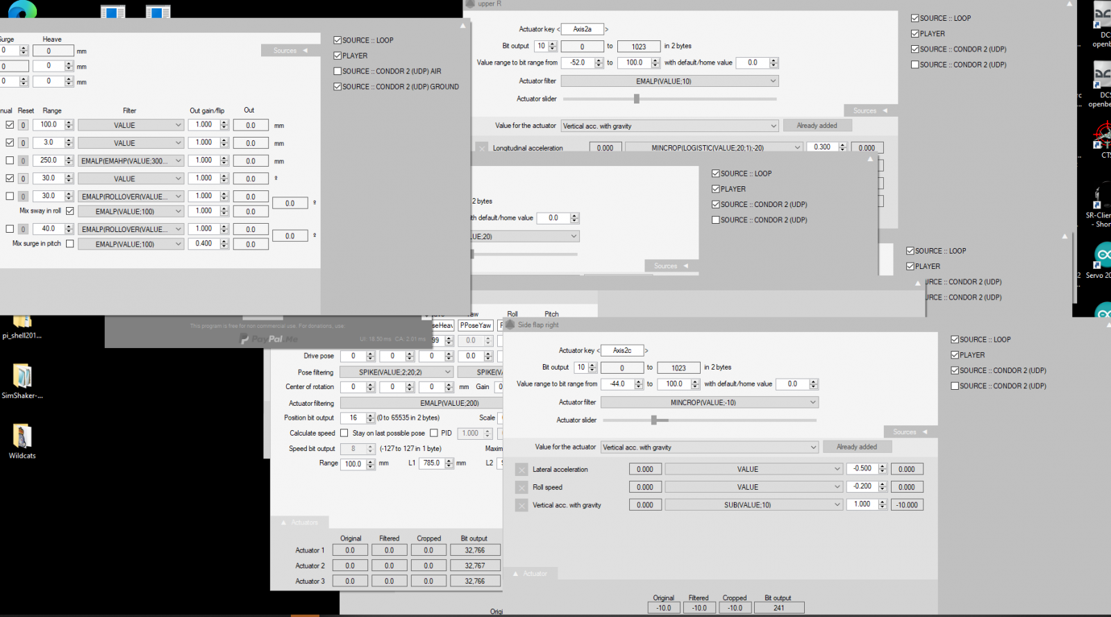

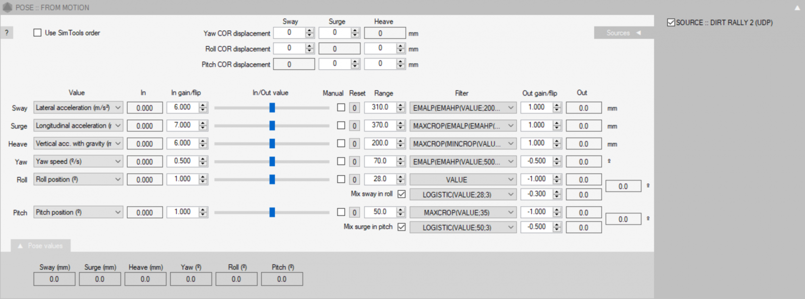

    I am having some issue to setup the heave in Flypt, can someone help me out.
    my 6d0f platform has heave scale from 0 to 200 (mm), I use vertical accel + gravity, which is 9.8m/s2 when vehicle is in still position. My filter of heave is MAXCROP(MINCROP(VALUE;0);200.00), this is to make sure the output value will be within my range.
    The problem I have is that when vehicle jump and landed, the output duration of that peak value is too short and so basically my platform don't have time to react. When vehicle landing, the value v.accel+gravity is reduce from peak value to 9.8. during this, driver shall continue to feel the extra g-force. To simulate that, the heave shall continue positive movement until the v.accel+gravity reach 9.8m/s2 again.
    Is there anyway we can have current_heave = previous_heave + vertical_accel * constant
    This way, as long as the vertical_accel is positive, the heave will continue raise to feel positive G
    and if the vertical_accel is negative (during air), the heave will continue lower to feel negative G
    I did above with my program (only work with dirt rally), and it work pretty good. I am wondering how to achieve something similar with filter with Flypt.

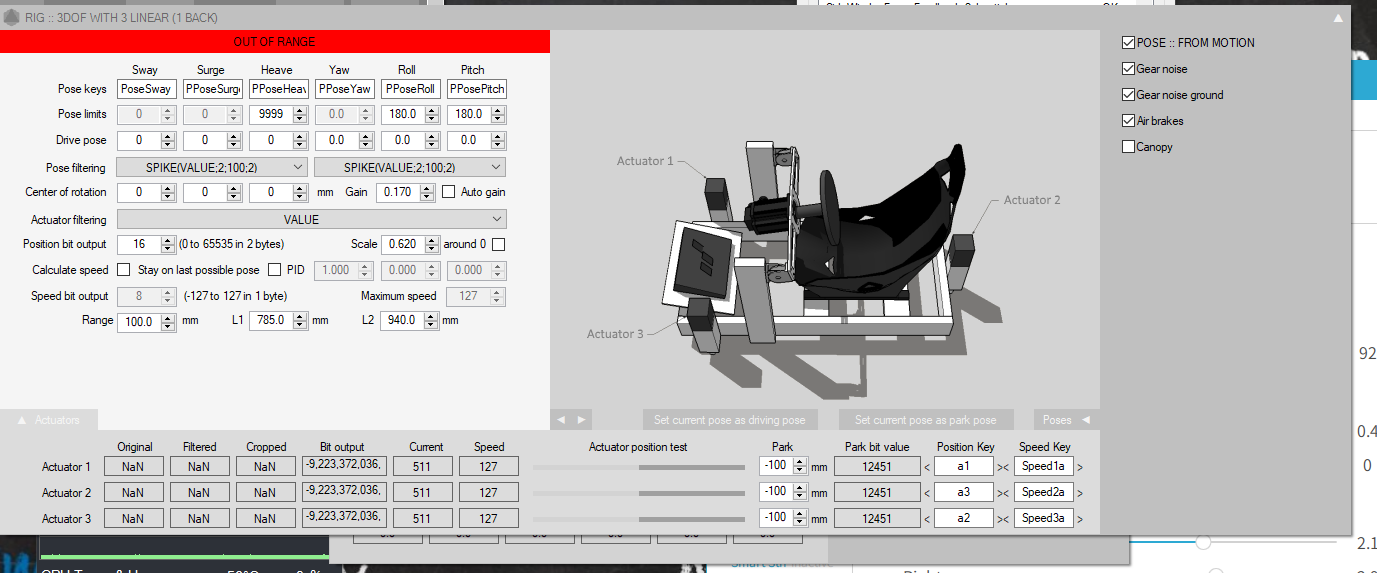

    I may have mentioned this earlier but has there been some major change to the Spike filters?
    I find until here we dont filter at 0 feels like its at 3-4 and its only for huge spikes. The other two inputs does work.
    Could this have something to do with the scaling and gain of the rig, it just dont feel right.
    the rig is set to 1:1 using a gauge on the rig so 10 degree is correct. i Find i need 5.000 (50 degree) in pitch/roll there if that matters at all
    I did a test with SPIKE 0:2:3 and it felt the same as 0:20:10.
    Edit.
    It seems that Spike filters now need 100 and 200 instead of 1 - 2 which is so far out of what i was using before that i just didnt test it.

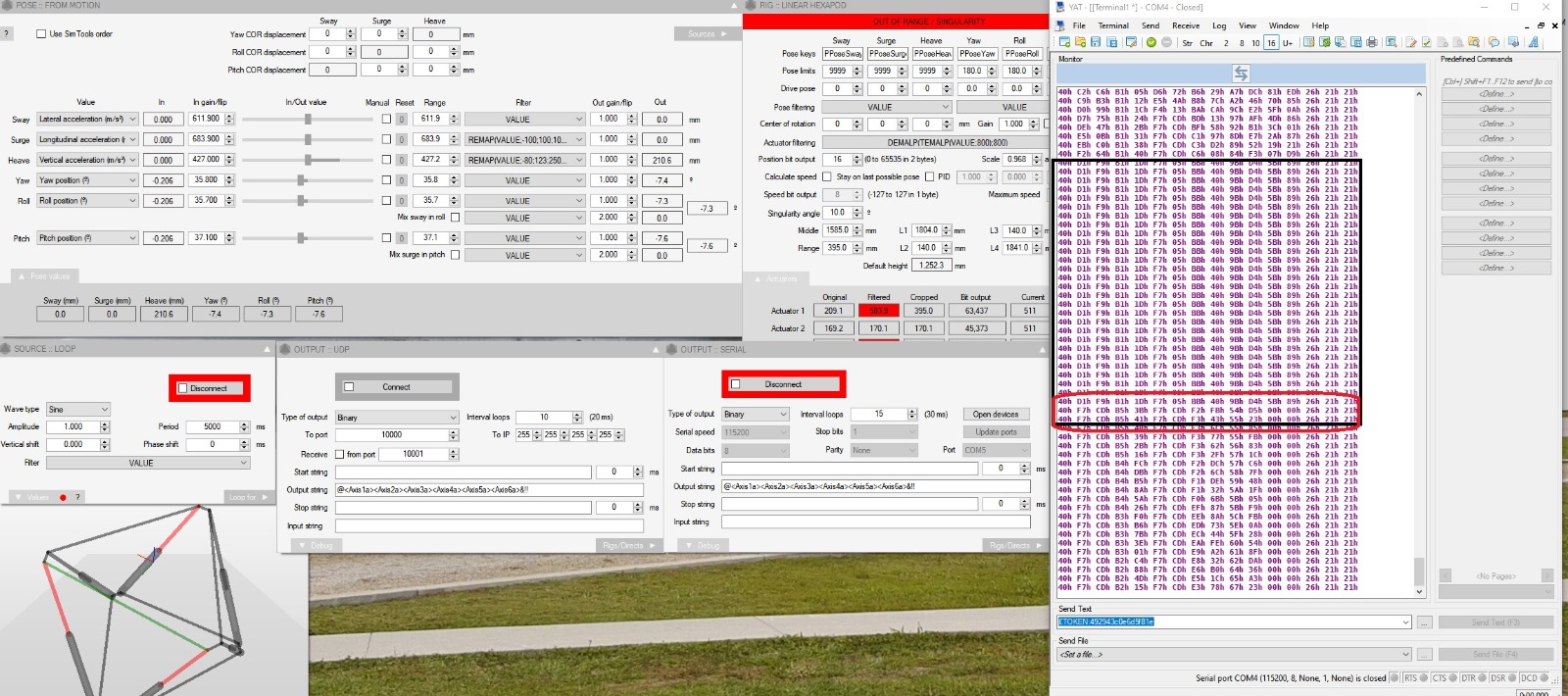

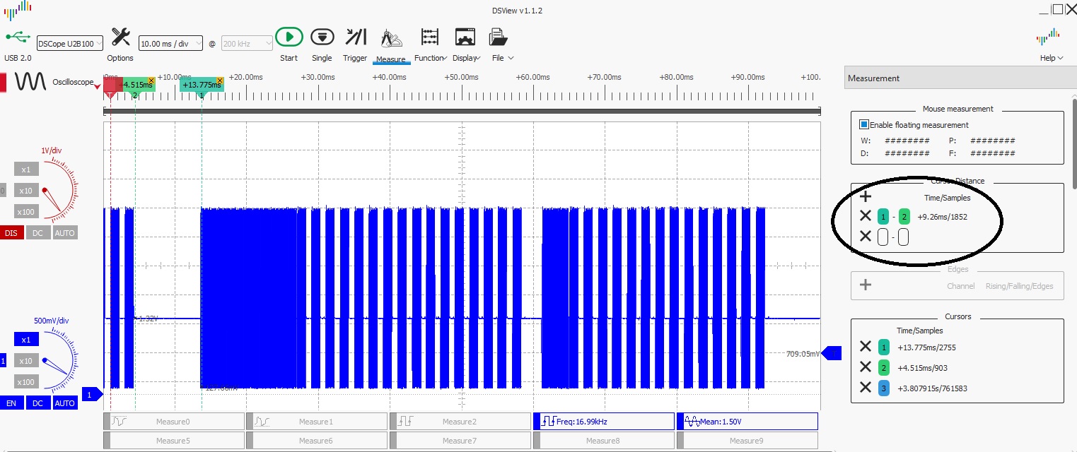

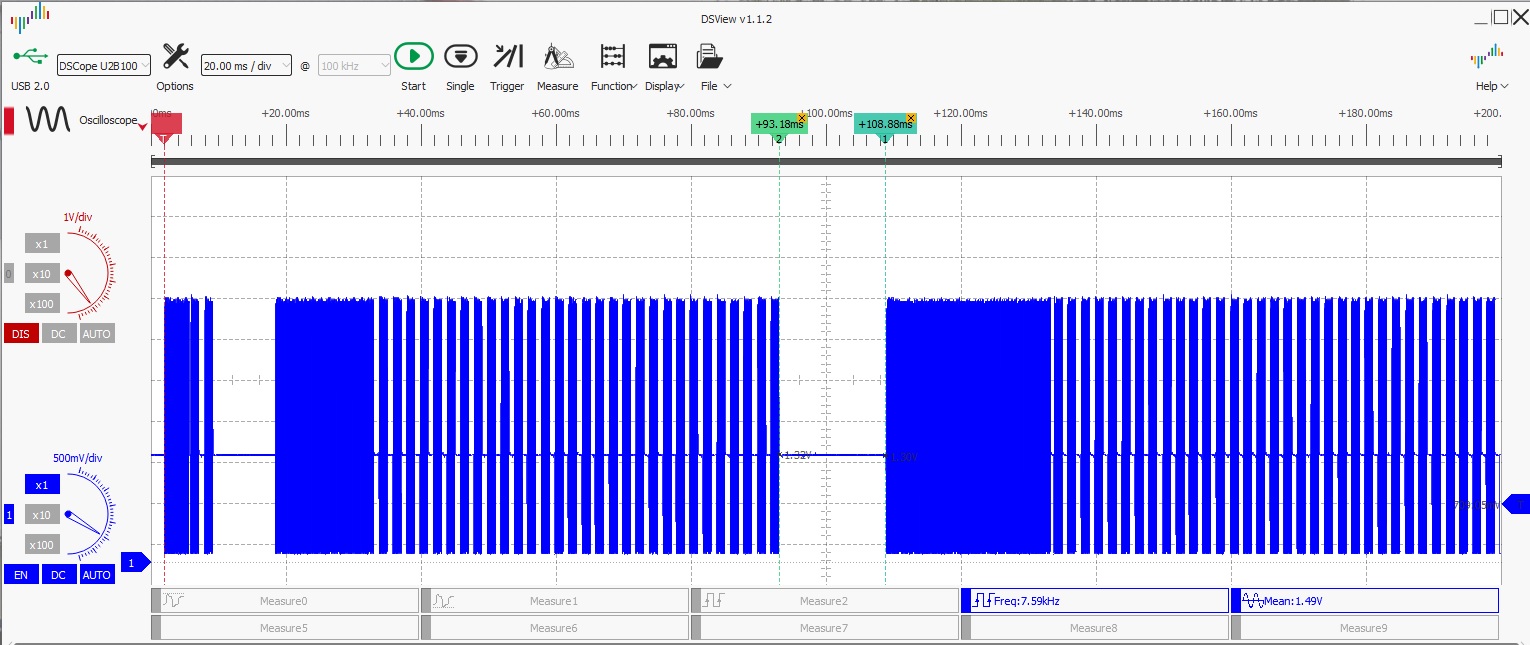

    Hello everyone,
    I got some issues with the serial output.
    I found a lot of lags in the serial packets, there some dangerous burst at 115.200 bps. There is a sort of expansion of the curve over time then the platform freeze for about 15 ms and restart very fast recovering the lost packages all in one time. It happens principally when the geometry gets out of range/singularity. can I remove these strange lags?
    In the two pictures with the blue pulses, is possible to see the delay just off the serial, tested with an oscilloscope. These show that when the singularity, or an always precise position, is reached, stop to send position for a while (about 15-30ms), then send all the buffered information all in one time so that a burst happens.
    In the picture with the purple numerical output, in the black rectangle of the serial log, we see that at a certain point the actuator goes into a singularity, he stops changing his position, but the others keep moving. shortly afterward, going forward, downwards, we see that all the pistons stop.
    In singularity, there is only one, or maybe two
    but the worse is that, in the red box, you see that when they start to move again, one actuator continues from the point where it stopped, but the others jump by thousands of impulses ...
    In case, I could send some video of the rig
    I don't know if I'm been able to explain correctly the issue, I hope that someone could help me

    I chaged something in the spikes....
    But with so many updates I'm now lost. I have to look better to the code. But I know it was wrong before.

    @Marco Annunziata,
    The problem, seems related to some mix in the ui and calculation thread.
    Looking for that hole right now.

    The rig will jerk as its got lots of noise on and go up to about where it should but just spike all over the place. Feels like it has something to do with the spike filters.
