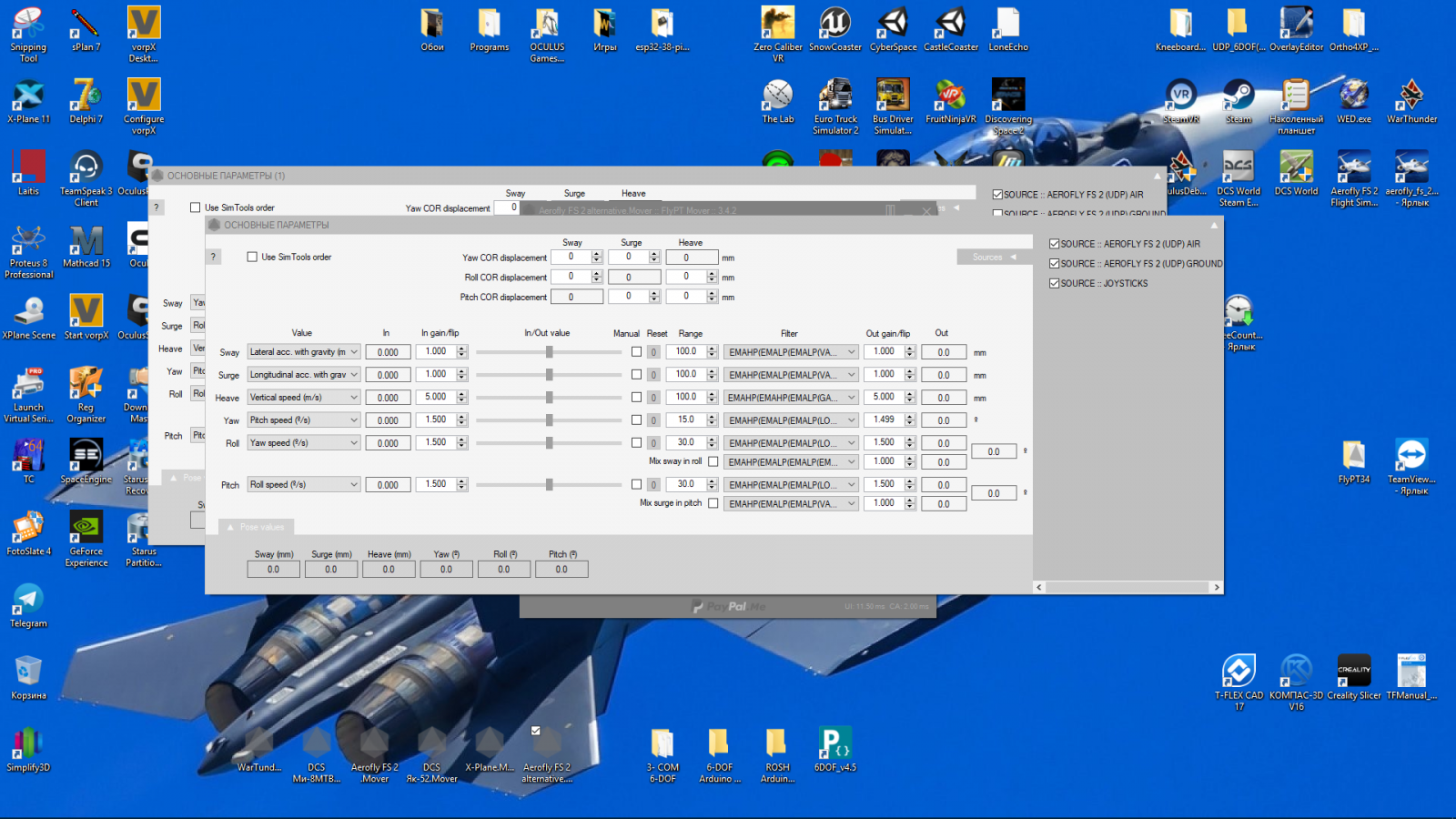

    In Aerofly FS2, if I control fly by acceleration some parameters is wrong. At this screen all right. Look at this. Yaw, Pitch and Roll speeds send wrong data.:cheers If you set the parameters to match, the platform performs incorrectly. The telemetry value is assigned to the wrong variables from Aerofly.

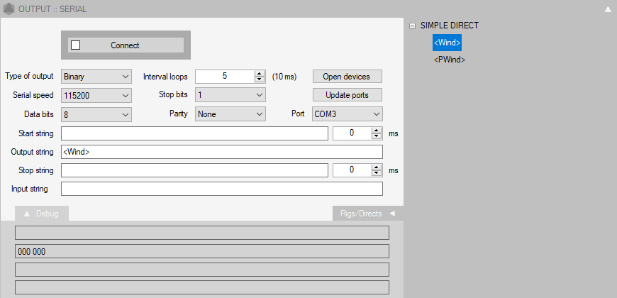

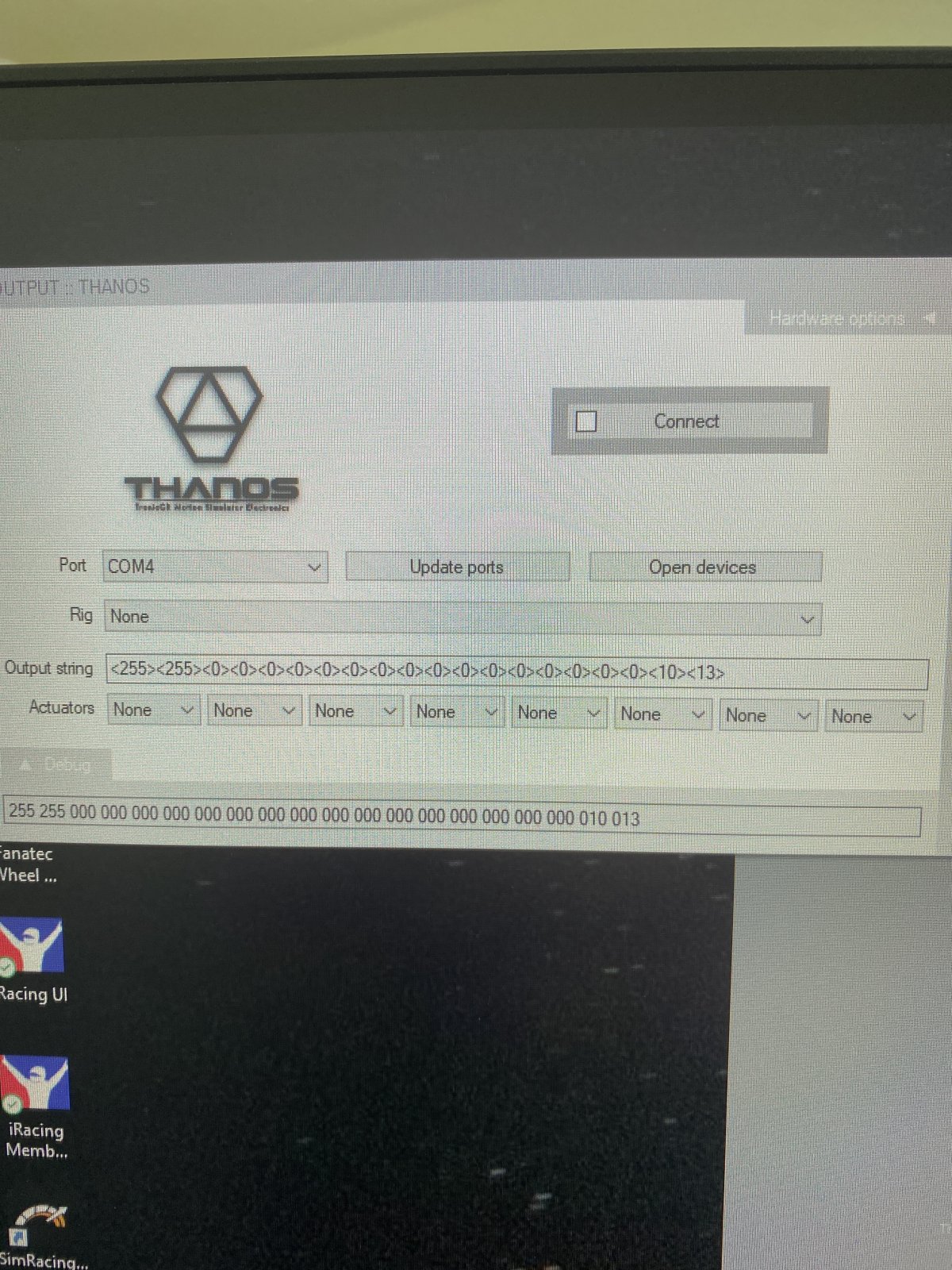

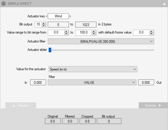

    In Mover:
    #1: Add a simple direct
    With this we are going to control just one actuator.
    Put those settings:
    The EMALP(VALUE;300) is just to soften the movement or it might get crazy.
    You can replace it just with value.
    #2: Add a serial output
    Here we are going to send data to the arduino
    In the output string use the <wind>, the key given to that actuator
    Now in the Arduino you need some code to receive the data and control the hardware.
    Now this depends on what you are using or if you are doing everything from scratch.
    Tell me what you have.
    To control the actuator manualy, you can use the slider in the simple direct.
    By the way, I'm setting the actuator to 10 bits in that direct.

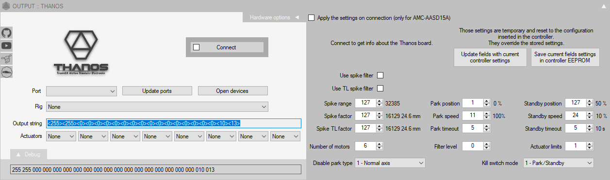

    I found out that a Thanos AMC AASD15A - RGB V1.4 would be perfect for my project since it’s plug and play and easy to use with Mover, am I right ?
    I plan to build a 3DOF rotary platform : 3 servomotors : 80ST-M02430 (AASD15A driver included).
    I’m not sure about the rig, should I go for a rotary or linear rig ? I don’t know if one is cheaper but less efficient or something ? I think I will have like 300kg of payload, would you recommend me a gearbox/linear actuator/nothing ?
    But I may finish by 6 servomotors, depending on the performances of the 3DOF system.
    About the joystick, I’m looking for something to completely control manually my platform, included : roll, pitch and yaw. Do you have any recommendations ?
    Thanks for your help

    Go for 6DOF if you can.
    In Mover you can use the joystick to move the rig.
    You can assign any of the usually received values from the games to a joystick input.
    Then you use it to move the rig pose.
    This allows the use of the joystick in games without telemetry.
    Mover has a specific output for the Thanos controller.
    It makes use of the controller easier, but you still need to understand how motion cues work and how you cen set them in the pose module.
    For more info and help, look at flyptmover.com

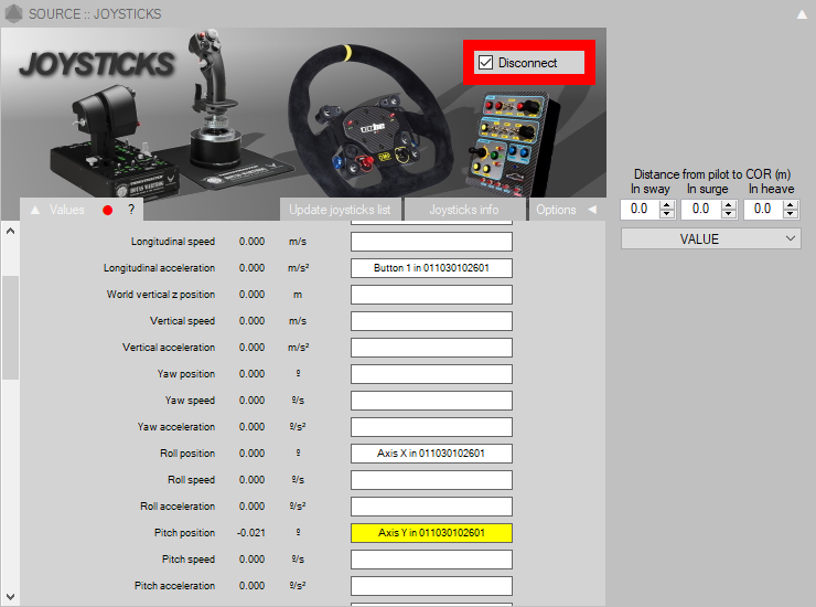

  12. pmvcda
    pmvcda aka FlyPT
    Nov 3, 2010
    2,266
    Portugal
    15,866Coins
    +2,709 / 17 / -0

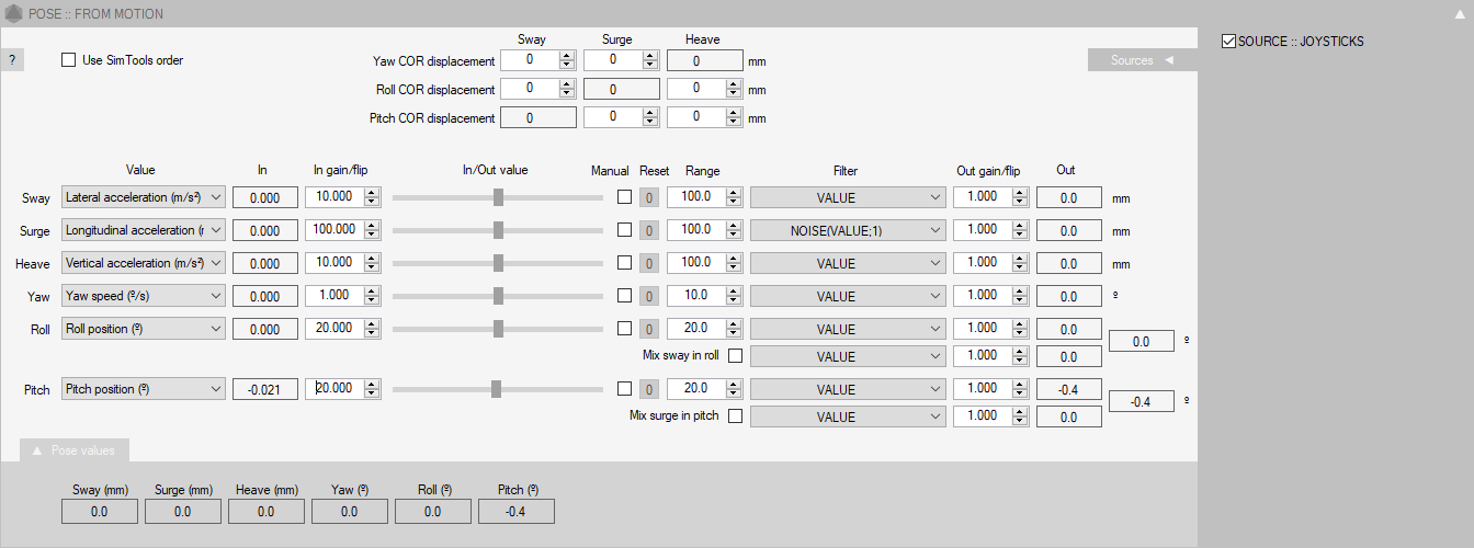

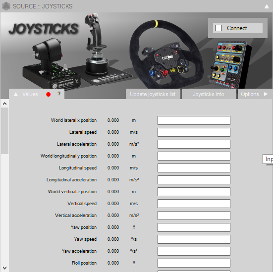

    An example:
    Add a joystick source.
    Click on the Roll position (get's yellow) and move the joystick axis you want for roll to detect it.
    Make the same for pitch.
    On the longitudinal acceleration, click on the fire trigger of the joystick (just an extra test).
    Connect the source.
    Now add a pose from motion
    Put the above values in the fields.
    Notice on the right, that I checked the joystick source. It means I want to use it's data in this pose.
    Also notice, that I put gain in the received value (left).
    The values sent by the joystick are between -1 and +1, so I use 20 to make roll between -20º and +20º, same for pitch.
    I'm not mixing surge and sway in roll and pitch.

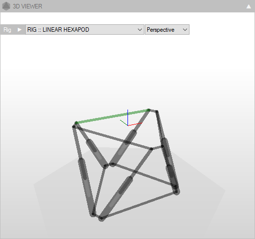

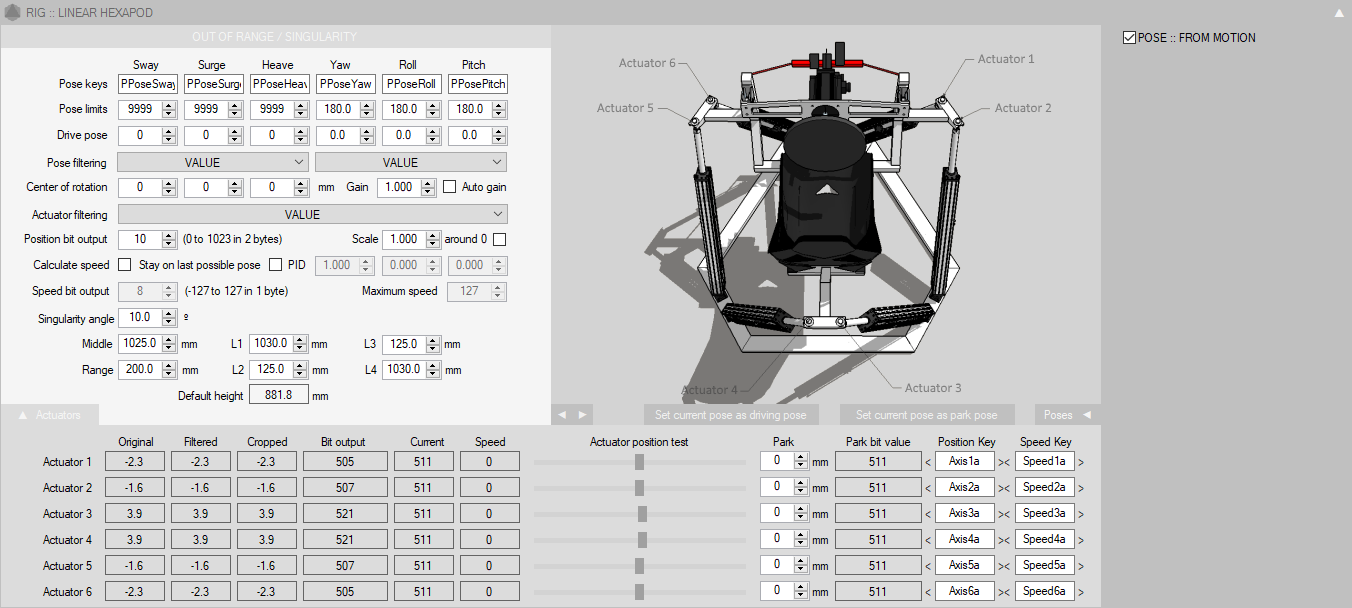

    Now add an hexapod rig
    In the right say check the pose you want to use in the rig
    Add a 3D viewer to get a glipse of the result:
    Front of the rig in green.
    Now move the joystick and press the fire button.

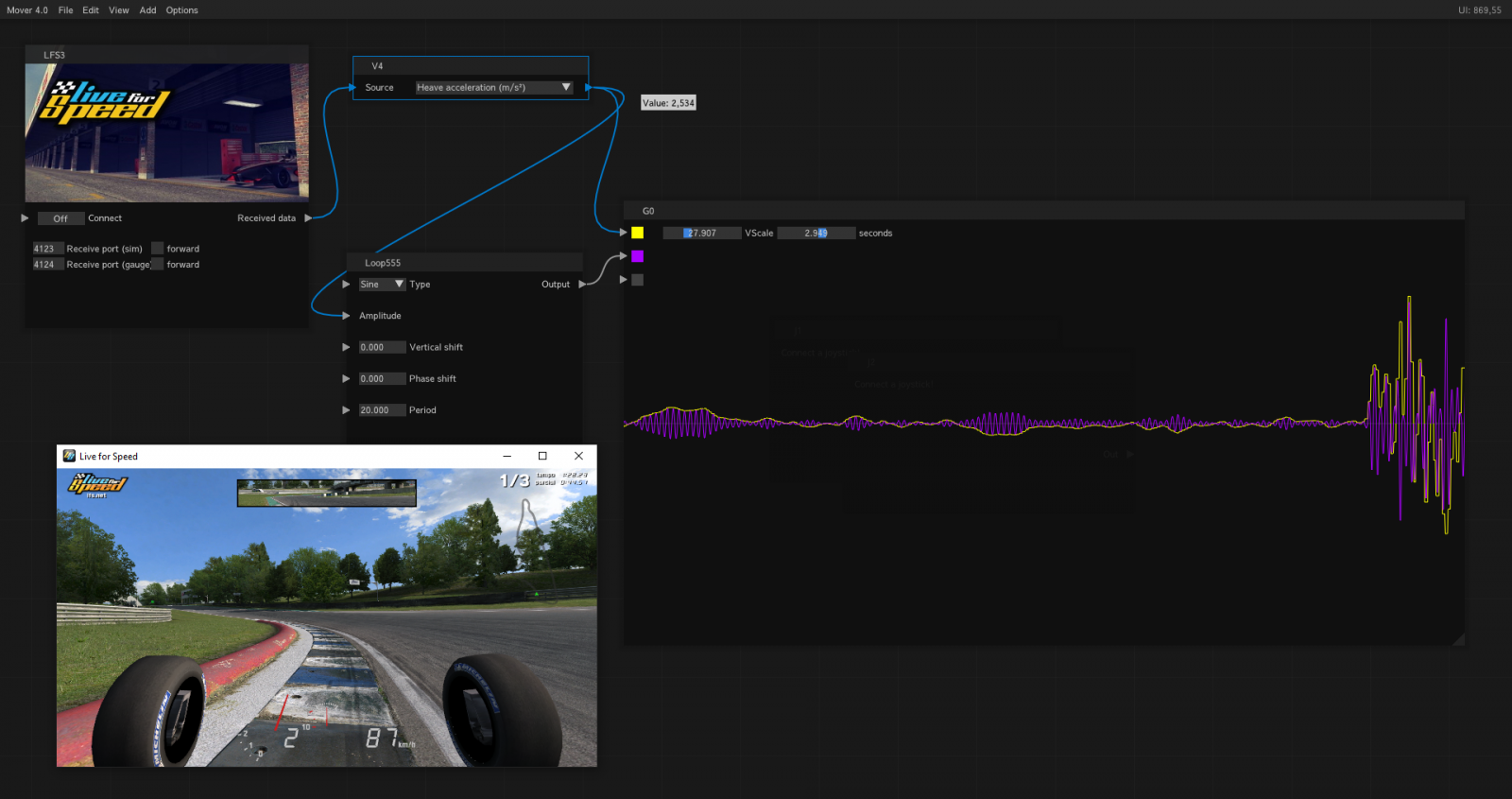

    Not posting much,
    but here's a new shot from the work in Mover 4.0:
    Oh, we can zoom and pan, so we can make it huge:
    I know I posted something like this, some time ago, but just solved a major base problem.
    Really happy with the progress.
    And it's running pretty fast (look at fps on top right corner).
    Runing in two threads and compatible with at least Linux for now.
    Fingers crossed. ;)
    Most of the rigs, filters and code made for current Mover is now almost copy/paste.
    But it needs more time.

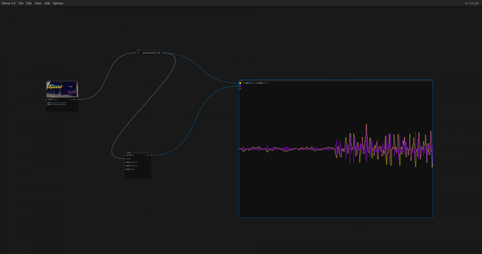

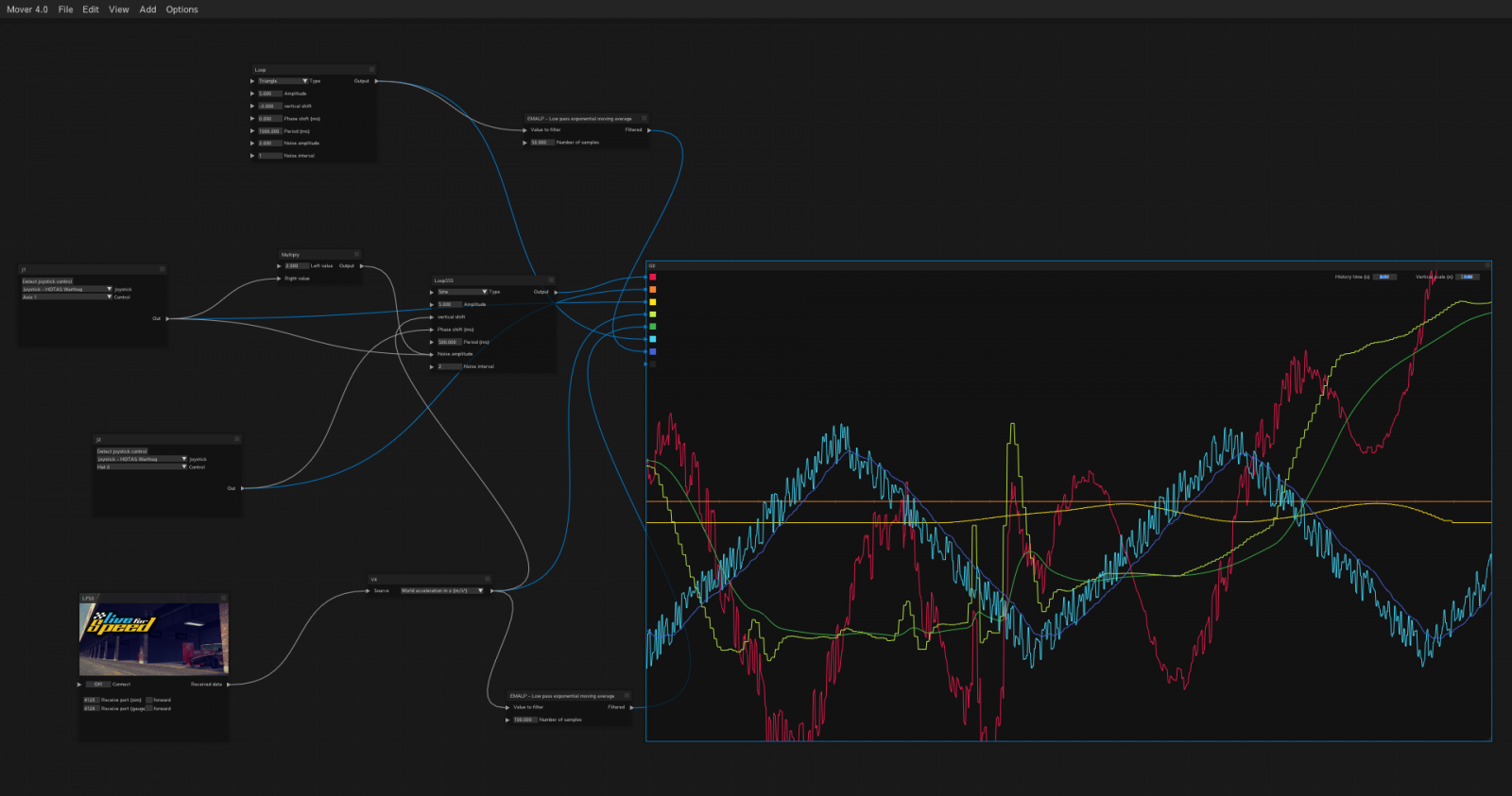

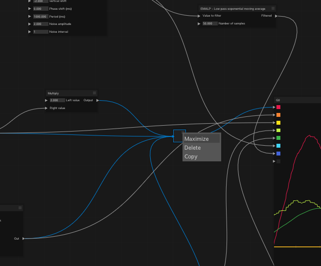

    Seems to be working well:
    Still some bugs on the base system.
    So how it works?
    This is composed by Nodes, shown has windows.
    Each Node has input Pins and output Pins.
    Inside the nodes, we perform the operations, like filters, get data from games, visualize data in a graphic, logic...
    But here, not like the current Mover, everything is nodes, so we can set filters by multiple sources, like defining the number of samples in the EMALP with a joystick or any other data and feed the value from a game.
    Connecting more than one output pin to an input pin, adds the effects.
    And the pins can be sources, poses, just one value or even text.
    Think about it. It's the "ultimate" Mover.
    Might get messy, but we can minimize windows and group them in blocks:
    Stay tunned for news on Mover 4.0.

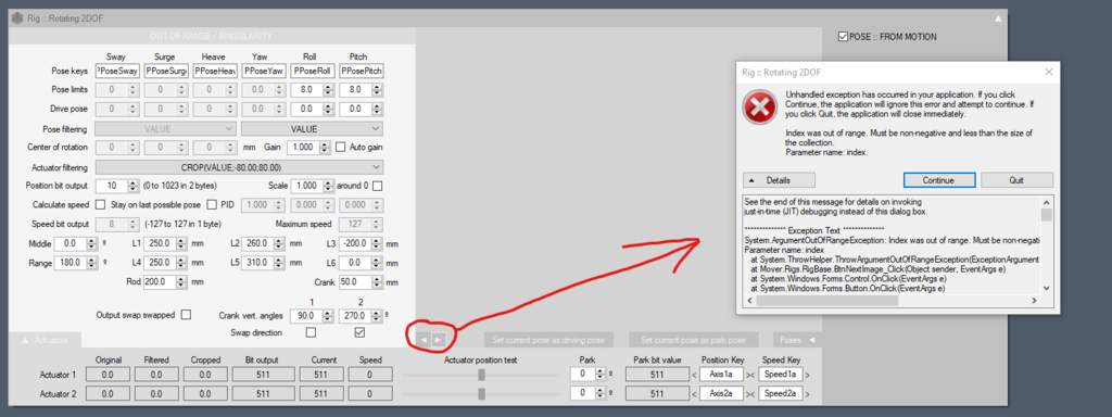

    Hello, I would like to report a bug. This is in the 2DOF rotating rig. When you press one of these red circled buttons, it causes the error shown in the screenshot.
    The following text is copied from the error message:
    Code:
    System.ArgumentOutOfRangeException: Index was out of range. Must be non-negative and less than the size of the collection.
    Parameter name: index
       at System.ThrowHelper.ThrowArgumentOutOfRangeException(ExceptionArgument argument, ExceptionResource resource)
       at Mover.Rigs.RigBase.BtnNextImage_Click(Object sender, EventArgs e)

    Unfortunately, it is also unclear to me which L value stands for which Dimensions. iIt would be nice if this could be read up somewhere. :thumbs
  18. Bastiuscha
    Bastiuscha Active Member
    Apr 1, 2017
    291
    750Coins
    +191 / 2 / -0
    I don't have thanos. But i think, you did not create an rig? You need first so create an rig window, to change that values.
