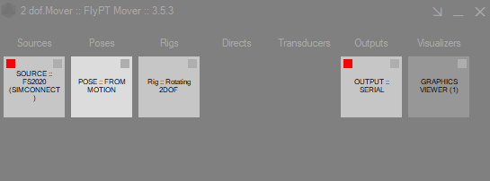

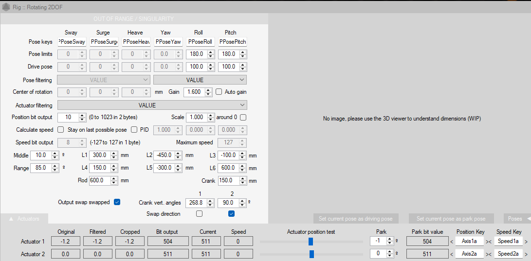

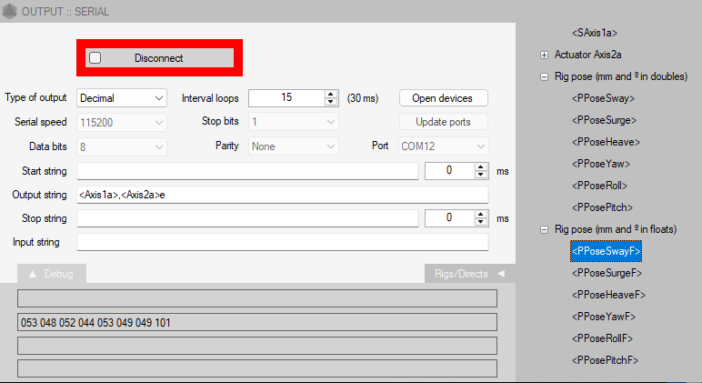

    I have an issue with FlyPT Mover. Its all set up with MS FS 2020 connection and all the metrics are moving. I have setup the serial connection to my arduino board which also works. I have setup a 2dof motion rig and I guess this is where I have issues.
    I sends this - which is basically the test slider data from the rig setup box. The format is correct but I'm unable to get the live FS2020 datastream
    I have attached som screenshot of the setup.

    Okay - think I got it. I apparantly needed to add poses. I now get a data stream from the simulator to the serial port.
    I have just added 1 pose which is Pose from motion. This seems to work, but if have insight into this I would appreciate som feedback :)
