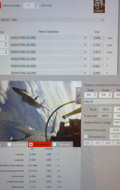

    So I just fired iRacing up tonight with 3.7.0.2 and this is actually now workable! Kudos!
    There still some of the existing bugs that are already known but OXRMC works! It is doing what it's supposed to be doing with OXRMC 0.3.8beta. Looks and feels solid, things are genuinely looking strong.
    The issue with directs not outputing values from their source until you open them still exists, although I have more feedback here. So I opened up the directs while already connected to output but not to source and I used the sliders to move things around and they impacted the output on both my M4S serial and my Arduino Fan serial. But once I closed the directs and started iRacing and connected to the source the data wasn't sent from the directs until I re-opened their window with iRacing connected and running.

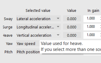

    The issue with positioning of the fields when display scaling is not at 100% seems to have been resolved! It looks good at 125%. There are some text fields that are undersized for the text that in them, in the rig module:
    Singularity angle, Angle to Ground And Actuators radius are cut off as well as Motion Algorithm.
    Same with Heave in the Pose module.
    I haven't looked in detail everything else, but reporting what I'm seeing.
    Sound in iRacing still doesn't work without the NoSound option on the command line.
    But overall this is great progress! I'm going to start looking at the safety fencing feature, probably a bit later in the week and see if I can increase the motion envelope of my rig from 15 degrees rotational and 100m lateral to 200mm lateral and 25 degrees rotational. This would be a massive change!
    I'm also super excited about the washout filters that can perform washout with rotational/movement speed limits, once we have telemetry option I'll start modifying my profiles to see if I can incorporate them into my filter flow.
    Question/ask: is there a way to also do the same on the onset of a filter? Ie. I'd like to add rotation mix from sway and surge but I want to limit the rotation rate so it stays under the perceptible limit.
    So yeah, there is definitely a few rough edges that need polishing but 3.7 for my use case works almost as good as 3.5.3 with the few exceptions and I'm eager to utilize the extra features that are not available in 3.5.3 at all.
    This is probably the most exciting time to be a FlyPT user since 2021 :).

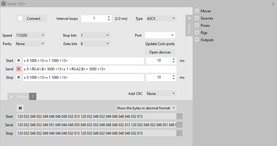

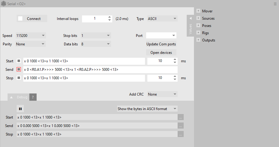

    @SilentChill ,
    Please try this (position and ascii, old decimal):
    Use the checkboxes next to Start, Send and Stop please
    You can also try bits if the above doesn't work
    This would make sense because of resolution and the fact you have small movements

    The output string format used to be clear and simple but IMHO it's getting more and more complex in the new release. The amount of options may ask too much of new users. Users shouldn't be forced to do programming/coding. This is an unnecessary source of possible errors. Simple typing errors can lead to invalid formatting strings. Those errors need to be catched by your interpreter. Decisions have to be taken what to do in those cases: throw an error message? ignore the faulty part and output the rest?
    Suggestion:
    How about replacing the three formatting strings with a single list view? Four "Add" "Delete" "Move up" and "Move down" buttons control number and arrangement of list items. Options are
    • ASCII decimal or hex constant bytes
    • Delays in ms (to replace extra start/stop sequences)
    • Integer values of 1, 2, 3 or 4 bytes
    • Floating point binary values of 4 or 8 bytes
    • Floating point as ASCII string with x.y digits before/after decimal point
    • ... (I don't remember all of them)
    This way no parsing is required and it's impossible to enter invalid strings. (Of course, the software still needs the parser internally for converting old .mover files to the new format. But it has to handle the old syntax, only)

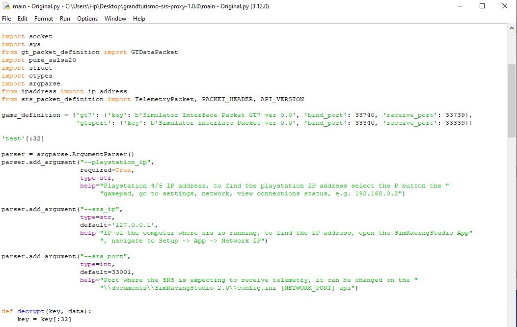

    @pmvcda However GT Sports still ain't working. But I would be happy to assist you for the GT Sports with some of my downloaded python files use to read the telemetry from the game,any time dude.
    Thanks for keeping up with the community.

    Was going to talk with you...
    So I tested GT7 on PS5 and GT6 on PS3 and they both work for me...
    Did you try to set the IP of the playstation? I'm using 255.255.255.255, this sends everywhere.
    You might have some protection on the firewall for that. Try to specify the playstation IP
