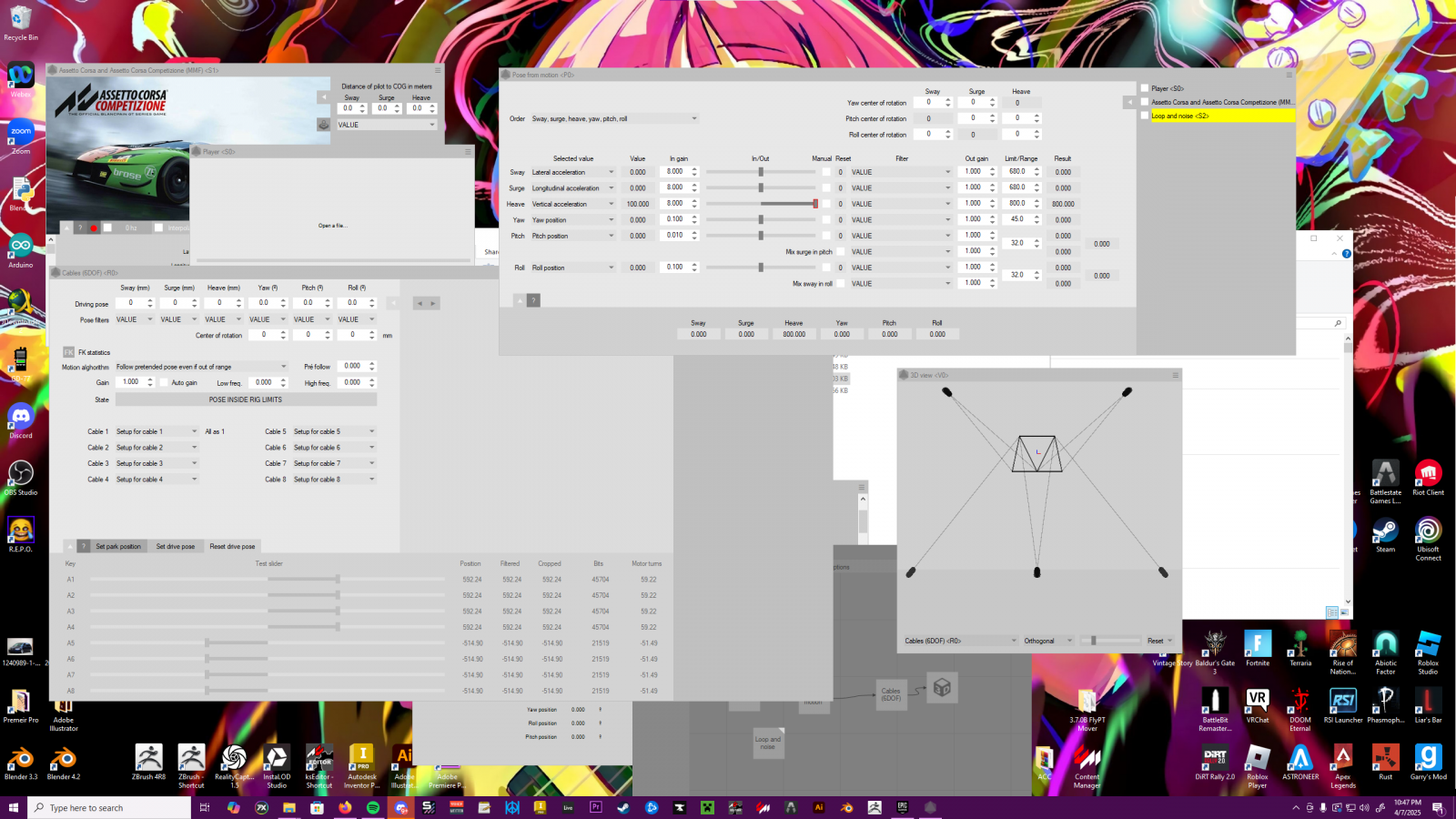

    Hello im in v3.7.0.9 and the 6dof cable sim has some weird singularity issues, on the xy plane it seems that it cant extend to the limit of the cables which i assume has some sort of bounds related to tension but should still be possible I think. whereas max height would cause infinite tension in the top cables. But the main issue i have is i can't go as low as I can high. screenshots for example:
    also can i make it so it has a 6 cable setup rather than 8?

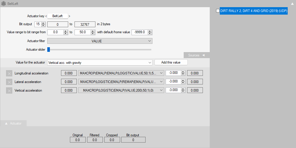

    I have no idea how to set my Wind fans or my Belt Tensioners up as the simple direct has no options like in the old Mover ? There is no actuator key to input the Wind Or LeftBelt RightBelt key
    Old
    New

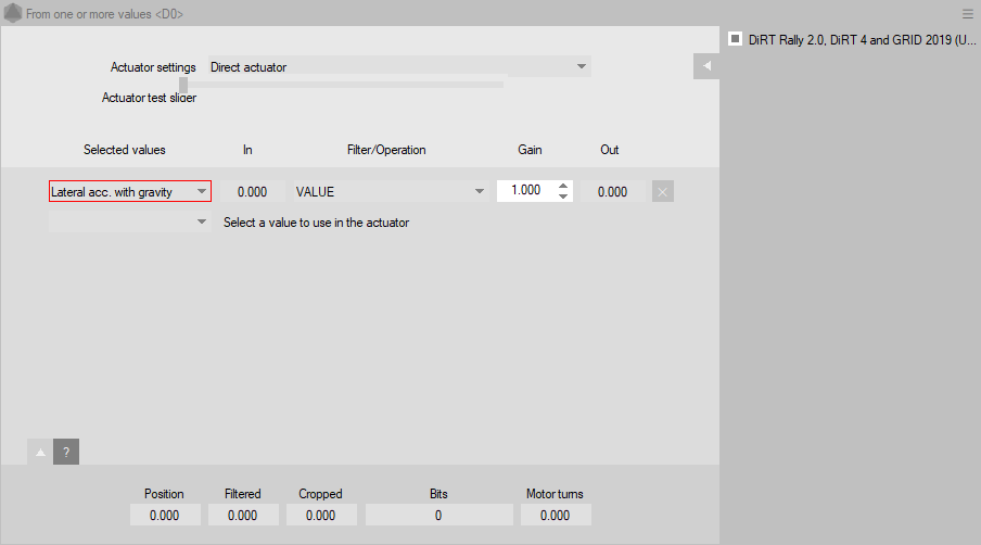

    Struggling with directs myself. set up 4 directs to drive a g-seat like Chris Fischer's design. Cannot get them to show data at the M4S output. They show as: <D0.A.B> <D1.A.B>

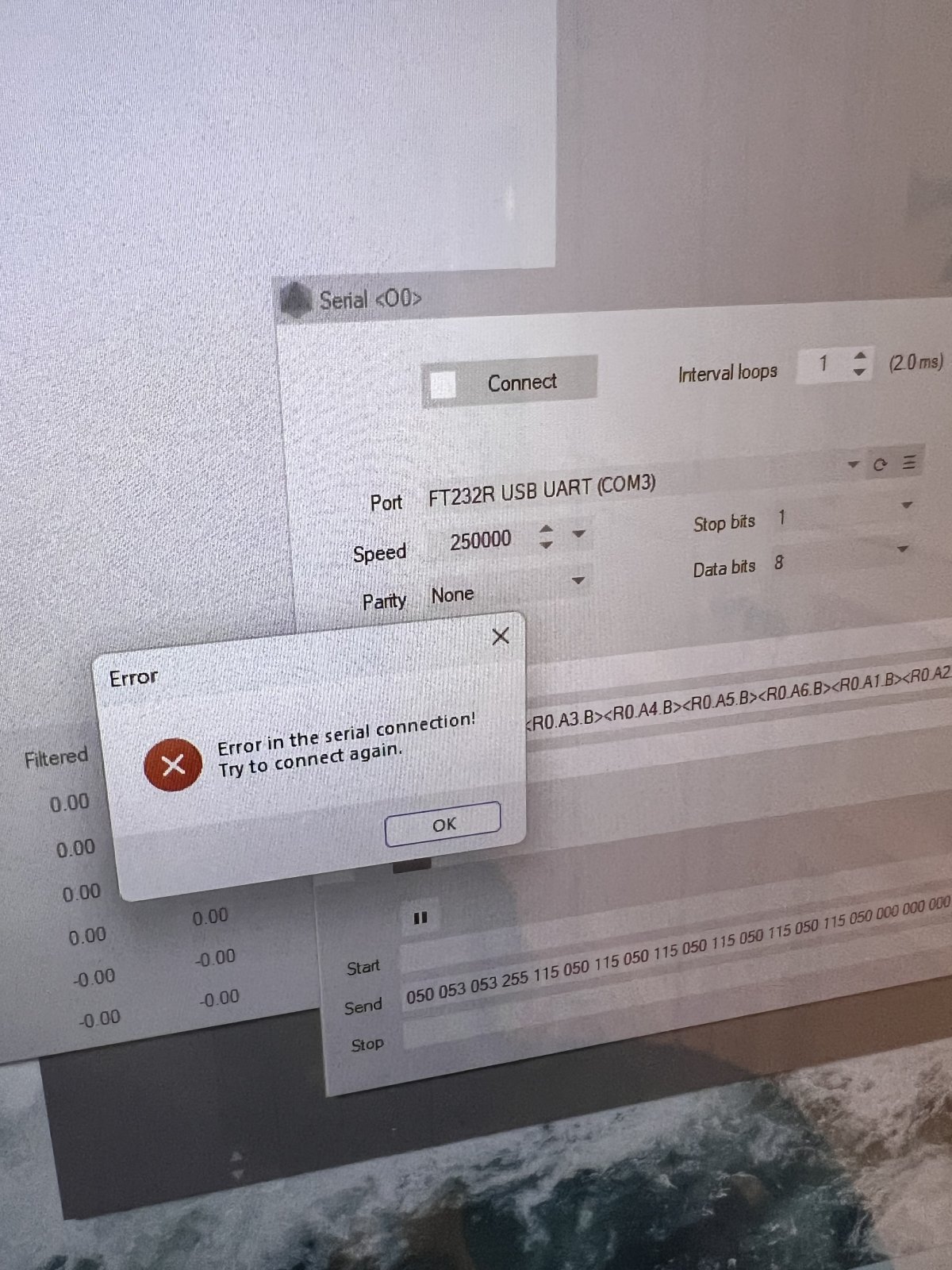

    107267
    Hi Pedro !

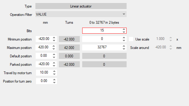

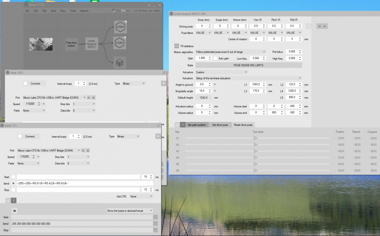

    Unfortunately, I had no success to connect the two ESP32 controllers with the serial outputs (speed 115200 or 921600 like the old version) every time I want to connect, I have a blue screen and the pc shutoff .
    With the MMF output it works but Port 3 or 4 does not seem to communicate, in the rig the bits is at 15 and when I return to the old version everything works wonderfully .
    Have a good day !
    Thanks ! @pmvcda
    Eric
