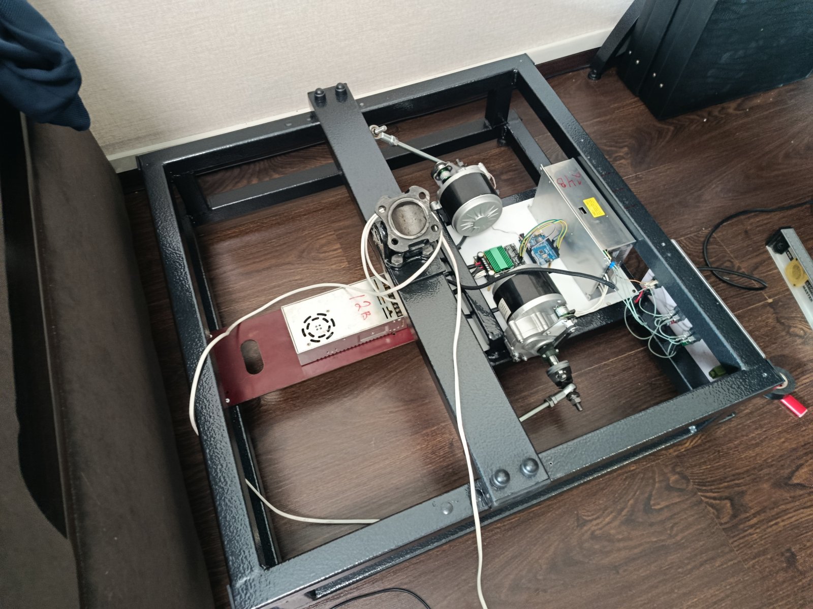

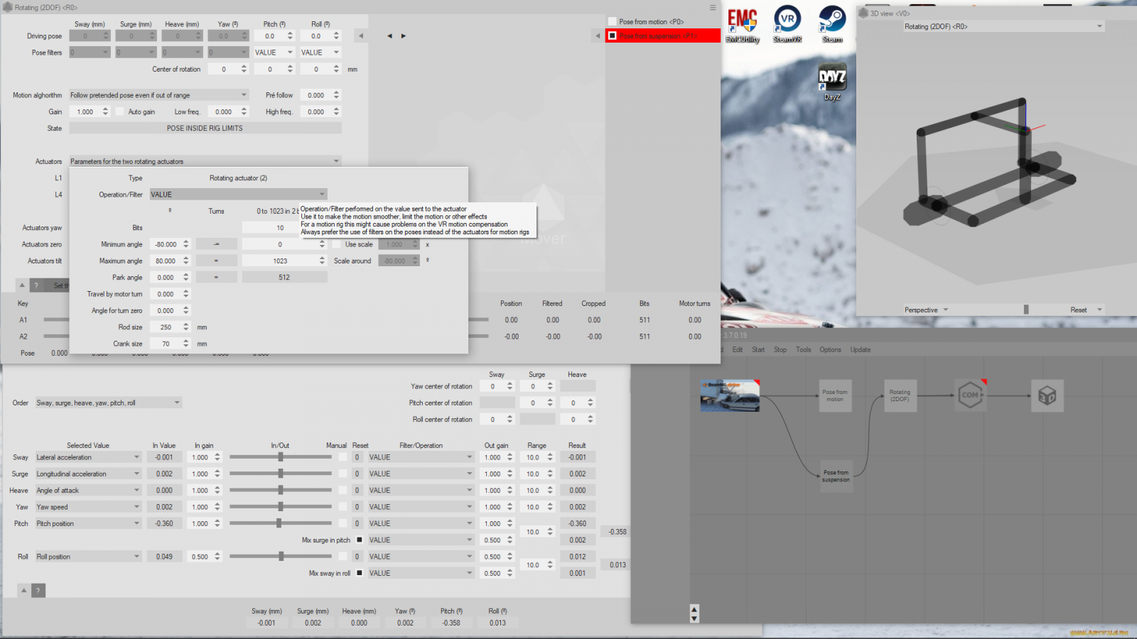

    Please help me or share a working config for a 2DOF rotation platform. I have set up a Mover with SMC3. I have defined the geometry of my platform. Everything is fine. However, when I run a game, the platform behaves in an inappropriate manner. The movements are too abrupt and have a large amplitude. I want to achieve a smoother motion. SIMTOOLS provides a general sensitivity slider.

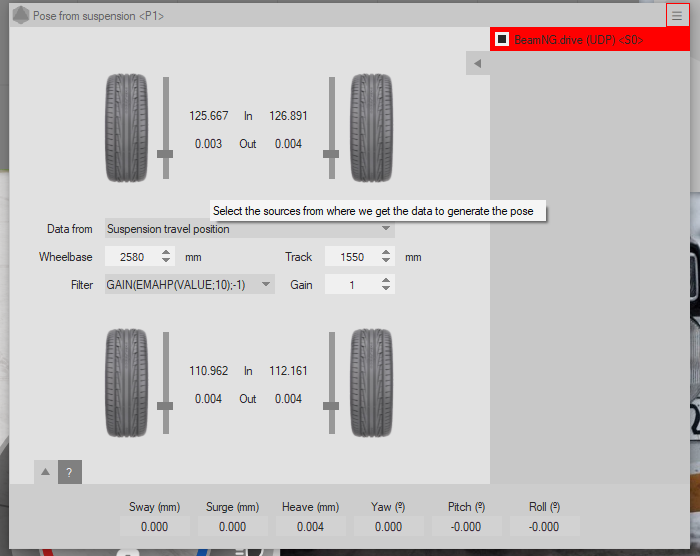

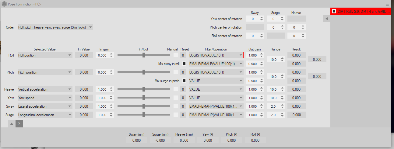

    I'm currently watching a video on how to set up a 6DOF hexapod. Similarly, I've set up Pose from suspension and applied the filters as shown in the video. The suspension works as expected. However, the other movements are too abrupt. I believe I need to apply filters to other sources. I'd appreciate a detailed guide on how to set up a 2DOF platform with rotation axes for DIRT, Asseta Corsa, or BeamNG car simulators, along with examples.

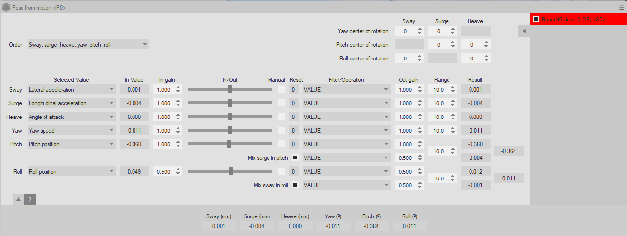

    I have now applied the following settings. Acceleration and braking work fine. Climbing and descending work fine. However, driving over bumps, potholes, and humps is too jerky. My head tries to detach when I drive over a small bump.

    +378 / 5 / -0
    DC motor, 6DOF
    Put one, or two EmaLP (smoothing) on every single input. Vertical accel. as well. No wonder it sends you to the moon if you leave the signal unfiltered.
