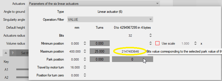

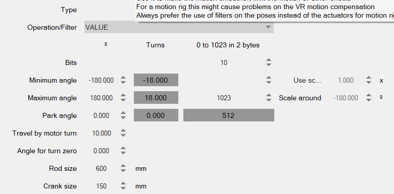

    Found one minor bug: On the rig->actuator panel I can't enter a maximum position value above 2^31 even when the headings say "0 to 4294967295 in 4 bytes". It always limits the input to "2147483646" which is 2^31-2.

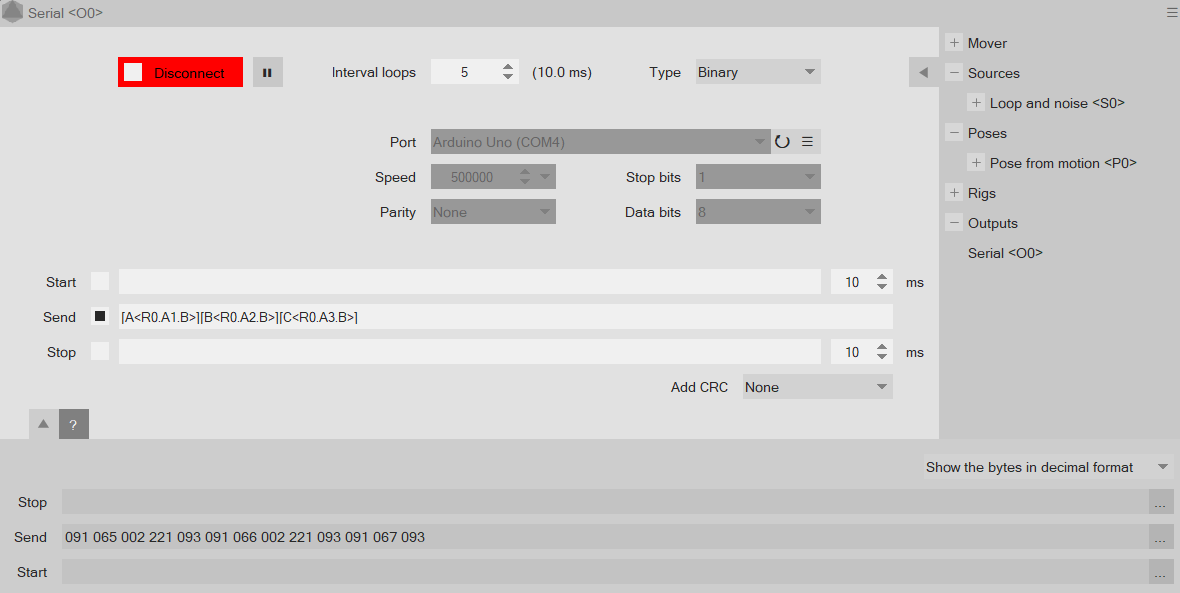

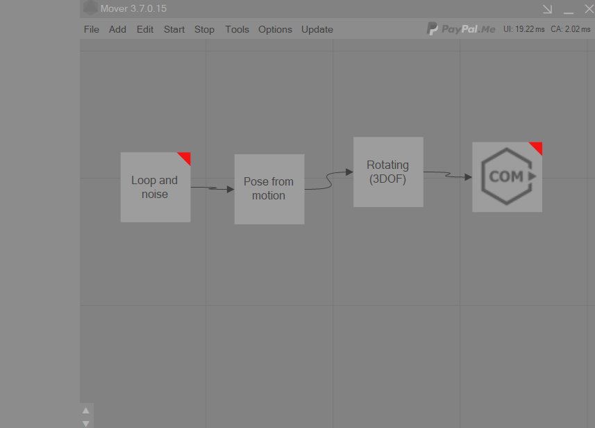

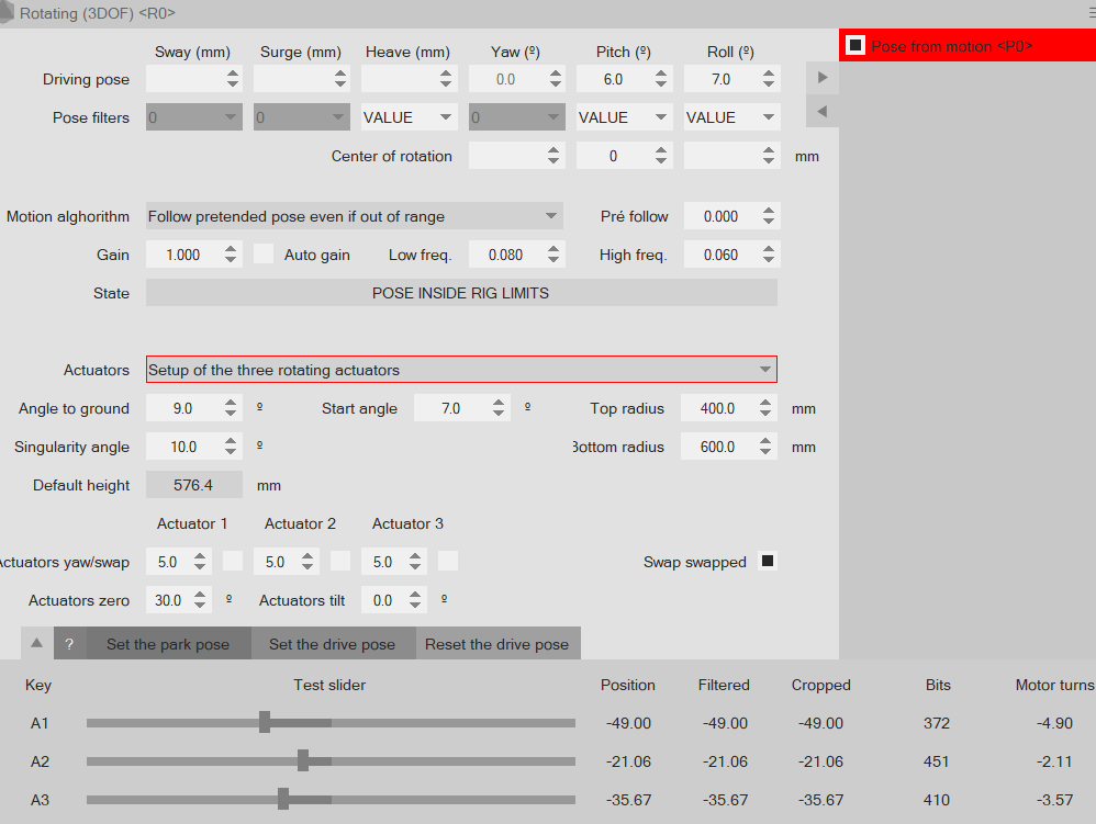

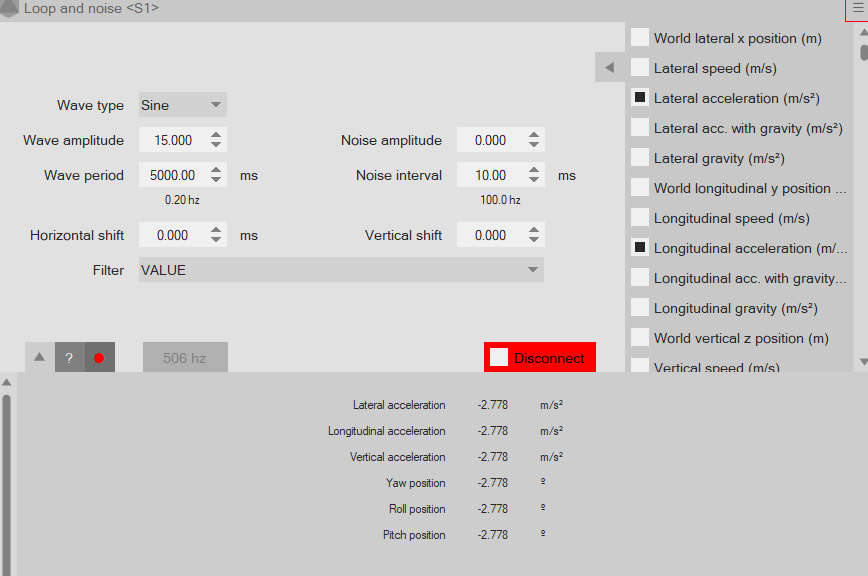

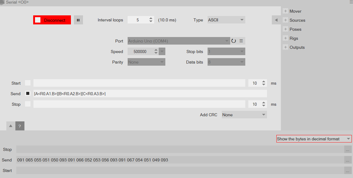

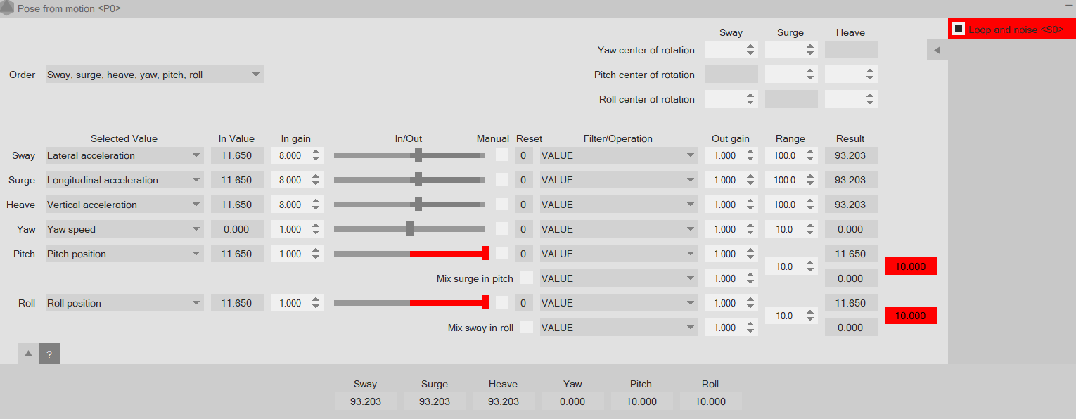

    A stupid question. Is there a video or guide how to set it up with 3DOF motion sim with 2 motors in the front for pitch and roll and 1 motor in the back for yaw? I'm using arduino uno with SMC3 and 3 IBT_2. All 3 motors connected to a single Arduino uno.
    So far, I setup serial connection with the following Send command "[A<R0.A1.B>][B<Ro.A2.B>][C<Ro.A3.B>]"
    Started with Loop and Noise -> Pose from Motion -> Rotating 3DOF -> COM
    From Rotating 3DOF the motor is rotating with a slider (so far only 1 motor is connected for testing)
    To be honest, I'm a little bit lost with all the settings. Since Loop and Noise is started and all the sliders are moving in Pose from Motion but the motor is not moving. Also, how to enable yaw?

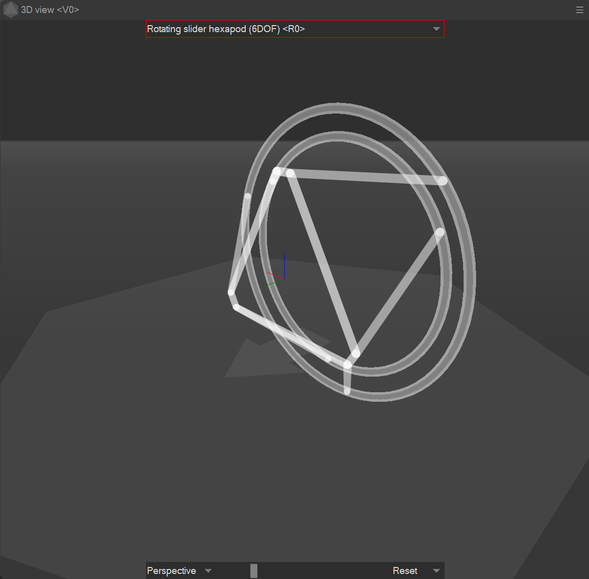

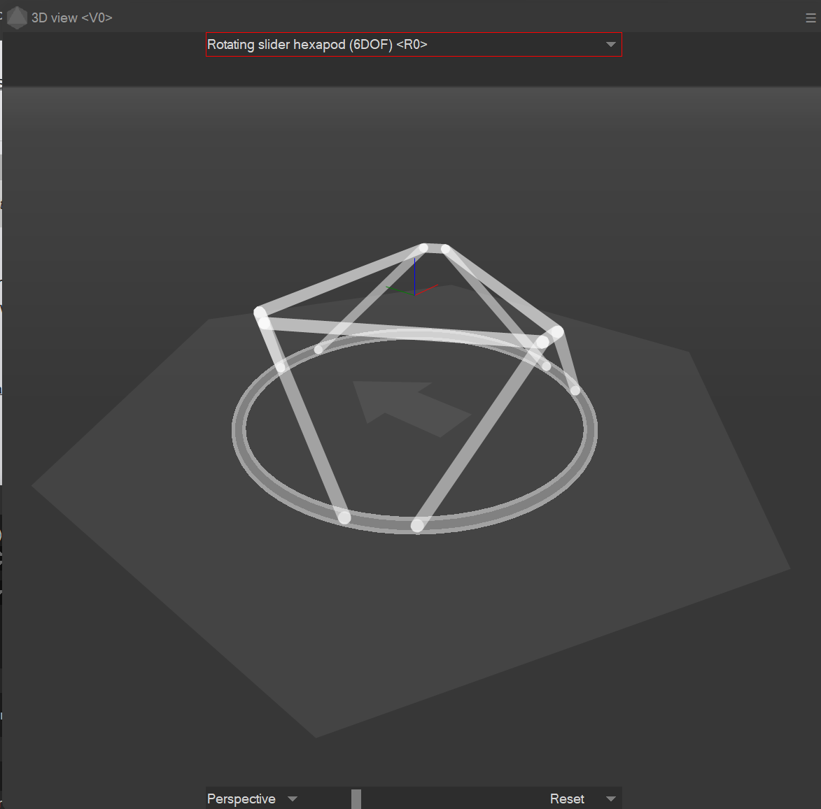

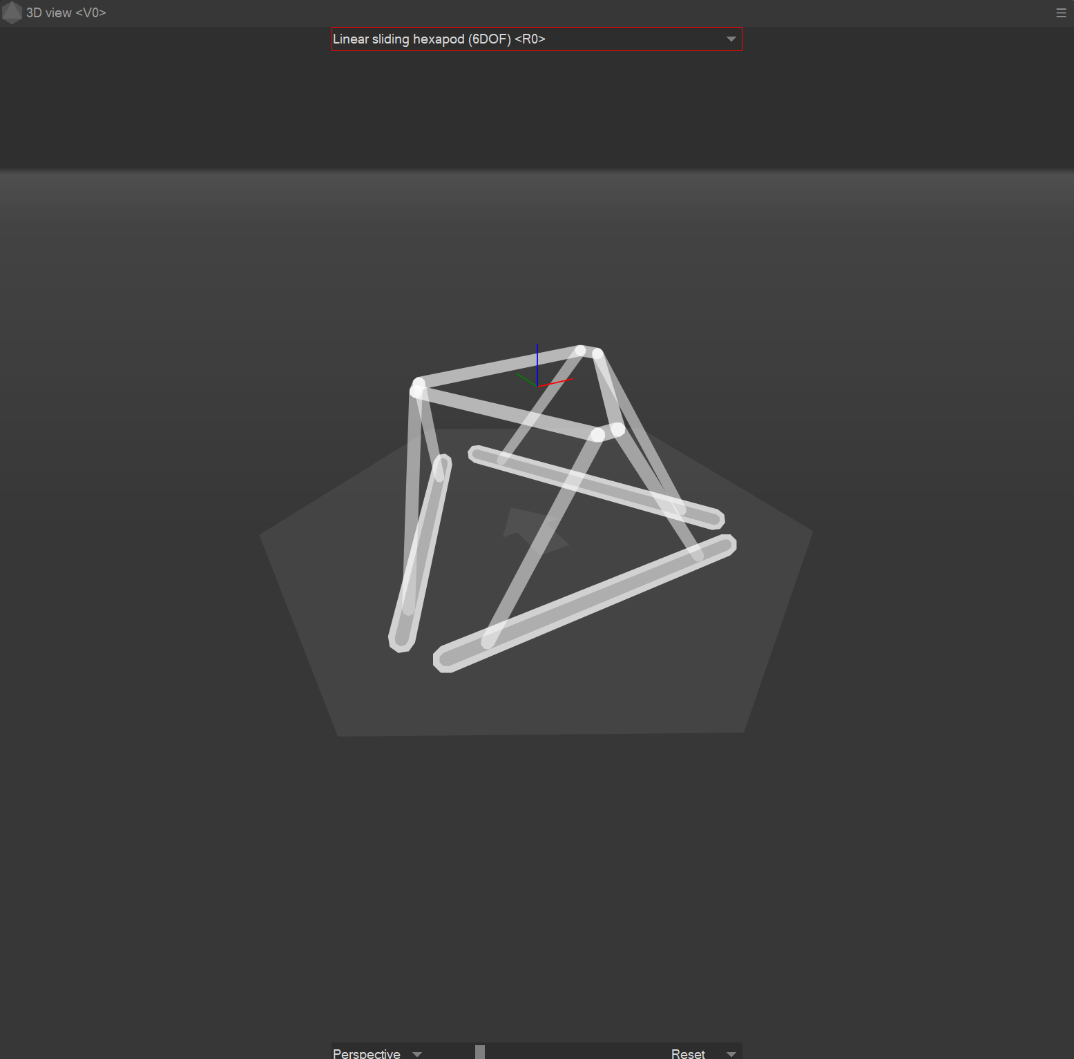

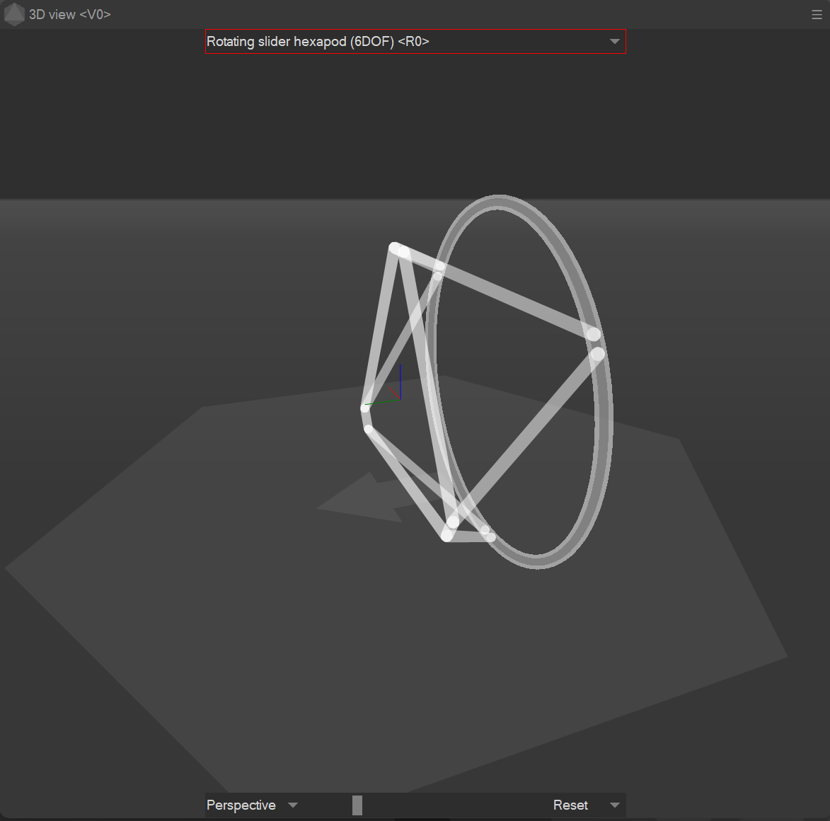

    There's another one, maybe more interesting that can give you 360º rotation. Could be yaw if mounted on the floor, or roll if mounted in the wall:
    It's a rotating slider. If you use two slider rails you get more travel in the rotations:
    This avoids colisions between rods, thay can "intersect", the position of one is not limiting the other one.

    What is correct Serial COM settings in SEND command? I'm using 1 Arduino UNO with SMC3 1.0v and 3 IBT_2 units and latest 3-7-0-15. The motor is not moving but works fine when I test with SMC3 windows utility. Also, in rig settings I changed to Bit 10

    You have to use decimal/ascii output instead of binary

    151Coins
    I know I'm missing something simple but I just can't get the motor moving in FlyPT Mover Latest beta but it works in SMC3 windows utility. The sliders are moving. In the serial output SEND data numbers are changing. Can somebody point to the right directions. Only 1 motor is connected to Arduino/SMC3 just for testing.

    @PavelF and @Opast ,
    I have a new release almost ready.
    I would prefer that both of you tried with the new one.
    I solved several bugs related with updates of values from source to pose to rig to output
    @Opast , Make sure you closed the SMC3 windows utility. You can't use it at the same time with Mover or any other app.
    Did it work with the older Mover? Or have you tried just with this one? From the screenshots everything seems correct.

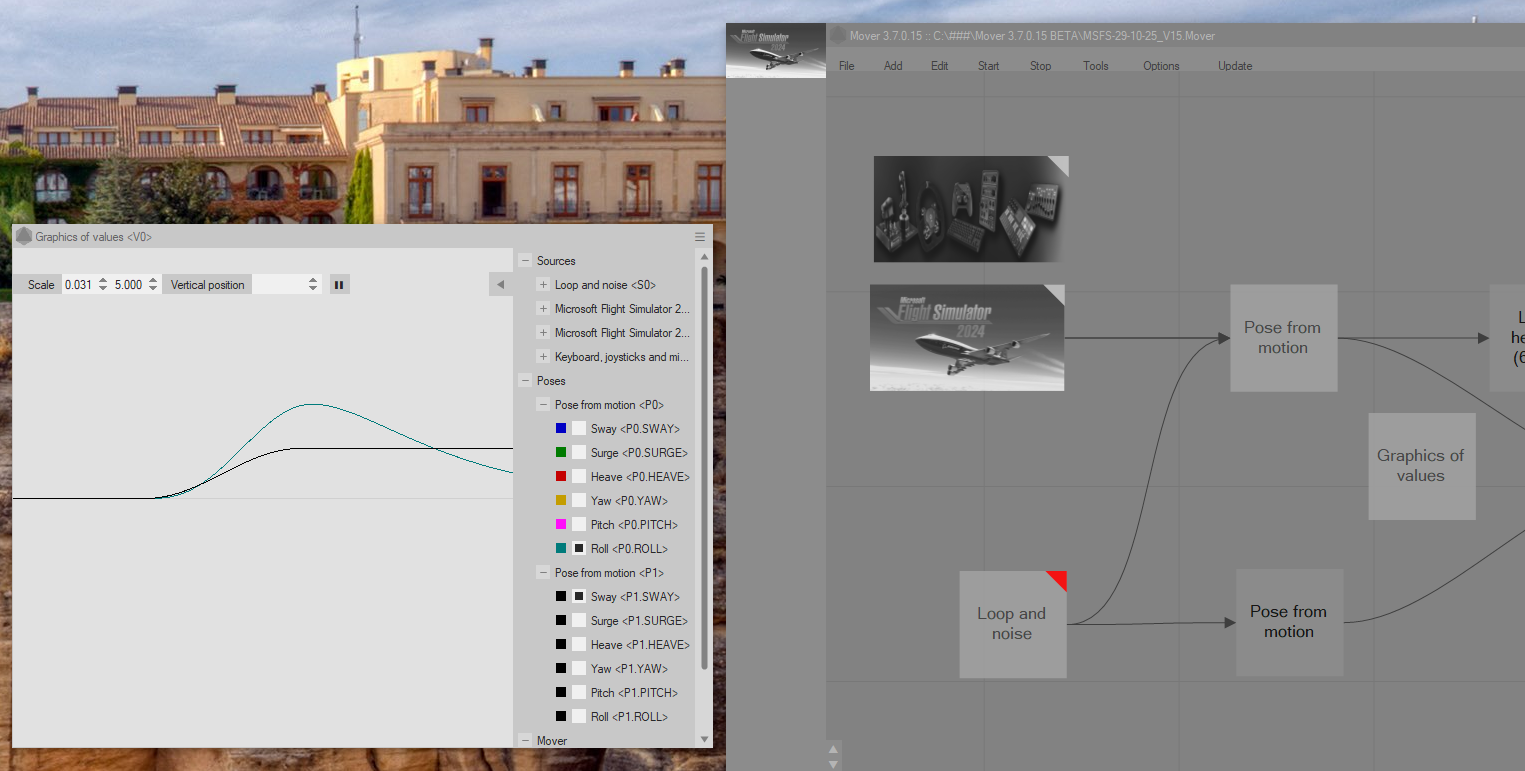

    Mover 3.7.0.16
    Update from the Mover or download here: https://github.com/FlyPTMover/Releases/raw/refs/heads/main/Mover 3.7.0.16 BETA.zip
    Release notes for 3.7.0.16 (04-11-2025)
    Updated and solved several bugs in the 4DOF rig (like D-Mover)
    This rig should put out a surge value due to the mechanical constraints. Yaw induces some surge because the rear actuators don't rotate in the lateral axis
    Solved several bugs in items selection for each modules
    Added Joysticks and Midi devices to graphics and outputs
    Updated several custom controls
    Solved bug in numeric controls, value was not showing on initialization
    Solved bug in numeric controls, bad rendering of value
    Solved bug on 3D rendering of actuators with sliders
    Solved bug in module renaming and key change
    Solved bug in actuators bytes (wrong maximum value)
    Solved bugs in setup merge (not all, need to test better - keys should change because of possible duplicates and this affects all the setup)
    Known bugs and problems:
    Some colors are not the best, it's WIP
    Problems with MSFS connection, still same as previous release
    Midi in hotkeys still not sending the correct feedback to devices (doubt I can make it work, missing a device for correct testing)
    Midi selection in graphics and outputs is still WIP, they should show only when used... have to decide how to do it yet, the list is to extensive, you can always add the var in the string manually
    Some bugs in directs
    Some connections might disapear in the diagram
    Slow loading of setups, specially with the Loop source
