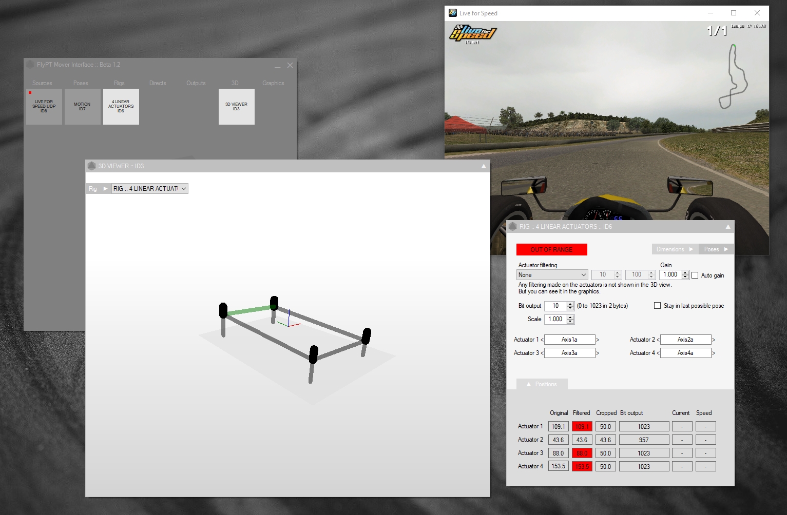

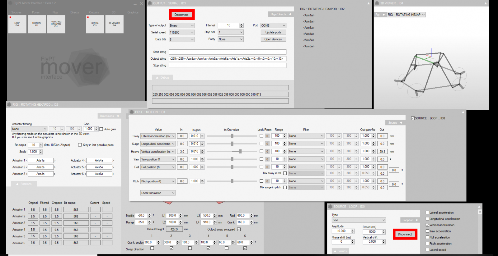

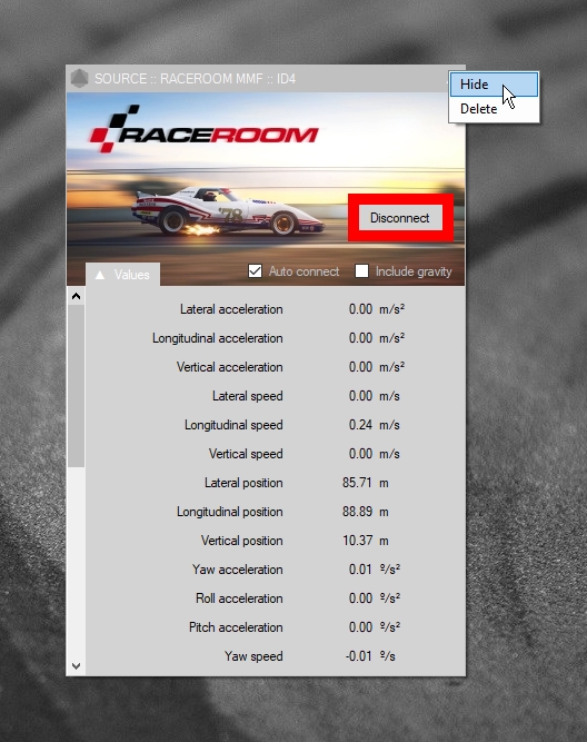

    FlyPT Mover Version 1.2 Beta
    New/solved:
    - New source for RaceRoom!
    - Changed the way windows close/hide. Now it shows a menu and you select what you want.
    - Added shortcuts to the menu to close/show/hide all modules.
    - DCS - Solved bug where yaw was receiving data from roll
    - DCS - New lua script that sends more info and tries to enhance ground/fly detection.
    - Solved bug in pose motion.
    Opening a pose for motion without changing input gain values for sway, surge and heave, made values scalled down 1000x until they where changed.
    This as to do with m/s^2 to mm/s^2 conversion.
    - Solved bug where every time we loaded a file, the modules with input lists had the first item always checked.
    The logic is to select the first item only when you create the module for the first time, not when you load a saved module.

    In output:
    Set serial speed to "250000"
    Set interval to "2"
    In rig:
    Set bit output to "16"
    If you still have problems we should arrange a time to meet on Discord so I can try to help you in real time.
  11. pmvcda
    pmvcda aka FlyPT
    Nov 3, 2010
    2,272
    Portugal
    15,902Coins
    +2,716 / 18 / -0
    What @Trip Rodriguez says.
    There's something I should have explained better.
    A rig is a group of actuators, and those actuators are defined in the rig.
    That's the reason why bit output is there.
    In the future custom rig, you can have actuators with different ranges and bit outputs in the same rig.
    If we defined bit output in the output, we could not specify different values for each actuator.
    It's already happening with directs. You can have a direct (it's an actuator) with a different bit range from the rig.
    Or you can define two rigs and use one for a g force system that uses a different bit range compared to the motion rig.
    Now for outputs, that's just a compilation of actuators info. We connect to an hardware, and select witch actuators we want to send.
