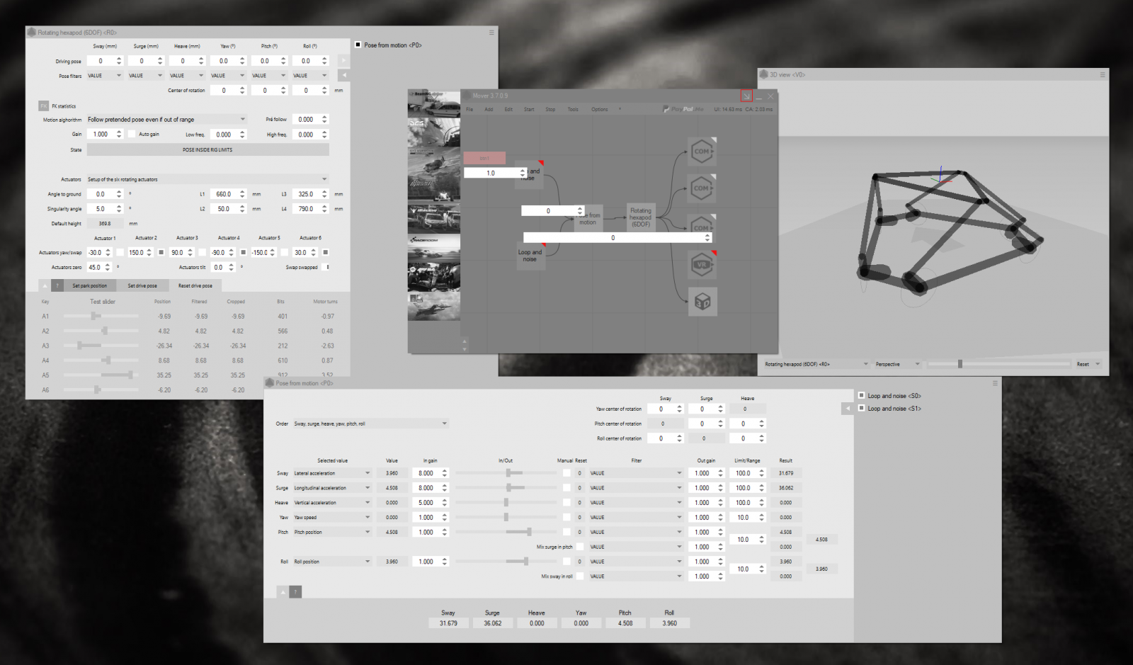

    Sorry for the delay. Was travelling.
    So I join a setup for the latest Mover.
    Ignore some items above. It's development fields for 3.7.0.10 that show on the main window.
    I think it has exactlly what you have in 3.5.3 in the rig and outputs.
    You have to choose the correct ports.
    On the rig, angles changed in the new Mover -180 to 180 (it was 0 to 360)
    I also made an oscilating loop to have an effect on the rig (pitch/roll/sway/surge)
    I also think you should test other positions for the actuators. Not sure this is the one that gives you more range.

    Thanks a million! I answered in the other topic as appropriate for this new version.
