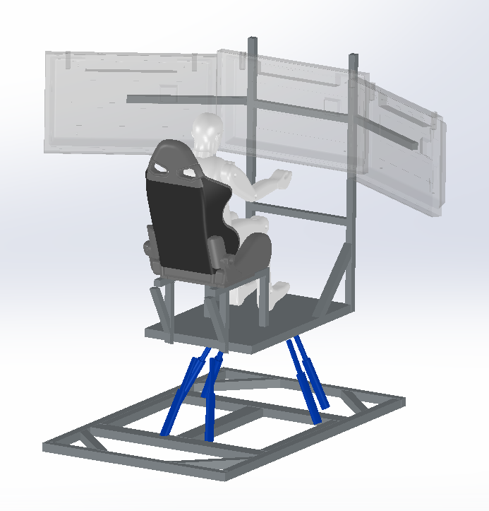

    Hey everyone!
    We are three students who will build a flight Simulation for our university.
    The following requirements are placed on our project:
    • Mobility of the System
    The Simulator has to be designed as a transportable system in order to enable presentations during fairs, lectures, experiments and other Student projects​
    • The following restrictions must be observed:
    mass
    spatial dimension (maximum size 2m x 1.2m x 2m)
    dismountability in transportable components​
    The movement of the platform is to be realized by means of six linear motors, which are arranged in a hexapod arrangement.
    IMAGE-LINK ​
    A comparable project is:
    YOUTUBE-LINK​
    Because of a limited budget we won't do a detailed reproduction of the Cockpit.
    As a simulation software, Prepar3d is used.
    We will probably use the following motor / linear systems:
    DUNKER LINK​
    The motors are controlled via a bus system, called CANopen. There are two possible variants of the structure:
    • Simtools - Serial interface - Arduino / Raspberry, which controls our actuators - CANopen
    • Simtools - program which reads variables from Simtools and which controls our actuators - USB-CANopen Adapter
    Open questions and challenges:
    • What do you think about our linear cylinders/actuators?
    • How do we have to configure the axes in SimTools when using linear cylinders?
    • Is there a way to access the SimTools axes values via a software interface in Windows?
    • is there someone who is familiar with CANopen, or has realized the control via CANopen?
    THX &
    many greetings
    Markus, Magnus, Manuel
