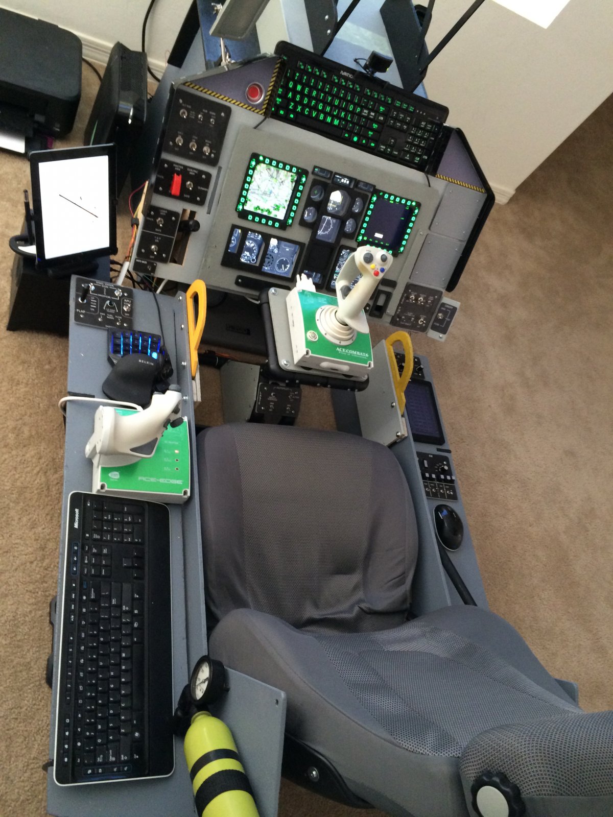

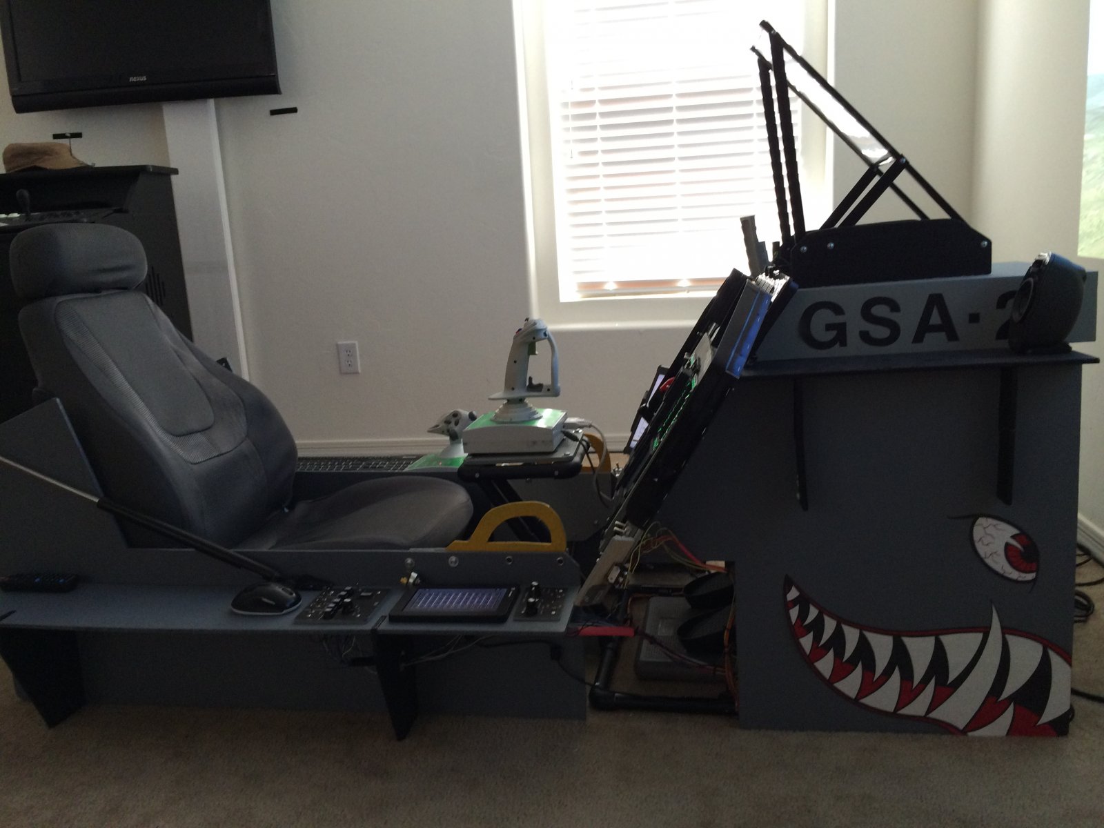

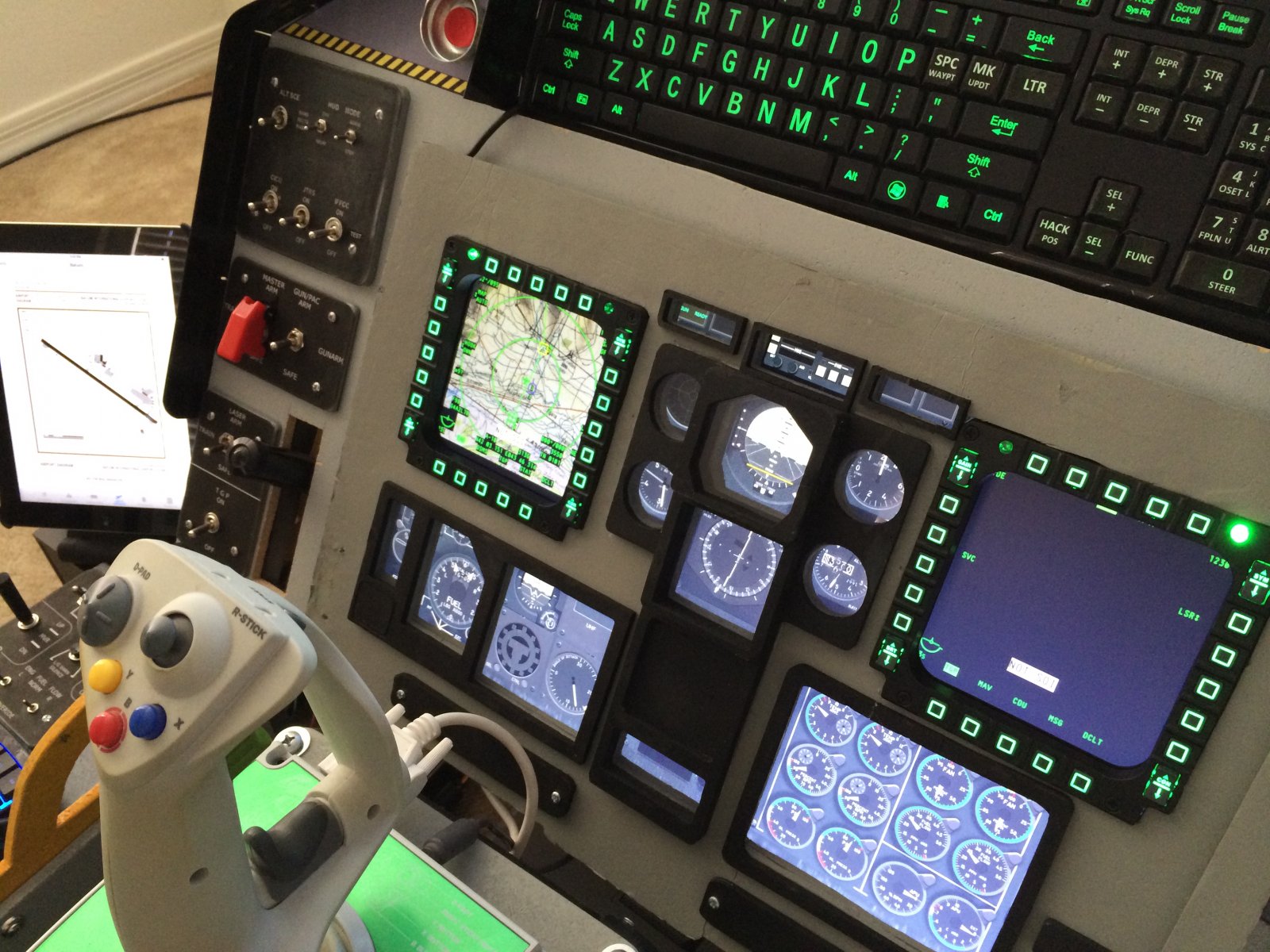

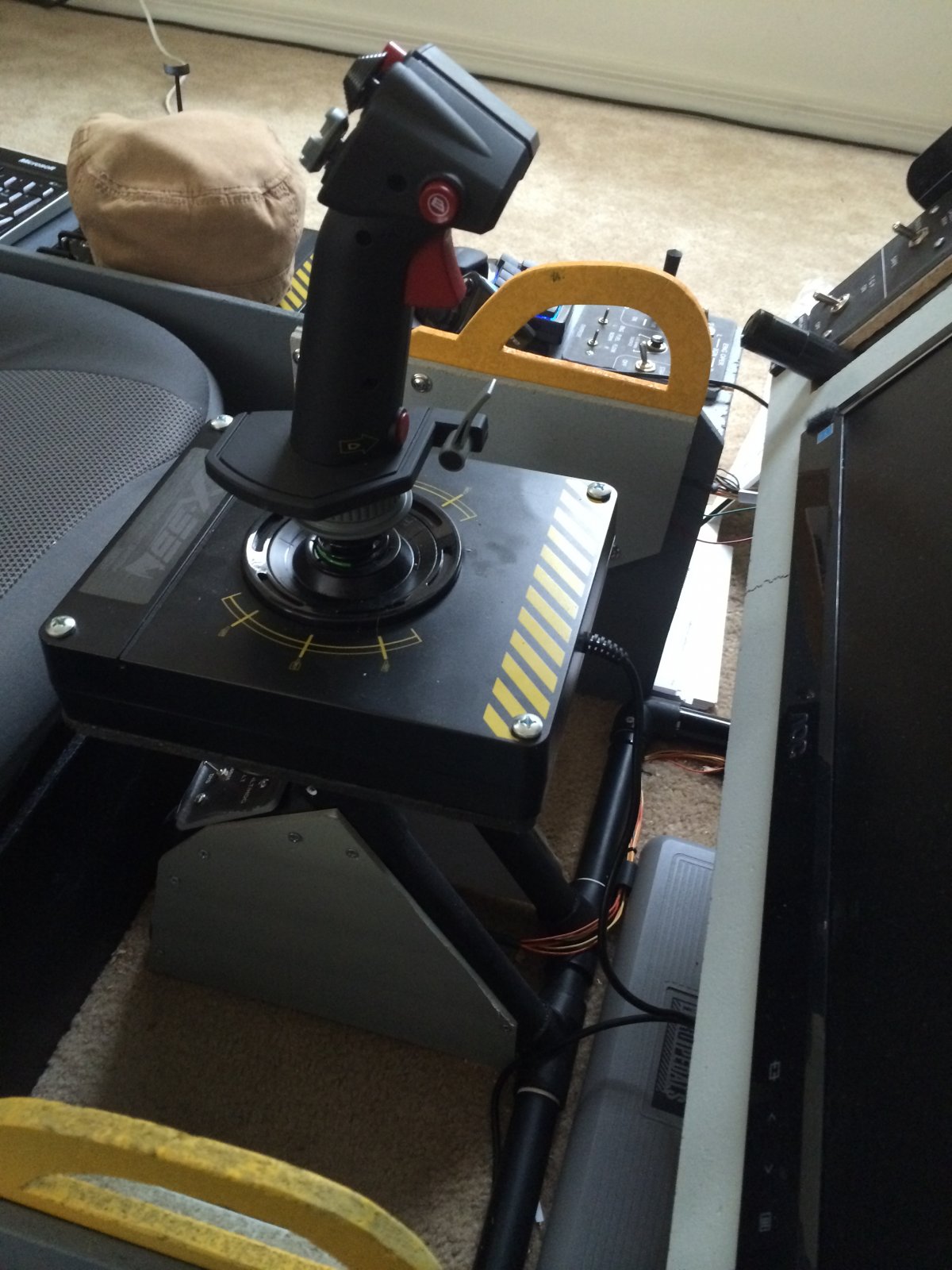

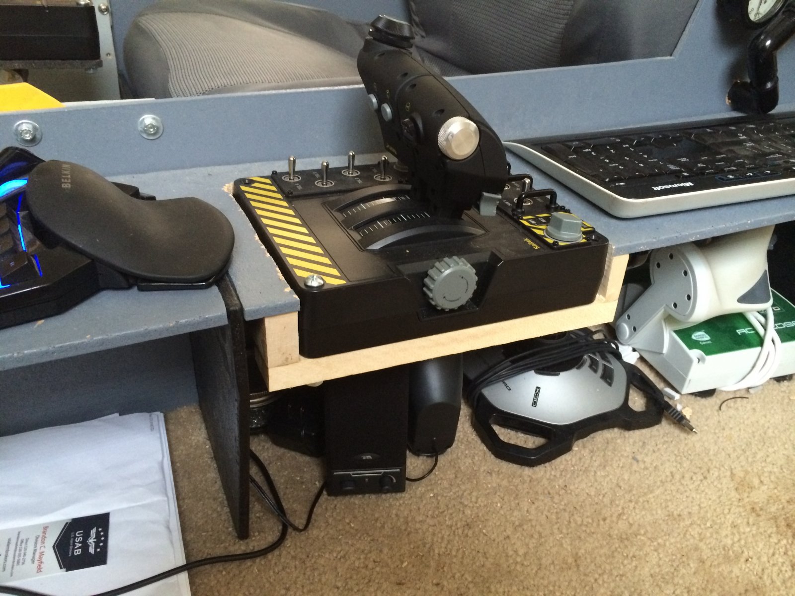

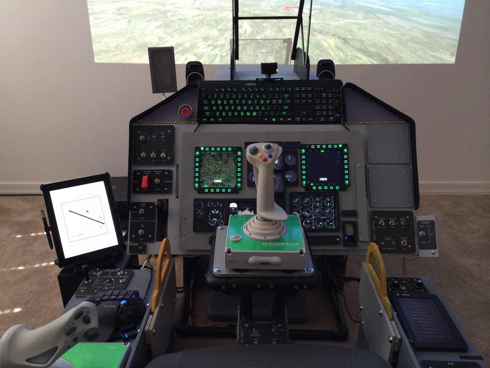

    Thanks for the replies, guys... I'll definately be doing some more research. Here's a couple of pics of my current 'pit. Nothing too special, a slightly modified Akers/Barnes set-up.
    To which I've also added an X-55 Rhino HOTAS.
