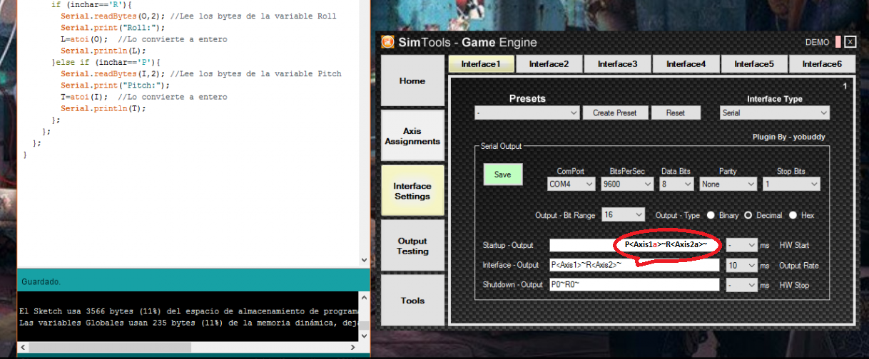

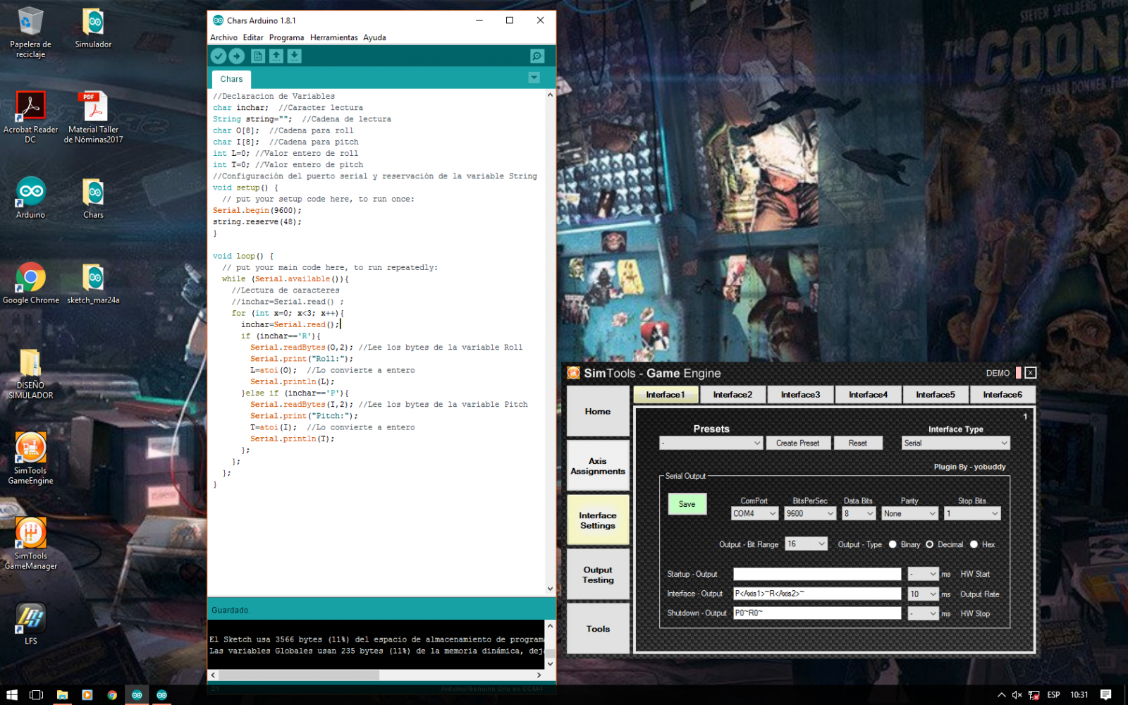

    Hi to the community i'm a little bit new in the world of simulators, i'm an electronics engineer and have been contacted by a friend to build a flying simulator, my friend is a mechatronic engineer, but till the moment i'm on charge of extracting data from simtools, i've been researching some similar projects at the forums and get some firmwares for arduino but can never stablish the connection between simtools and arduino even when i'm trying with the most knowledge like SMC3, so i decide to write my own code from zero, i do a simple code that read the roll and pitch but i can't get any data from simtools yet, i attach the image of my code and configuration, and add the code here, if someone can help me would be great, our goal is to build a simulator to play star wars videogames and flying simulators. Sorry for the comments in spanish is just our mother language so we can understand better the work. i hope to build my complete code and later release here at the forum, till the moment we are trying with an arduino uno r3, but maybe in a future could be use a fpga.

    First i'm trying to get the data (roll and pitch) from the simtools software to my arduino so i can later design my own code at the arduino a manage my motors with encoders but the simtools it seems to doesn't anything to my arduino, the rx led doesn't even blink while simtools is working even having the same rate in bauds and configuration, thanks for your reply noorbeast

    But the problem is that i can't get the data into my arduino with simtools, my arduino leds rx doesn't even blink when lfs and simtools are working, i need to get the data so i can start work with this data in the way to build my own way to control de motors that would be DC motors no steppers it's a requeriment from my partner, it's for a big structure. I would check that code too but i'm still trying to get the data in my arduino thanks for the link stevemontuno.

    If you're using SimTools 2.x then the usual error comes again and the output settings should be like this buddy ...

    Hey Speedy that information is what i was searching now i can get the data on my arduino thanks a lot really really cool answer my error was the 'a'. I hope to get news soon when i'll improve the code and begin the control, i hope to bring the improvements this week my friend would build a small prototype of the mechanics parts
