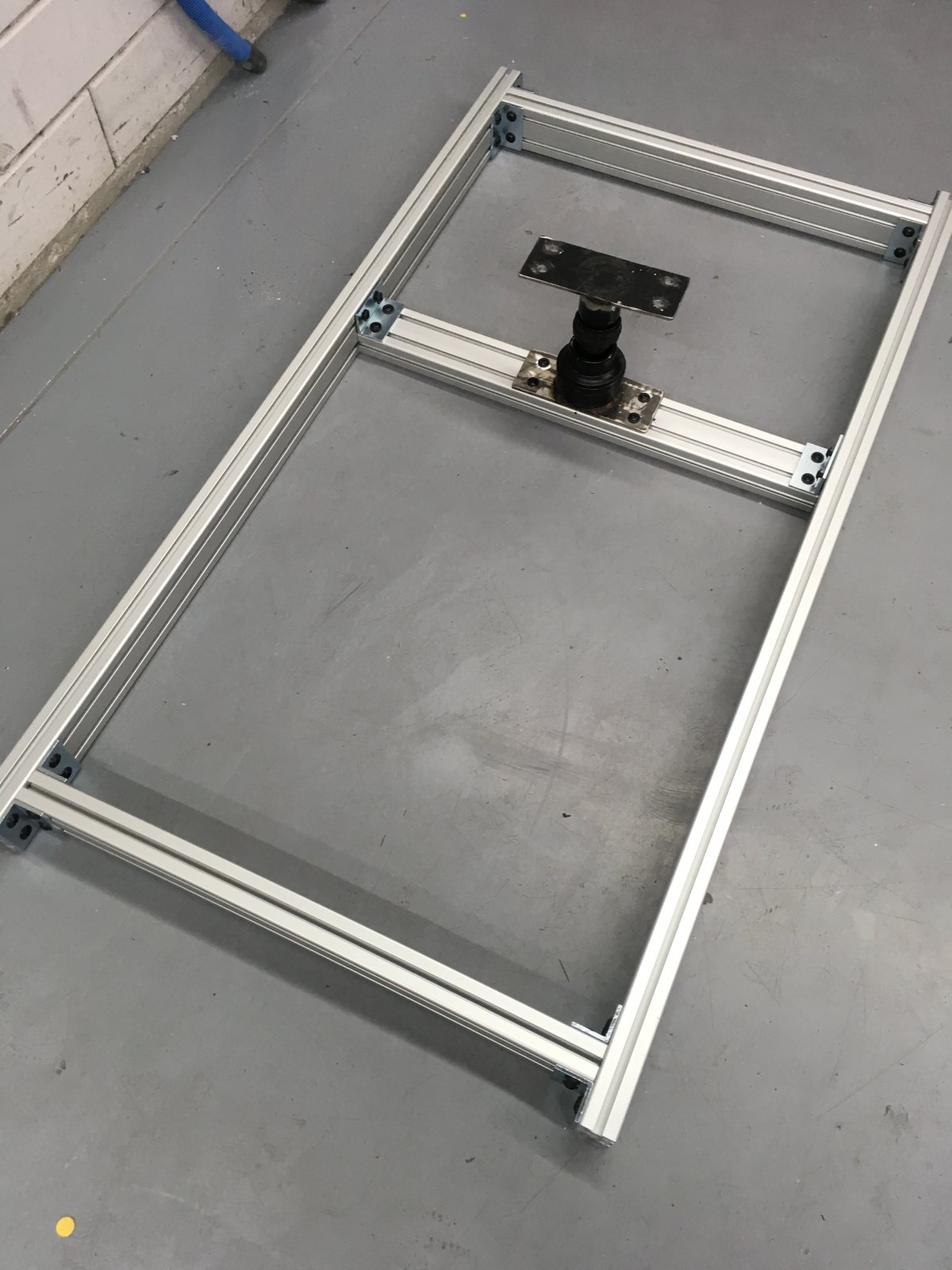

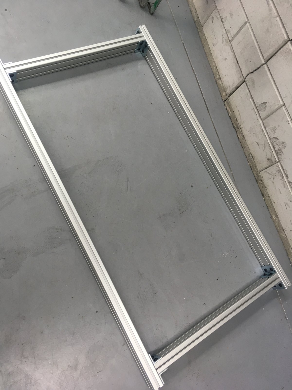

    started on the bottom frame.
    7DB9C56F-9513-4DD8-B102-AF77DFD4420F.jpeg 257B1619-555D-46D1-B666-06A69E515F9B.jpeg

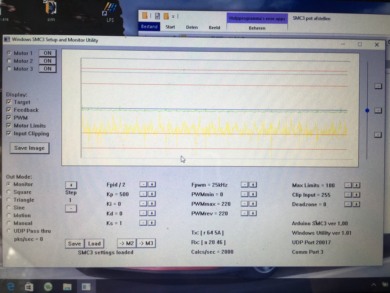

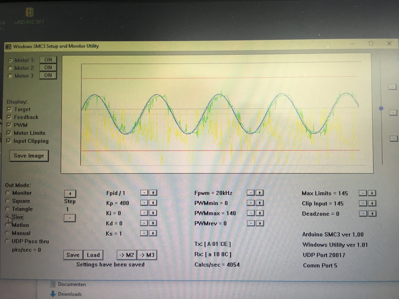

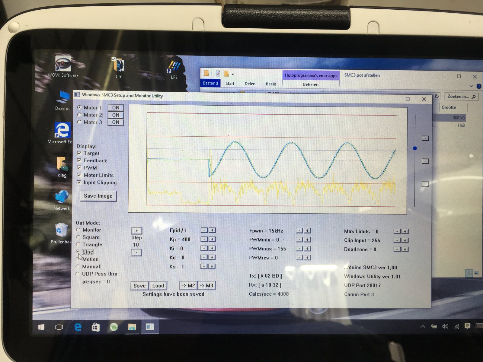

    played a bit with smc3 today. with the test motors 12v. I only had to use max limits 145. if I set it to 255. then it goes outside the values and goes off. is that OK ?

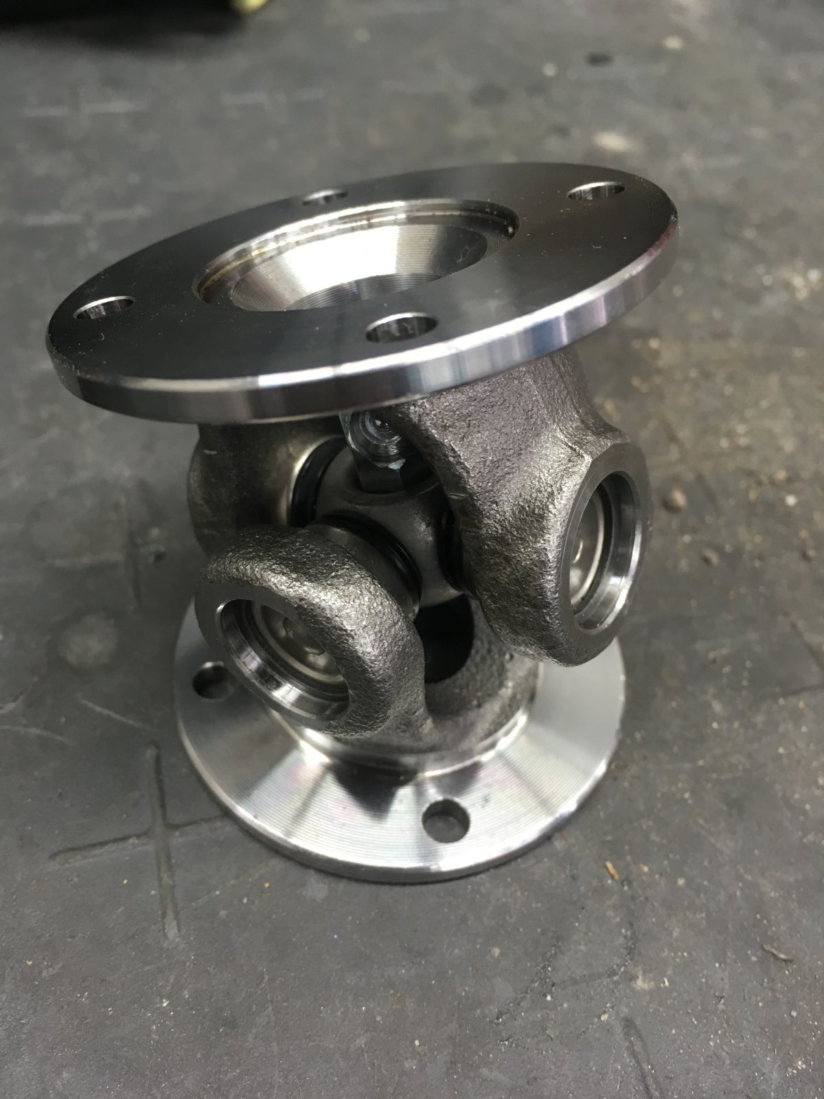

    got the universal joint in today. I think he's a little on the small side. Only 60mm high, hope that is high enough. parts are now coming in slowly.
    Keep u up to date

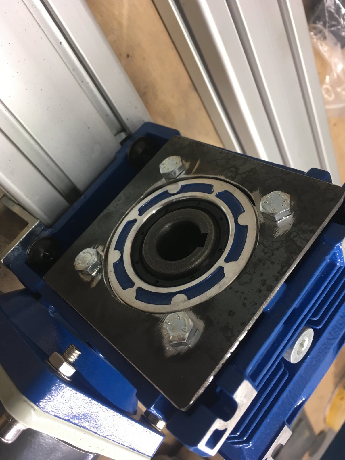

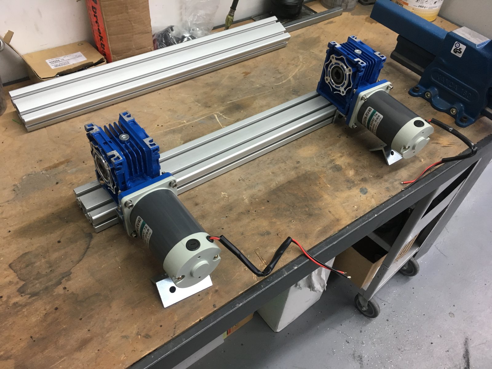

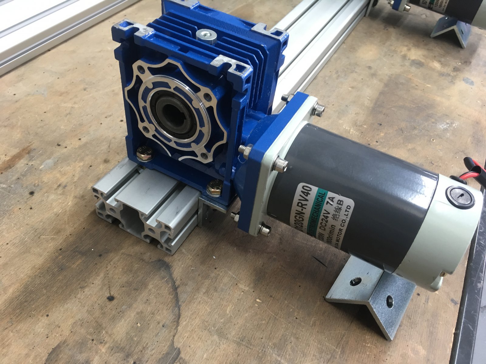

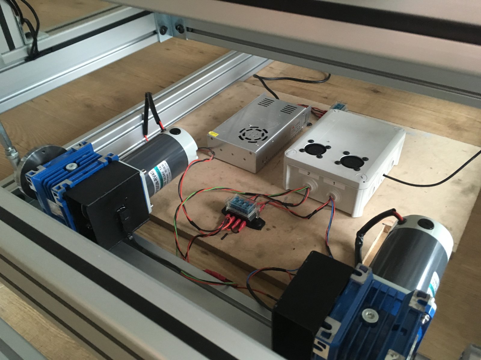

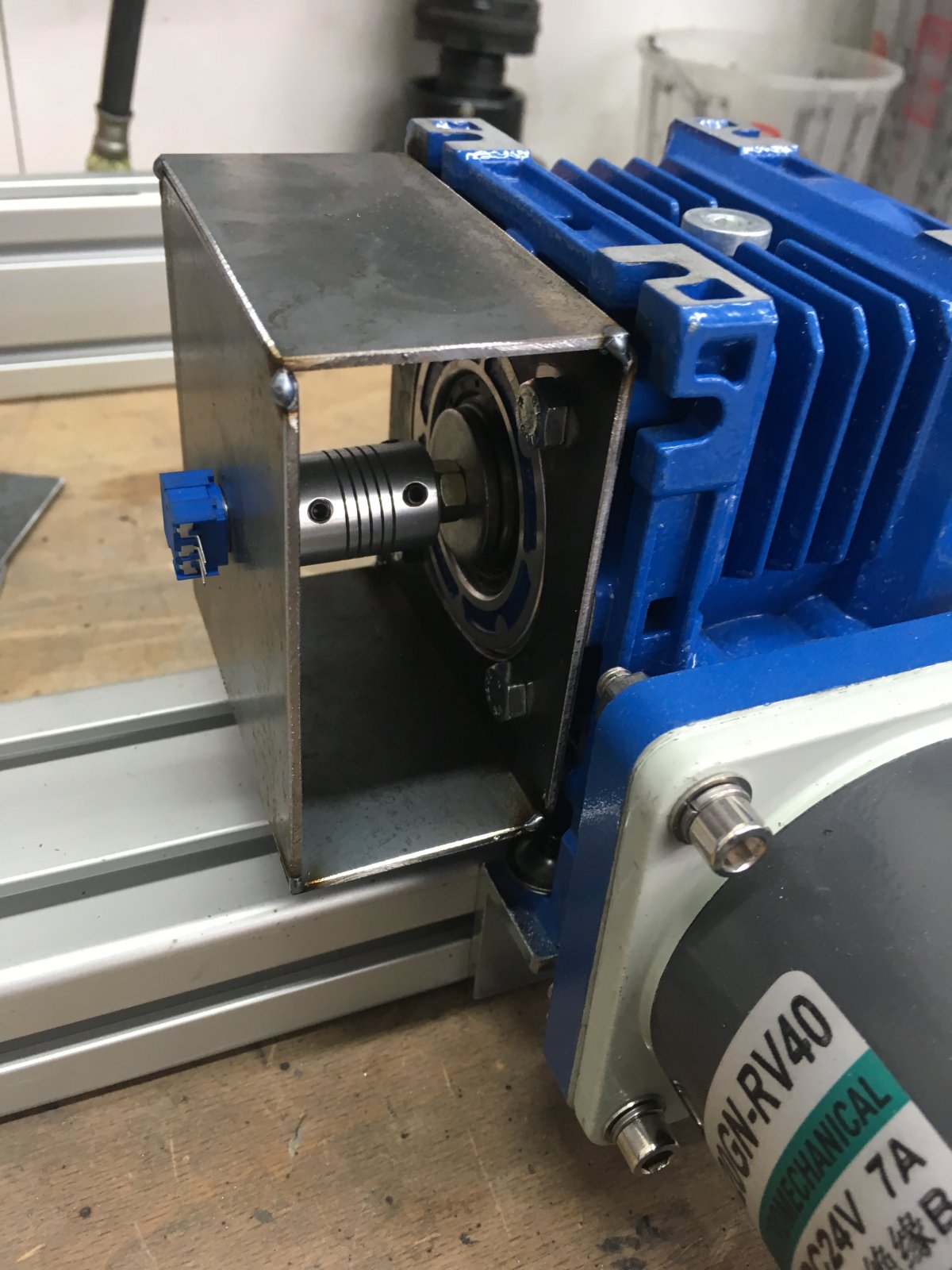

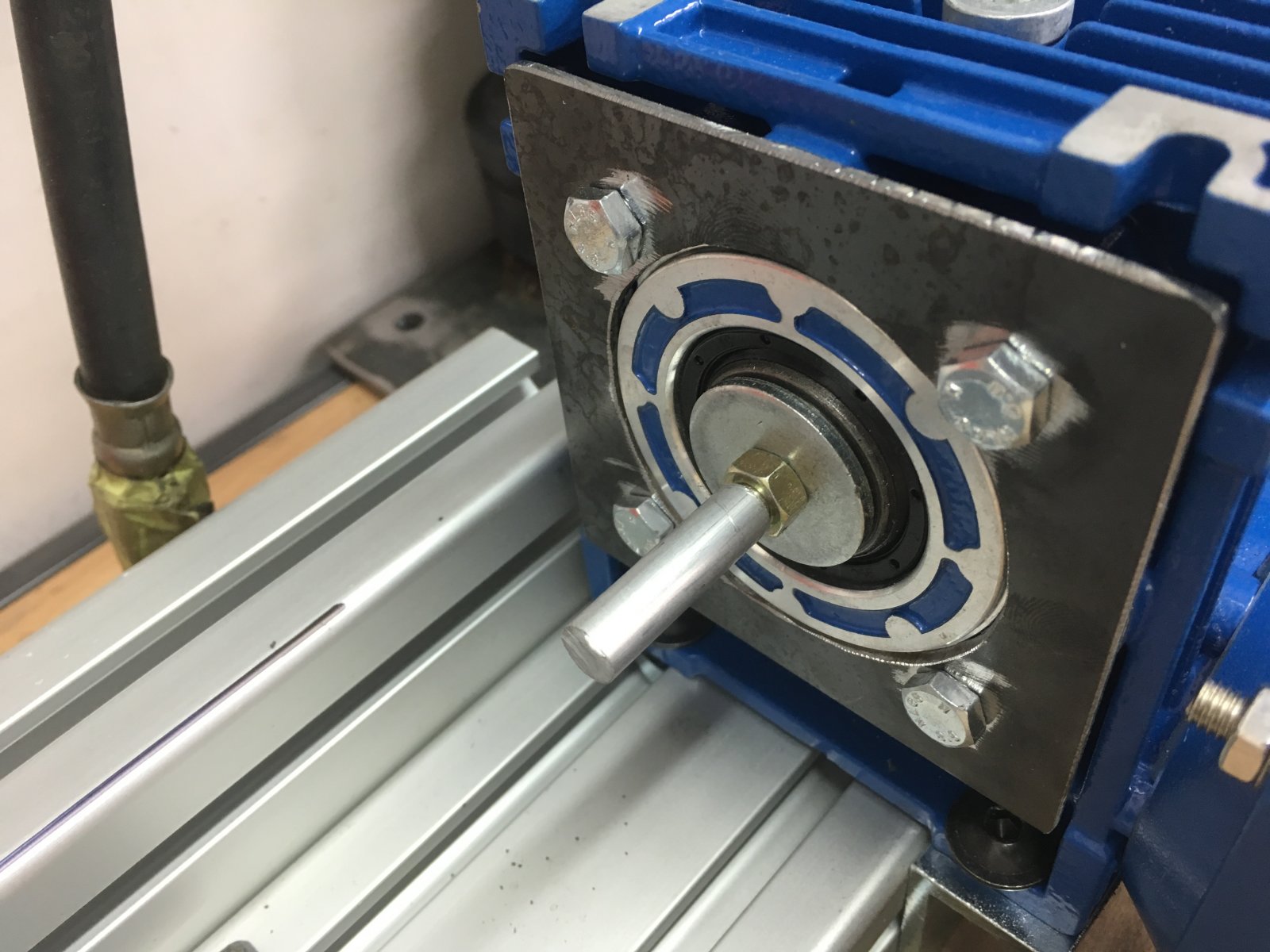

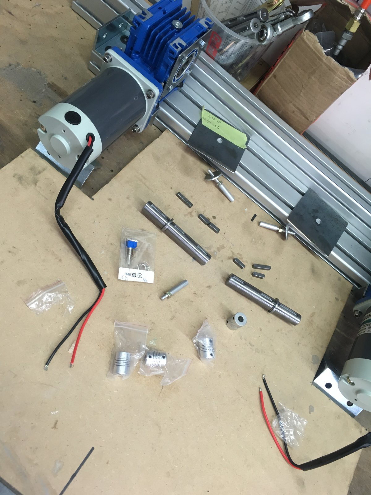

    Update.

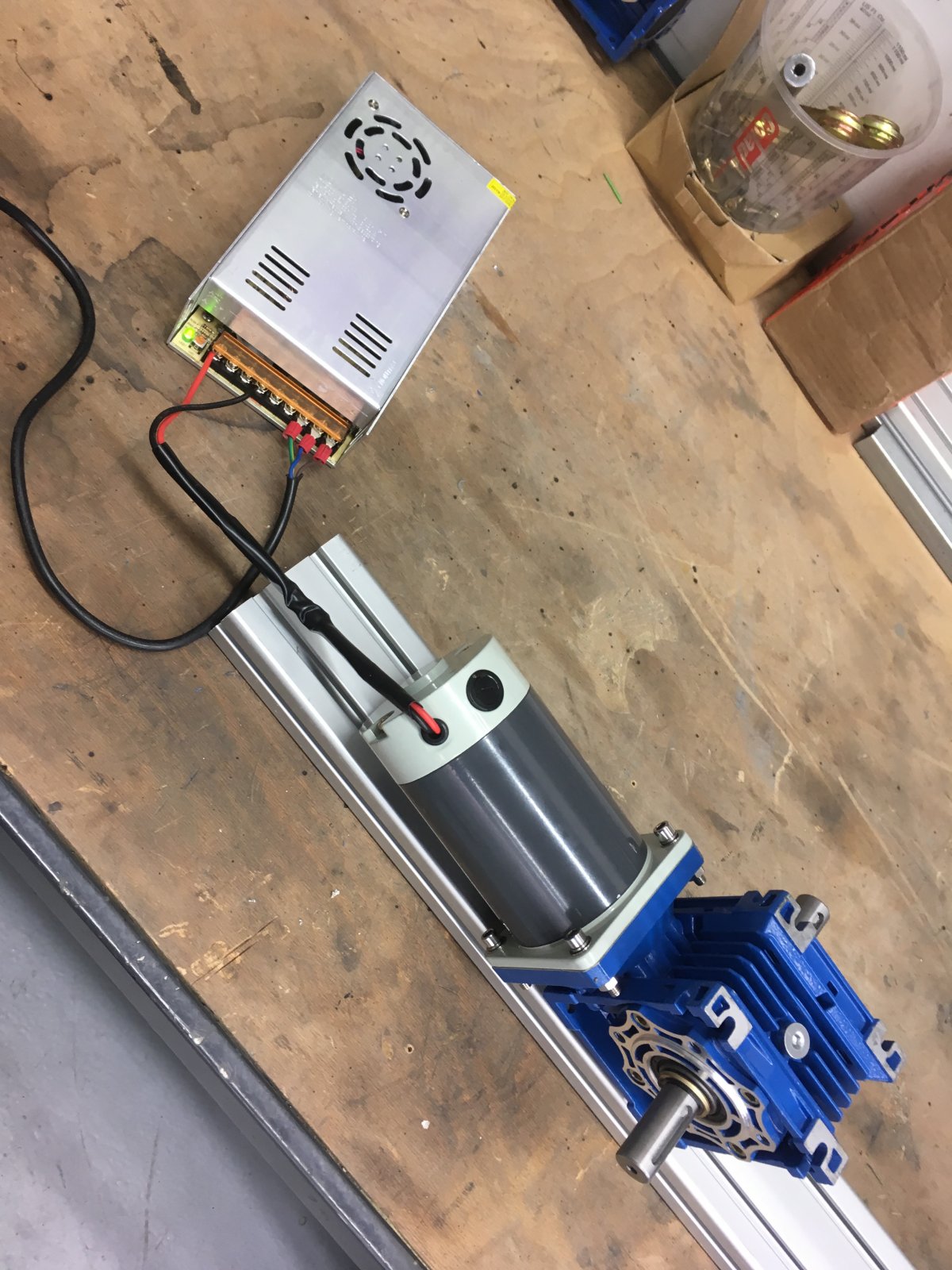

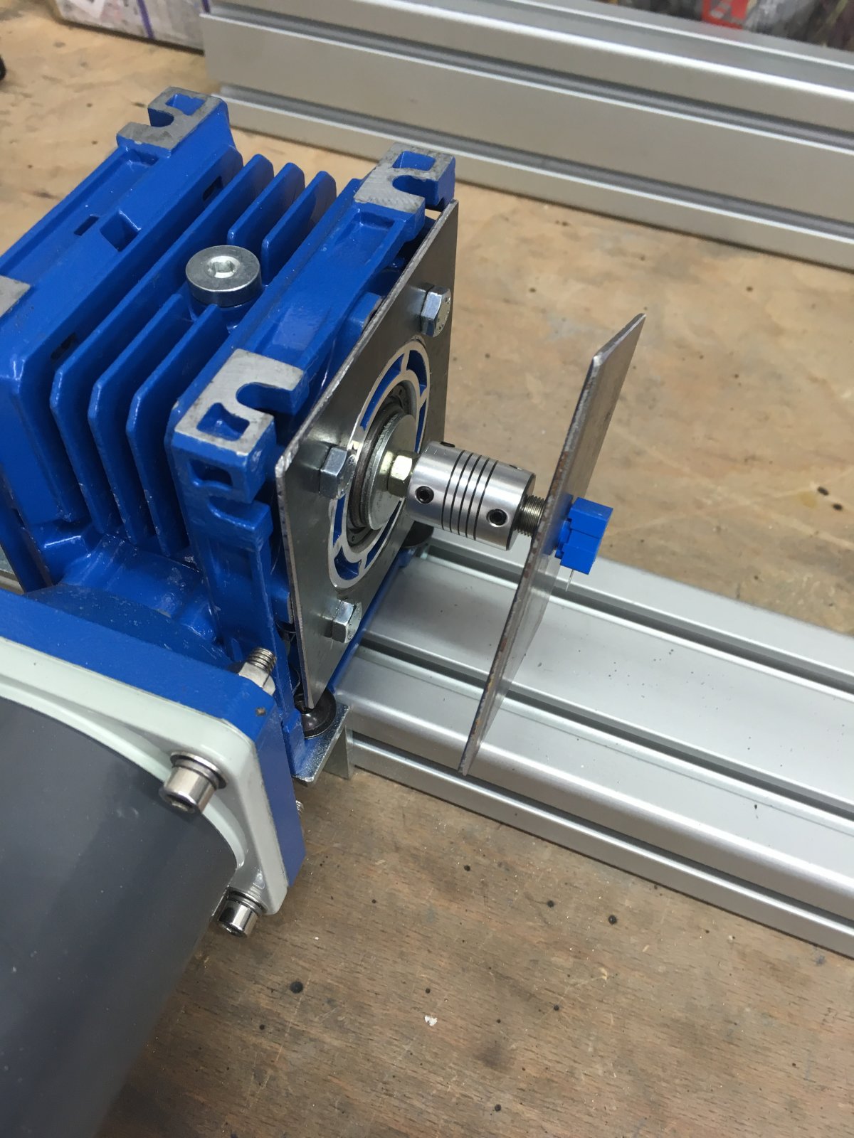

    Got the motors. Still waiting for Some small parts.
    F12A1295-9C3D-4EE9-9E6C-67B7BD47469C.jpeg DF4593C6-AE16-4213-B9E1-215E62A00596.jpeg
    Motor test.
    39043B4F-C3B1-42EB-91ED-B85524C3145A.jpeg 07C2CCC9-3DD4-43FE-9BCC-E686D1466806.jpeg

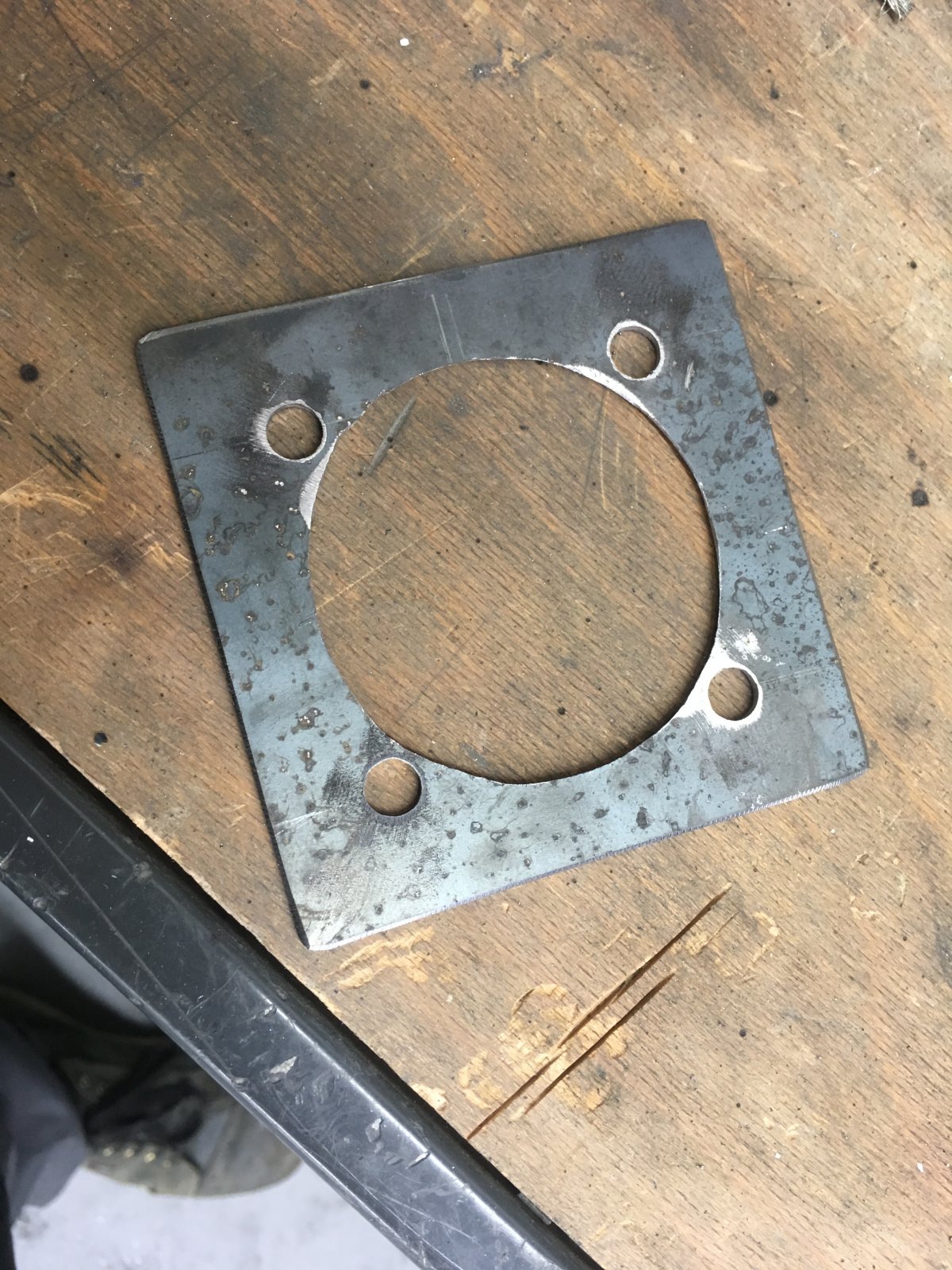

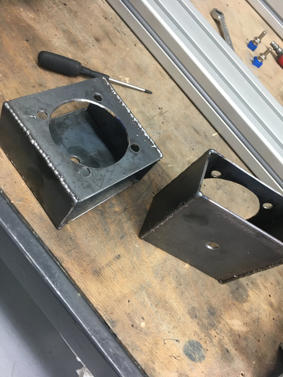

    Making Some brackets and support for te motors.

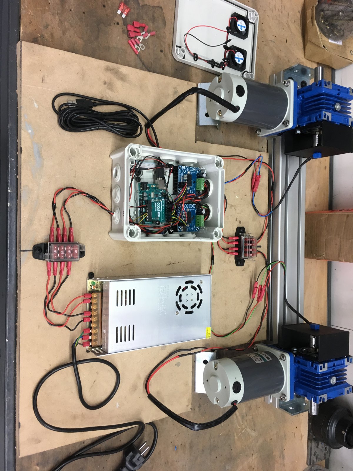

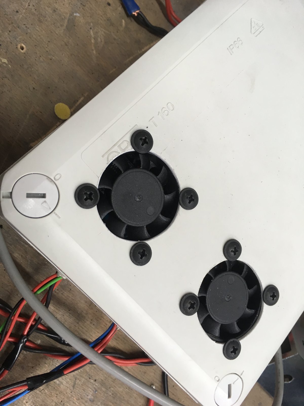

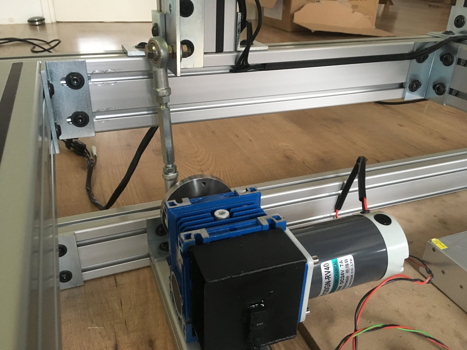

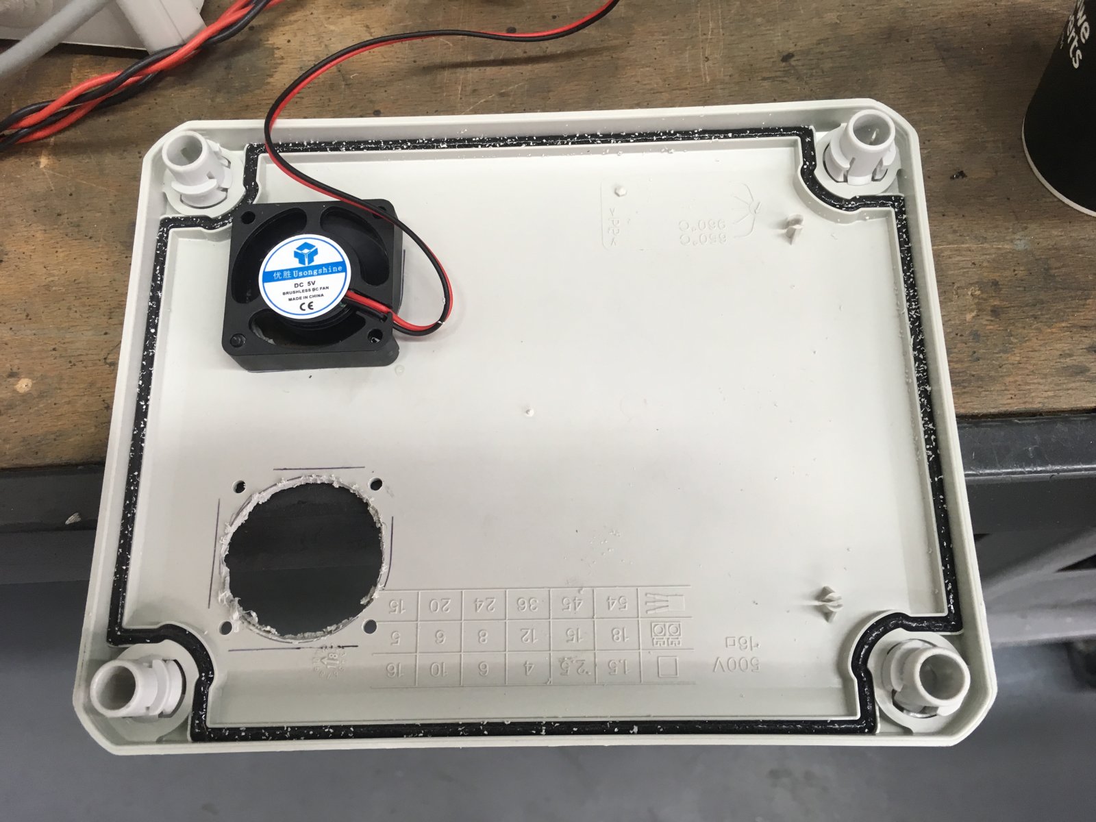

    update

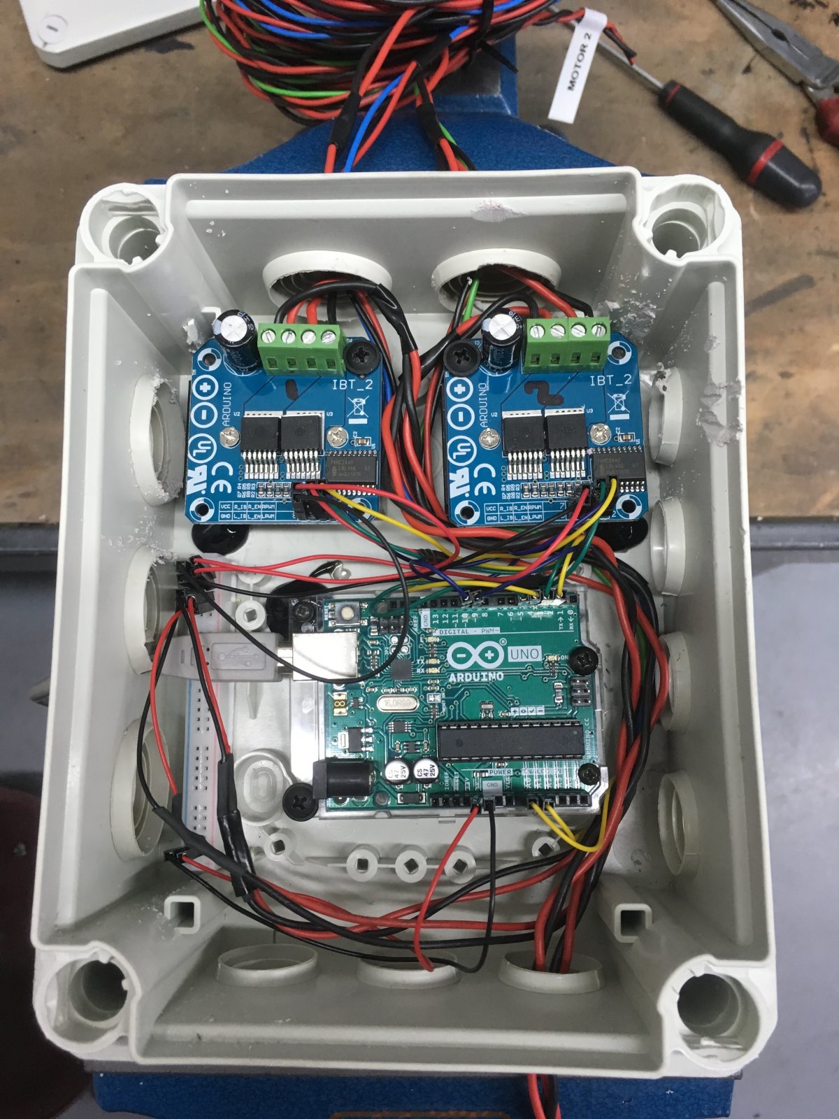

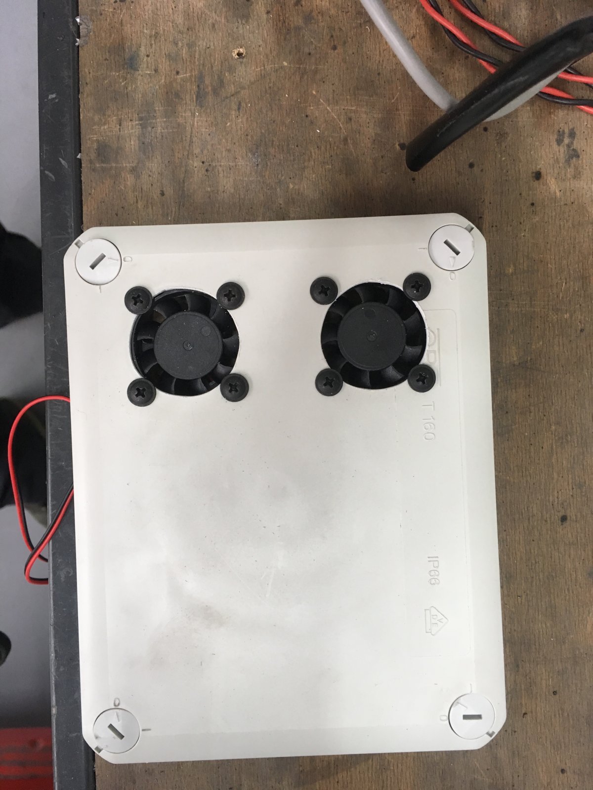

    made 2 cooling fans in the control box:
    strated on connecting the wires:
    parts:

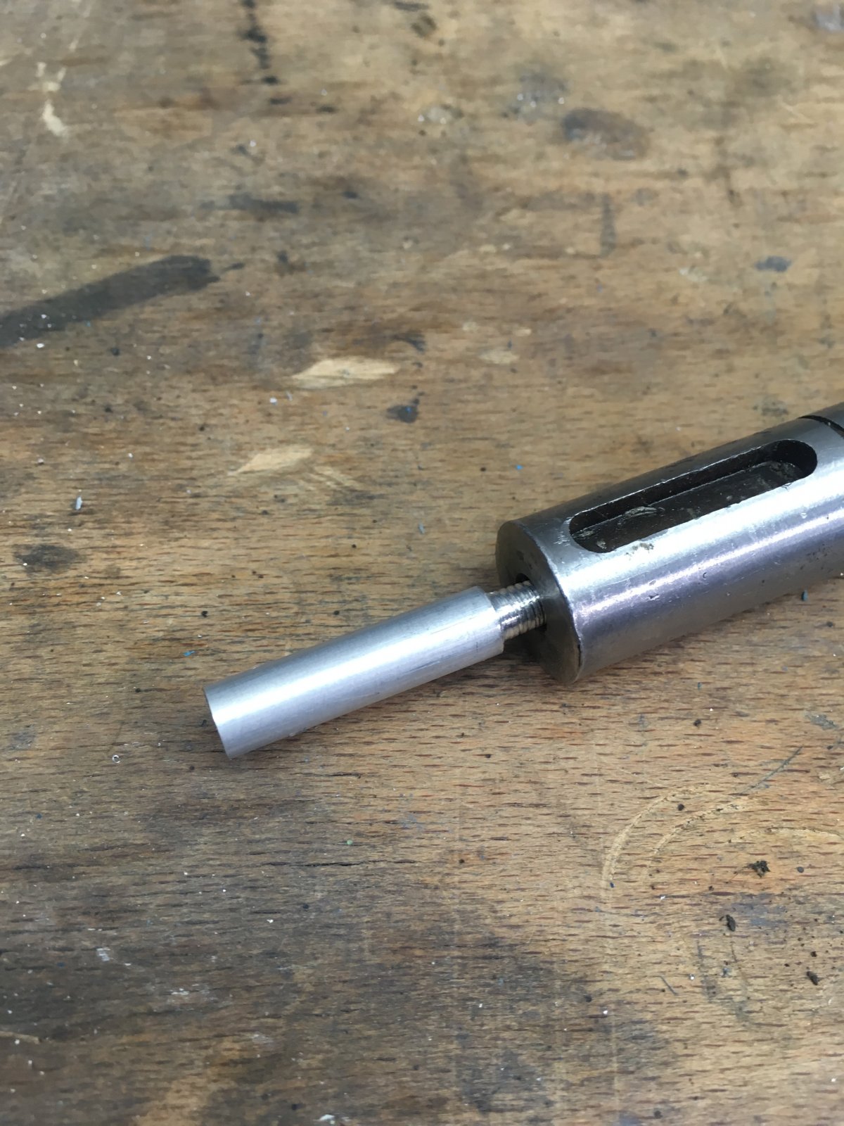

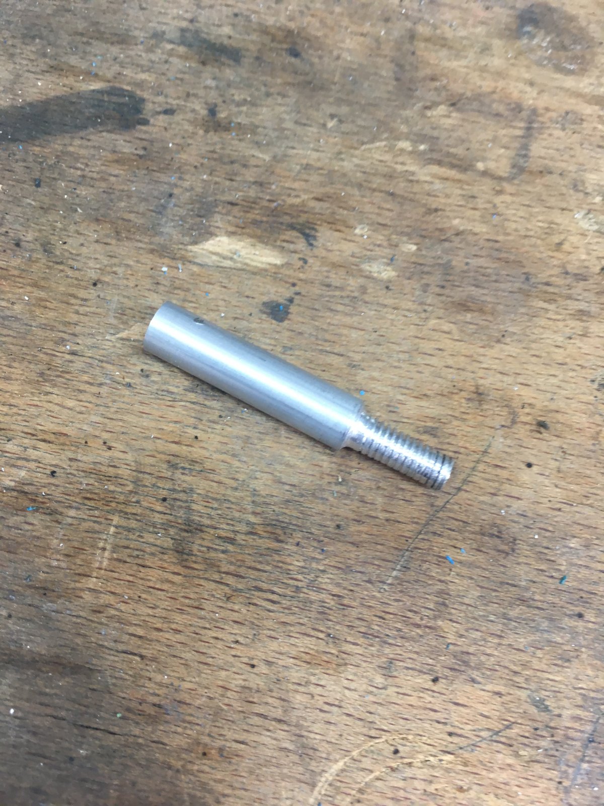

    custom made pot. support:
    IMG_7845.JPG IMG_7846.JPG IMG_7851.JPG IMG_7852.JPG IMG_7853.JPG IMG_7854.JPG
    continue to connect everything tomorrow.
    then i can go to test.
    a local metalworker is making supports that fit on the motor shaft.
    if all goes well I can pick it up on Friday.
    then maybe I can make the play seat move this weekend :)

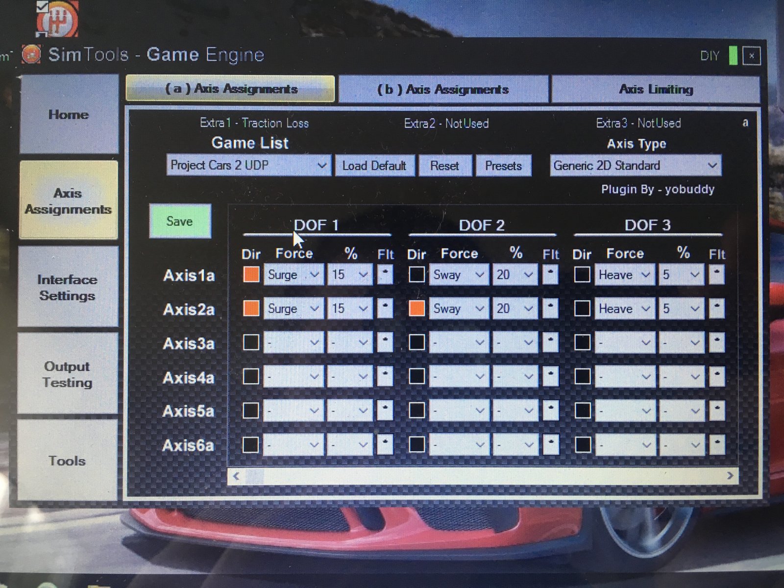

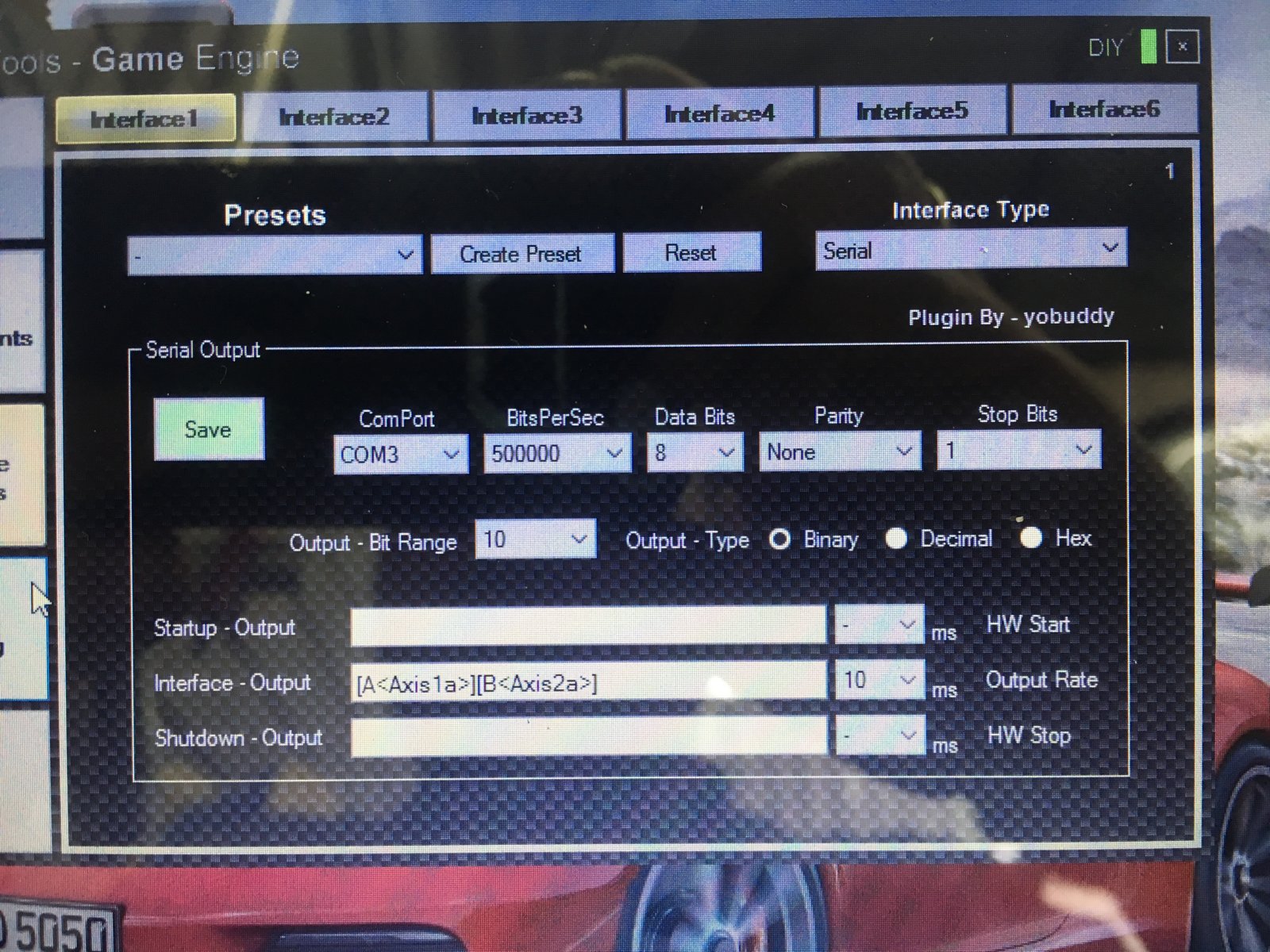

    Ok everything connected:
    set quickly still needs small tuning:

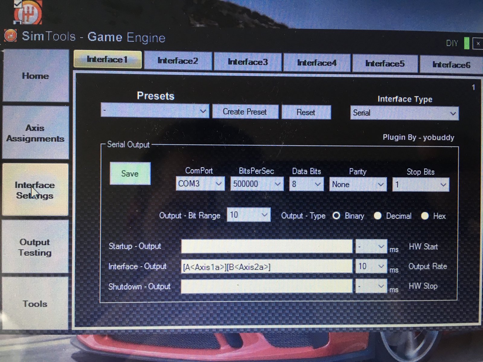

    Simtools set up:
    And a fast run with
    NoLimits Roller Coaster Simulation 2

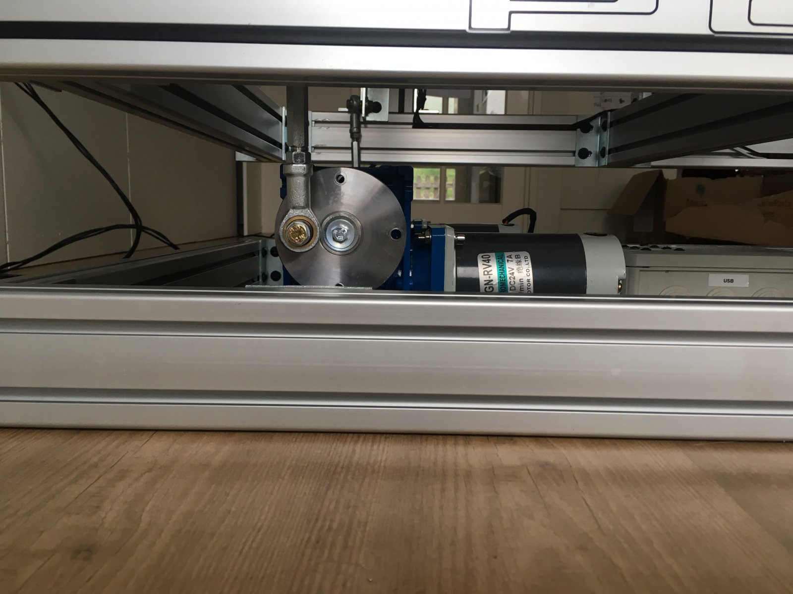

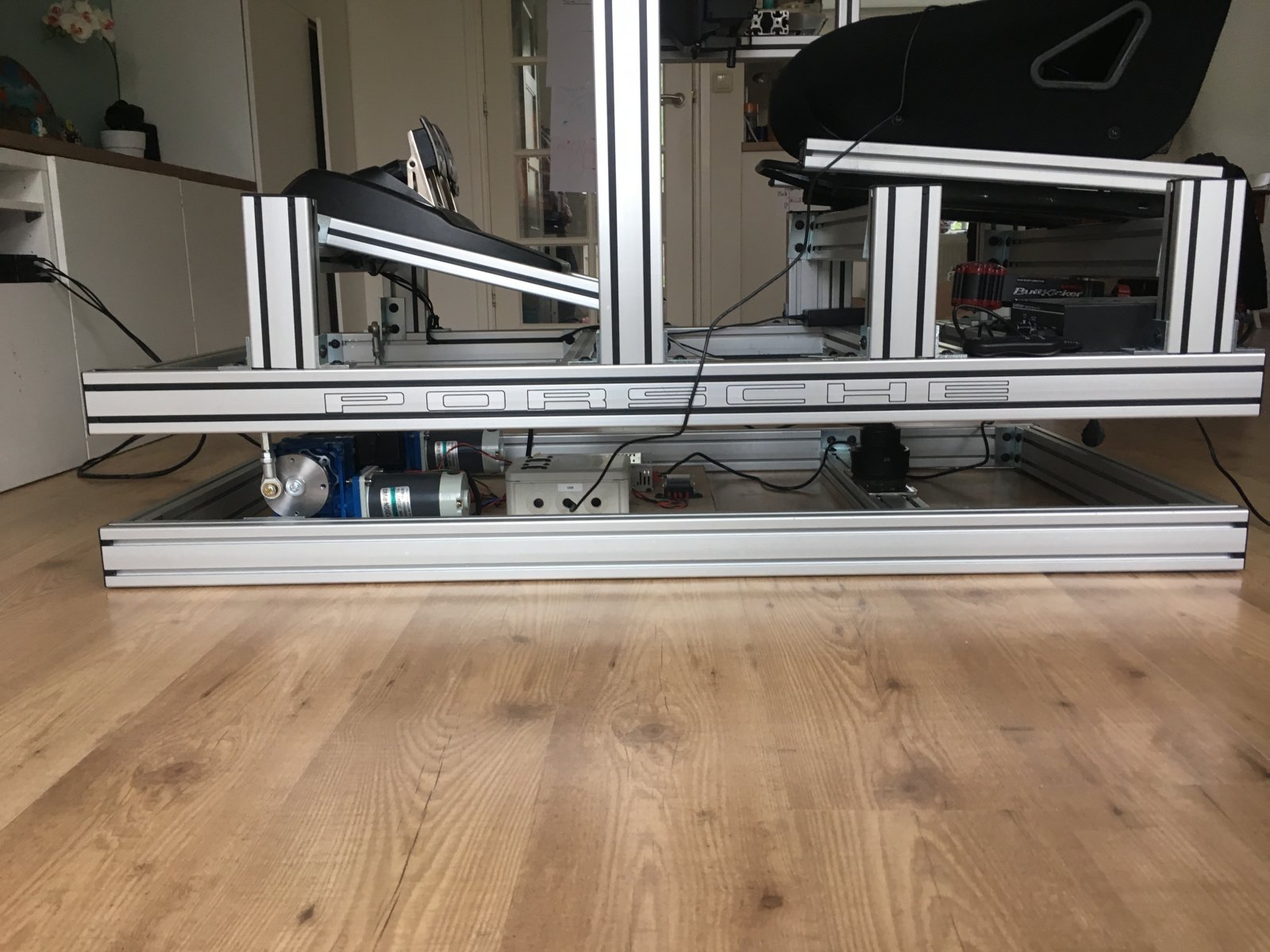

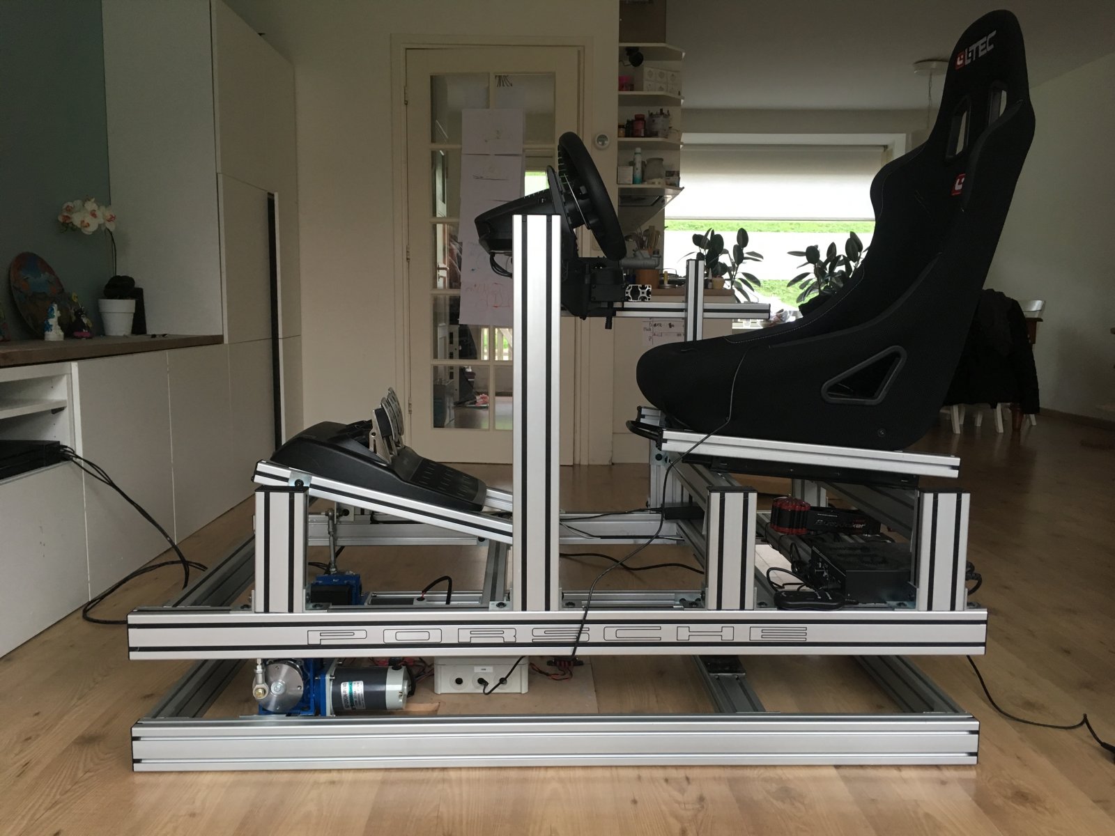

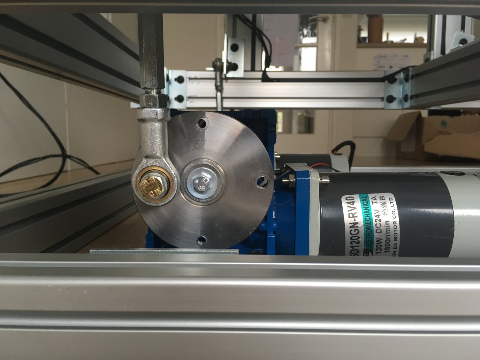

    Ok product finished :)
    F7A7A429-2CDA-4457-95ED-F4CC328DCC50.jpeg B860EFA9-F51D-405E-B446-1D51330741A6.jpeg 54D8E7C5-9FB3-441C-A9D1-962971DC85AB.jpeg A6391DE2-74E8-4D94-AEC4-5F3431F05E15.jpeg 7D874E7D-4434-4C04-9B99-C49ED4ECDBF7.jpeg B3E6B245-2F88-43A5-9CC5-C1F3F9689E2F.jpeg

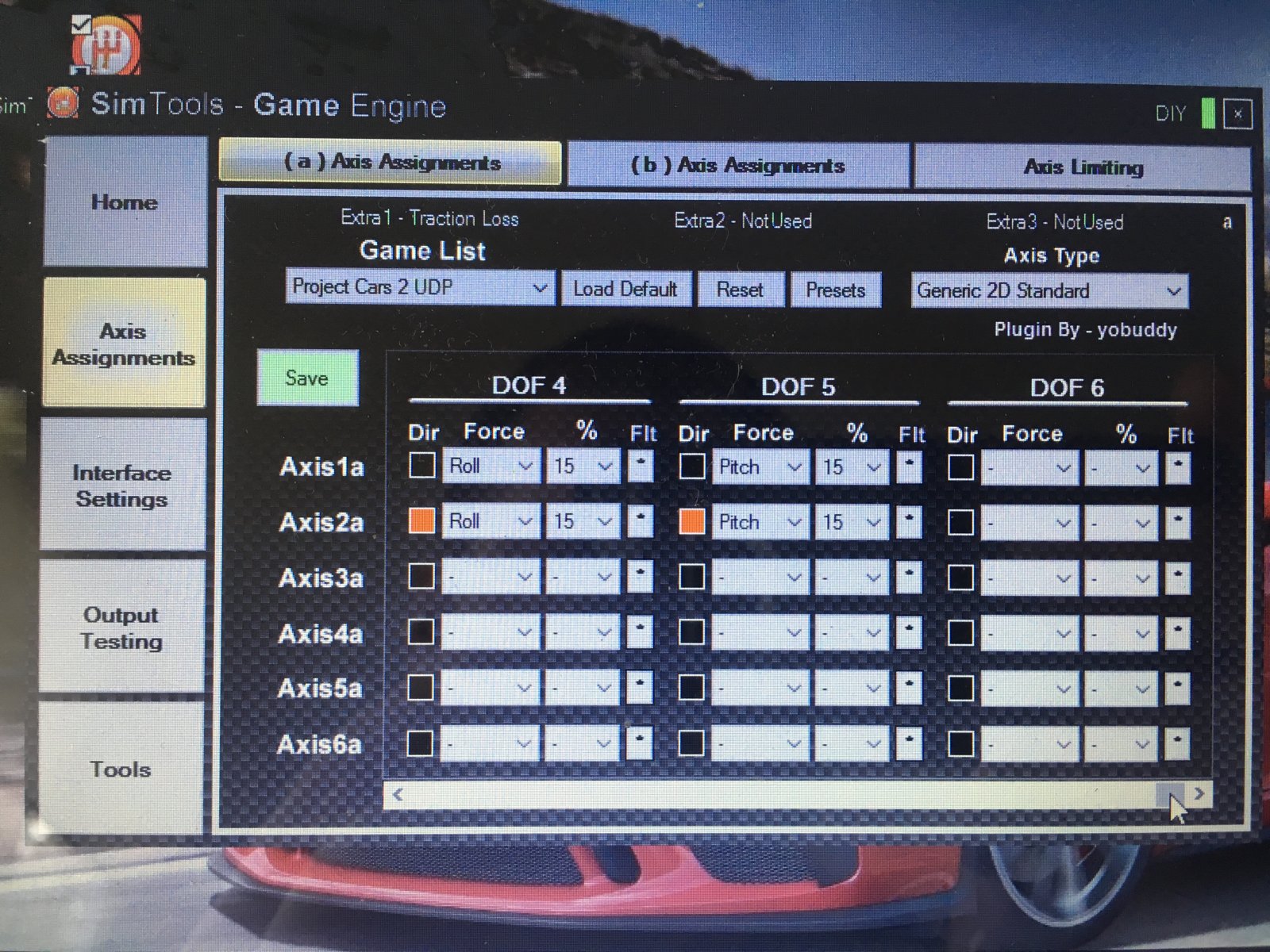

    Here are Some foto’s of my settings.
    C17170C1-E16F-46B2-8BF6-2644D7868C16.jpeg B060DADE-5CA3-47ED-B340-62771005804D.jpeg 05DBFA63-4442-4279-AD3E-A5478D8BE875.jpeg B051554D-3189-42EF-BC25-CF6BD38CDB70.jpeg
    feels pretty good now. maybe I still have to do some fine tunning. will see if I can make a good video tomorrow.
