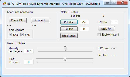

    After many request from people about using a K8055 interfaces connected to a sabertooth motor controller to drive motion simulator in SimTools.
    I have finally found the time to create a beta app to check my maths and see if I can drive one motor via the DAC of the K8055 as in the same way @-kevin- 's post works.
    The aim of this beta is to check -
    Direction is correct - as in motor turns the opposite way of the pot
    To see if a slider is needed to limit the overall speed the motors will move at
    Pot scaling I have implemented to scale the pots min and max values so the user can set it correctly.
    Startup and closing operation of the card
    Once all of these points have been addressed within the app I can implement the second motor control and Beta 2 can be tested in the same manner and finally then incorporate it with SimTools as a custom interface app.
    Please bear with me, I want to make sure this right and the same quality of simulation is maintained.

    Stage 1
    1. Wire as advised.
    2. Turn off the power to the sabertooth to start or motor will start spinning before app loads.
    3. Plug in K8055 and wait til it powers up and settles.
    4. Start the beta app.
    5. Click Check DLL - should return the Version Number of the DLL, Im using 4.0.0.0
    6. Set the Card Address you have set on the K8055
    7. Select the DAC Pin on the K8055 that S1 from the Sabertooth is connected too.
    8. Click Apply pin
    9. Make sure the Enable Motor is unchecked.
    10. Click Connect - Should immediately see the card has reported back to the app that it is connected.
    You will also note that the DAC pin you selected and is producing 2.5 volts to the S1 pin and the motor should stay stationary plus in the Motor Status the DAC used is 127 and Direction states that it is disabled.
    Aswell in this same area you will see that the Real Position is related to where the pot is positioned, please wind the pot back and forth to see that its moving the slider, middle position should read 0 set it there and leave
    I will explain scaling the overall pot movements later, yes this does that too.
    Ok please test:
    1. With pot reading 127 in the Motor 1 Setup area.
    2. Power on the sabertooth, if I got it right(cross me fingers) the motor should not rotate as it is disabled.
    3. Check Enable Motor 1 - and the DAC used should be 127 at pot position 0 and Direction should read "Stopped"
    4. Now by rotating the pot cw the motor should spin ccw
    5. Now by rotating the pot ccw the motor should spin cw till the pot is 0 in the real position the and the motor should stop.
    6. Now by rotating the pot further ccw the motor should spin cw
    Note: At anytime you can uncheck the Enable Motor 1 and the motor should stop.
    Now if the motor is spinning in its right directions , should be the opposite way the pot is moving then we are ready to test positional control.
    If happy close it all down and turn off the power to the Sabertooth and connect the pot back to the motor shaft and begin stage 2 test.

    But I see that the DAC 1, the light increases and decreases when I move the lever but the engine runs without control of the pot.
    I have the DLL_v5.0.0.0 because my card and k8055N
    http://www.velleman.eu/support/downloads/?code=VM110N&type=9
  6. eaorobbie
    20,504Coins
    +1,687 / 23 / -2
    Ok firstly thanks for testing.
    Ok is the address of the card the same, I have it set as default with both jumpers attached.
    But sounds like the card connected.
    1. You have set the pot min and max backwards, pot Max should be above 127 and pot min should be below 127, sorry code doesn't support inverting the pot, but I will add this , nice find.
    With the min max set correctly and pot is unattached from the motor and manual set target set to 127 is the direction of movement correct while moving the pot.
    2. Different card shouldn't matter.

    Hello eaorobbie,
    I tested your beta software, and here is what I found,
    1. With pot reading 127 in the Motor 1 Setup area. :thumbs
    2. Power on the sabertooth, if I got it right(cross me fingers) the motor should not rotate as it is disabled. :thumbs
    3. Check Enable Motor 1 - and the DAC used should be 127 at pot position 0 and Direction should read "Stopped":thumbs
    4. Now by rotating the pot cw the motor should spin ccw :thumbs
    5. Now by rotating the pot ccw the motor should spin cw till the pot is 0 in the real position the and the motor should stop.:thumbs
    6. Now by rotating the pot further ccw the motor should spin cw:confused:
    it did not spin cw direction......it kept spinning ccw direction
    So now I stopped at this stage waiting for advise!!!

    Same thing cyberxu .... the engine runs only in a clockwise direction that is in the max for me but I had no counterclockwise axes reversed and I put them affixed.
    Then I have another question: I can not put the min less than my 127 starts at 140 min then put screenshot:
    MIN
    MAX
    Something wrong?:confused:

    Ok found my error , logical error in maths for the DAC control. My bad, but not giving up on this.
    Have done a quick vid on the control , does this look right now.
    Sorry haven't done the axis inverting yet will test later tonight and add that will help if people wire the pot backwards. Thanks for the suggestion.
    Updated Ver. have changed it aswell in the first post too.
  16. eaorobbie
    20,504Coins
    +1,687 / 23 / -2
    @-kevin-
    Ok had time to look at inversion of the pot. Now seems to be correct, only testing will tell. Thanks in advance
    Ok if you wish to invert the pot, set the Max for the pot above 127 and the Min below 127, now simply check the invert pot, you will notice the scaled position is inverted, just need a confirmation I have the motors turning the right directions. Then this will be added into the main program.
    Cheer Robbie.
    Ps new test app ready. First Post.
  17. -kevin-
    -kevin- Fast e Furious
    Apr 6, 2012
    249
    Termo Tecnico industriale
    128Coins
    +175 / 1 / -0
    2DOF, 3DOF, DC motor, SimforceGT, 4DOF
    I do not know if the video you will understand why I write.
    I think I have problems with knobs on my sim I have to replace them probably took too many shots .....
    By moving the lever to the left of the DAC motor turns counterclockwise
    Selecting invert the pot and moving the lever always left the motor rotates counterclockwise.
    By moving the lever to the right of the DAC engine rotates clockwise in both cases.
    I noticed that the motor moves slowly ... what can it be?
  18. eaorobbie
    20,504Coins
    +1,687 / 23 / -2
    Ok @-kevin- so that's the inverted one, look like I need to work a lot more on that one. Was a quick fix , needs more.
    Did you get a chance to look at the other , non inverted (2). ?
    Speed, I have not ramped that up yet will be a slider for user to decide, eventually, without a sabertooth here, and I have never used a sabertooth myself, Im learning too. Ok I will try and update the invert one tomorrow, pretty sure what needs to change.
    Sorry taking a little while for me to nut out. Jrks made my brain go mushy I think, lol.
    p.s If you just close app , yes I have set on close for the DAC to be reset to 127 so the motors should stay in a stopped position. Safety on shutting down app accidently. Nice find , forgot to mention that.
