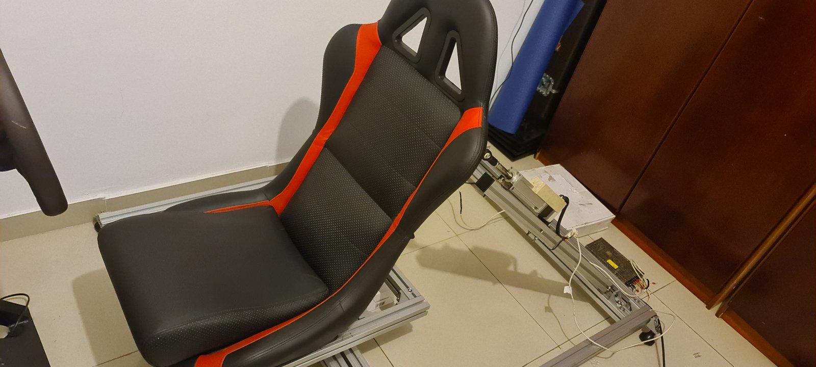

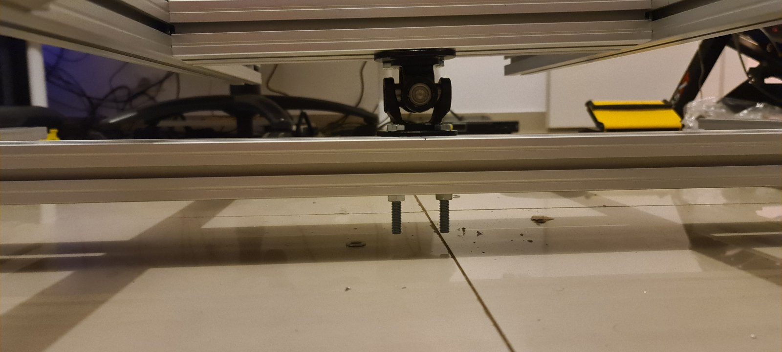

    I want to show you my first 2DOF that I build. I read and saw a lot of videos and texts from different sources to inspire me build this one. I think there are areas that i have to improve but I'm happy with the result.
    Sorry for my english, I'm Brazilian and I not use Enligh in my day.
    Items used:

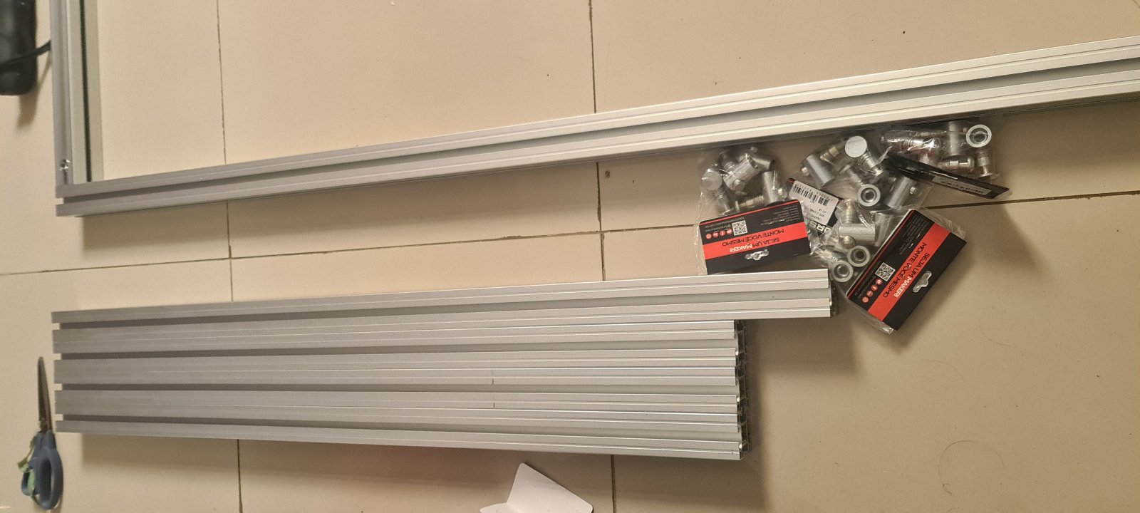

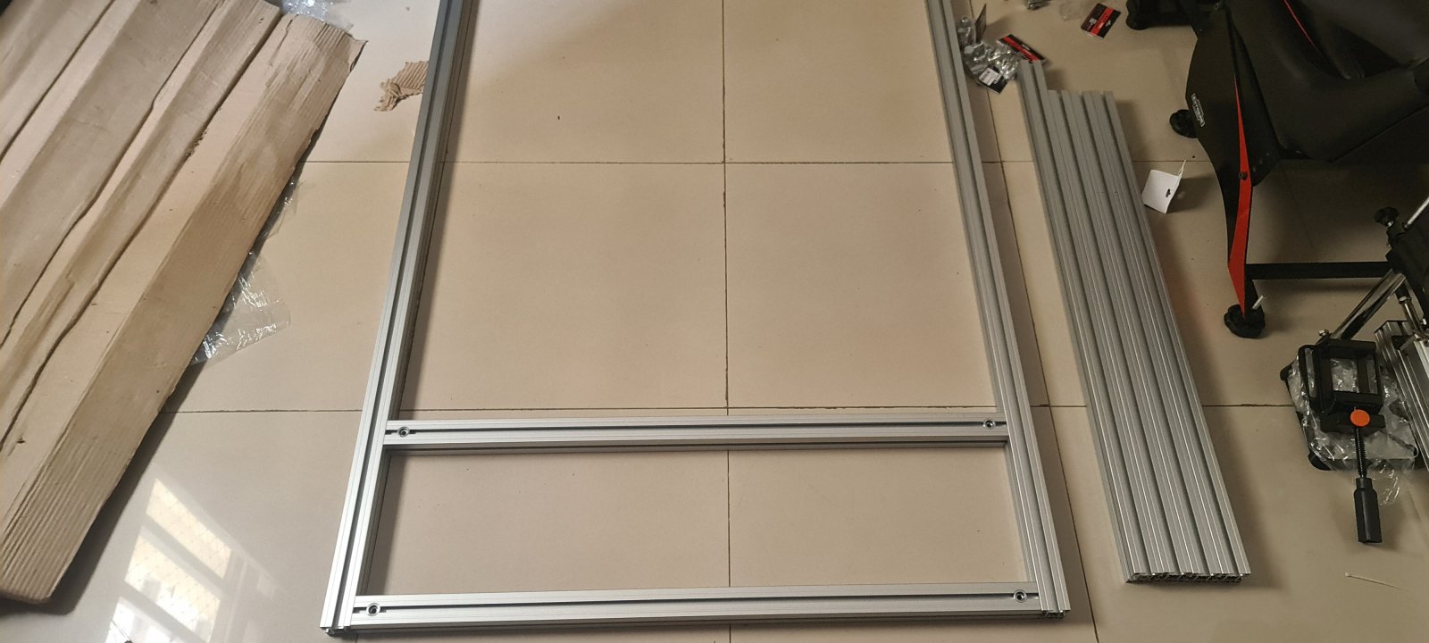

    1-) Aluminium Profiles
    2 X 1370mm (Vertical bars / Inferior Structure)
    4 X 920mm (Horizontal bars / Inferior Structure)
    2 X 700mm (Vertical bars / Seat Structure) / This one i had to saw: 600mm
    3 X 360mm (Horizontal bars / Seat Structure)
    2 X 730mm (Base for SCN5)
    1 X 450MM (Seat base connected with the SCN5)
    1 X 350MM (Seat base connected with the SCN5)

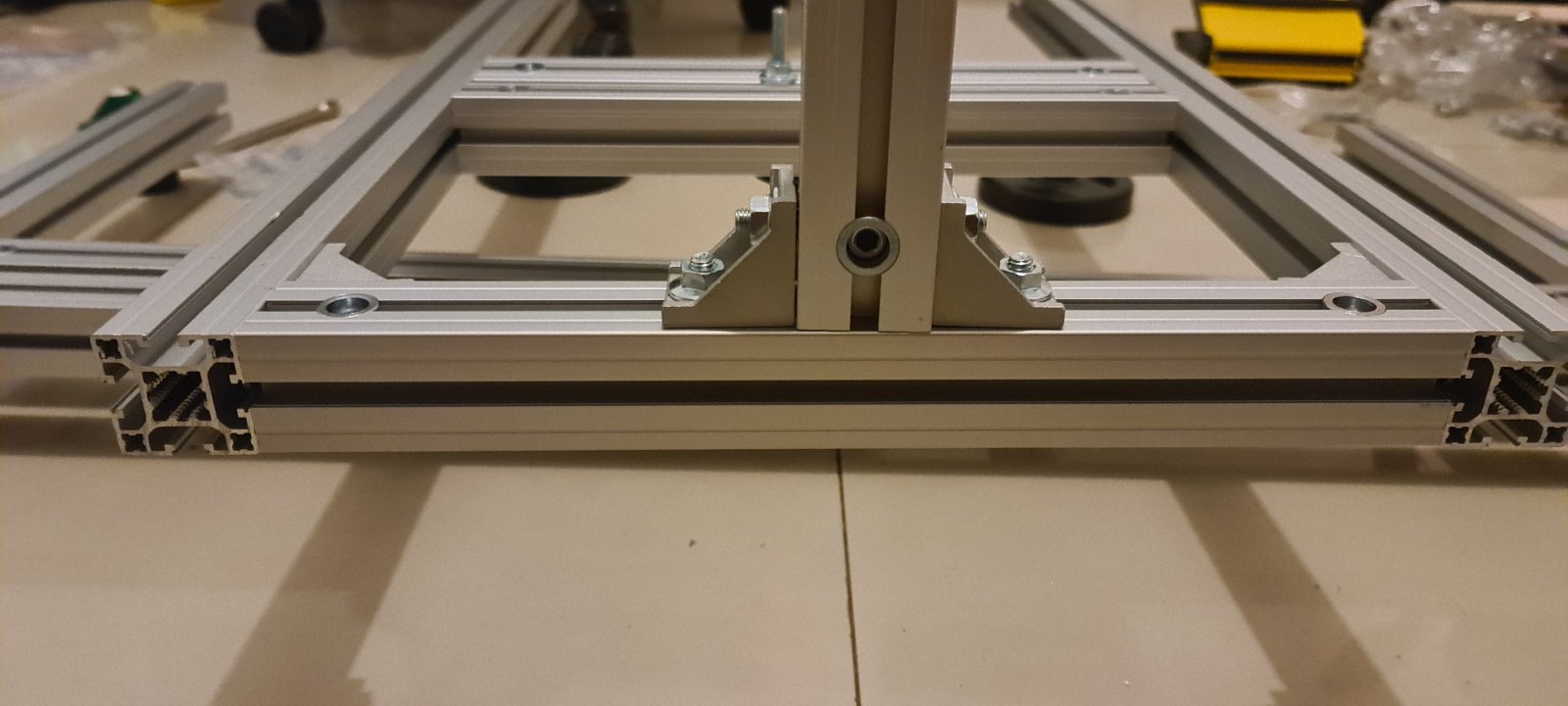

    2-) 28 X Aluminium Profile's corner joint
    3-) Aluminium Profile's internal connector for corner joints

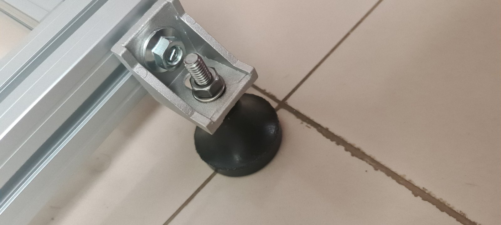

    4-) 4 Leveling foot (I choose one that is expensive but it's a dumper too)

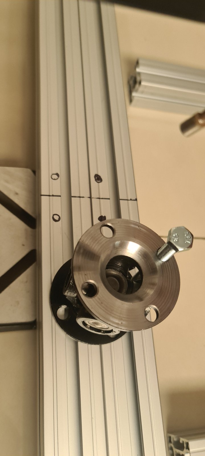

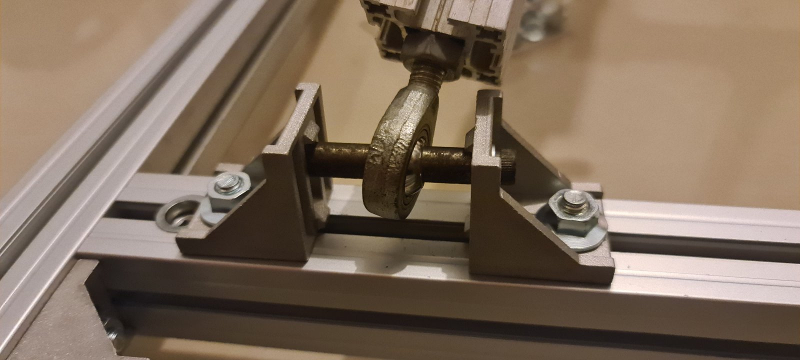

    5-) Universal Joint

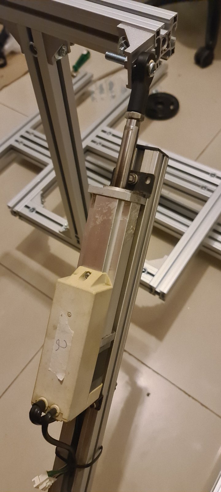

    6-) Pair of SCN5 (100mm)
    7-) Foam D33 (Density 33)
    :cool: 8 Rubber Mat 500x500mm (That one for crossfit :))
    9-) 4 Wooded Deck 500x500mm
    10-) A lot of screw/screw plugs (M8 and M10)

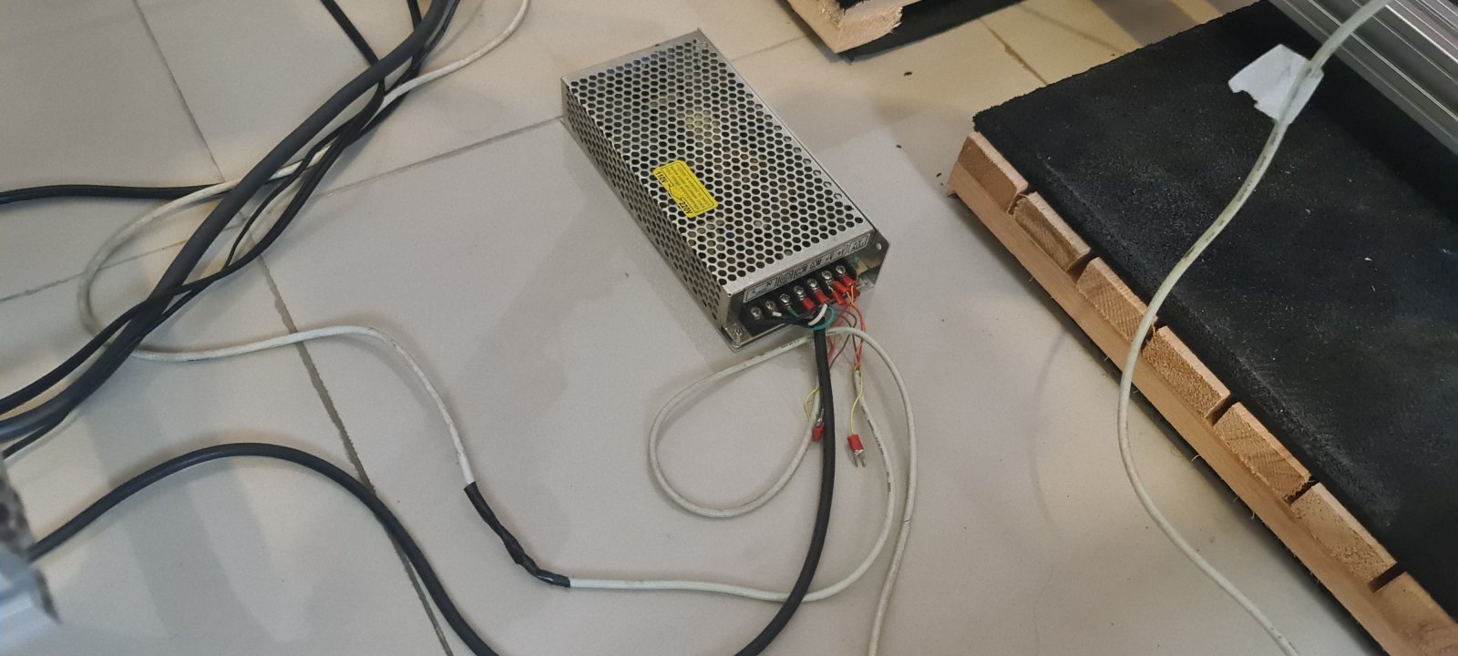

    11-) Power Supply 24V 6A

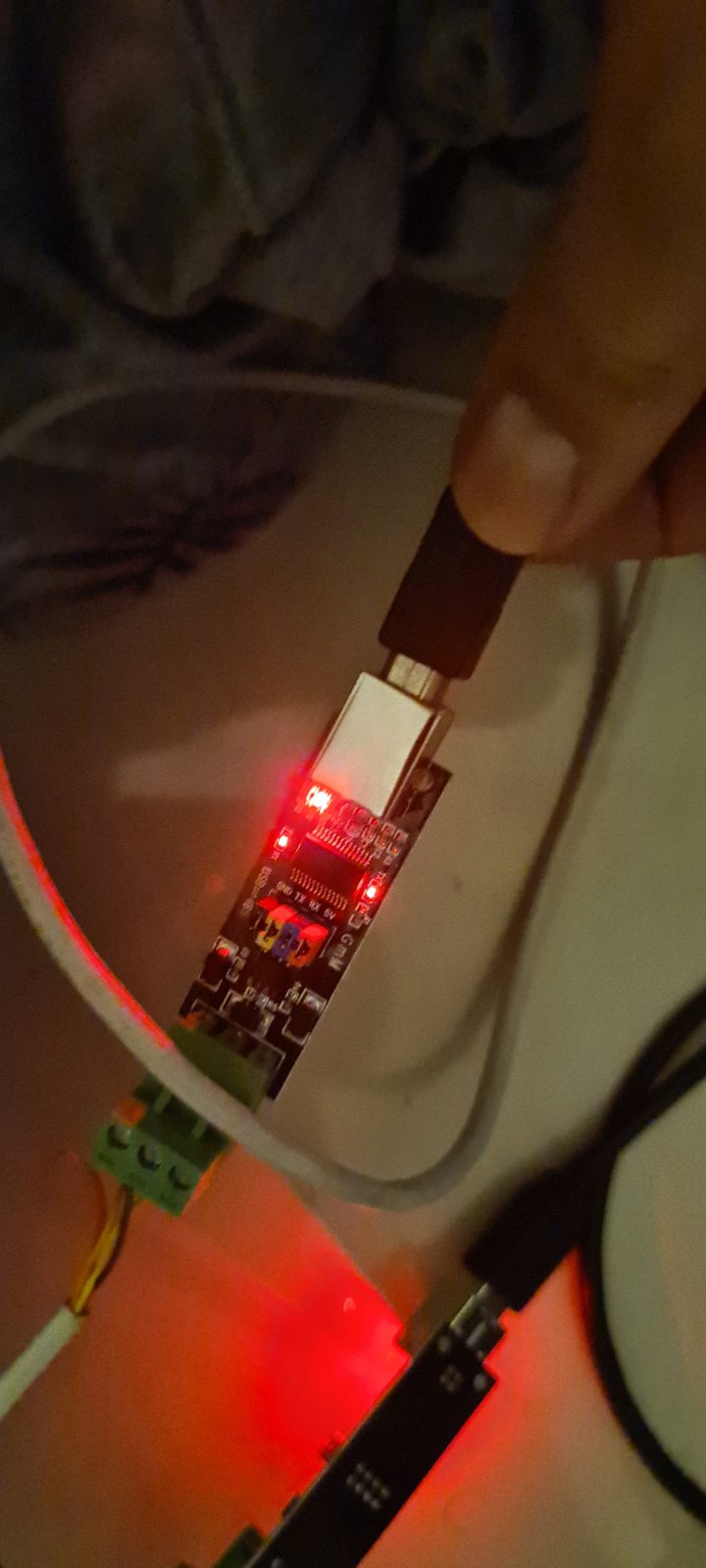

    12-) Pair of RS485 to USB

    Aluminium Profiles:

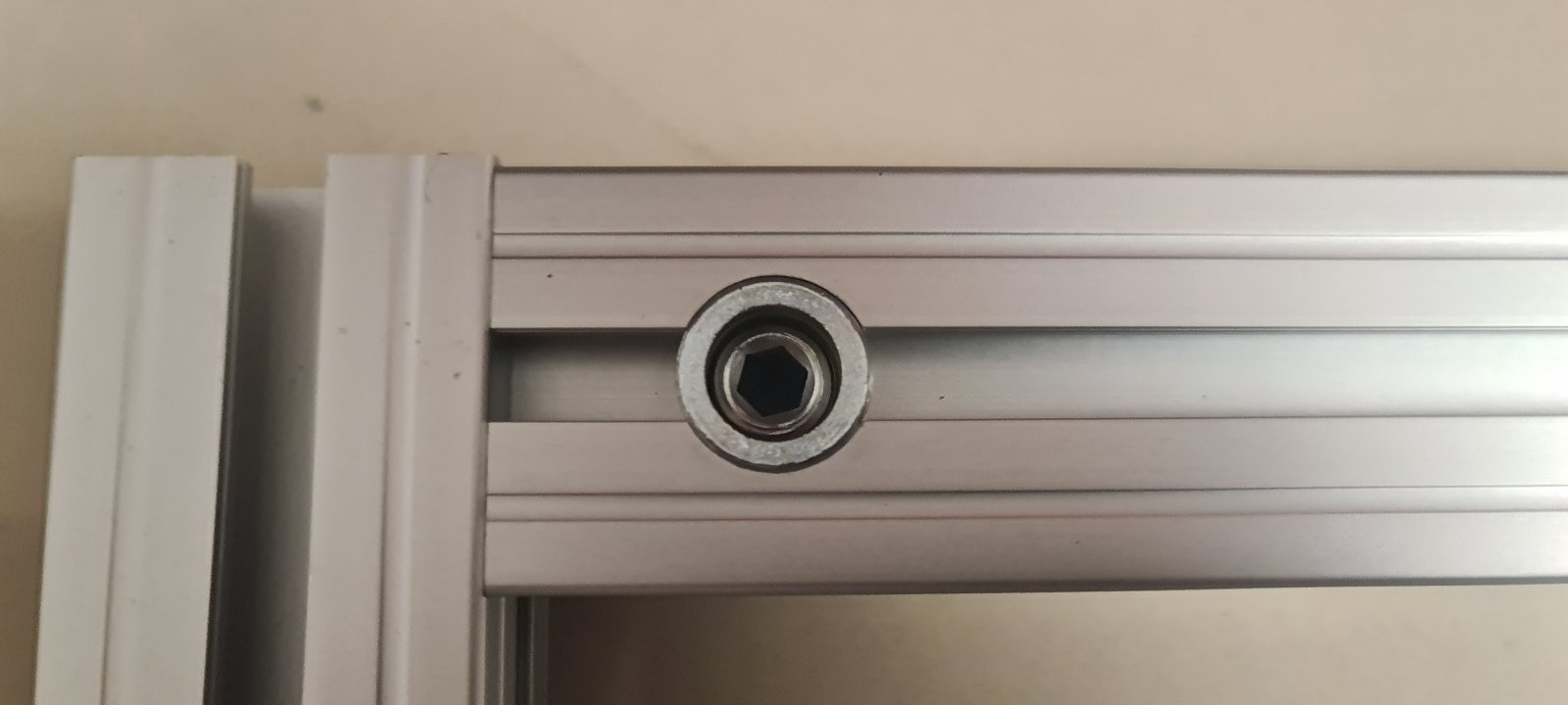

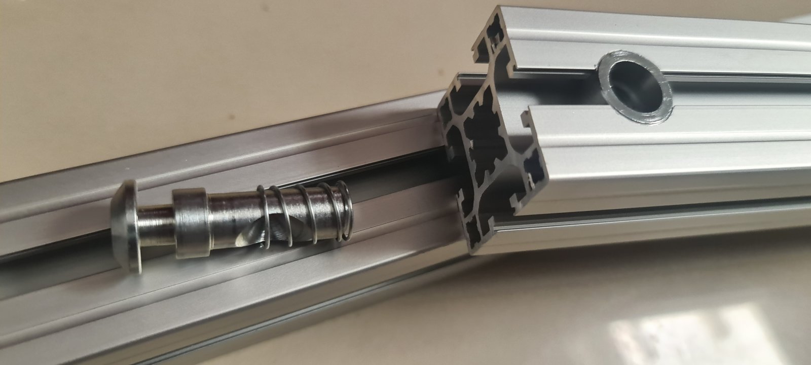

    Detail: Alumnium Profile's internal connector for coner joints (I don't know the name of this piece in English, sorry):
    Connection between Alumnium profiles and the internal connector:

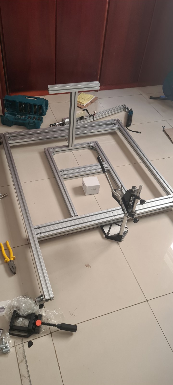

    Building:
    Leveling foot and Corner connectors:
    Building:

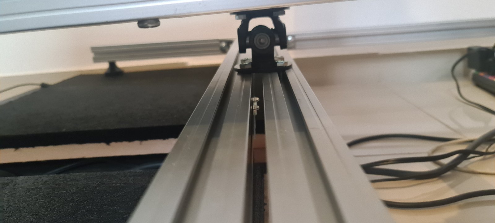

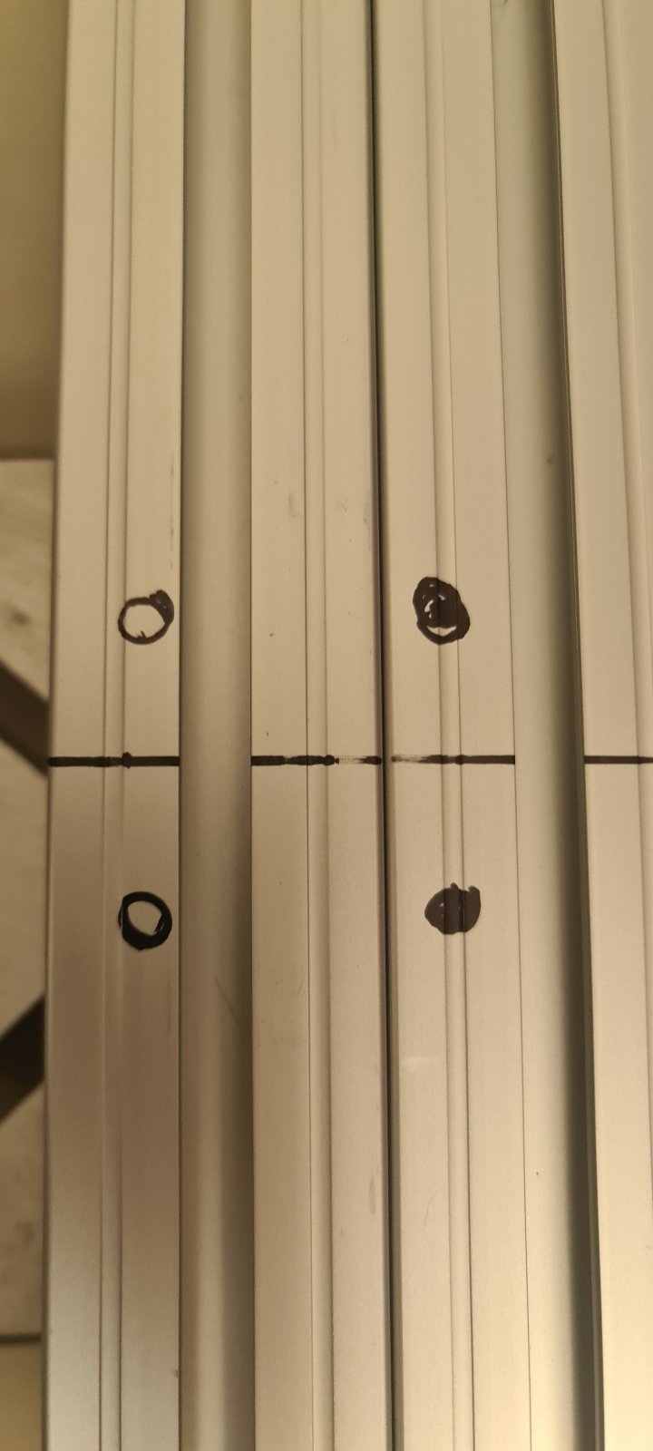

    Marking holes for Universal Joint:

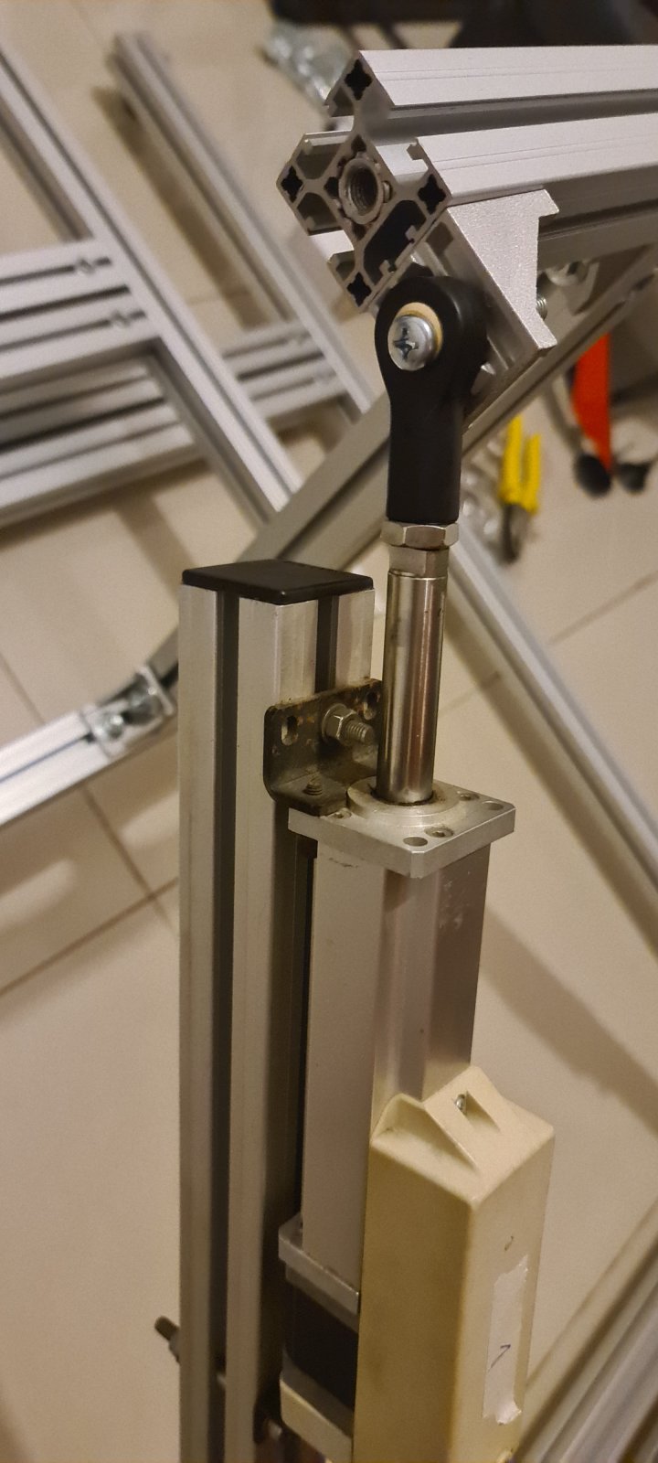

    Connecting the SCN5 with the structure:

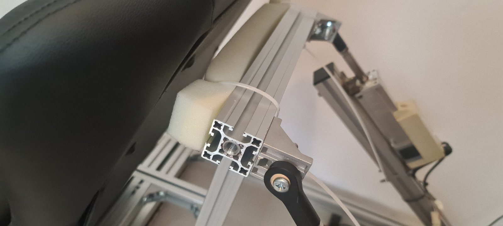

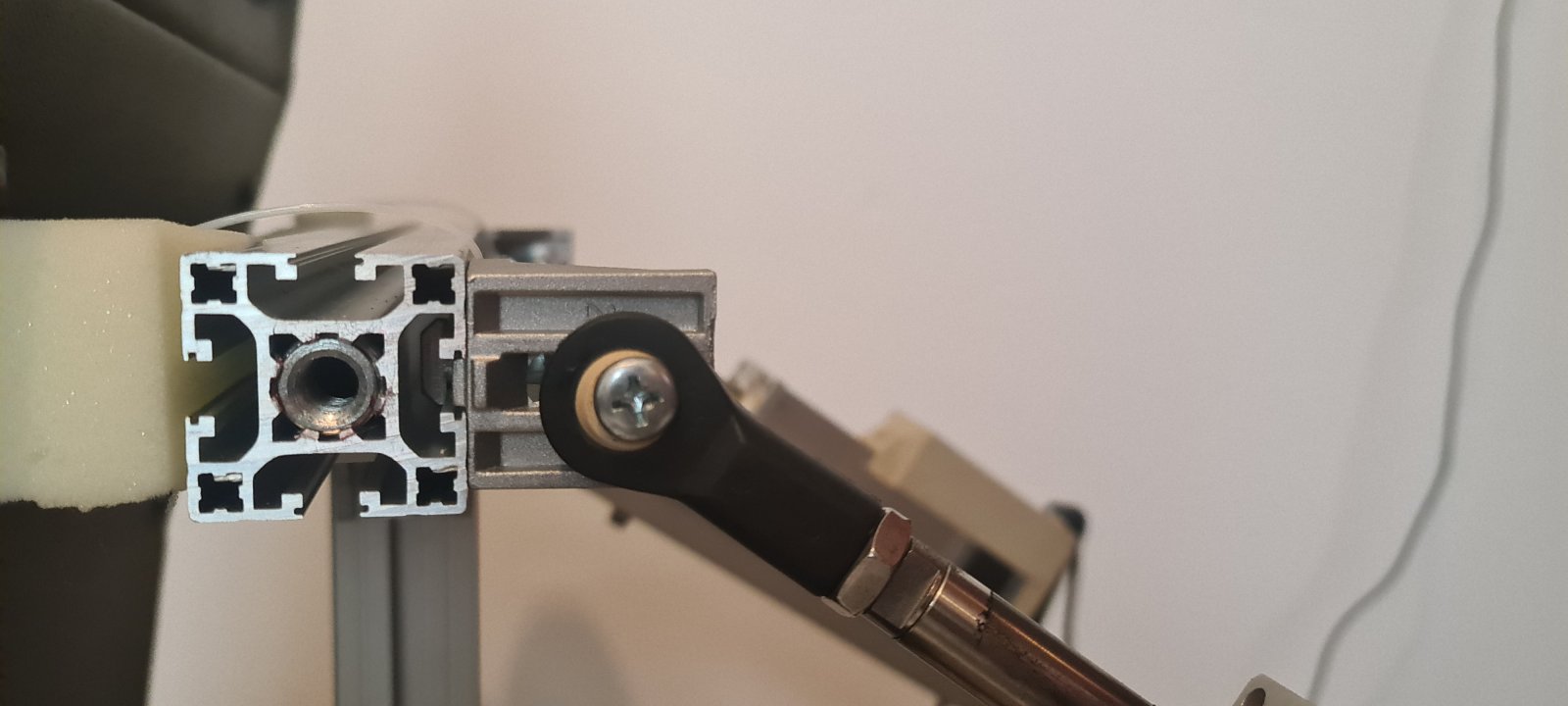

    Seat installed:

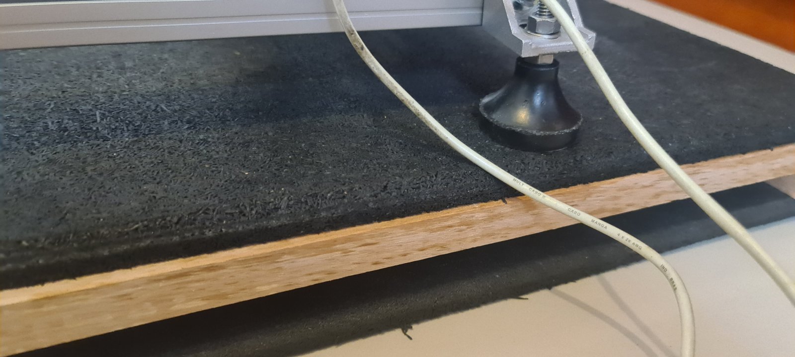

    Used Foam to attenuate vibration between seat and Structure:
    Rubber Mat/Wooden Deck to attenuate vibration to the floor (I live in an appartment):
    Power Supply and RS485 to USB:

    The universal joint was the piece that I didn't find anywhere because I didn't know this piece. So, you need to mount one using pieces of car (Portuguese: Cruzeta / Flange) or buy on named "Junta Universal".
