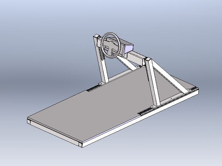

    Alright so I started my design and below is a picture of my progress so far. I've decided to build a seat mover style simulator that mounts to a fixed platform. I decided to start at the front of the platform and work my way back. The steering wheel mount is adjustable up/down, in/out and pivots about 30 degrees. My next goal will be to find a seat and decide how to mount it. I was looking at this seat from amazon but would be open to other suggestions as well. I've thought about going to the junkyard but my only concern with a standard car seat was how well it would hold you side to side without a seat belt.
    http://www.amazon.com/OMP-Racing-ACCESS ... 839&sr=1-4
    I'll have to build a frame to connect it to the base and attach to the wiper motor arms. Any suggestions for how to connect to the frame? Is this normally done with a u-joint? I've seen it done with a rubber mount but wasn't sure how well that would hold up.
    Also, on the geometry of the seat moving arms (not sure what to call these) I'm trying to figure out the best angles. I was planning on starting with 15 degrees in both x and y directions. I thought maybe I saw a post a while back on the geometry but I haven't been able to find it since.
    I'll keep posting my progress and thanks in advance for any feedback.
    Matt

    Hello Matt, good to see the project going forward. I like the adjustable steering - pedal arrangement. Good for any size user.
    The seat you have pictured is a good seat. And would more than hold you. I am not really sure about a standard car seat holding you in. Then again if the seat has some support on the side you may be ok. Most guys do not have seat belts in their set ups to hold them in, more for looks, I think. You may find that you move yourself around to hold yourself it the seat anyway. I have basic car-racing seats on mine and I do not find myself being thrown out. Thats just me though. http://img151.imagevenue.com/img.php?im ... _131lo.JPG
    Mounting the seat can be done with a box style frame with the seat mounted on it. A car uni joint is the preferred option as you have 2 movements, left and right, up and down, with no side to side slide. The best balance point would be just under the seat centre. Although have a browse at other projects to see the balance point.
    I used a 16mm thick piece of mdf sheet screwed under the steel frame to drill and bolt the unit joint to.
    Without hijacking the thread too much http://img134.imagevenue.com/img.php?im ... _572lo.JPG I connected mine at the base of the seat, however connecting them at shoulder height would be good and less strain on the motors.
    The wiper motor arms seem to have good movement, somewhere about 15 deg of angle. Most guys seem to leave what ever arm is on usually. With a seat mover it may be better to have short sharp motion as opposed to big movements. Then again, you can shorten the motion in x-sim, to save modifying the lever arms.
    Hopefully that helps to some extent.
    Have fun designing
    Cheers, David.
